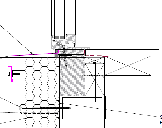

	TBH it's a red flag that this design was proposed as-is at all? Suggests the designer either isn't worried about massive cold bridges, or just didn't spot it? Had you specified that these kinds of things should be avoided? Where else might there be issues? For example what is the detail at the 'north' end of beam 4?
	We've used armatherm structural thermal breaks in a variety of places, which like the Farrat are I think commonly used for steel balcony connections https://www.armatherm.co.uk/products/frr-structural-thermal-break-material/ They can provide bushings and washers as well Not expensive. I believe stainless steel bolts give reduced heat transfer. While I'm not a professional, even if I wasn't concerned about heat transfer I wouldn't want any structural steel running through the envelope on a building intended to last 100+ years. What if the outer end gets wet and rusts? Wouldn't want to have to replace the entire beam. In that, I'd want the balcony to be replaceable independently of the main structure. We don't have any balconies, but we have an awning bracket which is similar. The stuff that looks like wood is the armatherm FRR:

	Fair enough. For various reasons we can't support much weight off the sides, and while in principle the support along the bottom need not be continuous (e.g. could have 3 blocks of perinsul and fill in the gaps between with foam blocks) the way the whole thing has been designed requires an insulating & structural block under the whole window frame, which then has things screwed into it and airtightness tape attached. The insulating / structural block is shaded. TBH I never really looked at this detail until now, hence the question. Also now obvious that perinsul won't work here since it can't take a screw, and I wonder perhaps armatherm can't either.
