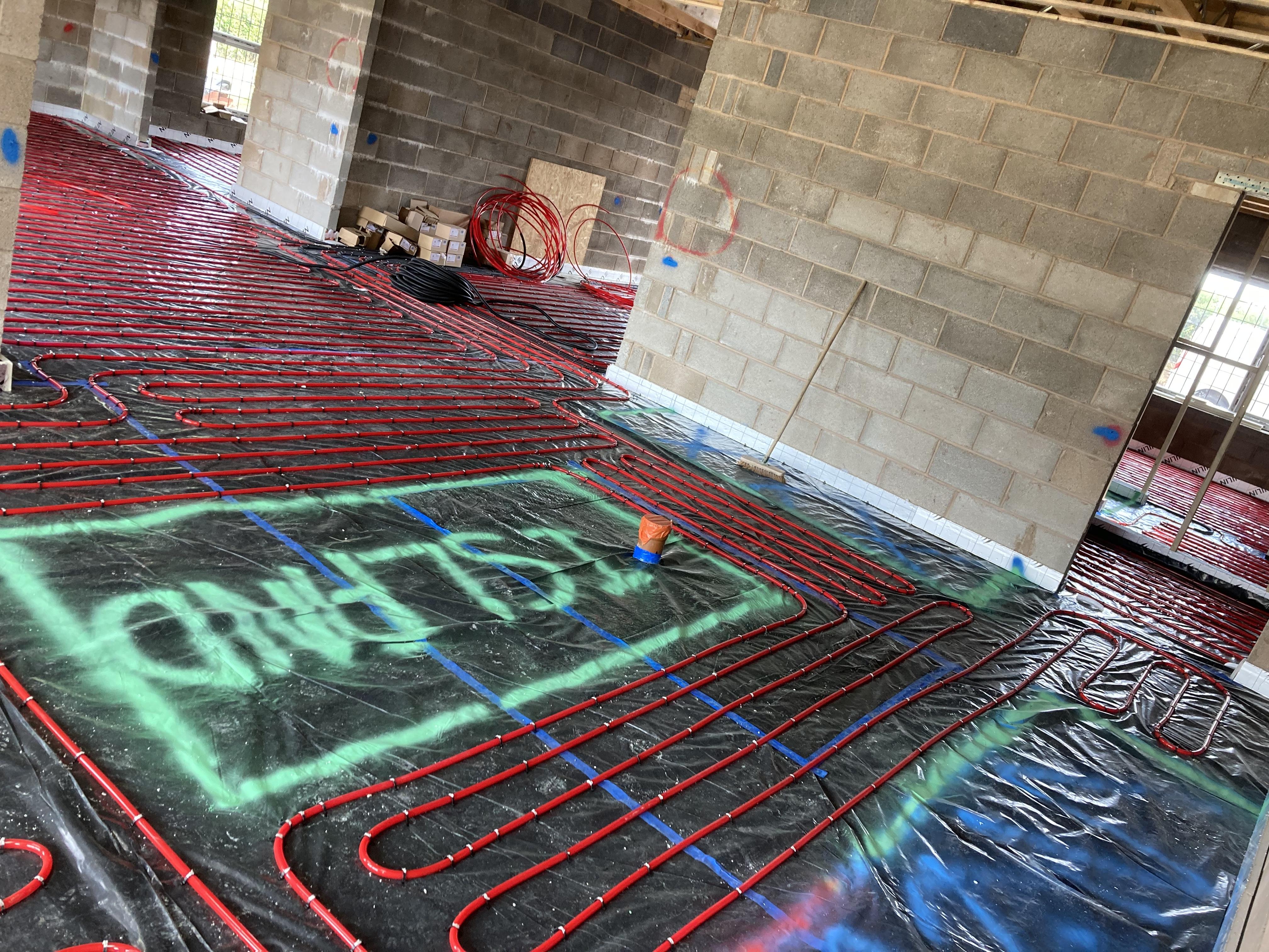

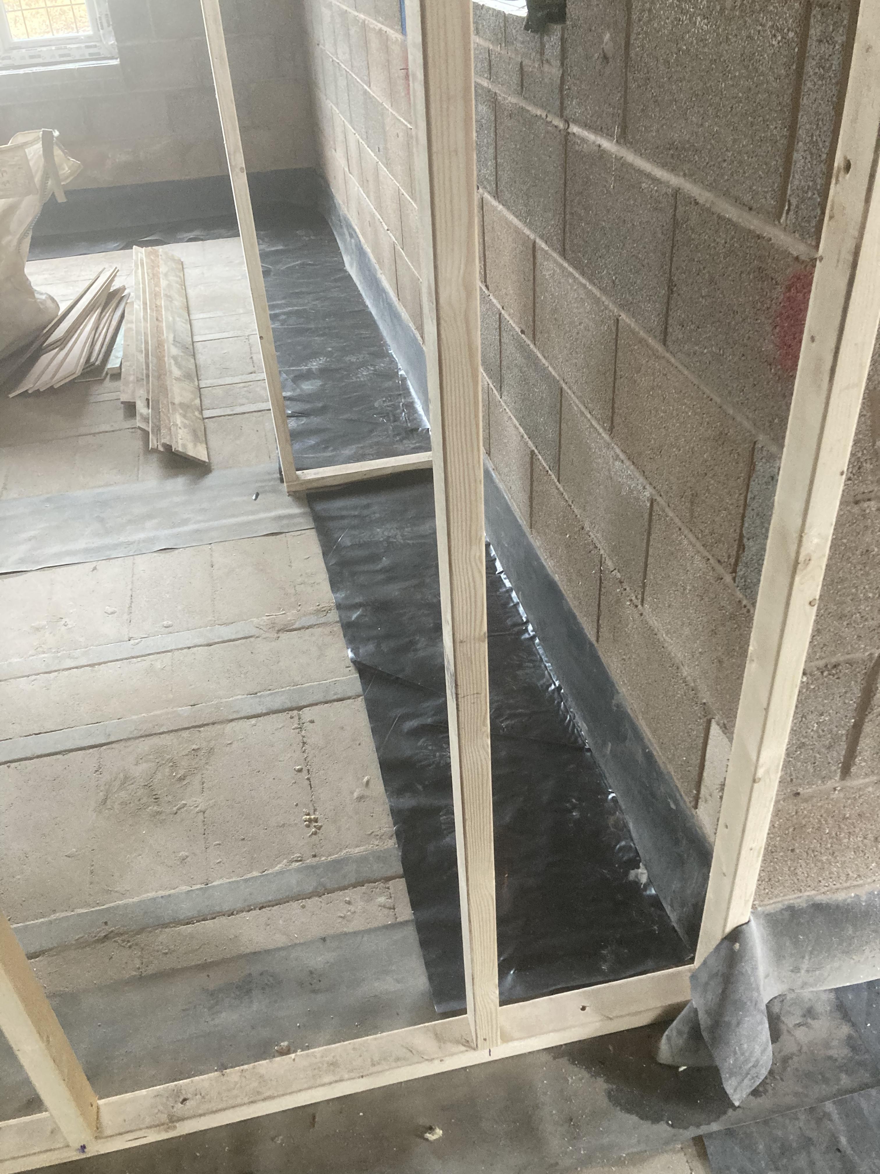

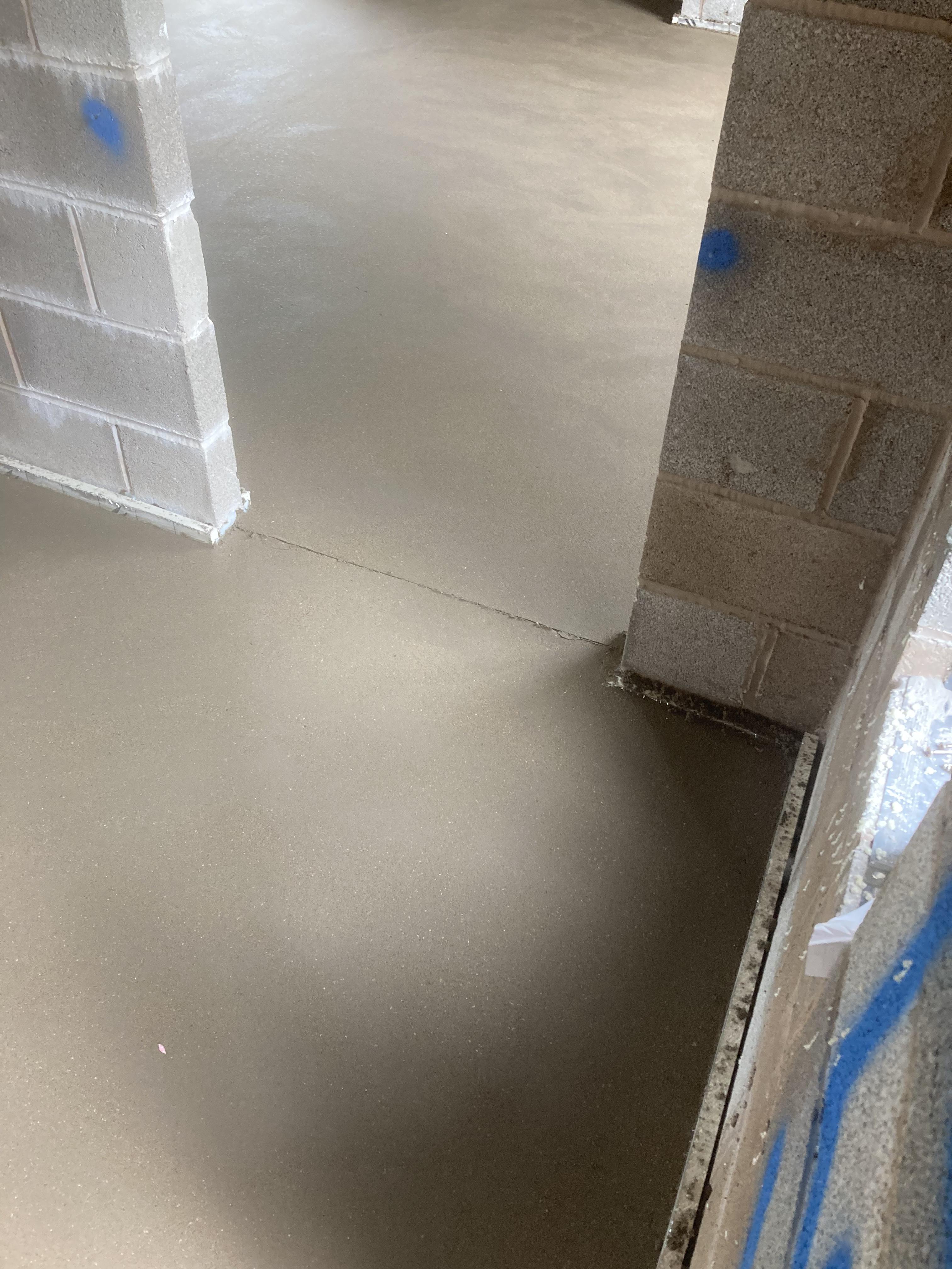

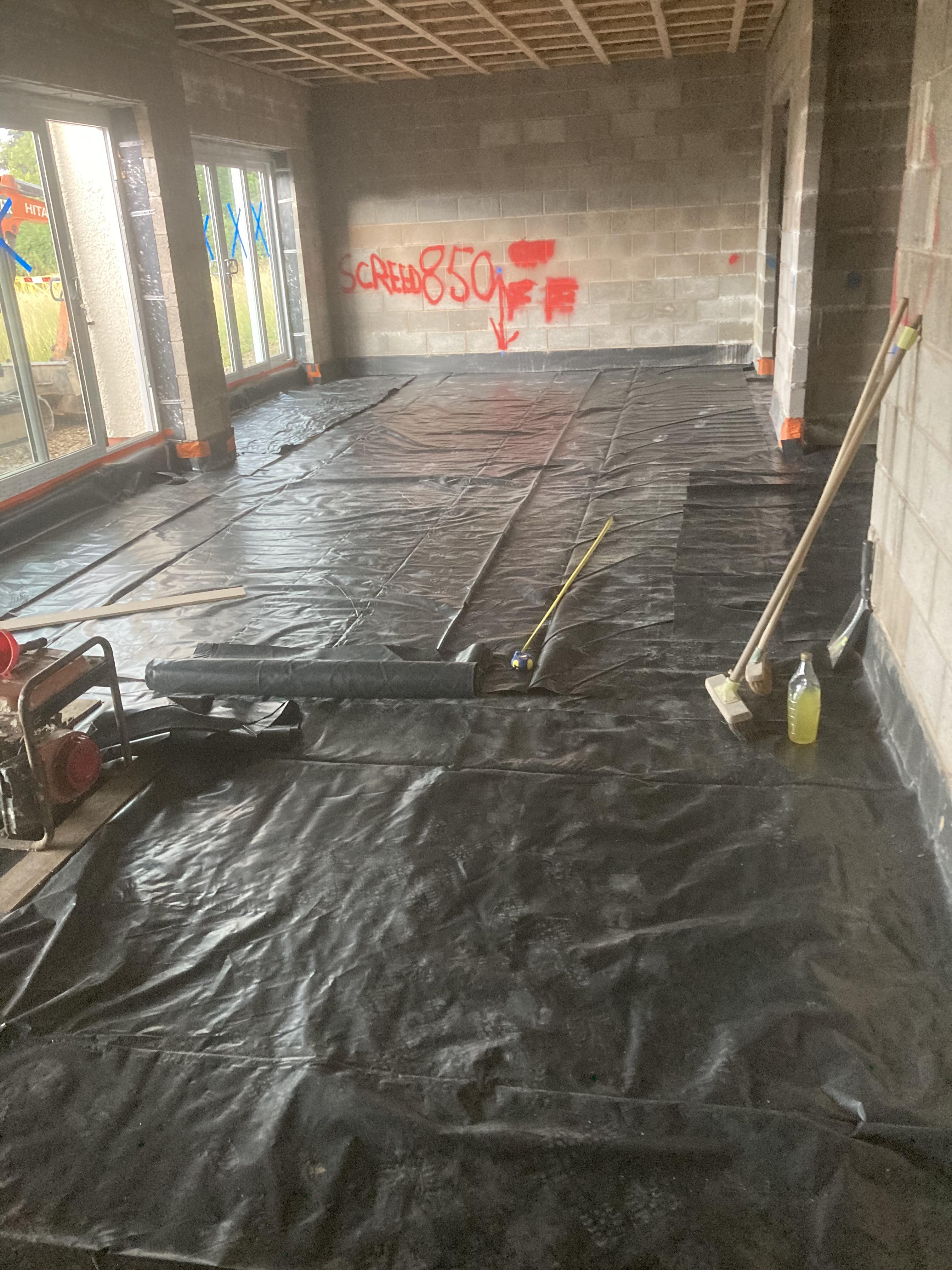

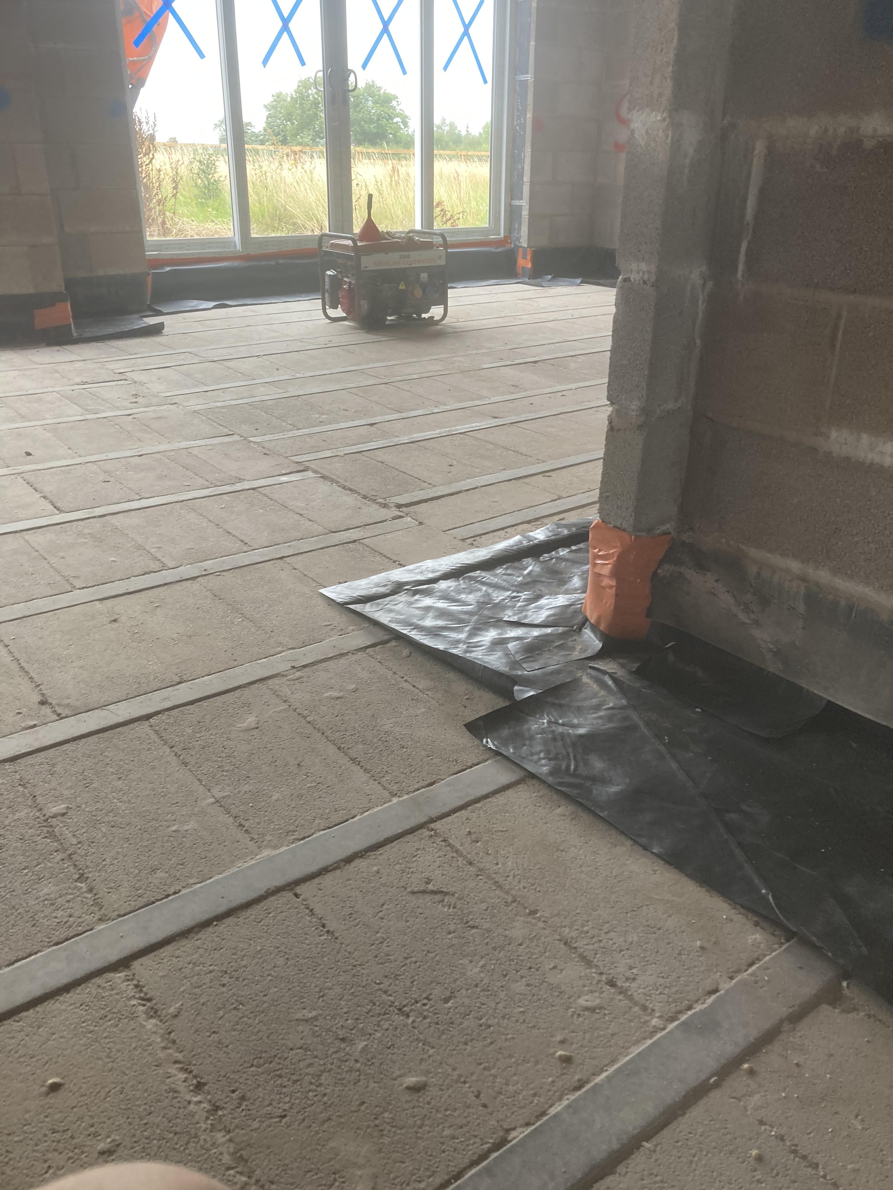

  5. Yes we ran a 600 strip around the pet Yes we ran a 600 strip around the perimeter and taped it to the high load dpc and rapped and taped all the corners Then ran a membrane wall to wall taping down 150 insulation Then a slip membrane Then a 100x25 mil upstand around the perimeter Then simply clipped the UFH pipe down
