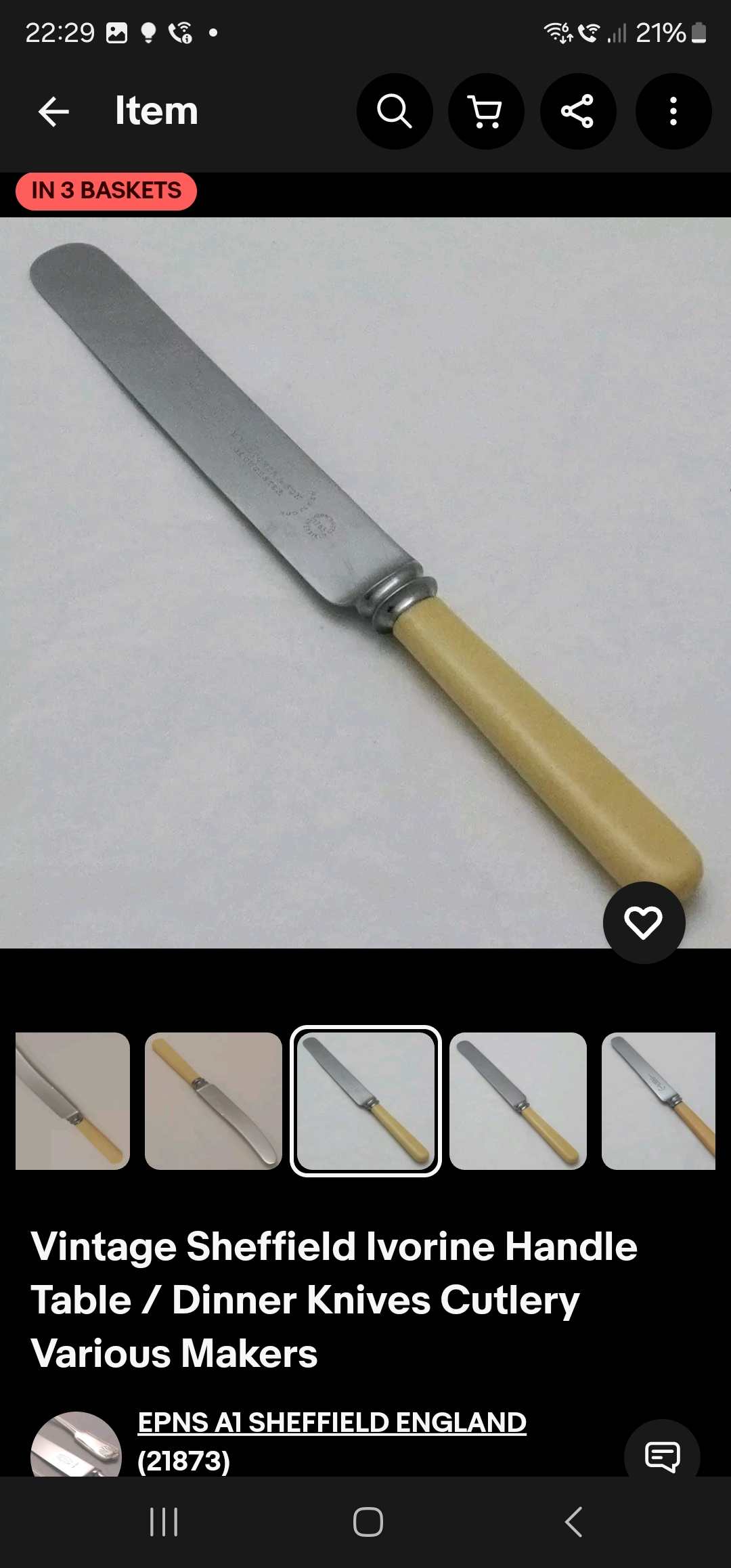

Not this particular panel but I struggled with the flipper panel on a walk in shower and the seal was like this, rigid and bloody hard work. In the end I used one of these old knives (I have a couple I got from my nana and use as butter knives). The handle is slightly rounded and worked well at pushing it in! Had blister on my finger though.... didn't use anything else as you had to put sealant on the metal and push the seal into that. -
