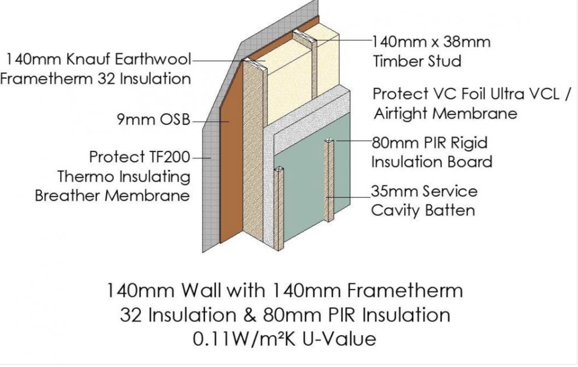

Hello all, I'm looking at ways to reduce the cost of my kit house, one big saving is to get the kit uninsulated and installing the insulation myself. I wanted to hear some opinions on using the 140mm Knauf Frametherm Insulation inside the 140mm Kit Frame, then using rigid Celotex type board on the inside face of the kit with a foil barrier. I've seen some kit manufacturers offer this option but my Architect is advising that its not good to mix the insulation types in the wall (wool and celotex). Is this correct? The U Values look to be the same and I imagine its a lot easier using the frametherm than trying to cut 120mm celotex boards neatly to fit in the verticle studs. The kit I'm looking at has 120mm Celotex in the kit frame and 50mm celotex on the inside face. If I get the kit without the insulation it's £9800 cheaper. Picture below shows what I'm looking at doing.

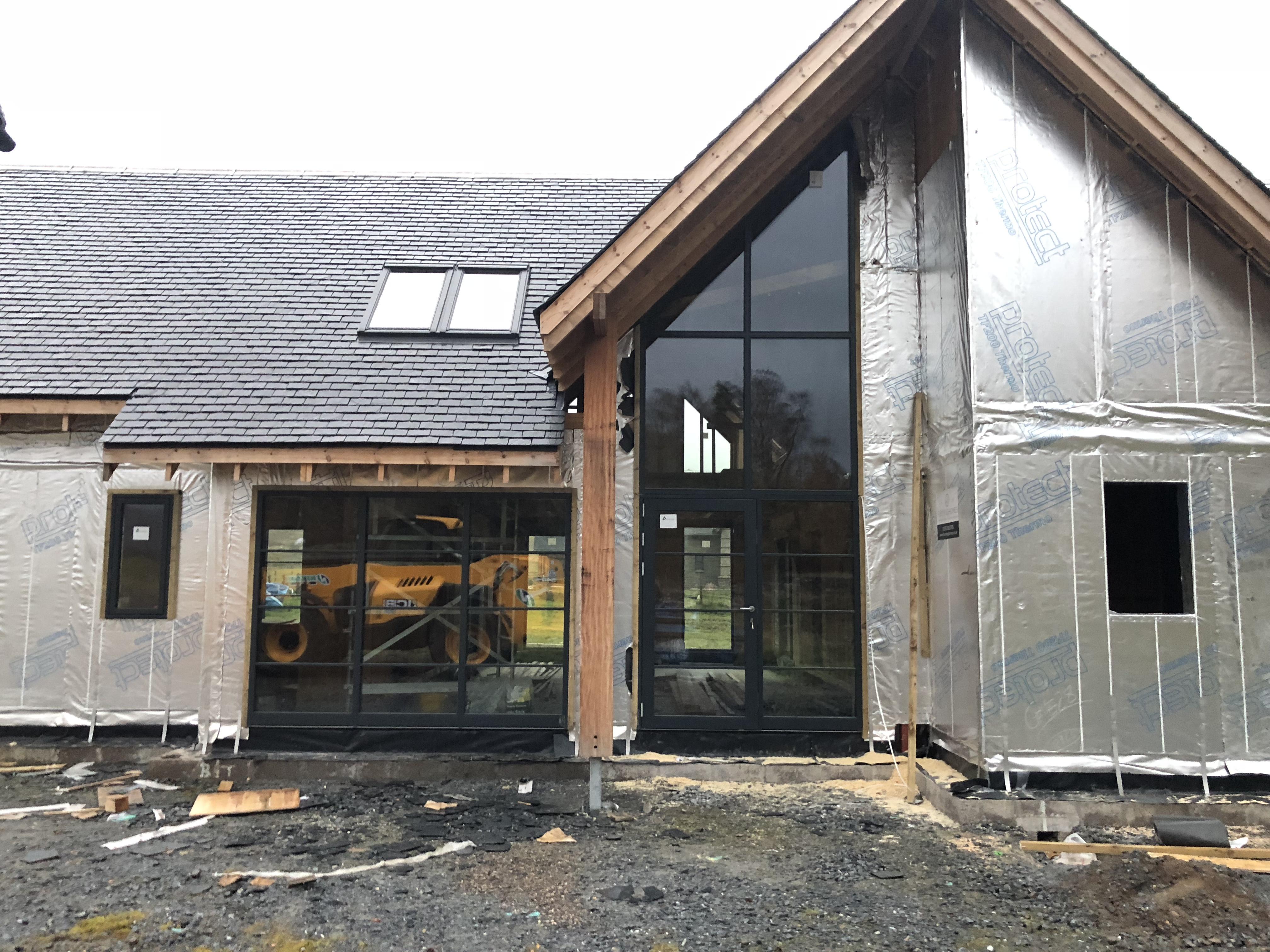

I just done some on a project and I was surprised at how easy it was. We had 50x50 battens that are cut to the fit around the windows, they are then screwed onto the outside edge of window frame (so like a frame around the window) You then push the windows into the recess and the battens leave it sticking out by 50mm. You then screw through the battens to the outside of the timber frame. If you zoom in on the picture you will see what I mean. This will I’ll have a block skin on the outside of the kit so the windows will be recessed once the blockwork goes up

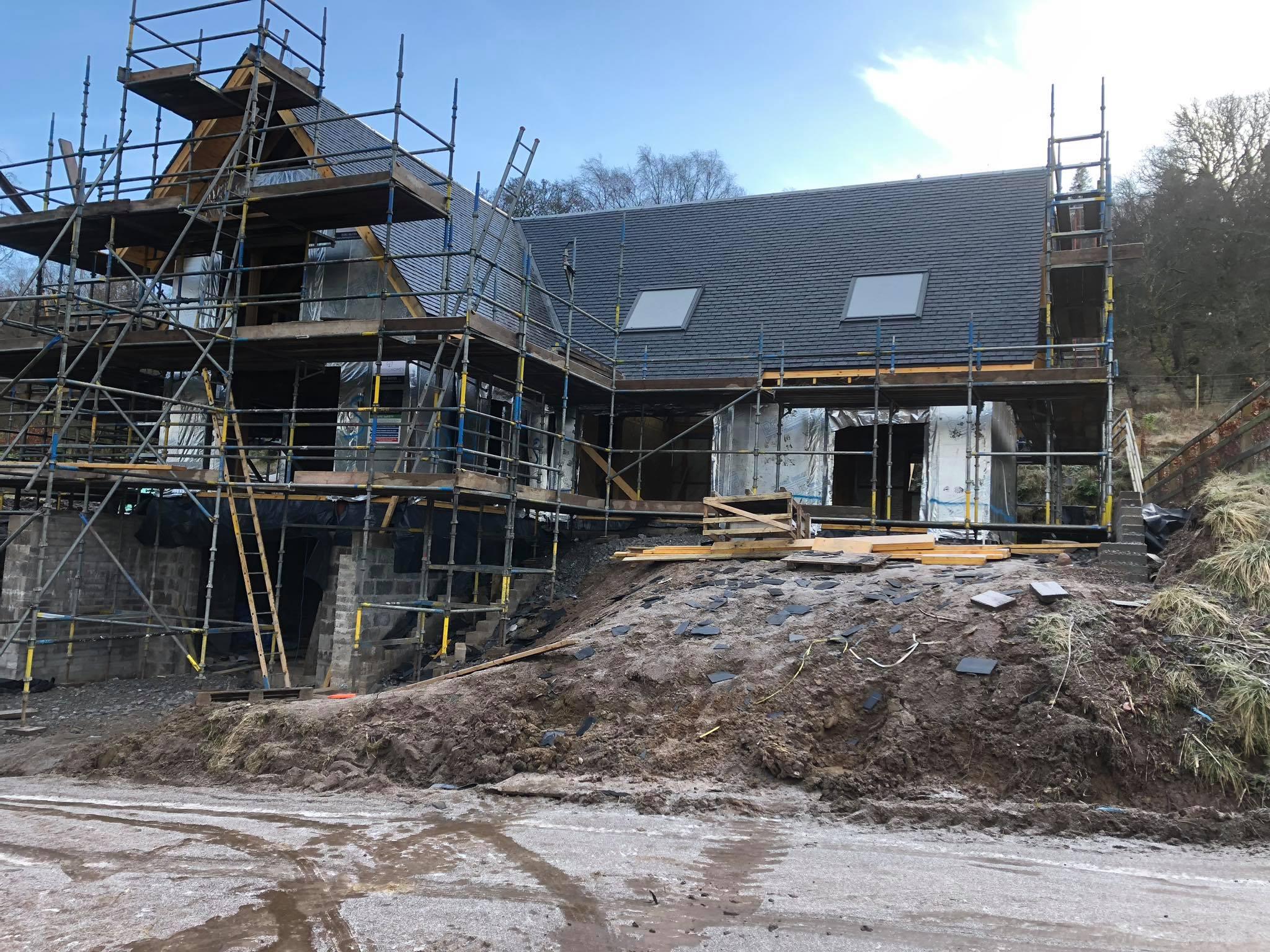

I have a grounds work contractor lined up, same with block work, slaters and most other trades. I am midway through the project management of a build for my brother in Dunkeld, this has proved valuable in learning the sequence of a build, and also meeting some reliable trades people. Pic below of the project I'm doing for my brother.
