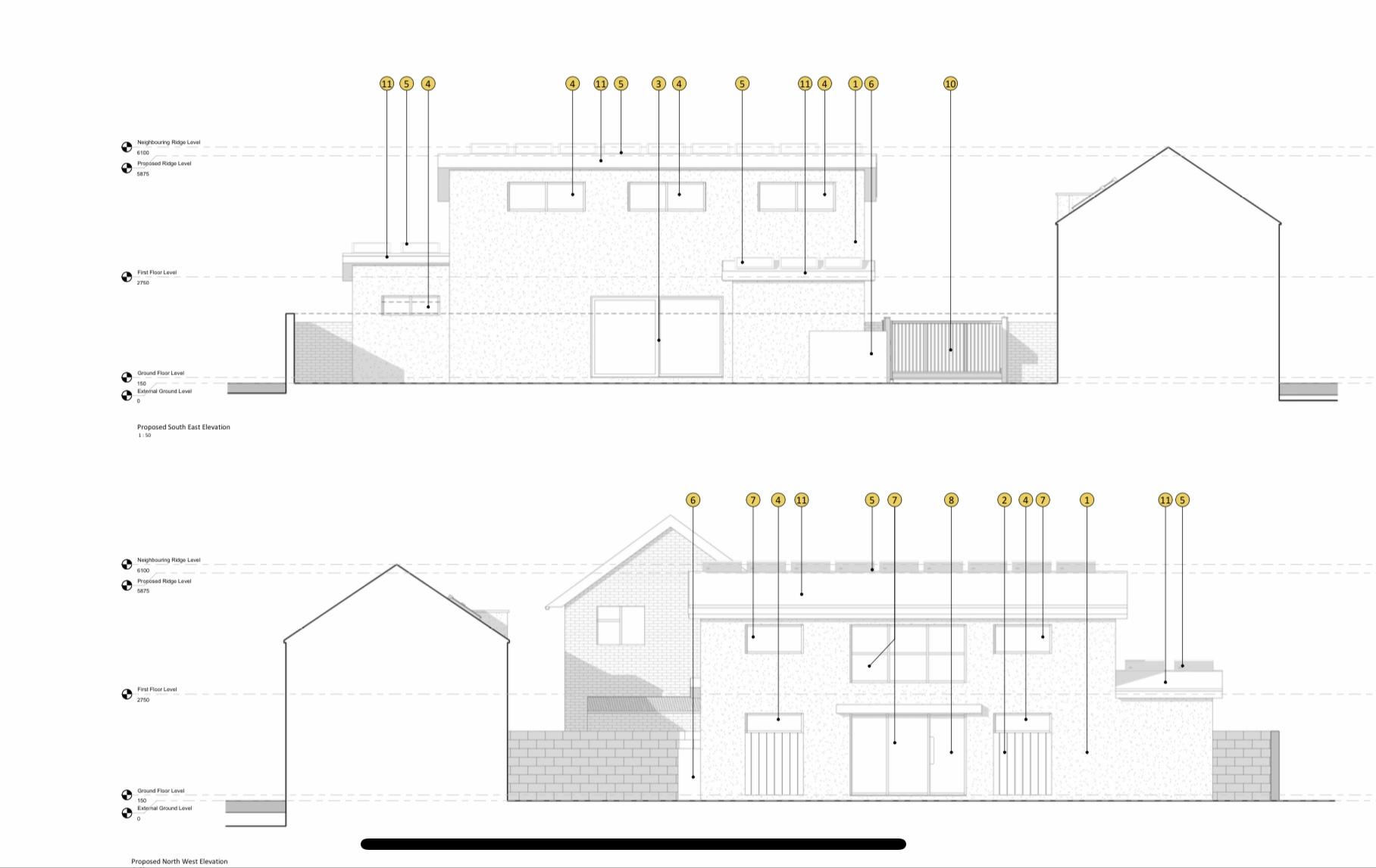

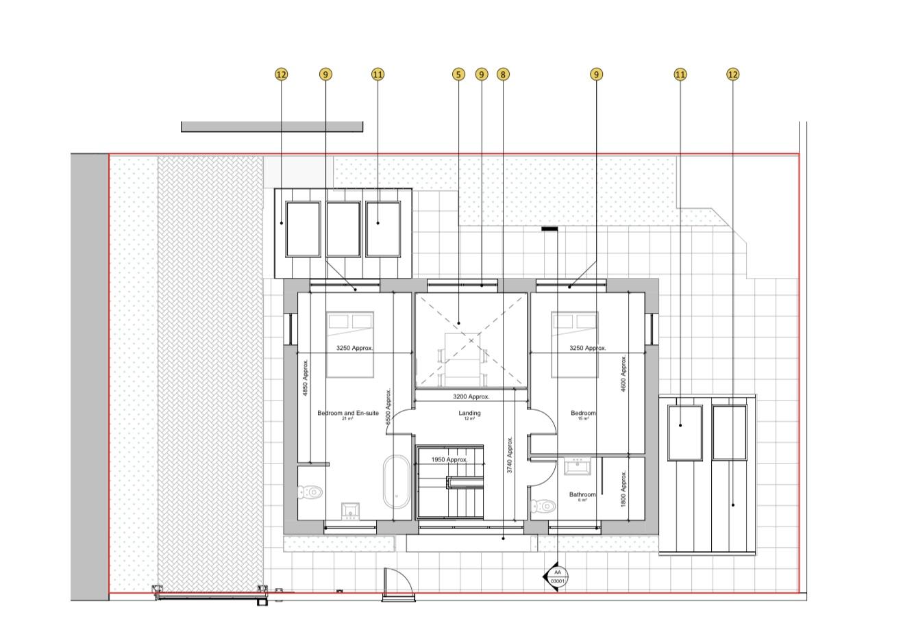

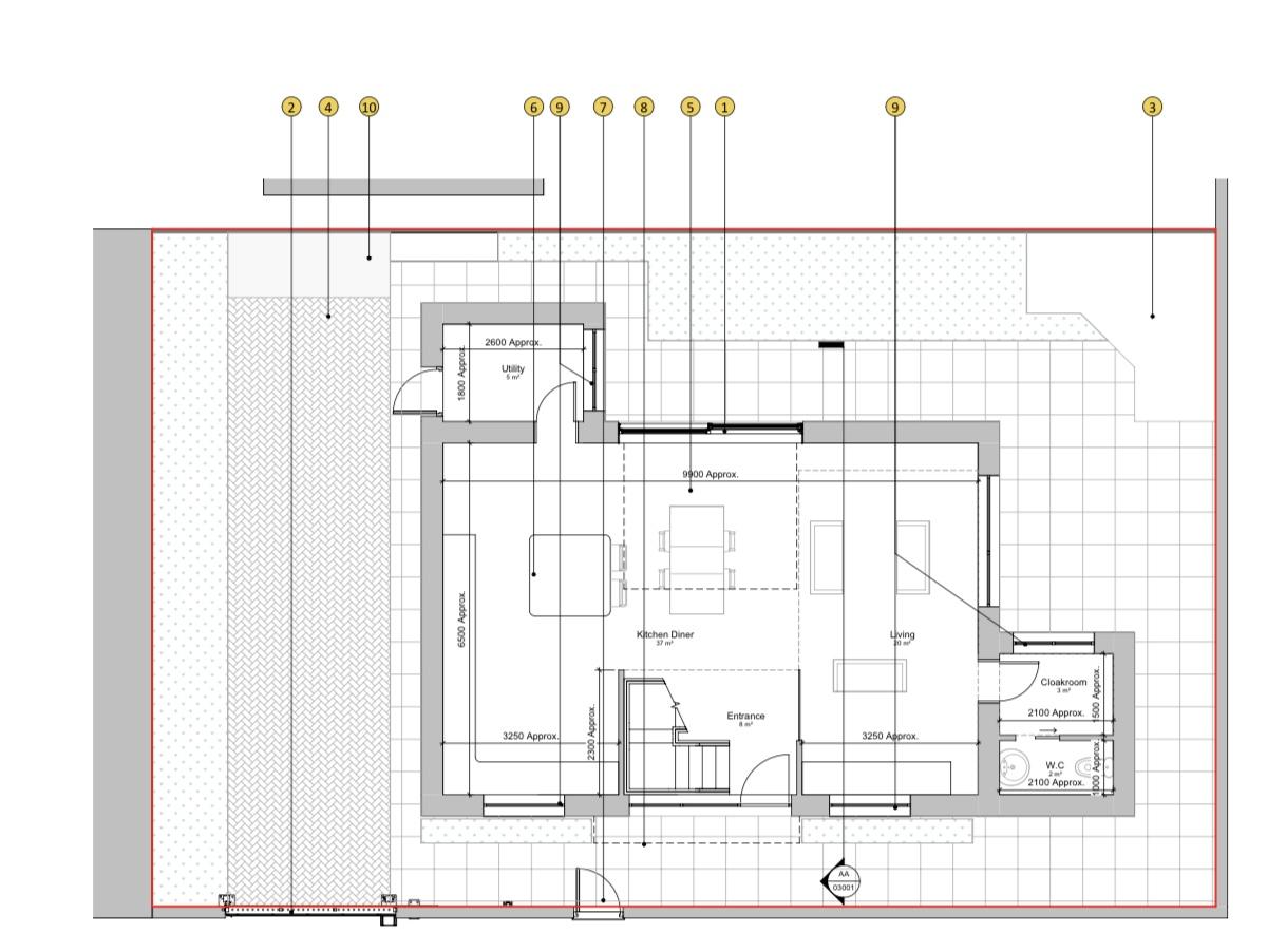

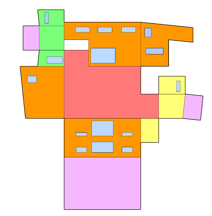

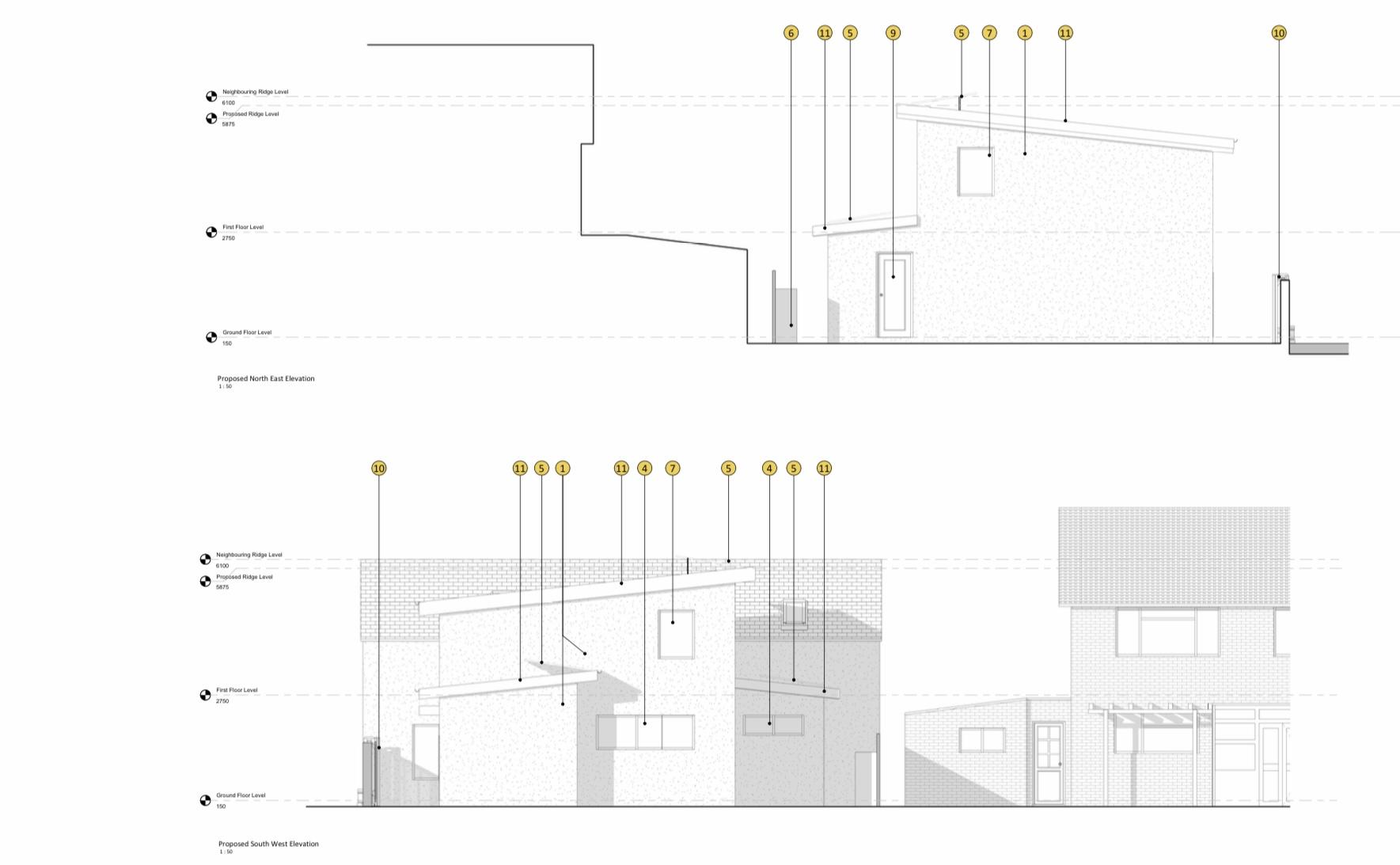

@iceverge kindly looked at this for me and replied as below. As they said any other comments are welcome.. the two add on ‘pods ‘ as I call them are because I will never be granted a bigger overall house from planning but they may allow the little extra single story ‘pods’ which would help. So here is the message . Which I’m very grateful for. This forum is invaluable I’ve learnt so much from my posts . Thanks to everyone Nic Here we go. I've thrown about an hour at this drawing. Its like a cardboard cut out template of a house PHPP uses external dimensions unlike SAP. NE wall 46.7m2 Window 3.3m2 NW wall 51.7m2 Window 14.5m2 SW wall 46.1m2 Window 4m2 SE Wall 61.9m2 Window 12.3m2 Floor 94m2 Roof 94.6m2 Your current wall thickness is 400mm. Roof is 350mm. This would result in U values of about 0.16W/m2K with ICF and a joisted roof. Lets assume you can install a floor as thick as you wish with a U value of 0.1. Windows at 1.1w/m2k installed. I note you're in the south coast. Lets assume zero as a minimum temperature. A good airtightness score and MVHR. Take any internal heat gains to be cancelled out by minor thermal bridging and the inefficacy of the MVHR. That leaves us a simple enough sum to do. Area X U value X delta T = Heat Loss Total Your heating load as stands would Roof: 94.6x0.16x20= 302w Floor 94 X 0.1 X 15 = 141w Walls 206.4 x 0.16 x20 = 660w Windows 34.1 x 1.1 x 20 = 750.2 W Total heating demand 1853 w. The foot print is 94m2 and the floor area is about 150m2. You're at roughly 12.5W/m2K specific heat demand vs the Passivhaus limit of 10W/m2K. There's a couple of things you could do to adjust. The small add ons to the south and west adddisproportionately more external surface area than the floor area. For instance the one to the west adds only 5.5m2 of floor area but 131W of heat load or 24W/m2. It's twice as bad as the average of the house. Designing from scratch they'd be a far more expensive option than just making a house a pure 4 sided box or even a full height "T" or "L". I understand you are size limited but slightly thicker walls or roof would help. Only marginally. As you can see even good triple glazed windows loose a tremendous amount of heat. More than all the walls combined. You have 14m2 of windows on the North wall. This will loose heat all year around as unlike the South facing window's they'll never gather energy. ( Nett loss) Consider making them smaller. For mainly this reason it's very unlightly you'll be near the annual heat demand of a passivhaus. I would guess you'll be about 4000kWh per year. Assuming a well functioning ASHPand 25p/unit this will translate to about £250/year for space heating. A passivhaus might be £150. Over all, if built to good standards of airtightness and thermal bridging you'll have a very warm house.
Thanks main reason is to make sure I get it right as it’s all new where can I find mr Harris’ spreadsheet ? thanks
hindsight is a wonderful thing ... however I need to move forward... sorry in advance for the long request I have an architect I really like and have submitted a design for an ICF, with raft, low energy build. The site I have did have planning for a small dwelling which was already approved ( another architect conventional build ) but due the changes I made it was thought best to pop in another application. That has been with planning now for a month , so far no objets , fingers crossed. The footprint of the building is a box shape ( no fancy details) only 94m2 and has a single mono slope roof at about 5 degrees. The plans submitted have kept the sw and se windows relitively small The corner of the property is on the south axis . I now am thinking I should just go fully for the Passivhaus certification. So I see I have these options if I choose to go down that route 1. find a new architect that is PHPP and start again ( not ideal ) 2. ask if there are any PHPP consultants who are prepared to just work with my architect ( in principle am I then paying almost twice for the same thing? ) 3. Is it possible to ask someone who has knowledge of the PHPP software to look at the design and plug in the basics of what I have to see how far off the design is and discuss options there? 4. can you ask someone to do all the PHPP ( who may not be officailly accredited ) to then just have an accredited PHPP done at the end and then either pass or fail ( but know you are very close to passive having worked mainly with the PHPP all the way through the build .... yes I know and apology's in advance.... really not sure best course of action and of course budget is tight as it always is with these things

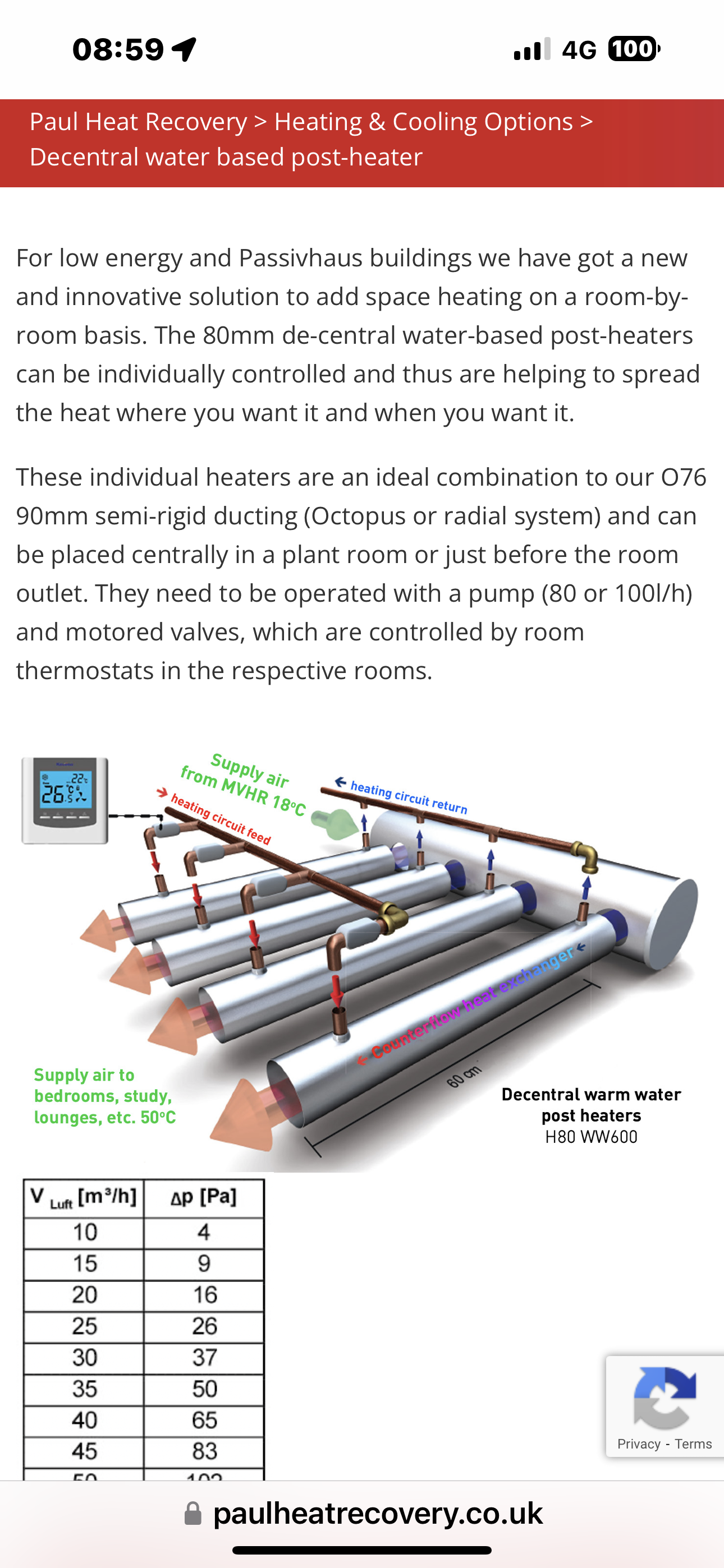

Sorry I think it was this or a bigger version of it . https://www.totalhome.co.uk/ventilation/?pid=594 early stages of my fact finding and drawing just being sorted . the whole house heating calculatio, is that easy to do?
