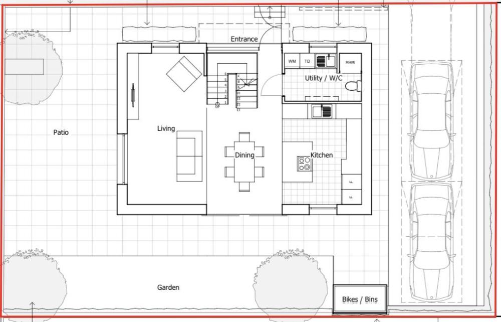

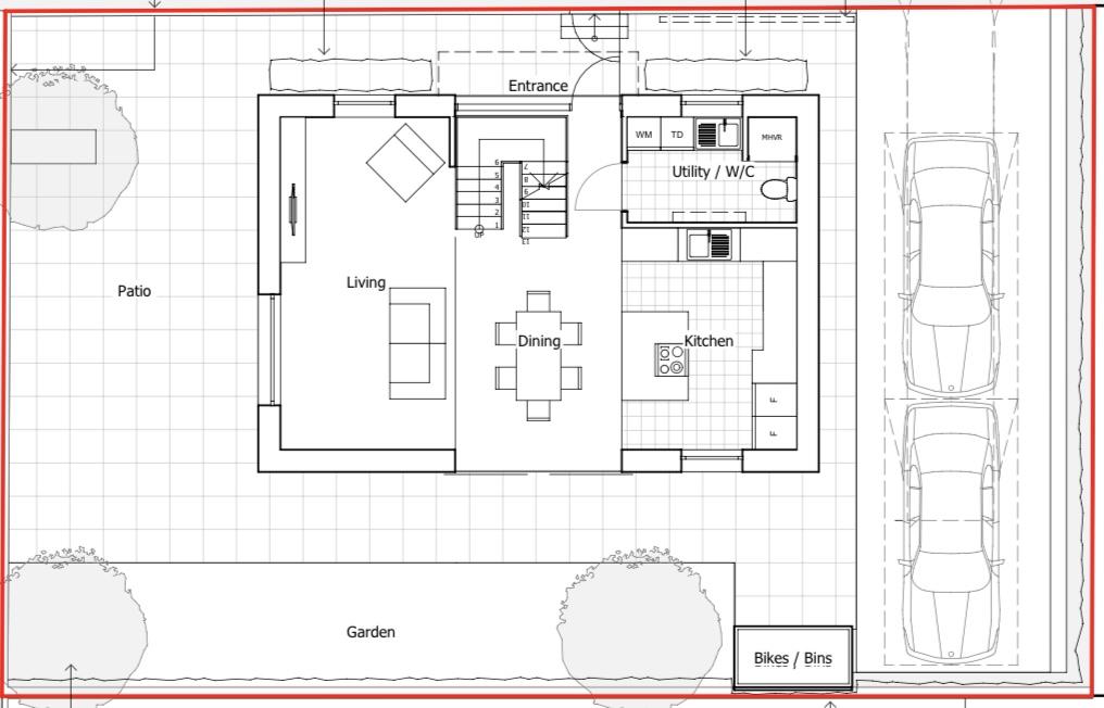

  1. Something like this, not set in stone on utility room layout ( probably stack washer and dryer , move toilet and MVHR as ASHP will be on the external wall where to toilet currently is located

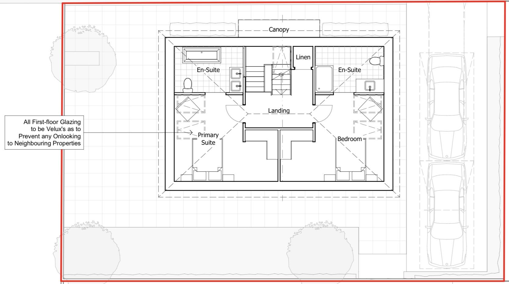

  2. I'm so grateful this is really helpful. I’ll be near to Raddenstile Lane in Exmouth due to the small roof are ? Only two bed and Velux’s in roof as well we are limited to about 3.48kw of solar , with a 5.76kw battery ( quote £8500 fitted inline ) looking at the Zehnder 250 flex ceiling mount to save space in utility room . Not considered best external ASHP yet or DHW cylinder and just a single zone ground floor UFH system . Very limited internal space for this about 1m2 with the MVHR in the ceiling. many thanks again . Total floor area over two floors is going to be 110m2 and Norrsken windows and walls will be around au value of 0.11-12 Velux will be the new passive range

  8. Hi just discovered this post and more confused on what to consider for our future build will be built to passive air tight standards. Will only be 55m2 downstairs and two double en-suites upstairs . 1 bath 1 with shower . So total is 110m2 downstairs is all open with a small utility room where I have about 24m ceiling and about 1 meter square of space. This is for however I’m going to do MVHR, DHW , one zone UFH .As you can see was looking at a one box solution like the Genvex combo or PKOM 4. I can obviously put an ASHP outside and a compact MVHR. But still need cylinder …… please help 🙏

  20. been round the houses on this several times the only way it works for a living point of view is the 1.8x3m utility room ( max I can go ) can stack tumble on top of washer gain a bit of space the utility can have a lock on it so don’t need to box in wc and sink .. coats and shoes on opposite side of room so that leaves the PKOM4 ( which I’ve been informed takes up about 1m2 to include pipes at side and expansion 🤷🏻‍♂️ can put an ASHP outside and say a wall mounted MVHR like the comfoair q 350?, is there a compact DHW cylinder that would slot under it if I mounted it high enough ? ( 2.3m ceiling…. Just very limited I’m sure there’s a solution somewhere

  22. Planners say no … on a small plot … even need to ask permission for a shed … hence it’s in the house can of course put an ashp outside to free up some space instead of pkom4 or similar but then will need a cylinder inside anyway
