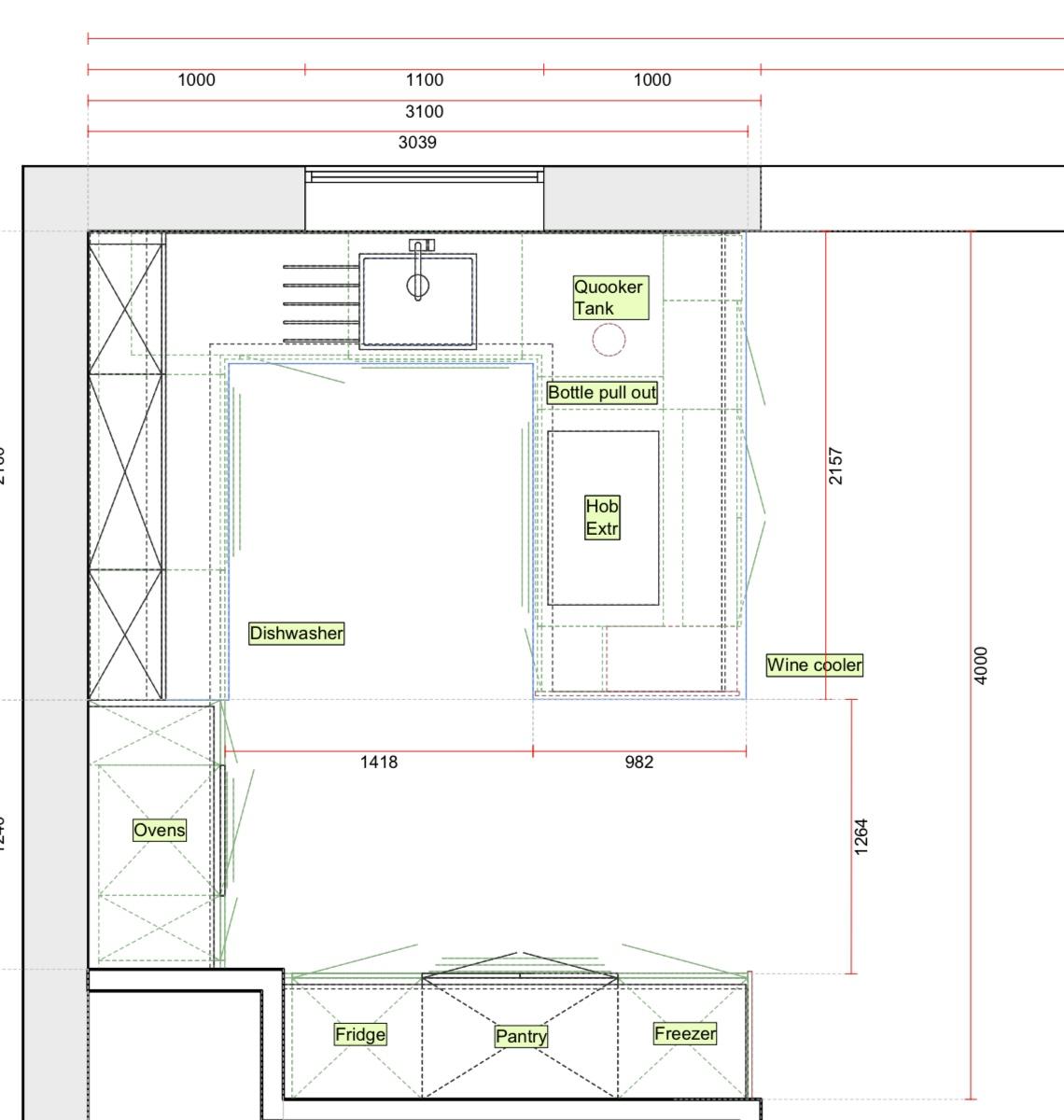

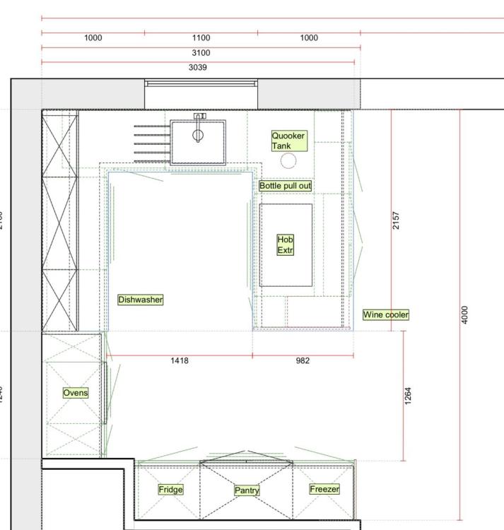

I meant on the run next to the dishwasher and move the draw unit to the current sink area👍🏼
Quick question.. I’m happy with the general layout of attached kitchen ( 4x3.1m) however the sink ( although facing the window is nice atheistic I wonder if it’s a bit too close to the hob and might be better on the run directly behind the hob? any thoughts?

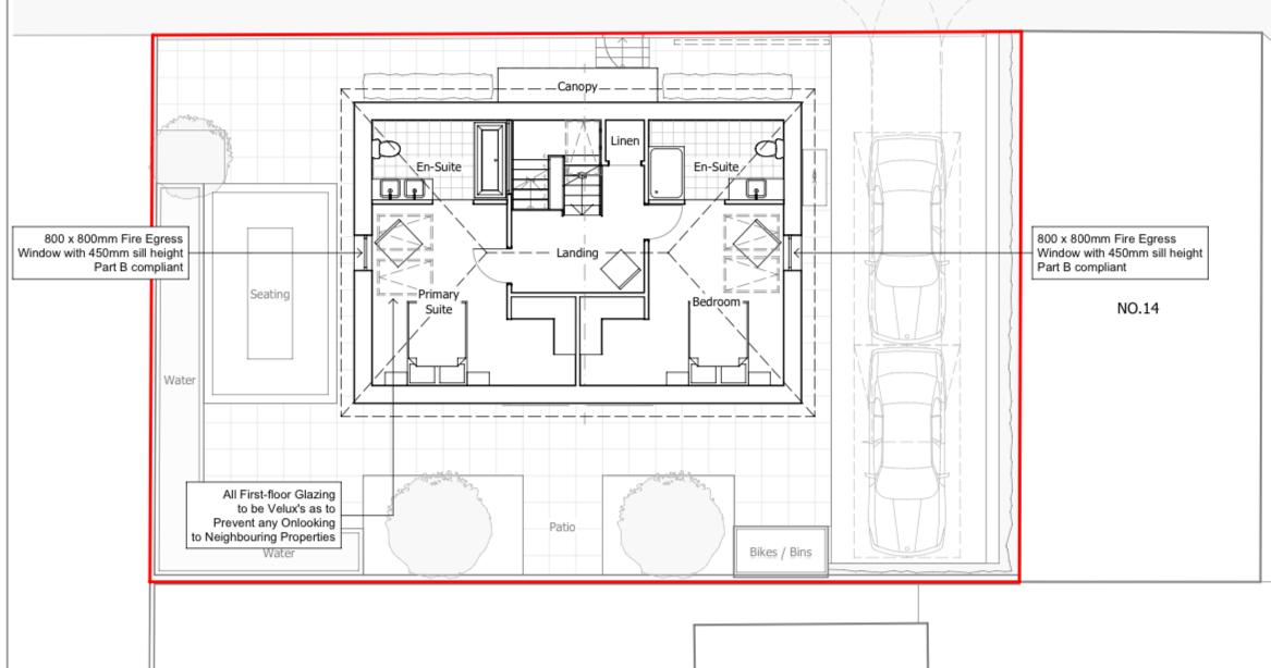

Because planners say all windows have to be Velux on first floor and 1.7 from first floor also overall height of building not allowed to be higher than old coach house next door, so has to be subservient to that . So there are some strict conditions . The two Velux’s at each end will supply light to en-suit as well as bedroom as the wall to the en-suite’s will not be full height. ( it’s been a challenge 😂) If there weren’t these restrictions we of course would have conventional windows etc

Yes indeed the planners have said what they said... but seriously this plan had to go back through the planning process because I wanted to move a door and a vellum ( condition meant I couldn't do that on the first plan which had already been APPROVED with the ashp in situ!!!!) I then pointed out to the architect that we have no escape windows on first floor and although planners never mentioned that and had approved without , we put them in on this application as building regs would never let that slide and would cause issues down the line. so a bit annoyed they are now being very picky

Err hope you all don’t mind I have a similar situation My velux bottom is 1.7 from first FF. so a small escape window with a fire escape door type release is being suggested ( permanent frosted glass) see attached photos . The planners are saying below , which if I’m honest I have no idea what they mean😂… a clue anyone ? “We are still considering the additional info re the fire escape window and are discussions as to whether we feel we can have sufficient control over the opening of this window in the event of an emergency only through condition.” ????????
