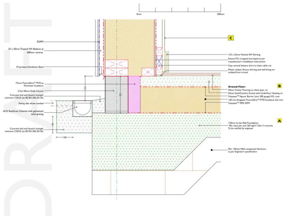

  2. Hi timber frame ( triple glazed Norrsken windows ) attached on outside stud work. what sort of thermal bridging detail do I need to have / consider ? Is what’s shown enough?

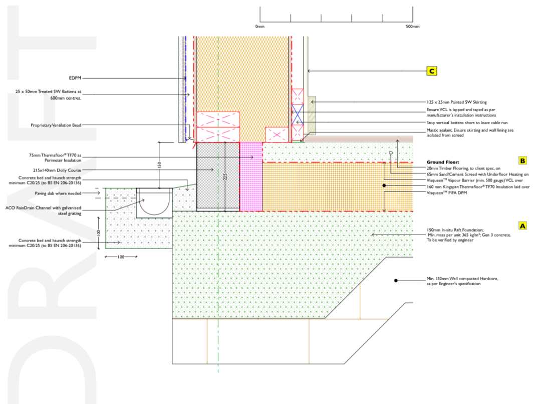

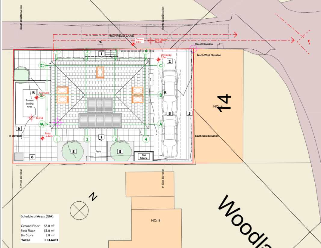

  5. Hi any recommendation for a design service near Exeter for a new build based on a passive design. Two bed timber frame high insulation, airtight . Ground floor UFH and ashp, MVHR and solar to work together is the plan
  6. What about how to raise outside to make outside at FF? And not cause any issues with damp cause
  7. So at building regs drawing stage for a small timber framed house. Rendered outside, built with passive and airtightness in mind . Architect has listed this in the info on the ventilation? Any thoughts as I thought the MVHR did all the ventilation do I need all these extra things ? AD PART F Ventilation to be provided by designed MHVR system. In general: BACKGROUND VENTILATION In addition to natural ventilation, equal to 0.3 l/s per m' internal floor area (including 8000mm night vents), the whole building ventilation rate to be 19 l/s (one bedroom). The whole to be in accordance with Approved Document Part F. Kitchen and bathroom to have a mechanical vent with 100mm dia, ductwork to external air. Kitchen to have extraction equal to 60L/s (w/o cooker hood). Bathrooms to have extraction equal to 15L/s. Kitchen extract to be Expelair GXC6, or similar, with a 15 minute over run facility. Bathroom to be Expelair DX 2100, or similar, with a 20 minute over run wired to light switch. NOTE:All exposed vents to have fixed grills/hoods. A Positive Input Ventilation unit to be installed. Vent-axia wall mounted Posi-Dry Compact Pro (model 479188) with integral heating element. Duct form outside to PIV unit to be insulated. PURGE VENTILATION Minimum requirement is for 4 air changes per hour per room. All rooms to have openable window area equivalent to minimum 1/20th floor area for windows that open more than 30 degrees or 1/10th for opening 15 to 30 degrees. CONTROL OFVENTILATION Trickle vents are to be positioned min 1700mm above floor level, where possible, and installed in accordance with BS EN 13141-1 2004. Humidity detector to be fitted to Mechanical extraction. Installation and Commissioning Checklist to be completed by Competent and Qualified person and forwarded to Building Control.
  8. Hi I’m at building regs stage of a small timber frame , passive based house in Devon. Draft drawing just arrived today. I think I would like the outside to be at internal FF level based on what has already been drawn , any ideas on best option based on drawing attached

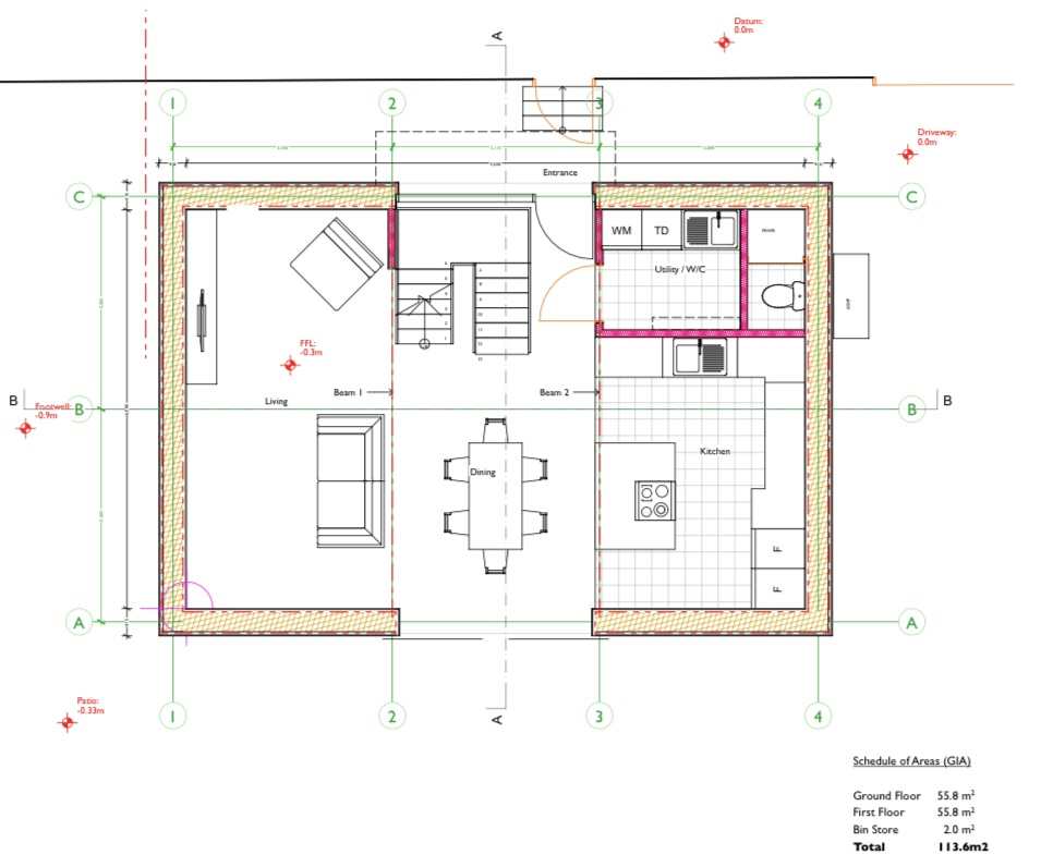

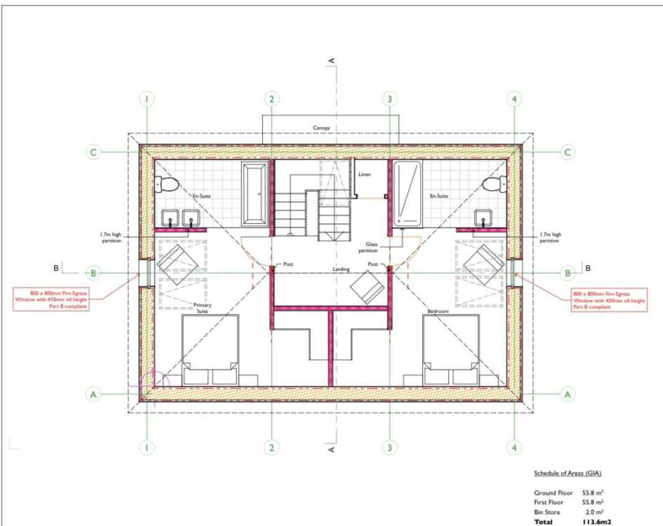

  11. Working together as a team ! I know a little about the above …but building a small 110m2 ( passive based) house see attached . I know what I’d like but can’t seem to find anyone who can design a whole system ( I get the “we only do ashp or we only do solar or only MVHR” etc) I’m going to be building in Devon . Anyone know someone who can look at it holistically and make sure everything works together? looking at a single zone for UFH ground floor ( primarily all open, so keep it simple) solar panels on the south side of the roof, to do electrical and DHW if required . I like the Panasonic ashp compact J type and the zhendar q 350 ( in a small loft) a DHW cylinder 180-210 size( three of us, two like baths) fan coils for bedroom? For summer cooling, cool the slab for downstairs in summer .internal dimensions are 9300mm x 6000 kitchen and utility have change slightly but no drawings yet for that we will have an insulated raft foundation and triple glazed probably blown cellulose planners were a pain in the !!! So we have what we have and need to work with it id be grateful for any recommendations on someone to look at this and make sure the builders ( or installers ) know what’s what and a plan to work to

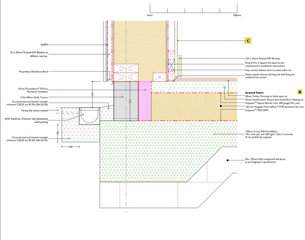

  20. Hi attached is the proposal for insulated raft for (passive principle) timber frame build of small new home. just getting some general thoughts on it to see if there are any areas which could be improved? Clay based soil and architect changed the original block and beam to this raft . I’m not a builder or after a passive certificate just want as airtight and thermally sound build on a budget 😁
