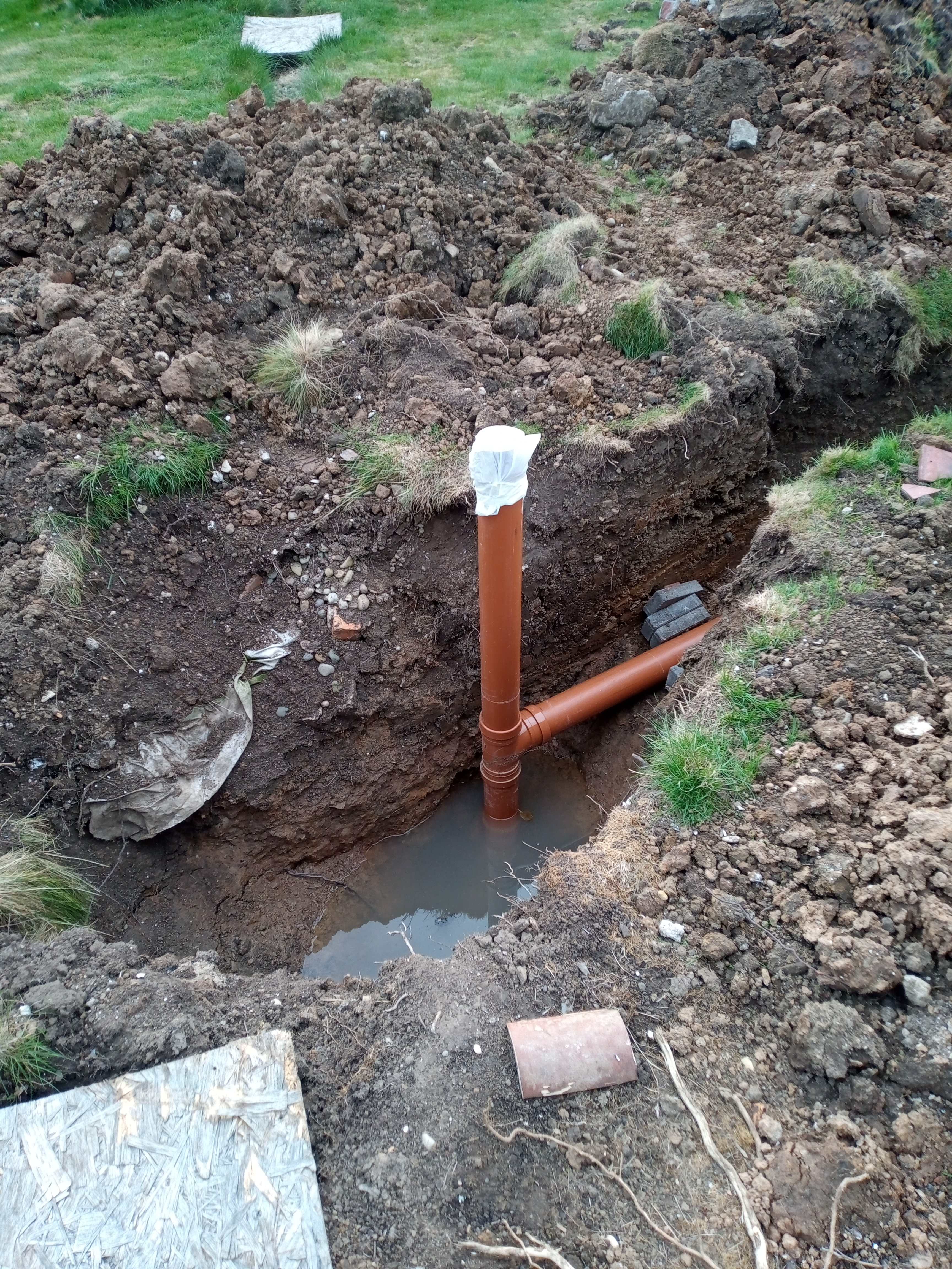

  2. Thanks for the replies. Got a spare rest bend so will put that on it with a 45deg Y piece in front of it for access.
  3. There's a manhole under the osb in first pic. New pipe cuts into clay pipe running through manhole. No probs with that. Been doing this 20 years, never seen a long radius swept tee. Apparently my drains are a bit long as well! Think he was on a mission

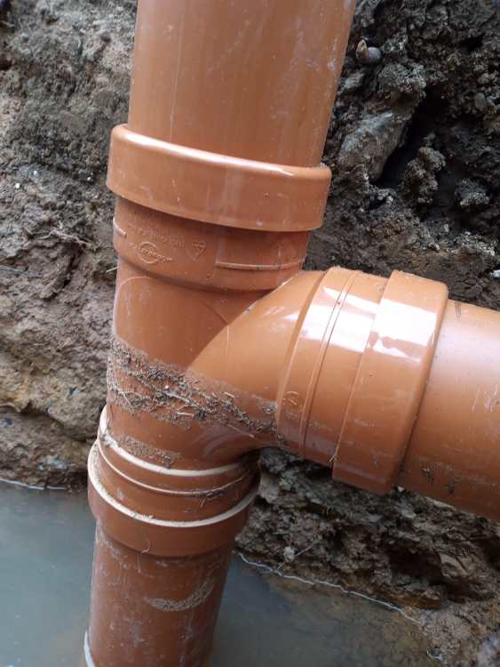

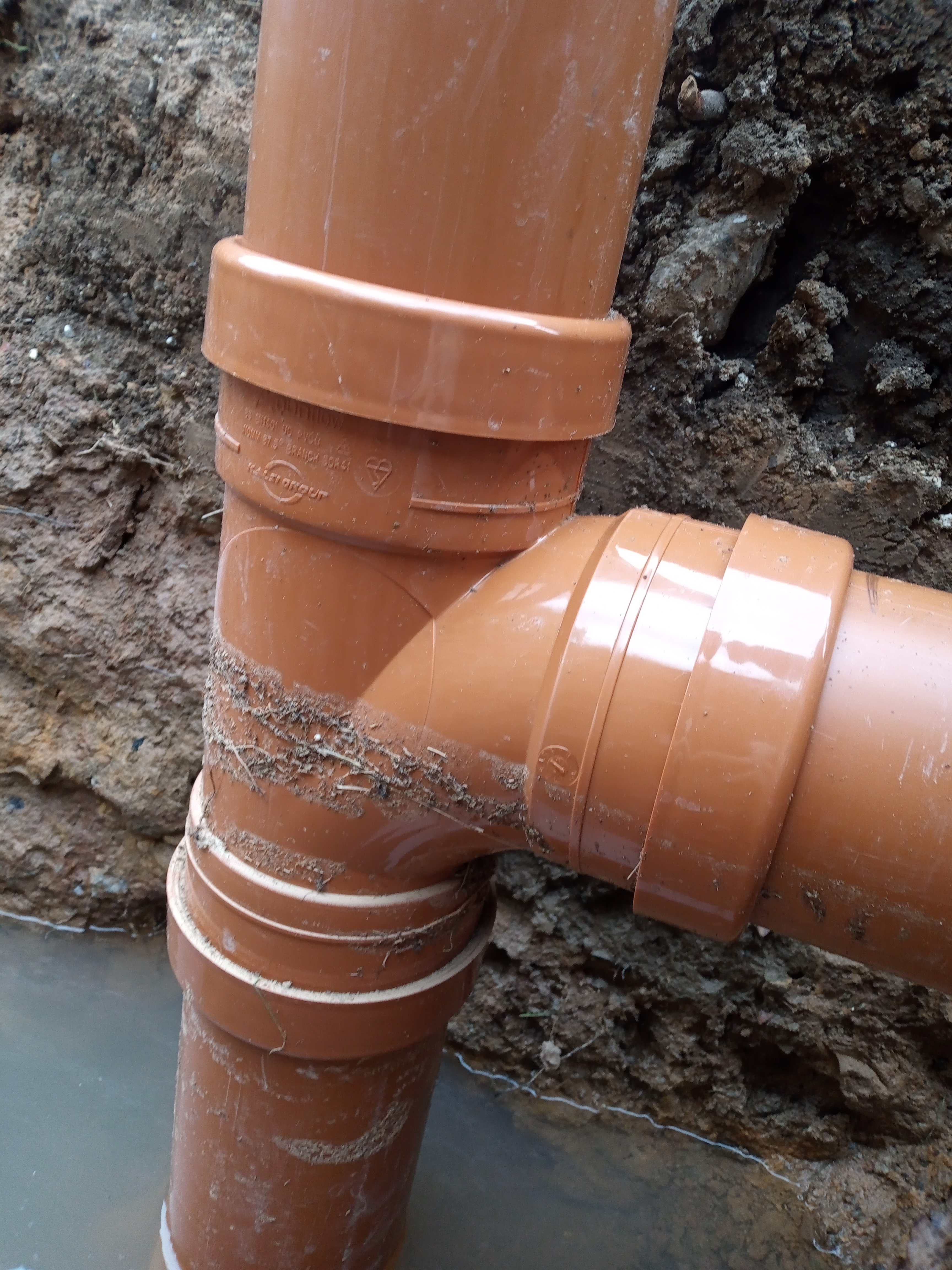

  4. Close up of the offending tee
  5. Hi all, Had building inspector out today and he wants this tee swapping for a long radius version. Essentially it's at the top of a small backdrop. The rest bend at bottom is just below the water. Does anyone see anything wrong with this? He says 'things' will get stuck at the sharp radius of this tee 😮
