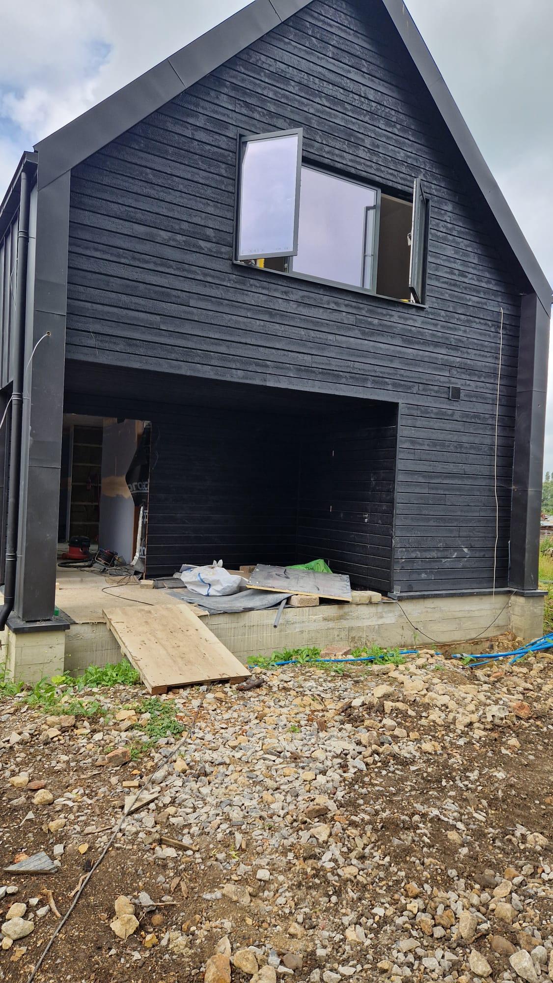

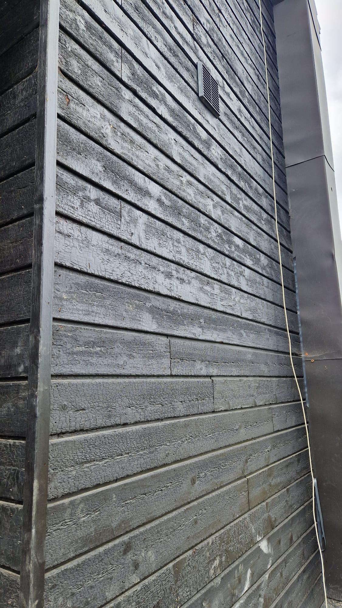

  6. We used siberian larch with a heavy charred from inflamed.eu it was cheaper than buying from the uk. I didn't find it hard to work and not too flakey. We nailed gunned it with stainless pin nails It's been up 4months and looks good so far. We have lots of trees around so it may weather overtime but we like a bit of character
