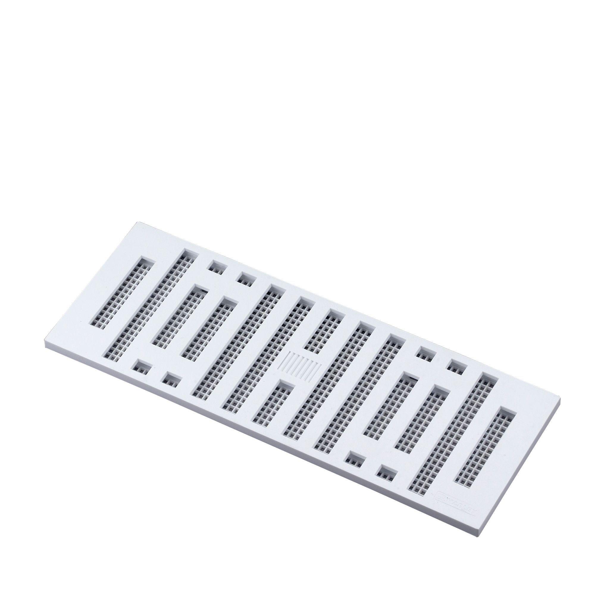

Hey there, Just a quick bit of advice from you gurus please 😀 I'm in the process of doing a bit of light renovation around the house, and was wondering if anyone knew whether I could buy this sort of air vent with a metal finish? Hoping to get something in brushed steel, identical to this (vent & mesh) Does anyone know of some good brands/suppliers to try please? in addition, it looks like these are simple pull/push fit, as there are no screws I can see. Is that correct? many thanks for your time 😀 Shadow

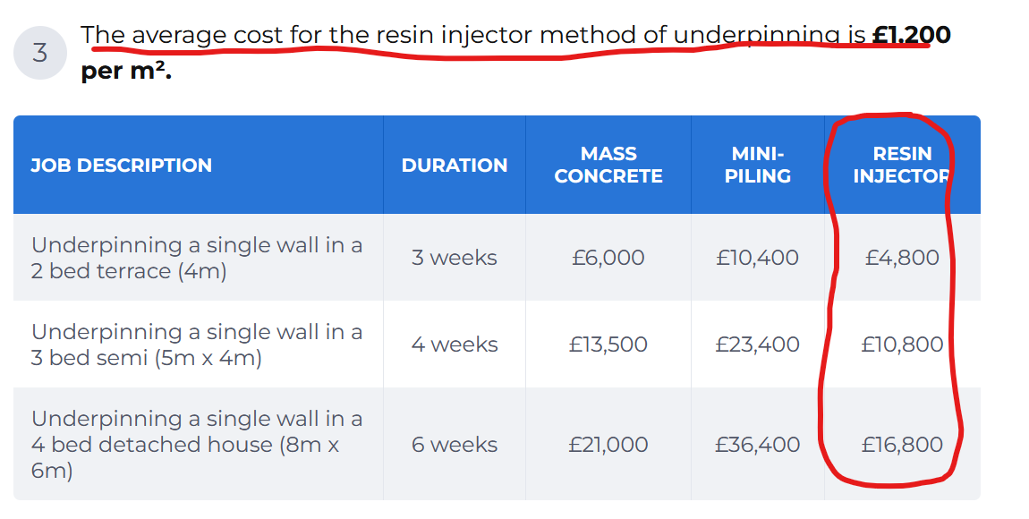

I have seen this approximate guide - not entirely sure, but i think the sidewall is probably 7m long, so likely to be around £15k for 1 wall.... Although saying that, at £1200/m2, kinda implies they will go 1-2m further than the wall itself? (it's the only way i can fathom £10.8k for a 5m wall 🤔) -
