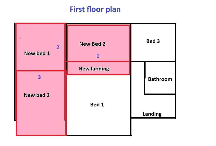

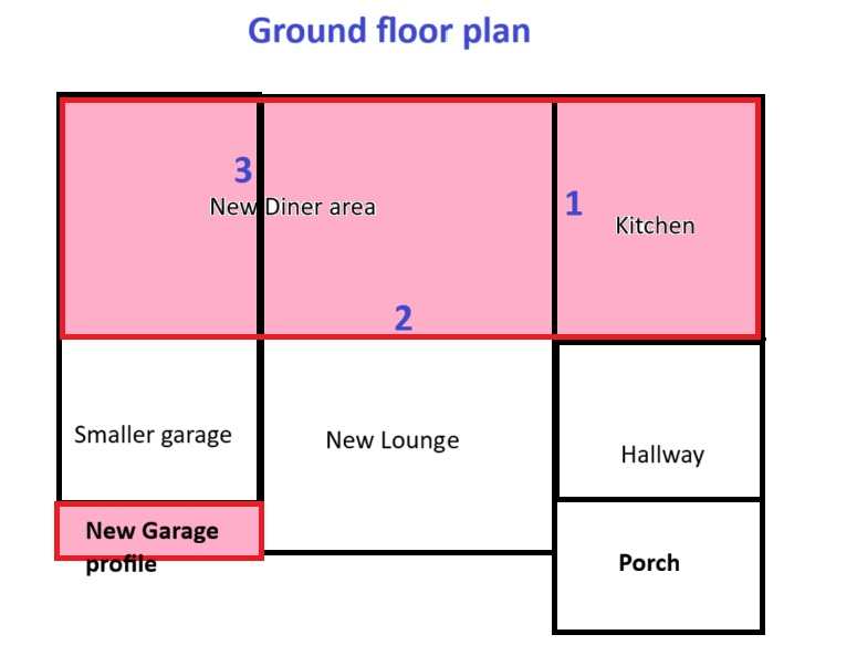

Hey all, Firstly let me say, this is not to bash architects (there seems to be some of that already! 😉), so im not here to decry their skills & service in any way... I'm here to ask a few fundamental Q's, please. So would be most grateful if anyone knows the following: Working with building control - as I understand, it's common place for them to be the linchpin in having each stage signed off till completion. But would you also expect them to mediate with the builder (as part of their standard fee), whenever challenges around cost, design or build materials/finish come up? I'm assuming they act as guardians of design & quality, so I'd expect them to push back if the builder tries to deviate from the plans... Also, has anyone known of using multiple architects in a project (eg, a fallout with the builder part way through construction, or 1 architect does the plan & another works with those plans till sign off)? I'm just curious as to how flexible architects are with using another's drawings or continuing where a previous one left off.... Apologies if these seek like dumb Q's, but I'm just furnishing myself with as much knowledge as possible 😀 Best regards Shadow

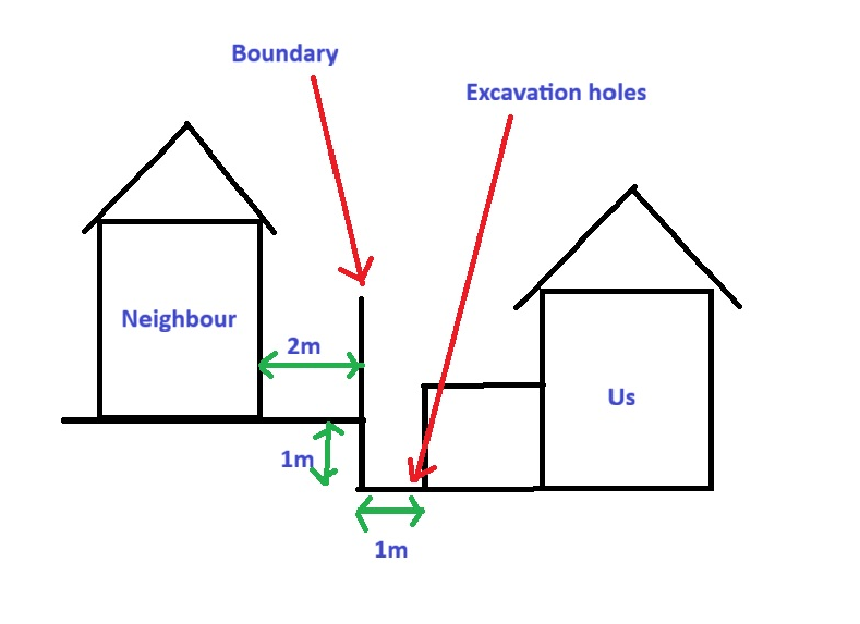

Thanks for your replies so far, guys Do you guys reckon our next step is to hire the prowess of a structural engineer? I'm afraid I wouldn't have a clue, as regards foundation depth/suitability If you think it wise, then I guess we could employ someone now & do this independently of the builder & architect -

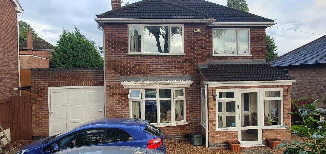

Spot ok, TBC - it's purely an arse covering exercise. But as you say, nobody can be sure yet There is 2ft of cracking right through the bricks in 1 area, which I showed them, that's likely the reason for their suspicion -

Hi there, I'm hoping one of you guys in the know can help with a few fundamental questions please 😀 We have a single storey (double brick, no cavity) garage adjacent to the house, that were looking to extend over, with a sloping tiled roof The architect & builder we spoke with viewed the garage & suspects the foundations might not be deep enough, & if this is the case suggested we may need to demolish the garage, ripping up the foundations & laying a new deeper foundation to start anew. The builder with him said somewhere around £20k for undertaking this We weren't sure if this sounded a reasonable price for a 8m x 3m, but I can't imagine it'd be cheap. It got me thinking: whether helical piles, or some other alternative might be just as good & a little cheaper? Obviously we'd need to consult a structural engineer 1st, if we consider this. But wondered if anyone had experienced similar with insufficient foundations & had any advice? Whatever happens, we'll only know once they dig down (the builder agrees nobody knows for sure till we excavate) But any up front knowledge for your genius is most welcome 😀 Thanks for your time Shadow

Hey guys - been a while since i troubled you good folks for advice. But that time is nigh again.... 😉 We're looking to extend our house next year (build over single storey adjacent garage & some internal room layout alterations). We're at the initial 'chat about proposed changes/ initial quotes' stage & struggled to find builders with the right credentials, or those willing to get in touch. So, i've been in touch with these guys, who dropped me a line: https://www.mastertradesmen.co.uk/ They've asked regarding PP, building regs, permitted development I wanted to ask you guys a few fundamental questions, please: Who determines what aspects of PP, regs, PD are relevant? I was under the impression the builder would consider this, but that may be a bit naive, and perhaps it's something we should ascertain independently up front? Architectural plans - are we best engaging an independent architect 1st, and getting this drawn up before engaging builders? Architectural costs - realise this is a 'finger in air' guesstimate, but does anyone has a rough idea what these might cost? (for an extension over garage, on a 3 bed detached property, with some internal room layout alterations)? If anyone has some good web-articles about the steps, process order, rough costs that would be hugely appreciated 😁 TIA Shadow
