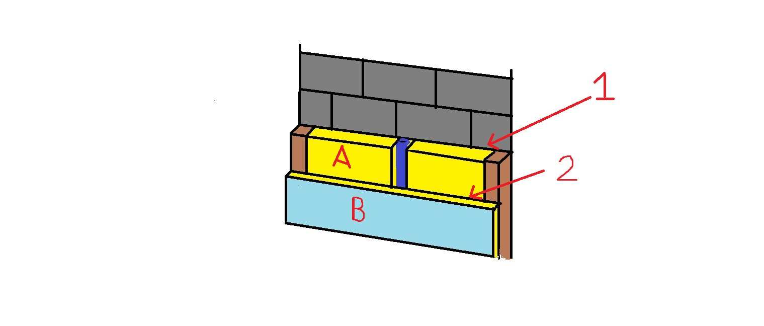

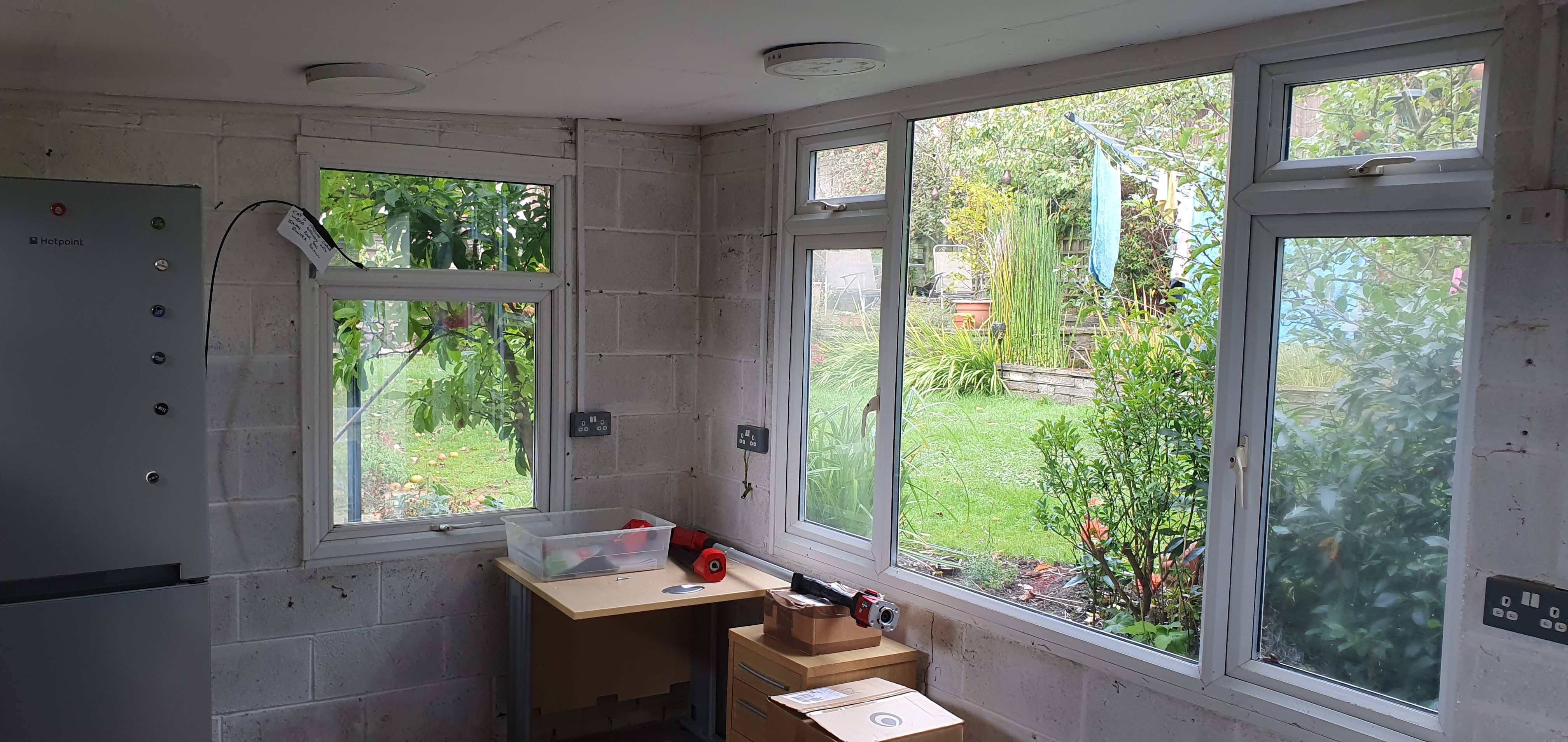

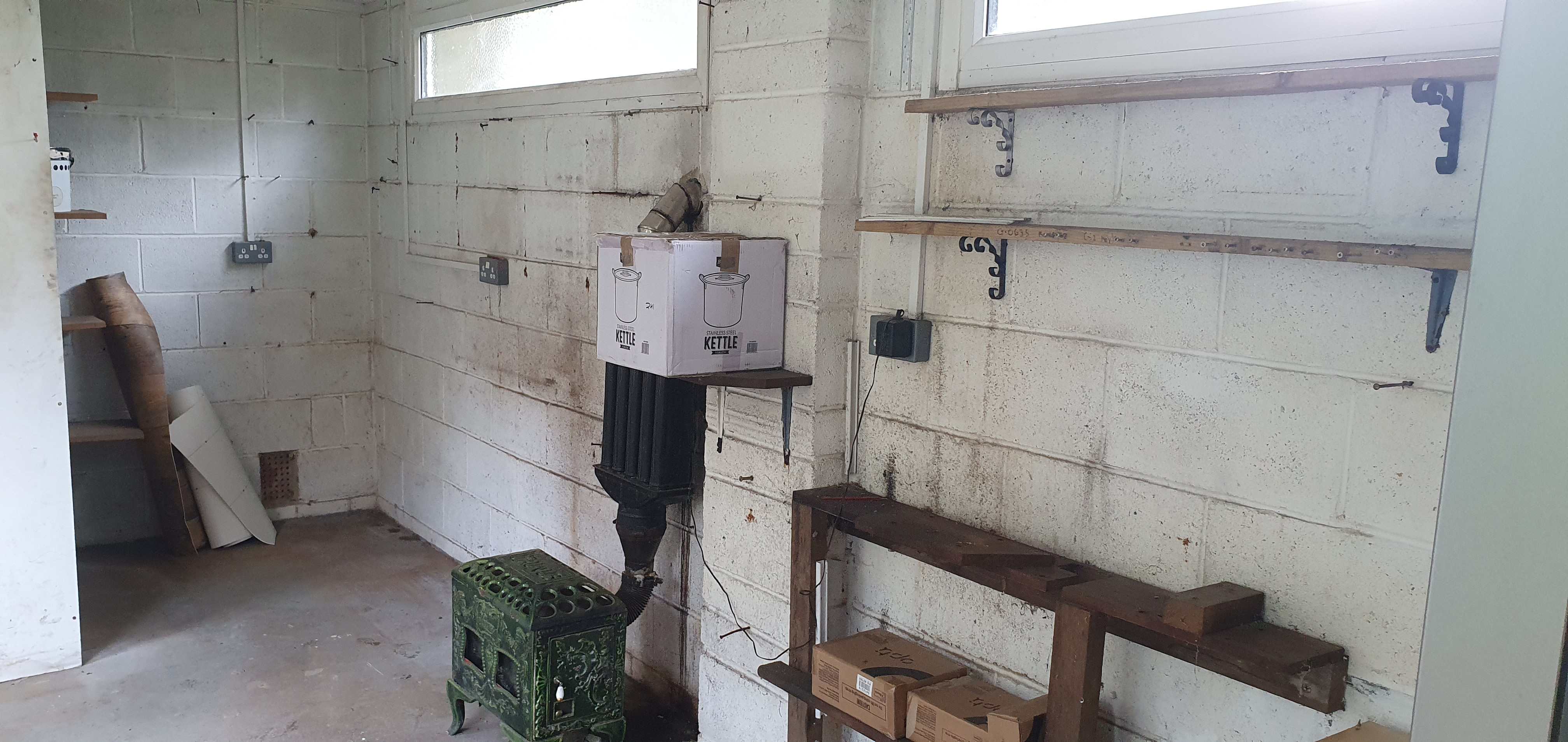

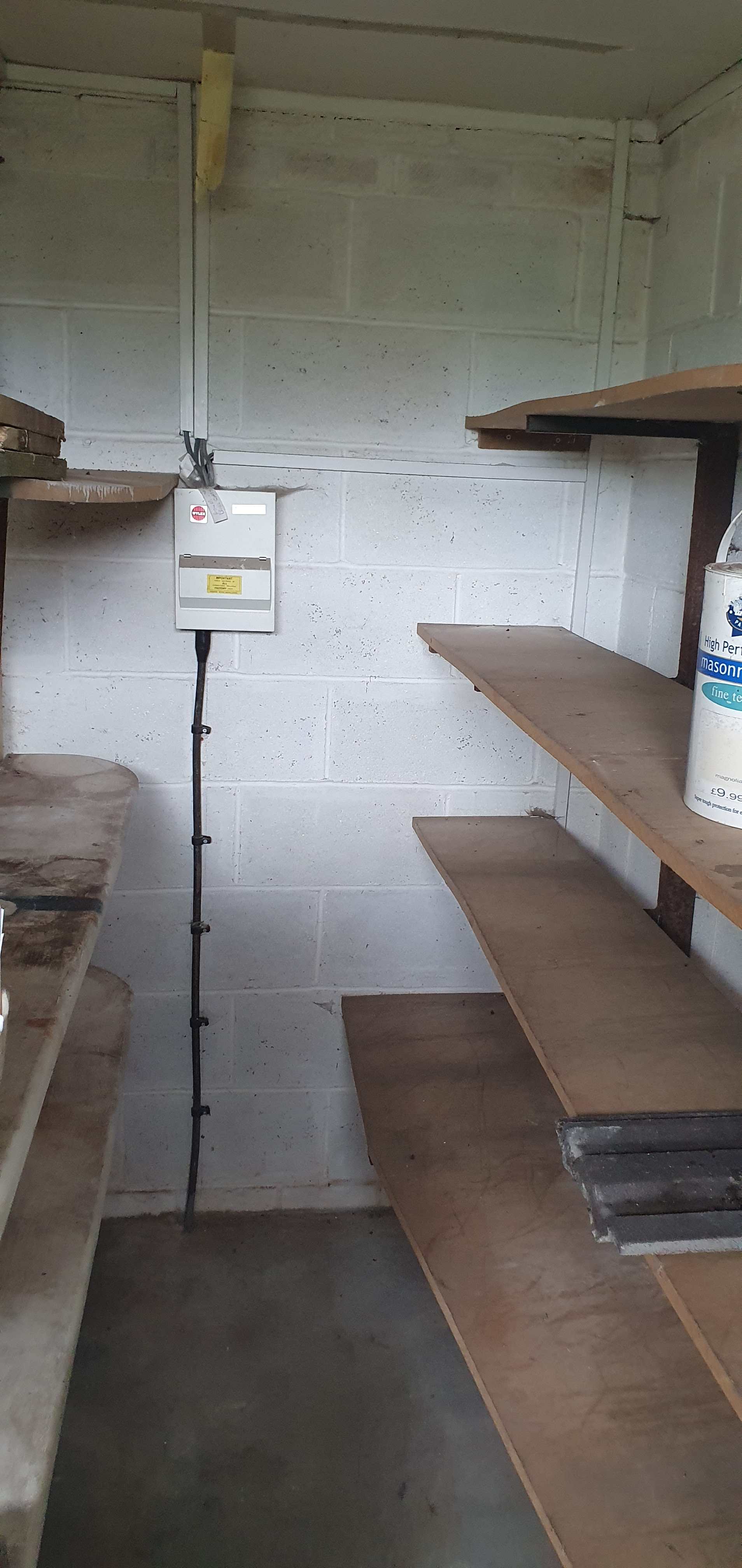

Great advice there, RB - many thanks 😁 Good point about the floor - i'd roughly guessed something like 25mm PIR and use Osb3 above it. Sounds like maybe adding another VCL layer between PIR and Osb would be your preferred method. Id thought about maybe 40mm battens, so i could sink the power outlets knockouts neatly into the plaster? I was confused (see other reply), about how these battens would be fixed above the PIR without piercing the VCL though....🤔 Another great point about the building regs, re keeping the log burner. I'll probably do away with it, if it requires building regs & stringent rules. Am i right in thinking i won't need building regs if i use a couple of wall mounted electric radiators? 🤷♂️ Thanks again Shadow
T Many thanks, Elite 😁 Probably a daft few questions incoming.... 🫣 Item 2 - would you dot n dab the PIR directly onto the painted breezeblocks? Item 2 - i could go all out and buy 100mm PIR, but hoping i could get away with 50mm or 75mm maybe and the heat not dissipate too quickly (seeing as budget is a big factor!) Item 3 - How would you fix the battens? I could use long screws for fixing the battens through the PIR into the wall, but seemed like making holes in the VCL could potentially cause vapour issues, so maybe adhesive grab is better Item 3 - presumably 25mm battens would be enough between the PIR and plasterboard? Saying that, I'd probably choose 40mm, so i could use 25mm socket knockout boxes with 15mm wood to fix the knockout boxes... 🤔 Most helpful buddy - definitely gives me a good insight into how to go about this Shadow
Apologies folks, if i'm causing more problems than ever, with these continual questions If it's easier: please feel free to point me to some diagrams/videos, that show how the PIR/battens/voids/vents/taping are all arranged and done for a similar sort of conversion (one without needing building regs, ideally) 👍
Thanks Elite - i wasn't sure at all about ventilation (where & what). Do you suggest having a void between the 2 layers of PIR, by way of using something like 70mm wood battens (to create a 20mm air gap between 50mm & 37.5mm boards)? I presume the 'reveals' are things like consumer unit and power sockets, etc? Apologies for the fundamental questions - this is probably quite obvious to the trained eye, but a big mystery to those without prior experience. All the videos on YouTube about conversion seem to conveniently skip this sort of consideration & many do it quite differently by the look of it. There doesn't seem to a generic agreed method/diagram for how to construct the layers 🙃
Hey Gus - tbh, it shouldn't need building regs (as it complies with rules exempting it). I'd not really considered it, as it felt like a lot of hassle for potentially little return. But i confess to being no expert, so don't really know how many hoops i'd need to go through and for what ££ benefit. I was aiming to use it primarily just as an office, rather than up the spec to something a person could sleep in (for example)

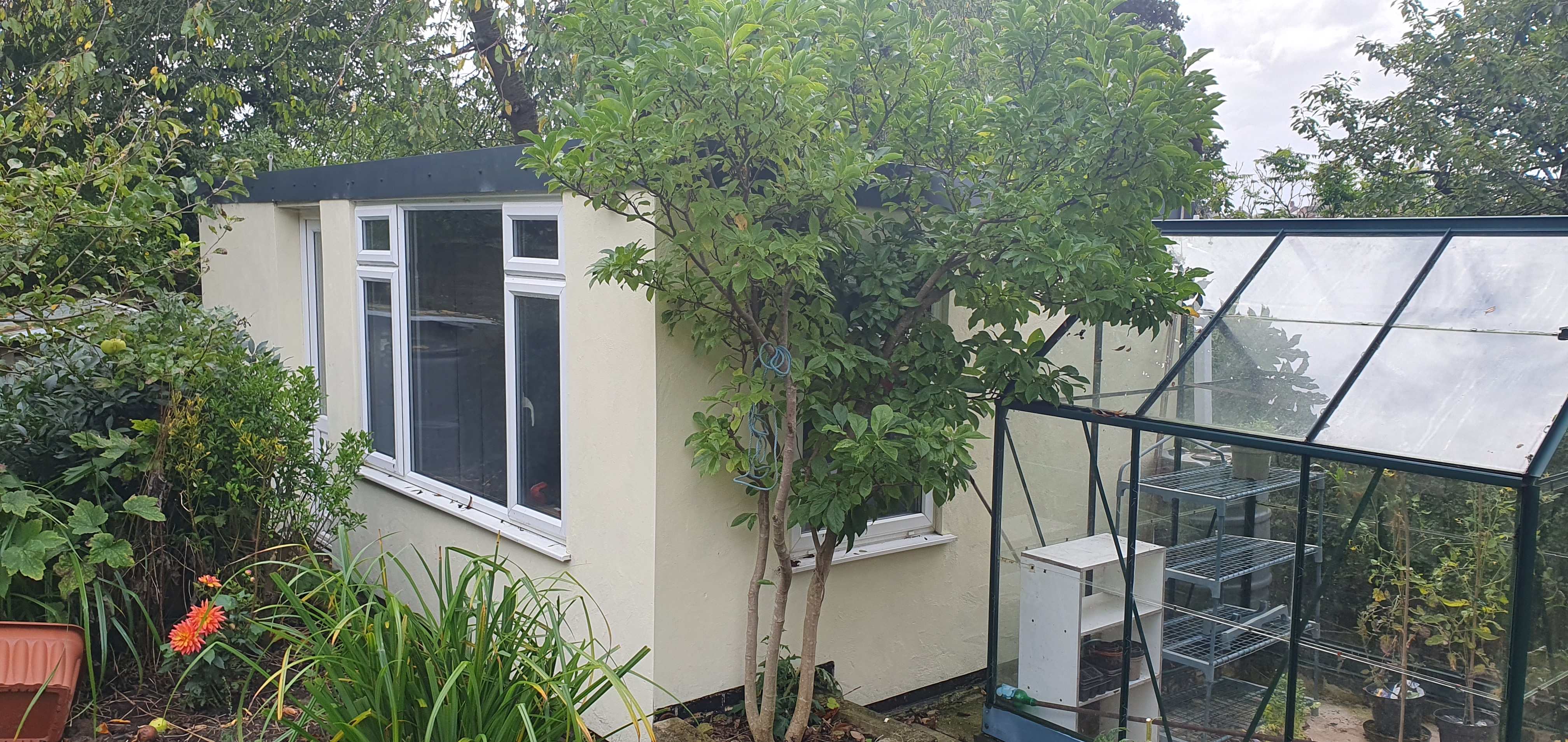

Hi there, I'm after more of your wonderful wisdom. Appreciate there's loads of similar threads floating around on, so apologies if this is stomping on well trodden paths... We'd like to convert our outbuilding at the bottom of the garden into an office, and wanted your sound advice on the type/approach of interior insulation, please. We've researched this a little so have a basic idea of what is required, but wanted to glean your knowledge if possible - the advice we're after is mostly for the walls, but any general advice is always more than welcome 😁 A little bit about the building:: 6m long x 3m wide x 2.5m high with metal sloping roof & solid concrete floor Appears to be single skin 100mm breeze-block with (i think) painted on the inside & with monocouche rendering on the outside. It has 3 upvc double glazed windows and upvc door Used to be a workshop (has plenty of power and it's own fuse box/consumer unit) From what i can see, the ceiling is already insulated (to an unknown depth), so our prime focus is walls & floor It has a wood burner with metal chimney leading to the outside A little about it's desired usage: Primarily an office - so used 8 hours or so during the day , throughout the year We'll add electric heating as required If at all possible we'd like to keep the log burner (if this isn't going to cause flammable issues with PIR/Insulation?) We'd like to be reasonably budget friendly, so get the most comfort/heat for whatever reasonable price we can afford Mock up of proposed wall insulation I've enclosed my initial plans for the wall insulation Vertical wooden battens 1.2m apart, using 50 x 50mm wood Item A- 50mm thick PIR boards (foil backed), sized 2.4m x 1.2m, arranged vertically Item B - 37.5mm thick PIR boards (25mm + 12.5mm plaster finish), sized 2.4m x 1.2m, arranged horizontally No air gaps between wall/item A or item A/item B Blue item - electrical tube trunking for sockets, cut between 50mm PIR boards cut through 37.5mm, where sockets will be As yet - unsure whether to install a damp proof membrane (if required with foil backed PIR?), and if so whether to insert for at 1 (between wall and 50mm PIR) or 2 (between 50mm & 37.5mm PIR) on the diagram? No idea what to do with the log burner (if it can stay without an undue fire risk, which i strongly doubt) This is something i'd really love to get to grips with in the new year, but realise it needs some strong advice to get off on the right footing Many thanks as always for your time Shadow

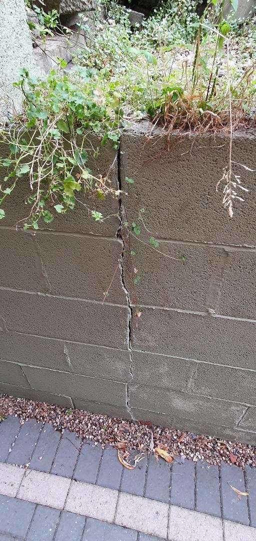

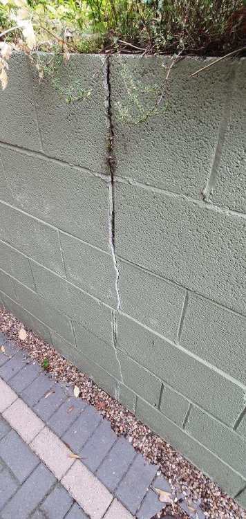

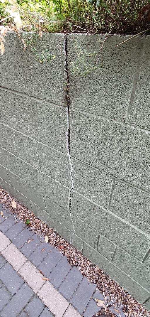

Hey all, I'm back once again, for more of your amazing advice please folks 😁 We purchased a property back in July 2024 and have since noted the adjacent retaining wall (to property below us) has a few large worrying cracks in it (see pics). The neighbours have said these have been there for decades, but seen some movement in the past few years. The wall is approx 8 meters long, 4-5ft high & made from concrete hollow blocks. Apparently our previous owner built it decades ago & reinforced it with posts/piles to make it sturdier. I've include pics of the cracks and view from our land above it (pics 1-3) As this feels slightly more specialised, we'd be grateful for any nuggets of help you guys can give... 1 - From recollection, i don't think this was picked up on our Lvl 3 survey. I'm not sure if this is a concern per se (something omitted by mistake), as the wall is not easily viewable 'down to the property side', but wasn't obstructed from view 2 - Our title deeds/plan don't show a 'T' for this boundary. However, i've read that it's generally assumed owners on the higher land side (and it's also right side boundary from street view) shoulder the responsibility for this. So probably not reasonable for us to ask neighbours to share repair costs for 3 - I'd imagine we'd get a structural engineer in 1st. But would anyone have a clue to whether repair or completely replace, yard stick costs m2 (prices vary wildly online - from £150-£300+ per m2, depending on material), suggestions for type of wall to consider? (interlocking blocks seem like a good option - as per pic 4) 4 - What would be a reasonable length of guarantee for this type of work (guess it depends on material used)? 5 - has anyone had similar experiences of this sort of scenario? Any hints/gotchya's to consider during this project Apologies for the verbose thread, but a lot to get through..... Many thanks as always for your time Mark

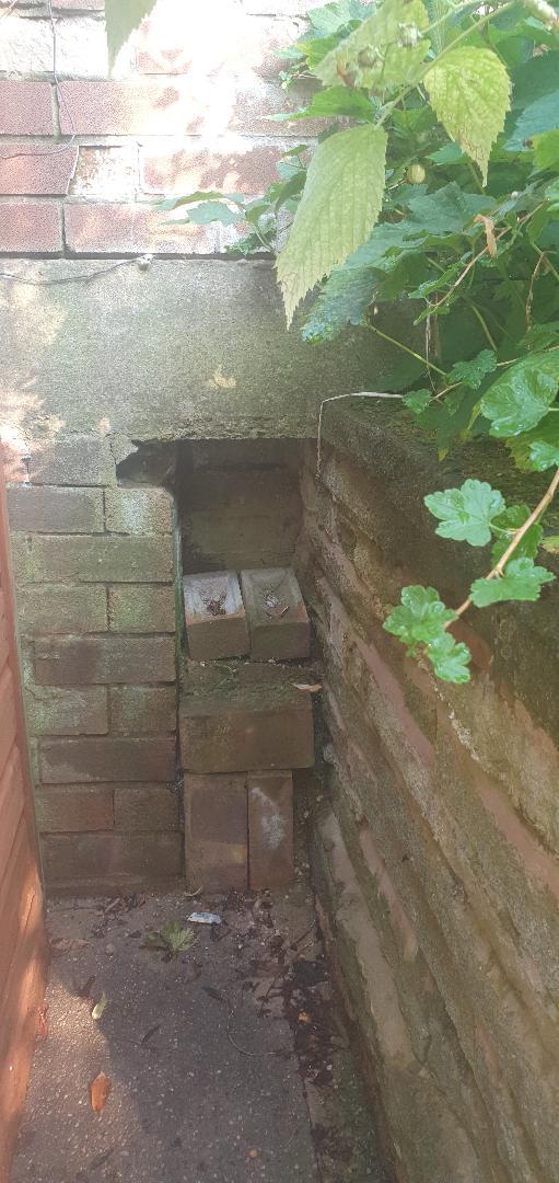

Thanks guys - you're quite right: it's at the back of the house. The bit above the hole is a concrete beam, and above that is a raised pathway. I will take a look to see what's behind the loose bricks, but if nothing then just brick it back up Thanks for your input -
Hello again, all you helpful folks out there 😁 Another question for you guys, if you wouldn't mind sparing 5 mins of your brilliance please.... As mentioned on another thread, we've recently bought a new house, and currently finding all the 'hidden joys' you typically do when starting to live there. In our back yard i recently came across this 'hole' in our wall, and wondered what the best way was for me to repair it. The concrete above is a thick beam, supporting a pathway above, so it makes sense to make this as structurally sound as possible. It's seems sturdy enough right now, but these things only become more precarious over time... What would be your guys thoughts for plugging this hole? My thought was just with good old bricks & mortar - starting at the bottom upwards. Then really pack in the cement for the last 2 levels and wedge the bricks into that, so it dries compact & able to support the load Many thanks for your help - very much appreciated 👍 Shadow

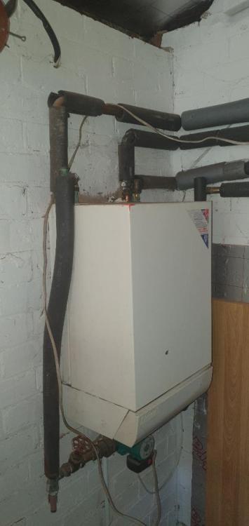

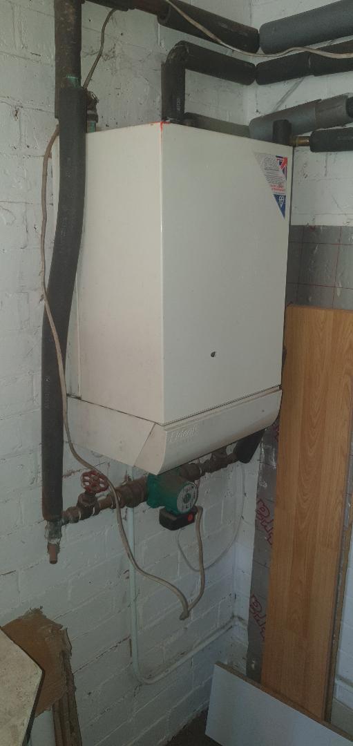

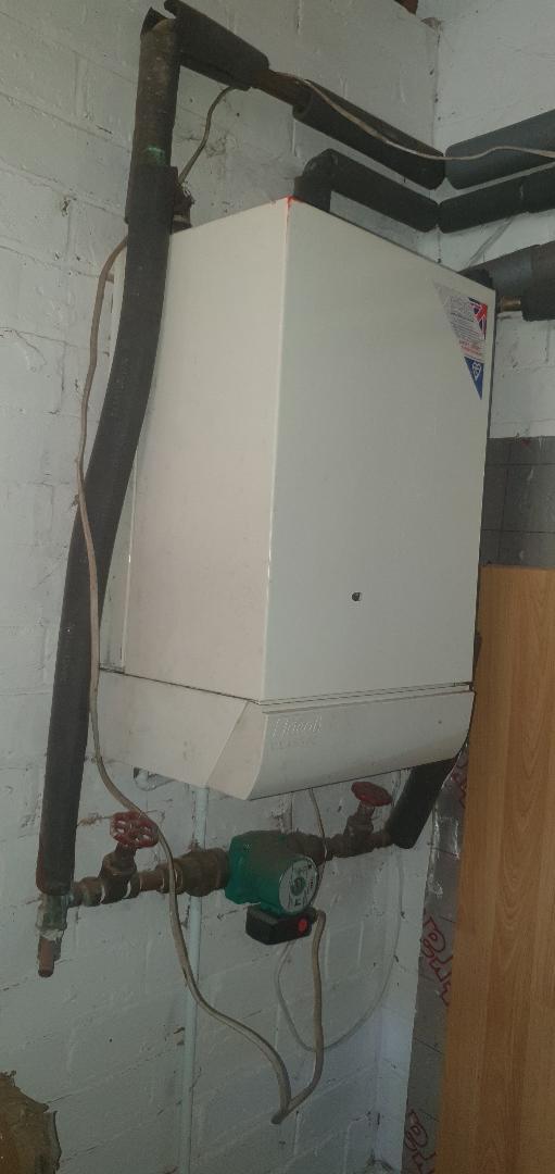

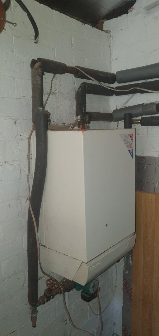

Hey all, Another day, another question - hopefully a nice easy one to ease into the weekend..... 😁 We've just recently moved into a new home, and noticed the central heating comes on whenever we want to heat the water via a gas boiler. Reading up on this it's pretty standard for gravity fed heating systems to do this. I've also read that installing a pump to the system will allow independent control of hot water & CH - very handy thing to have in this weather! 🥵 Looking at the boiler below, i'm pretty sure it's gravity fed (4 pipes in/out are a giveaway apparently?). However, am i right in thinking this system already has a pump attached to allow independent control? If so then perhaps it's the control panel that needs updating (a very old Horstmann Centaur44 🕸️), as this seems to only allow us to set hot water & CH combined My questions for you great guys are: 1 - can you tell from the pics if this seems to be gravity fed? 2 - if so, isn't that the required pump shown below to allow independent control? 3 - would getting a new control panel & pump (if not working) perhaps be the easiest way to achieve independent control? We will in time replace the antiquated system, once funds are a little more flowing and other jobs taken care of. Right now it's a shoestring budget approach to improving how it currently works. We will ofc get a qualified plumber out to look, but thought it good to be armed with some knowledge up front so we don't appear to be the duffers we really are! 😅 Many thanks for your time & help with this Shadow

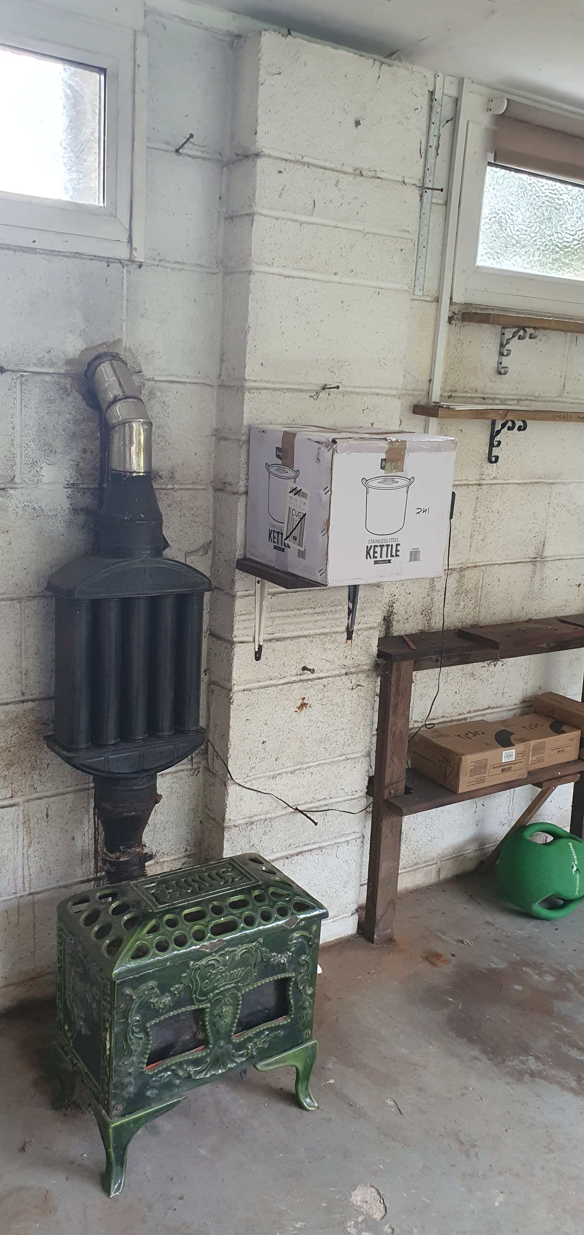

Hey again - hopefully just a basic quick question, for all you guys in the know 😁 The house we're hoping to buy has a detached outbuilding at the bottom of the garden, measuring 6 x 3m, with 2.5 sloping metal roof. It's >1m from property boundaries & generally non combustible (singke skin breezeblock walls, concrete floor, metal roof, upvc door & windows). It's a workshop, with electrical power & own consumer board, plus small log burner/ metal chimney I was looking to convert into an office (non sleeping accom) myself, by just adding PIR boards and adjusting electrical sockets over this. Would this incur building regs, and if so is there a portal / consultation service I can use for clarification & sign off?
