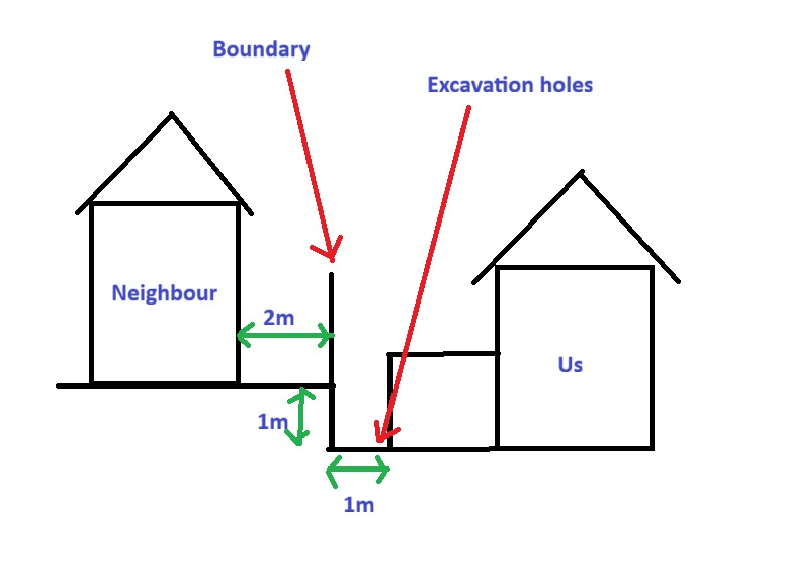

On another front, one of the architects replied to me, stating his party wall surveyor friend says that it's 'an unwritten rule' that exploratory pits generally don't require a PWA in place I've no reason to doubt him, but couldn't find anything around this. I definitely won't be rushing into anything, as its likely he's not privy to their potential location They would be within 1m of the boundary & approx 3.3m of the adjacent house

Yeah, i suspect you may be right. There is a rule about drawing a 45' line from the base of the neighbours foundation (where 3-6m from neighbours house), and if your digging/foundations do not cross this line then you don't need it. However, the crux of this is knowing how deep their foundations go, and i think some just take the 45' line from the ground surface to be on the safe side. I'm not 100% sure on that last bit though
Hey all, Thought i'd quickly ask you guys for your thoughts on the following please.... When digging 2 foundation exploratory holes (to check existing foundation depth) near our boundary, is a formal party wall agreement need to be in place, prior to excavation? The holes will be 50cm x 50cm, to check the depth of our garage foundations (so possibly be 1m deep or more). These would be within 1m of the neightbours boundary wall, and their land is 1m higher than ours. We want to keep on good terms with the landlord/tenants next door, so would notify them anyway. I just wanted to check whether we'd definitely need a party wall agreement in place prior to digging the exploratory holes, and whether it should be a formal document prior to commencing? (i suspect we will need this, but wanted to check my understanding is correct)
