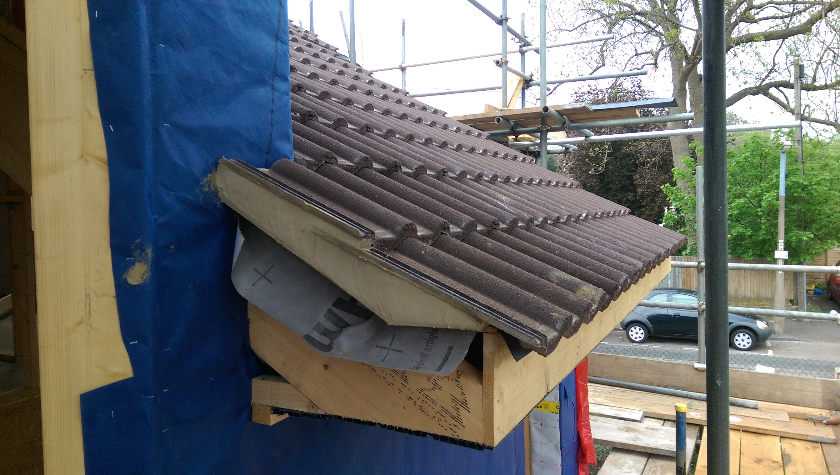

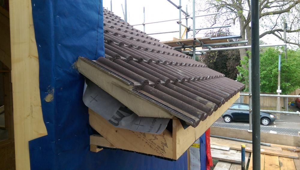

Thanks onoff They are double roman Redland 50s or Marley I've now gone back to the conservation and planing officers, asking for a meeting on site (they seem to like that sort of thing) I'm not happy about second hand tiles, am going to suggest a different covering altogether!! Me thinks
Ok... Width is 3.4 (length of of one side is 2m to facia board)...so going by what you said...it's too much Back to square one...any double roman out there?? Thanks again Ian.
Hi Ian, Not thought of that, adds about £260 to the job though, Mmmmmm wonder why Redland/Marley with same shape/ style, can go so low? Now you've got me thinking...would timber firing pieces be more reasonable? Any idea the difference between 22.5 and 30 expressed in measurement?
I have recently been afflicted with the current concrete roofing tile shortage! To finish the garage roof I have sourced a Sandtoft Concrete Lindum Interlocking sandfaced/granular tile (the supplier ordered them last year) The specifications say the lowest pitch is 30°mine is 25.5° Originally I had allowed for Redland which allowed a lower pitch. BIG question will they still function OK? P.s if anyone has 340 double roman in brown granulated spare let me know Thanks David.

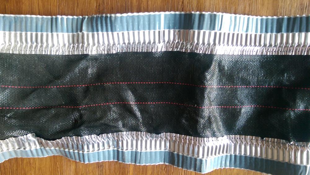

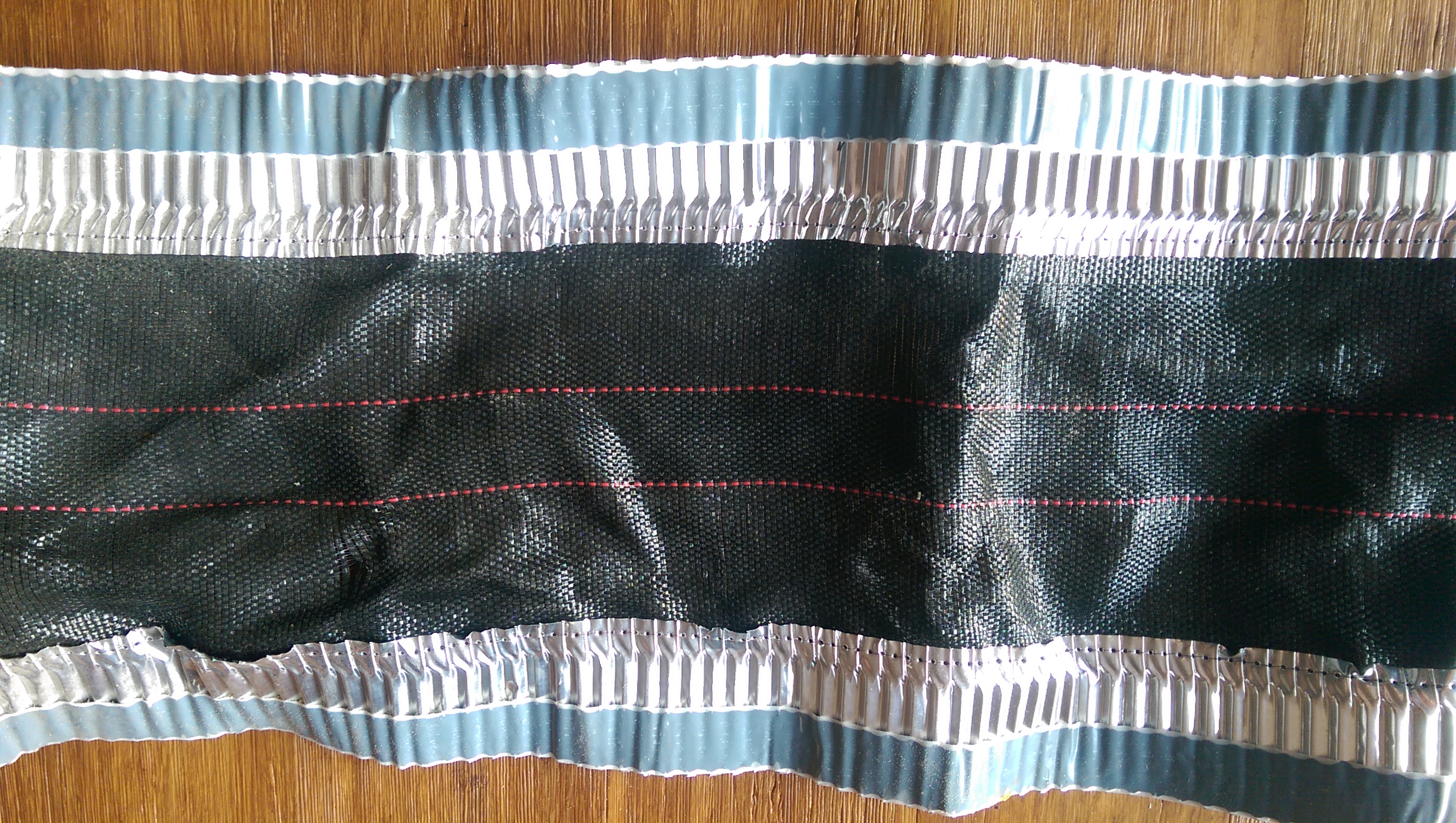

How does a dry ridge work? (That's what I've got) does it breath a little? Seems a little see through, would air be able to escape I wonder? In an hour I'm venturing up in the roof space, I will check the temperature of the ducting in the insulation Thanks Jeremy

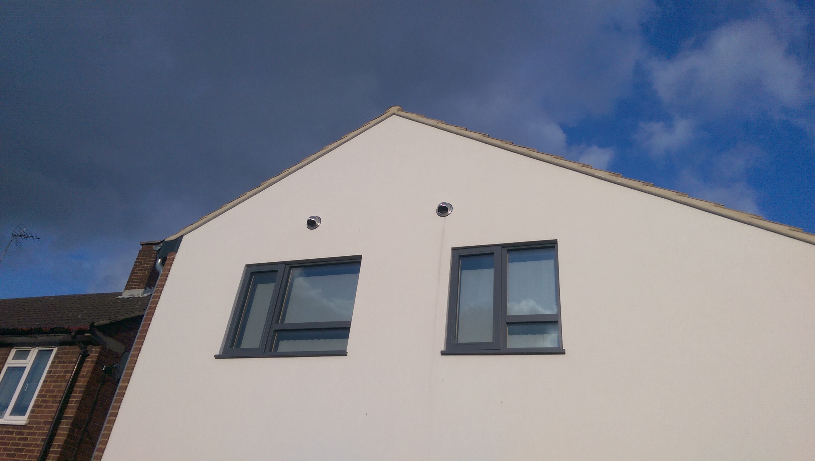

This may help... http://www.permavent.co.uk/cold-non-vented/ I'm thinking of adding additional ventilation via the gable end wall

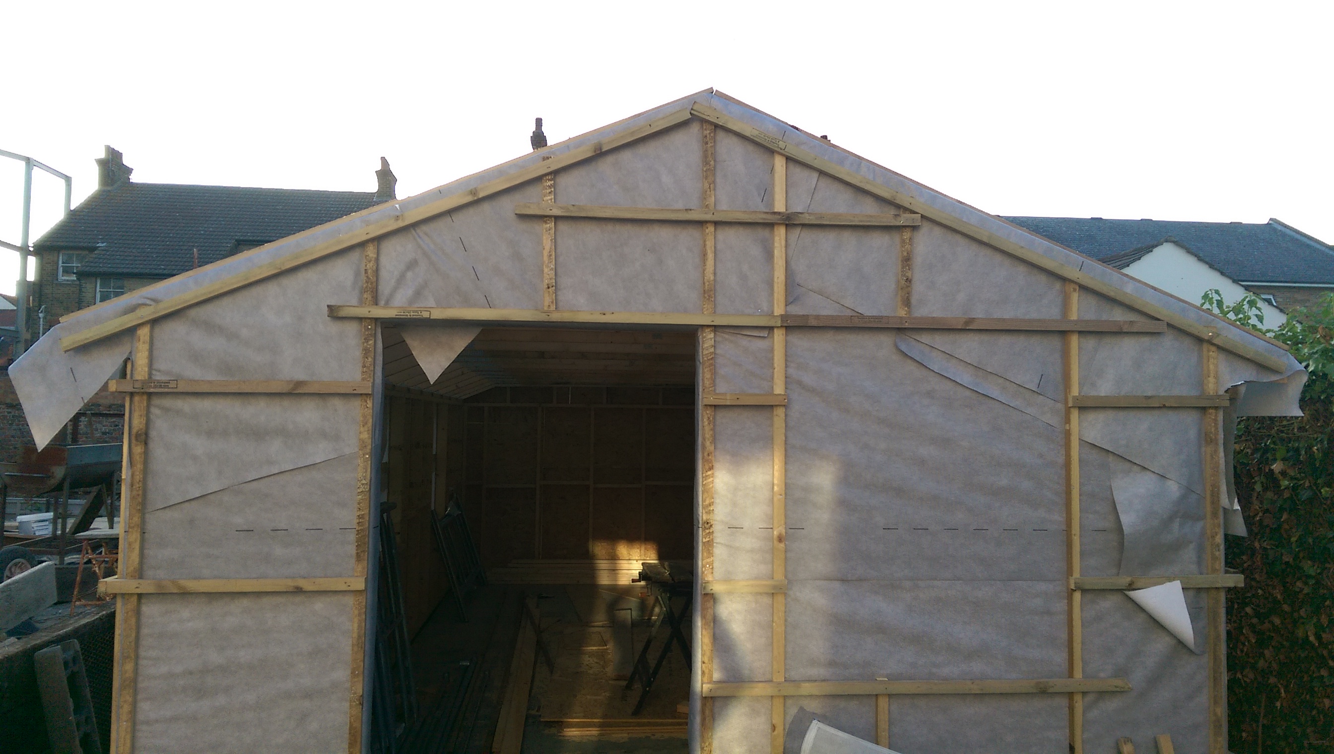

Hi all, just to clarify...under the tiles is a breather membrane, then roof void (cold roof), on top of ceiling 300mm blown insulation, in the insulation runs the main incoming pipe (4meters) for MHVR which also has its own wrapped insulation. I have Redland 50 double roman tiles with a bird protection brush, would these allow enough air under tiles? Would this be recognised as well vented?...or should there be additional vents inserted? Attached shows tiles and (small piece) breather membrane.
