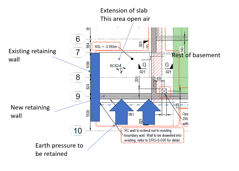

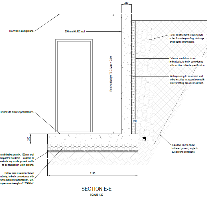

There is rebar yes. I don't doubt all that is necessary for this concept where the 2m section of retaining wall beyond the edge of the basment is structurally integrated, and it may be the best solution, but it can also be done by freestanding sheet piles for example, so I just want to get a feel for any other options. For example I could have a separate retaining wall for that 2m wide section using something like this:
I have a walkout basement as the house is built into a slope. I need to retain the earth between one side of the basement and an existing retaining wall on the boundary, approx 2.5m height of earth. My structural engineer has come up with a design which extends the basement slab and one of the basement retaining walls to the boundary. It just doesn't look quite right to me. My concerns are mainly: rain water splash back from the extended slab, particularly as there is a door threshold and external insulation/render with no ventilation cavity. thermal bridging (not too concerned as just one corner) This is the plan view: This is the section view I don't want to just say "I don't like it" because maybe i'm wrong and this looks fine to others. I will also get the view of the builder. I'm just wondering what the general thoughts are as to whether it is a detail that will cause issues in the longer term and whether there are any ideas for improvement that I could take back to my SE? For example, the cowboy developer next door is retaining the same earth with sheet piles bashed in using a digger bucket. Not an approach I will take but does show that there may be other approaches.

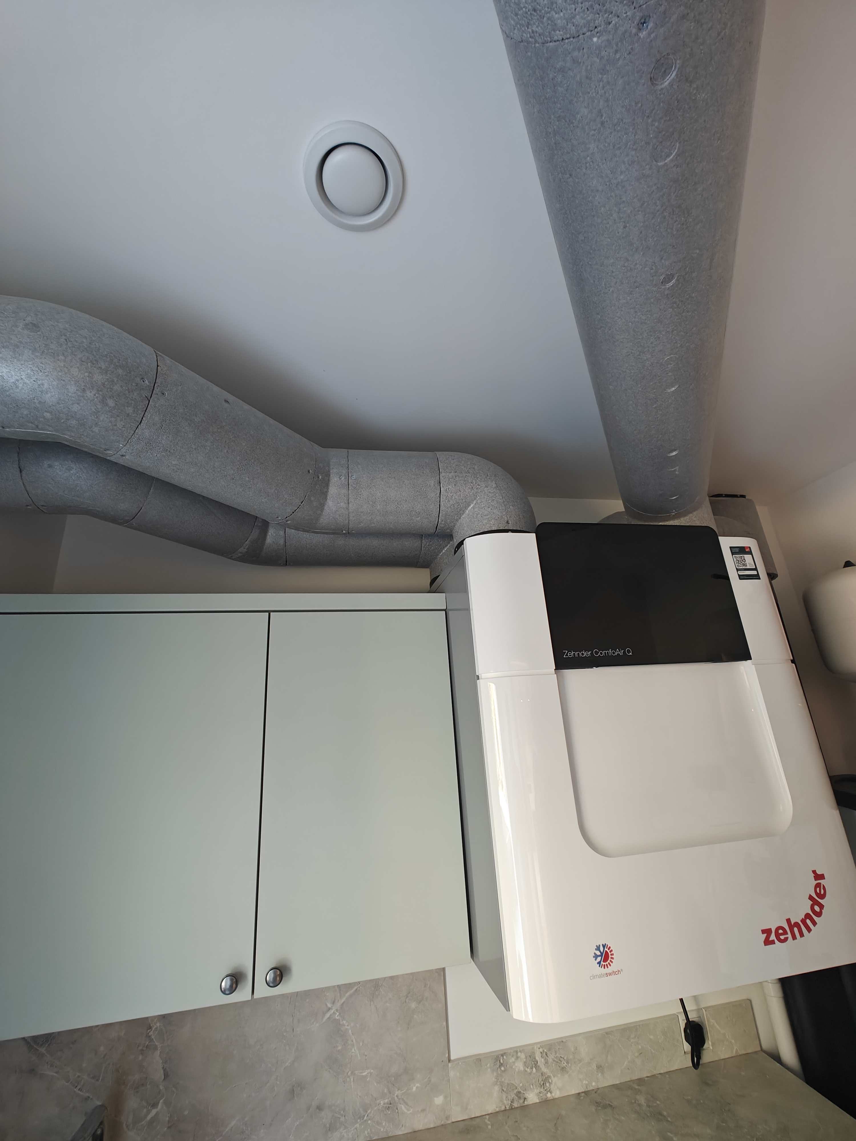

Anyone had a Danwood build without an MVHR?
Ed_ replied to worldwidewebs's topic in General Self Build & DIY Discussion
I'm going to be building a Danwood house. Some things are flexible and other things definitely aren't and it is difficult to tell beforehand which will be which, they have a build system and that is that. I've attached a photo i took of the system in a completed house I visited. -

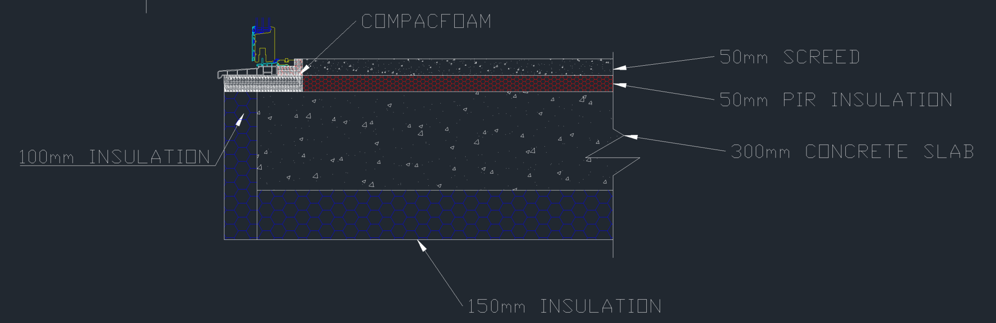

sliding door threshold detail with external wall insulation?
Ed_ replied to Ed_'s topic in Doors & Door Frames
Thanks @Russdl that is great, it looks like a sensible detail and I'll probably tweak mine to copy it. That GRP angle will hopefully also deal with the issue identified by @craig. Thanks everyone, really appreciated. -
No, I haven't selected a manufacturer yet, but thanks for the tip. -
It is not finalised, but it is a combination of me and my structural engineer. The rationale is that it is a walkout basement and the detail between the basement and the timber frame that makes up the top two floors means I can only have 100mm of external insulation on my basement walls (unless I step it out below the plinth, which I don't like the idea of), which is probably not quite enough, so I'm bulking it up a bit with 50mm internal Insulation (it would be enough if it was all basement, but it's not enough for the sections which are above ground- about 50% of the wall area). Under the slab will be 150mm, just because, so there is probably no need for the 50mm internal insulation there except I'd rather thermally isolate the screed a bit more from the concrete slab as the walls will be colder than the floor. Does that make sense? All thoughts appreciated, it seems like the best compromise of quite a few aspects to me but I'm not an expert... -
Thanks everyone for your thoughts, only just catching up. @craig whilst the compacfoam does rest on the EPS and concrete, the track of the sliding door is above only the concrete so the load path will be directly down through the compacfoam Into the concrete, the compacfoam will see no bending and the EPS will see essentially zero load from the slider. I could adjust the compacfoam so it is only on the concrete but I see no advantage to doing thay- the compacfoam should help spread any point loads from the sill. Or at least that's what I'm thinking, maybe I'm wrong? @Nickfromwales is the EPS the frame rests on integral with the slab Insulation? My concern is that mine probably will not be, and therefore may move somewhat Independently of the slab. And then I worry about the DPC, probably because I don't understand the detailing. @Russdl I'd love to see any more details of the GRP and it's fitting if possible. -
I'm struggling to find a good way of mounting my sliding doors, given I will have 100mm of external wall insulation as the outermost part of my wall buildup: I think the door track needs to go over the concrete slab, for strength, which leaves me struggling to protect the 100mm of external insulation. An extended sill seams like the best idea, but I can't really find any of these being offered, perhaps i'm not looking in the right places? As drawn i'm envisaging a wide sill that bridges the concrete to over the insulation, sat on compacfoam for a bit of strength to spread point loads, with the sliding door track set ontop of that. However I can't find suitable sills and i'm not sure if this arrangement would still put undesirable forces through the external insulation, for example when someone steps on the sill. Are there any other ways that don't introduce big thermal bridges?
