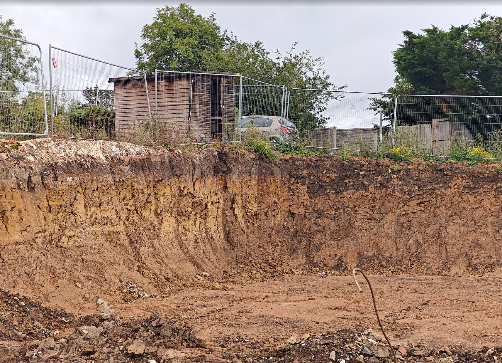

  6. I likely need to pile one side of my basement as can't batter back. Will be CFA piles in concrete. I would like to use external insulation, mainly to avoid cold bridging at the ground floor slab. If I have a line of piles, can I place insulation against that, then cast concrete against the insulation? Is that practical? I know concrete cast against piles is fine but can't get my head around what happens with insulation in the mix as well. Any experience gladly received!
  7. About 2.5 weeks is the stand-up time it appears, it has now started to collapse! Nice to know I wont be spending money for no reason.
  8. I'm 1m to the boundary. The current neighbour building is 2.5m and new ones will be 1-1.5m. Many reasons for a basement: More space - urban plot so footprint limited. Ground slopes- front is 2.5-3m above back, basement spans this slope so GF is ground level at front and basement is ground level at back. I have made ground with possibility of a slightly mobile slope so would likely have needed deep foundations anyway. As it is walkout it both becomes cheaper to build and more functional than a traditional basement. Hopefully.

  11. @Pendicle How did you assess the slope angle?
  12. Learn something new everyday, rubber duck excavator! Would you mind sharing details of the piling firm you used with me? I don't think I'm too far away.
  13. I've looked into kingpost, but at first study it looks like being no cheaper. Still have to mobilise the piling machine, piling mat etc. Additionally probably need a crane because how else do you get an 8m long steel into a narrow hole, then need to pay for concrete for the panels and probably some sort of gravel to back fill the reverse side... Seemingly everywhere i look people (professionals even) are doing this sort of thing without a retaining structure, are they just risking it or am I missing something? I don't intend to just risk it.
  14. I am excavating a basement and due to the confined plot there is not enough room to batter back at what I believe to be a safer battering angle, which seems to be 45 degrees at best from any seeminly scientific source I can find, therefore I had imagined I had to create a retaining wall. Said retaining wall, in piles, is going to cost in the region of £30k. What is giving me pause is that almost every picture I see on industry website, e.g. waterproofing specialists, shows bare earth battered at 60+ degress and seemingly without any safety measure, for example: And then the neighbouring plot to mine have done almost the identical excavation to me, and left it like this: I see how this could be safe whilst excavating with a digger, as no one is in the collapse zone, but how about doing any work under it? To me, it seems unlikely the bank would suddenly collapse, it will probably be fine, but thats not good enough when the consequences could be death? Just looking for views and experience on whether there are ways for a contractor either to safely build a retaining wall behind this or to erect shuttering for a basement, or whether my gut feel that it has to be a proper retaining wall or similar is correct. Thanks!
