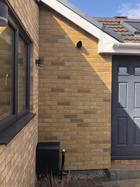

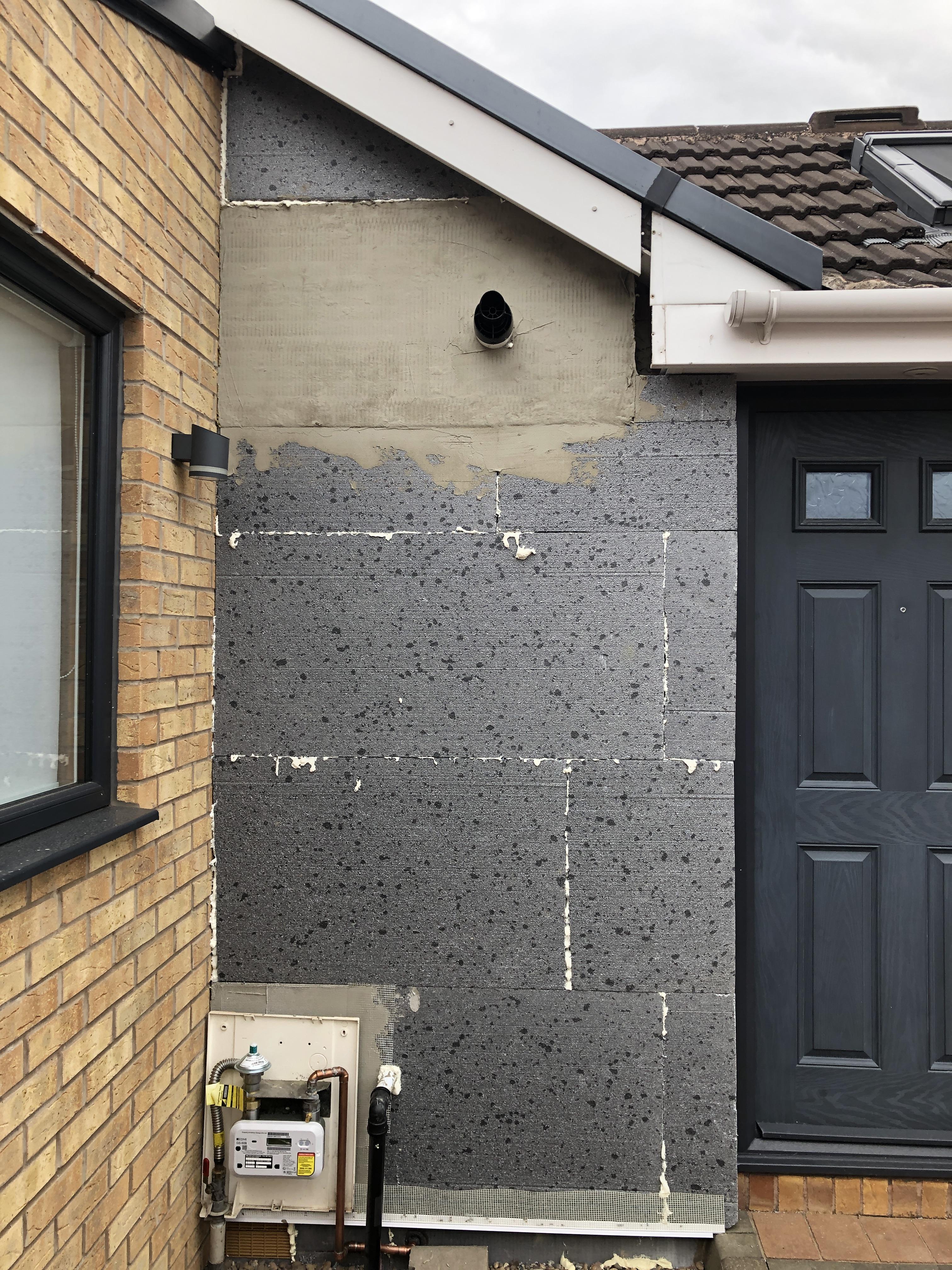

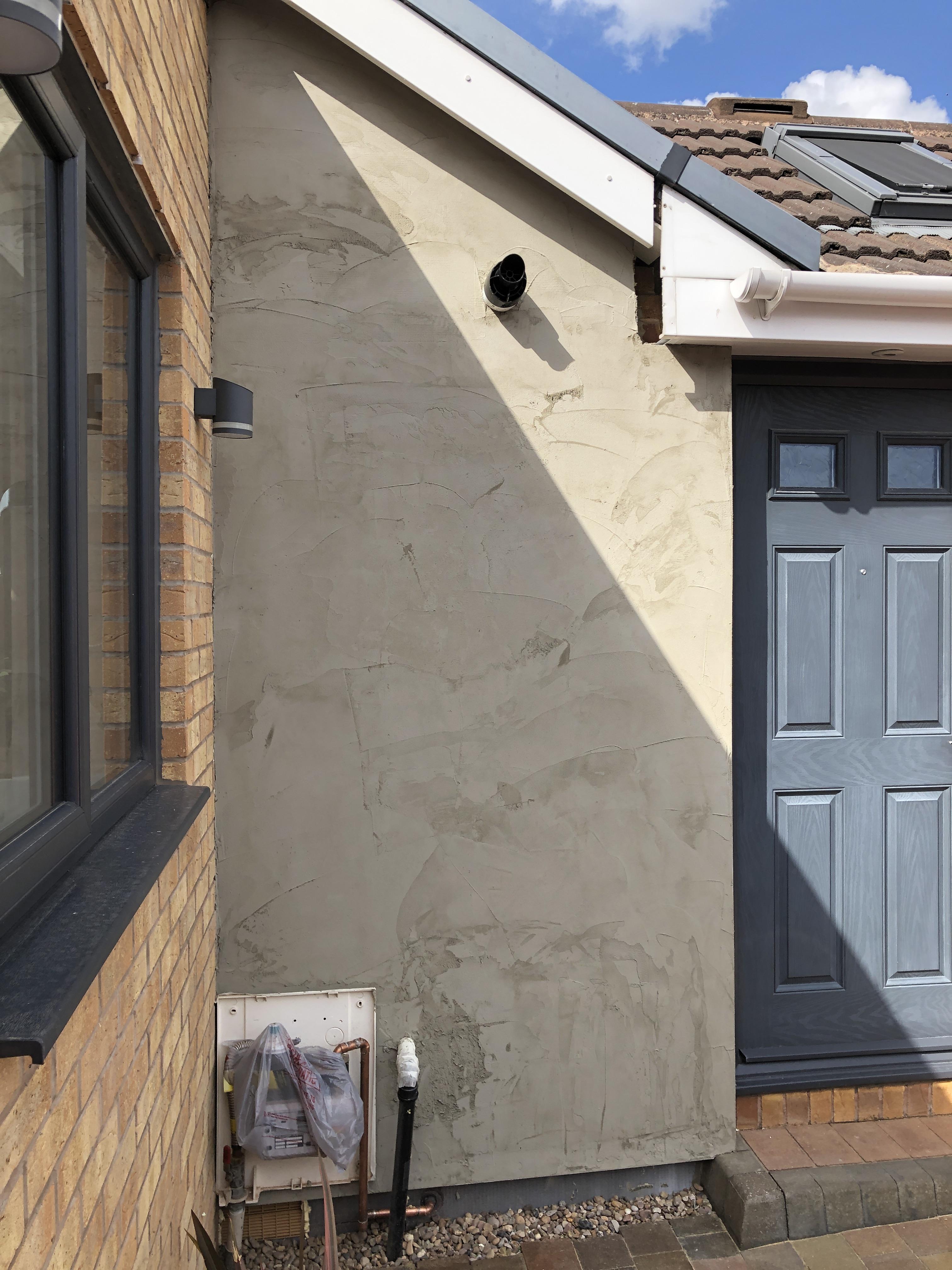

First bit done whilst the hedgehogs were still around, the bit i've been wanting to do the most, around the boiler and gas box, where the worst damage to existing masonry was. June brought boiler service time of the year, so while the plumber was here, he fitted a new longer flue, and also a new gas pipe from the meter to the boiler, to accomodate the thicker walls. Around the flue, I have applied the required dual density rockwool wall board, heavy but really nice to work with, with the remainder done in the usual EPS. Fascia was also installed badly by a contractor many years ago, so i took the bad bits off to replace later on.

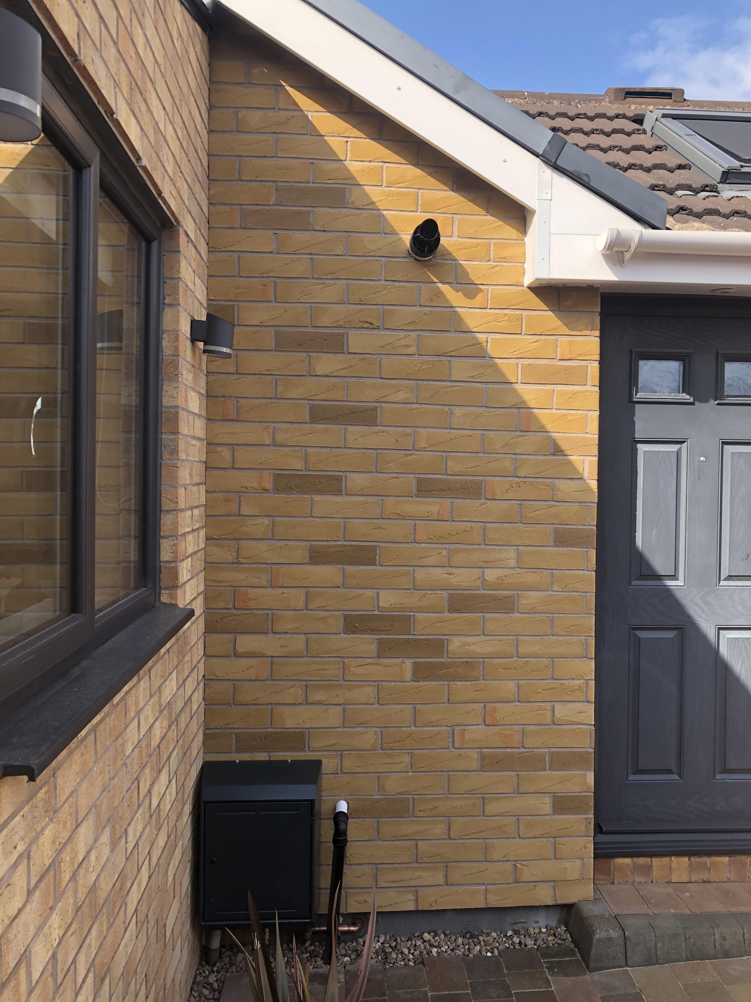

Fascia repaired, brick slips applied and gas box has been resprayed and refitted. I still need to silicone around here and fit the boiler flue rubber, along with cutting the waste pipe down slightly to fit nice and snug.

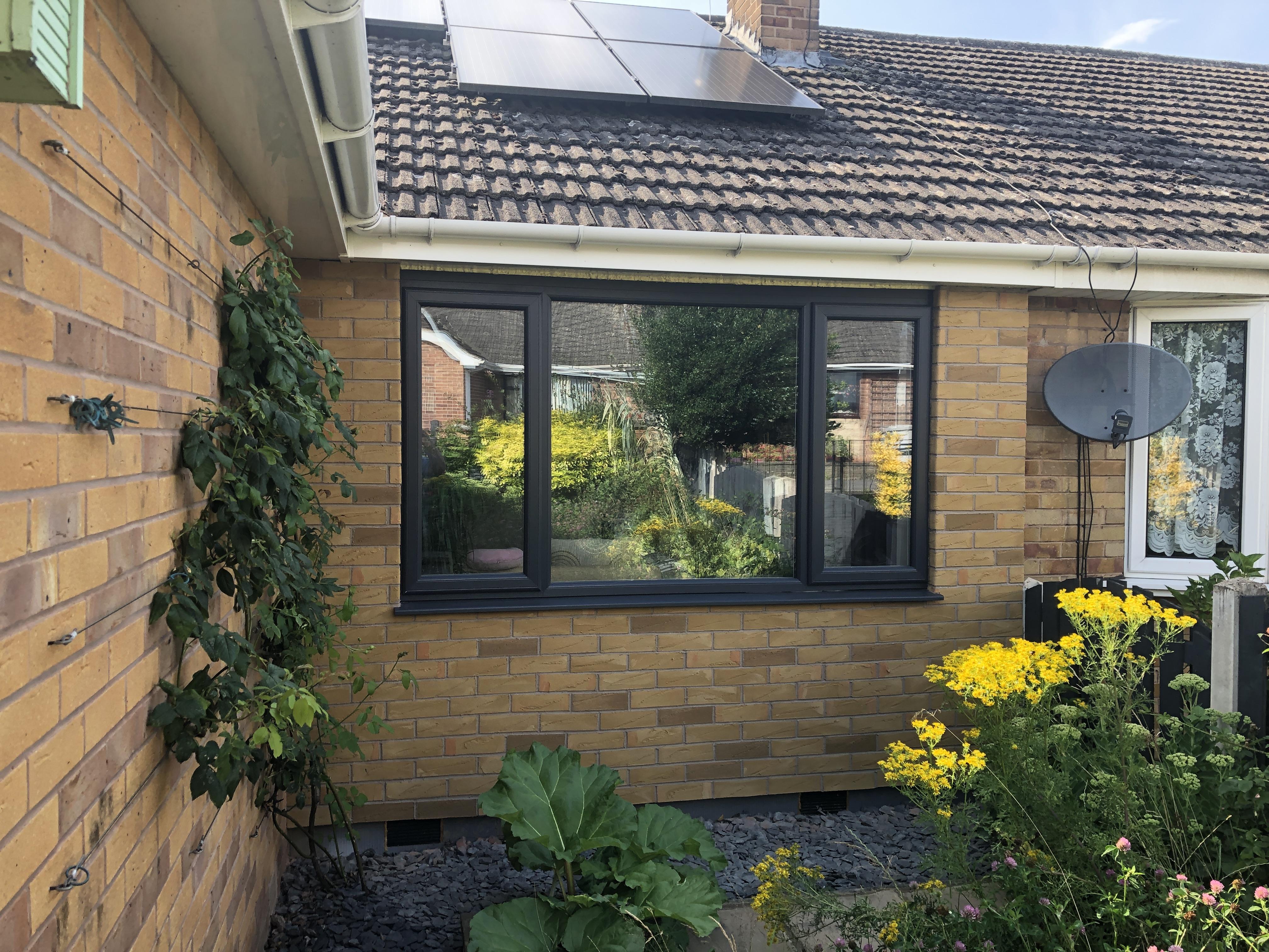

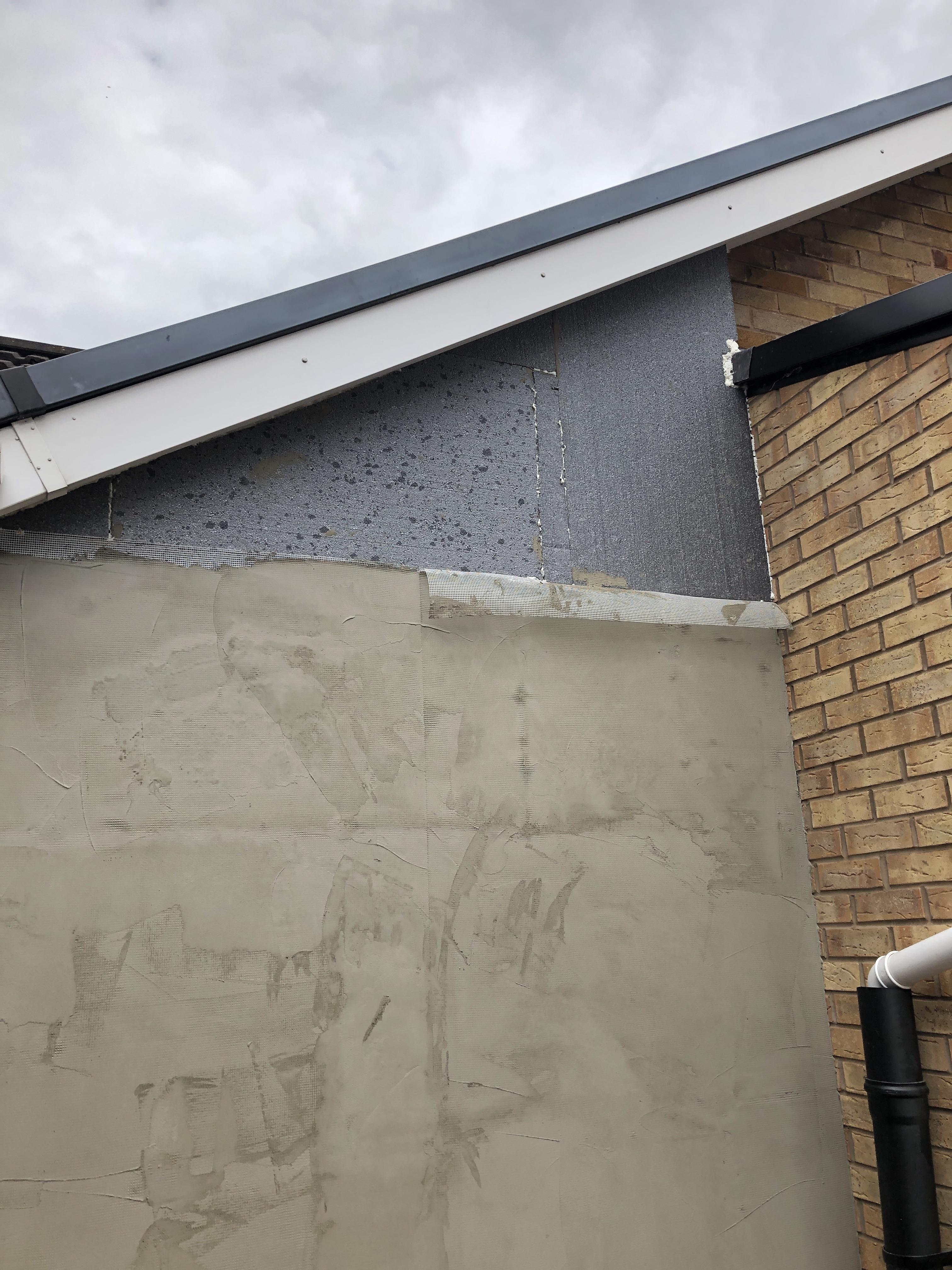

Rear of extension has been boarded, and mostly rendered, the top part is also fixed now, and just needs a render basecoat on, and brick slips.
Front is also complete, and i have since popped a trim above the window to cover the foam, this also needs a bit of silicone when i get a tube. Below the DPC on all sections of EWI, i've got a tub of black render to finish this off, which i'm going to do all at once at the end.
