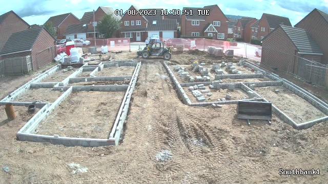

Brickwork tomorrow / Weds depending on when everything arrives on site. Wellies are at the ready.IMG_3687.JPG.9affa1d497734a4a60b98d909f0f43f6.JPG

On 03/08/2023 at 07:04, Dave Jones said:
any reason for using 2 x 7n's over 1 x trench block ?
Cost mainly.

On 09/08/2023 at 19:16, Canski said:
Cost mainly.
so it was cheaper to pay the brickie to lay 2 blocks over 1 ?
Link to comment
My brickie is cheap 😀. The cost of the materials is the issue a trench block is way more than 2 x 7 kn blocks. I know you save on cavity fill but you also lose a bit of leg room for half of the wall. I prefer to put 1 course of both skins of blocks down then cavity fill with a trough and then level the ground out up to the blocks to make it easier for my next 2 coursing brick courses up to B & B

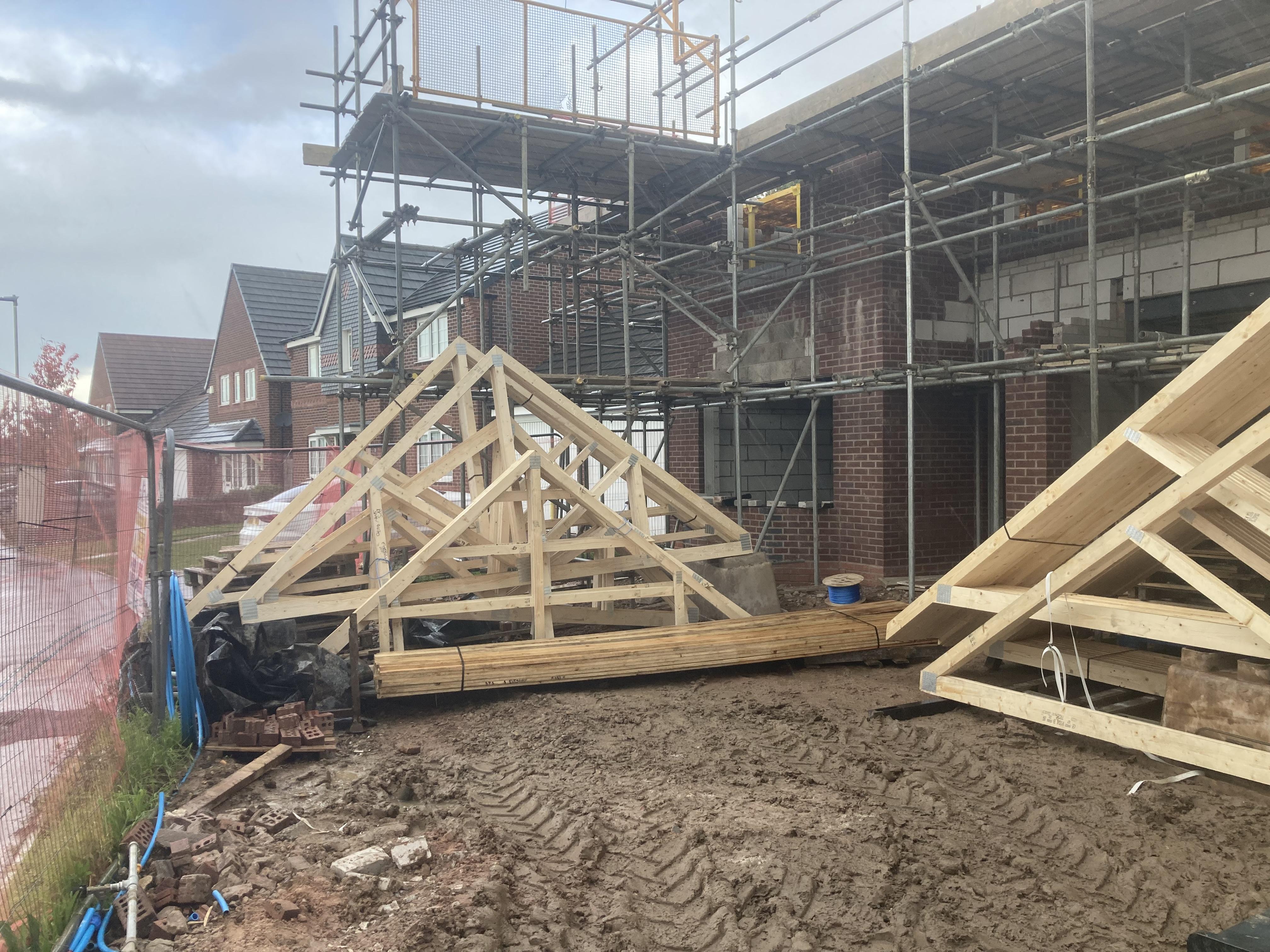

We got there in the end. Thursday
wasn’t the best day to be craning trusses into place and Saturday wasn’t the most pleasant day to be messing around in a roof space but the lads battled through the weather and after a bit of finishing off this morning we have 2 roofs completed ready for me to get my trowel out again tomorrow.  92455C30-BFE4-4C4B-9954-EC391E2B2468.jpeg.36af6c4adf958f87078246059abf3453.jpeg

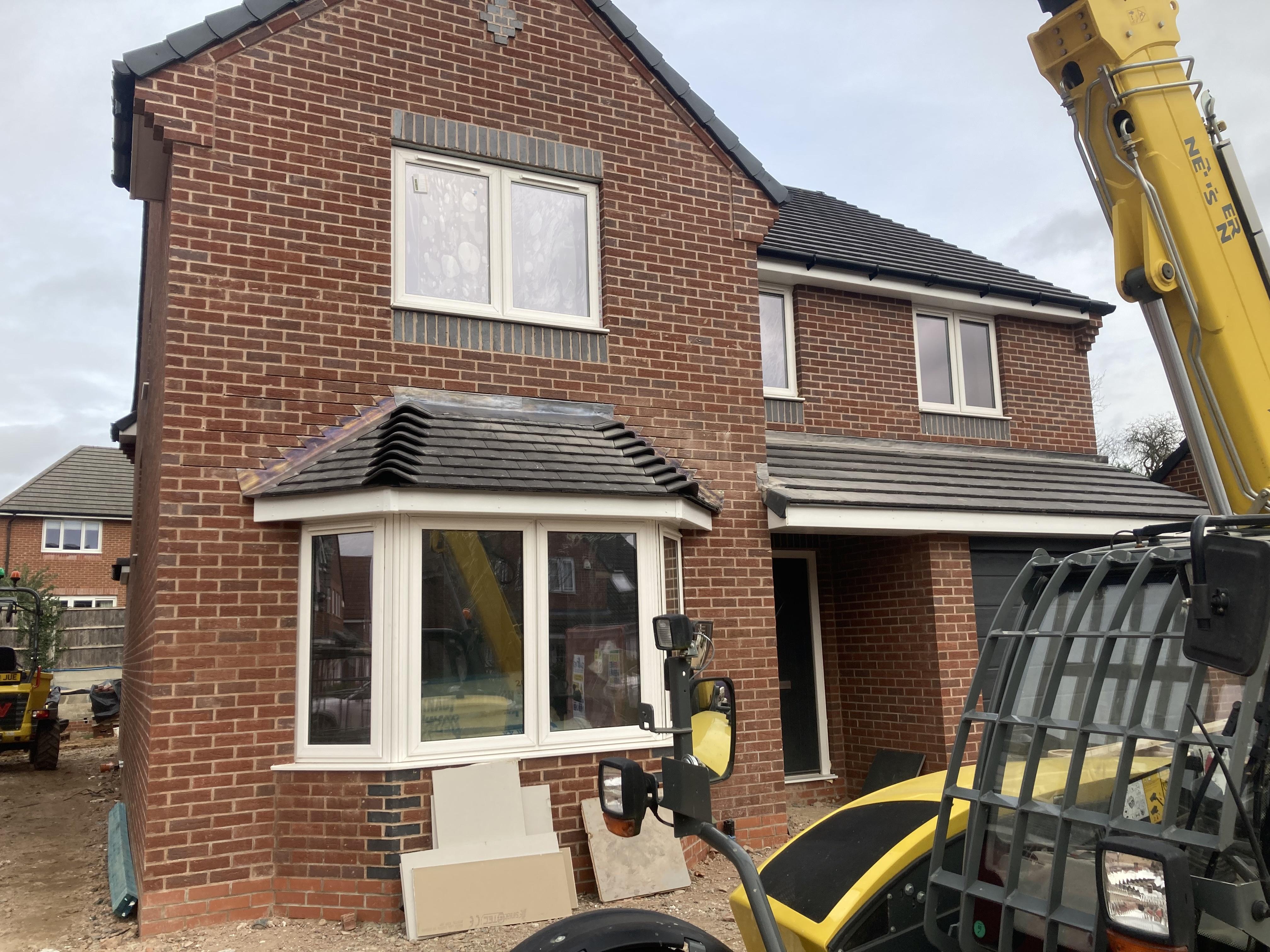

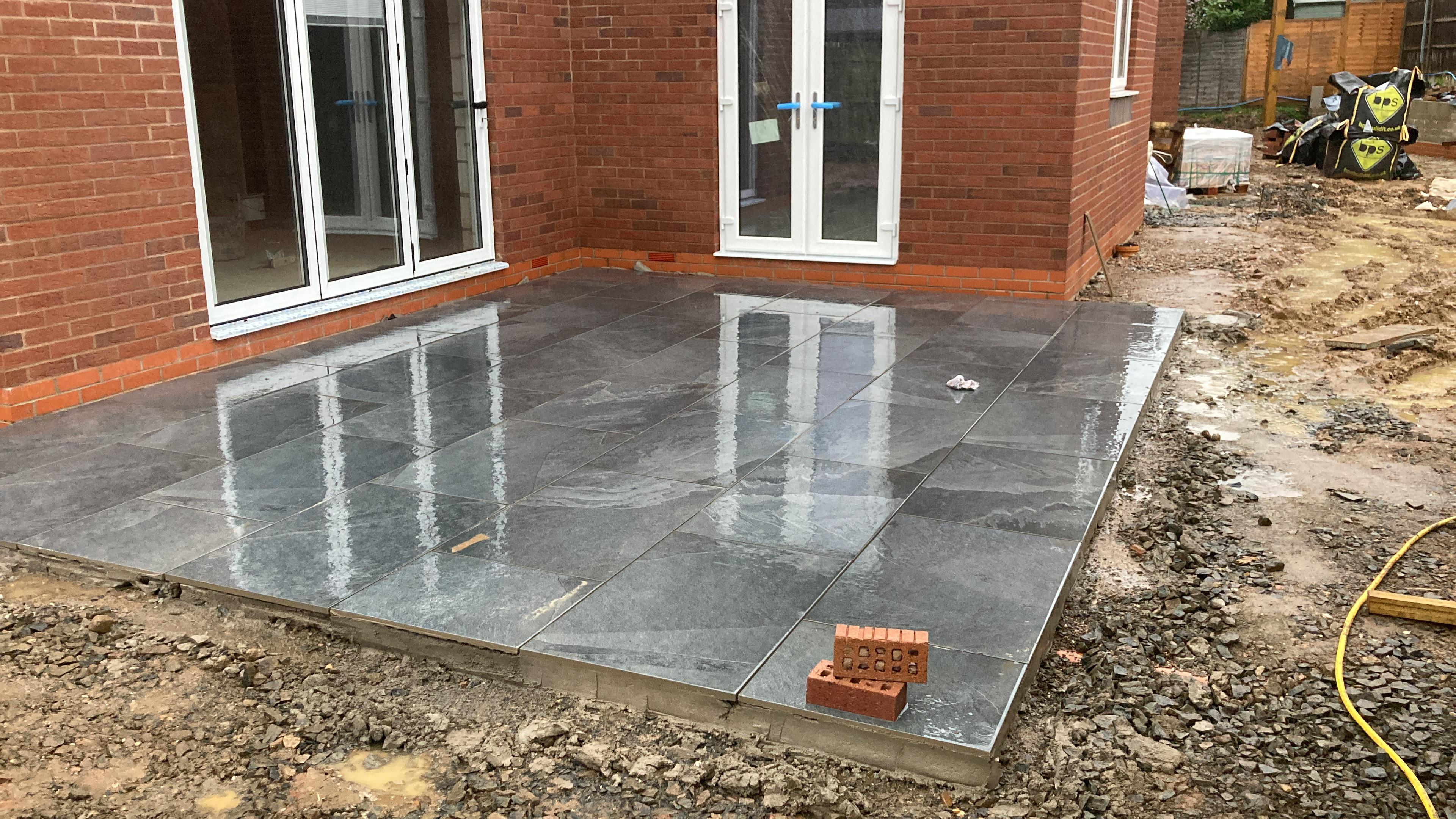

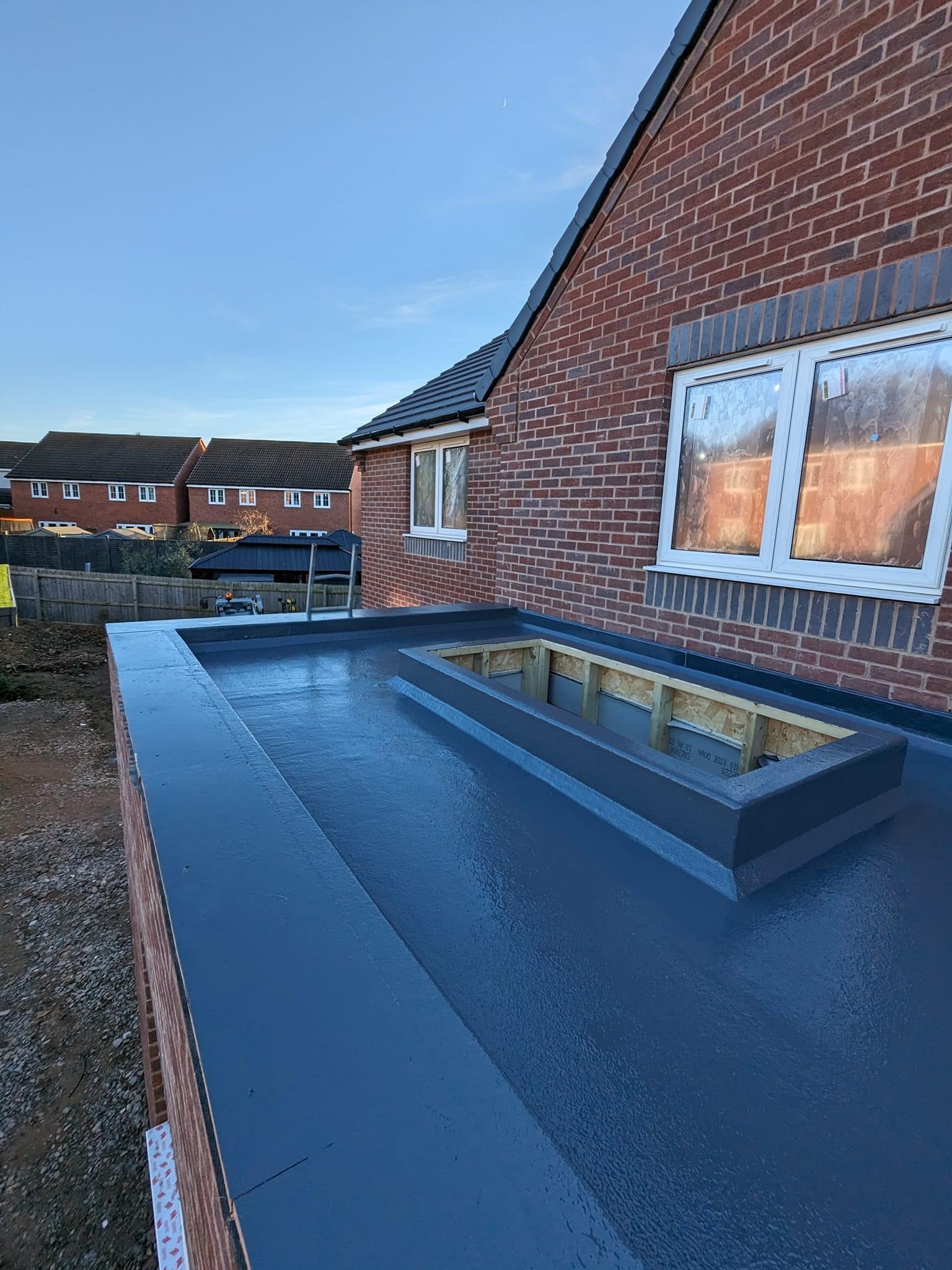

I’ve not had time recently for updates. Getting there now. Slowly but surely. The roofer is supposed to be coming back this week to finish off.
50F514F8-DFAA-4CEE-8C6C-B1110067DDFC.thumb.jpeg.cd023cc599d56f79e7ae122ab917202c.jpeg8C8F9737-0E45-4F6C-8120-3197483734D7.thumb.jpeg.91b82c10cd672450f004faee7bd79a50.jpeg3856EBD4-0F88-439B-A663-FA50A83988E0.thumb.jpeg.29e5bed73686314f5f85977dc12290d8.jpeg8919DBF7-CA2B-4E1C-82DF-55DE97800492.thumb.jpeg.c5506fa0787152f078e695ffee3fb938.jpeg
