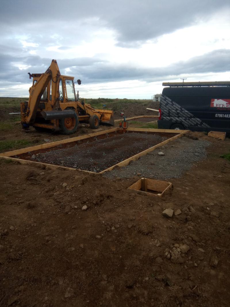

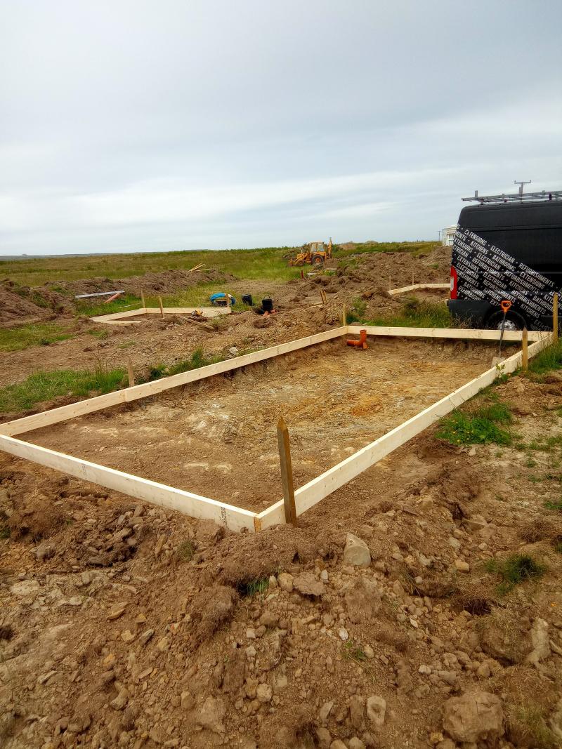

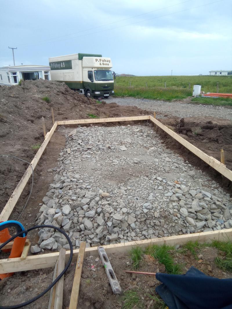

I'd already exposed the rock for the cabins, so BC could see this, and was happy for me to crack on.  I framed the the cabins with 6x2 timber, and levelled this formwork.

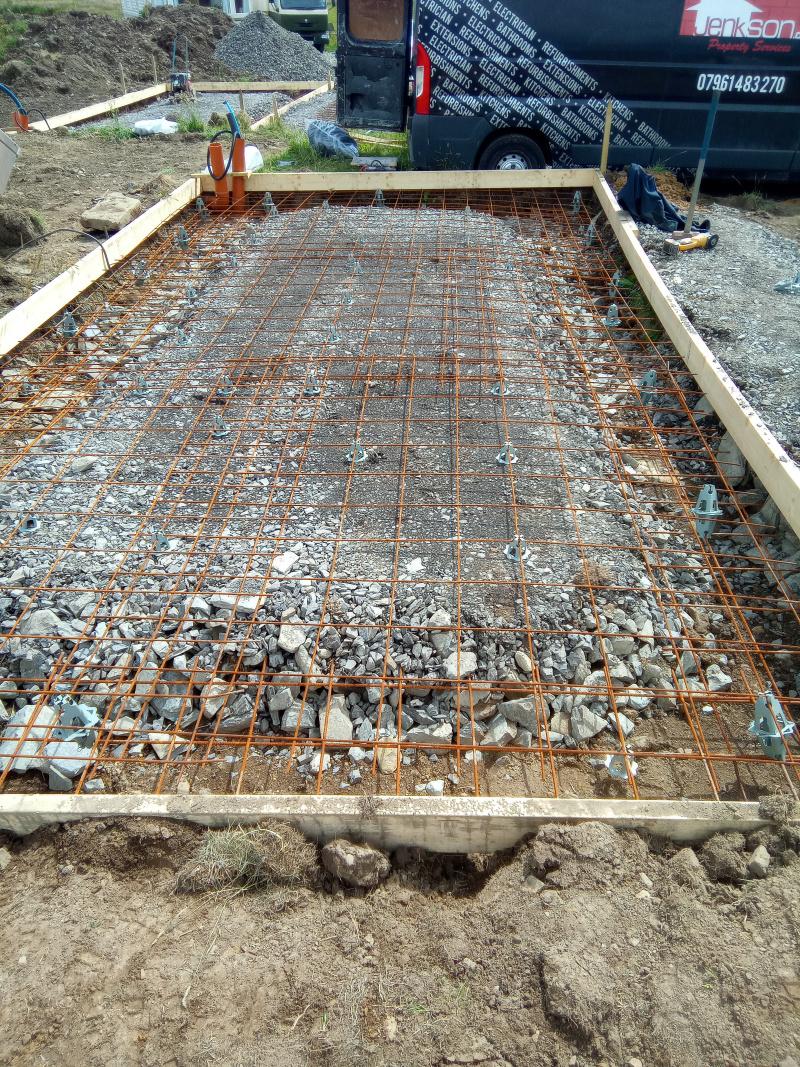

Then used  crush and run to raise the central slab area up, to leave me a 100mm thick slab with thickened foundation perimeter. This perimeter varied due to the level of the rock.  I used around 6 ton of MOT in each cabin., then A252 around the base of the foundation and A142 across the slab.

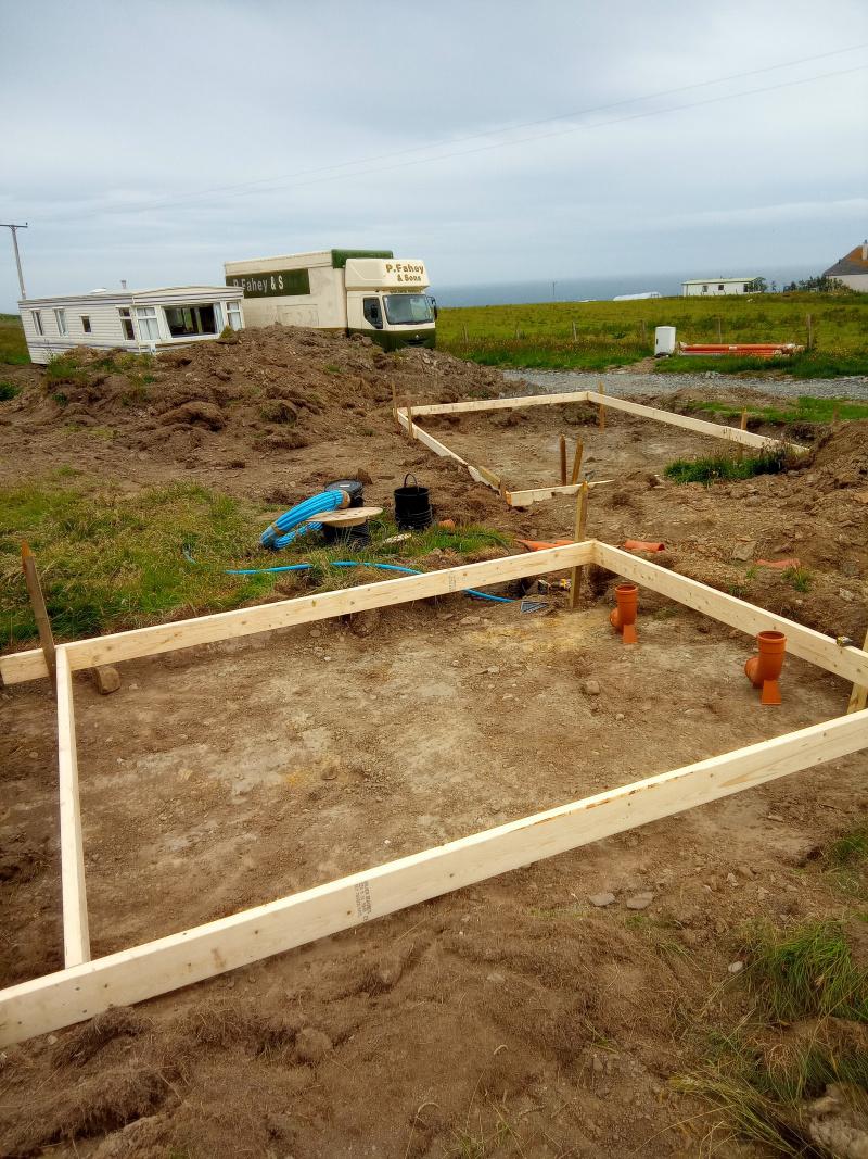

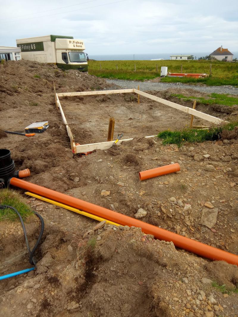

At the corners of each slab I ran the WC waste, and also a feed for H&C water, power and internet supplied for the amenity block.
The amenity block was a simple 150mm Slab on compacted hardcore.
TWR_POD1.thumb.jpg.d5bc33817fbe88950501c18c601043b4.jpg TWR_POD3.thumb.jpg.390f3b3e8a62e947dbcf7f5fc4200dd6.jpg
TWR_POD5.thumb.jpg.e8c22757f6740c18f65cb2d7625d0109.jpg  TWR_POD8.thumb.jpg.aa0806e15cea6bbb2d6056133185d1ca.jpg

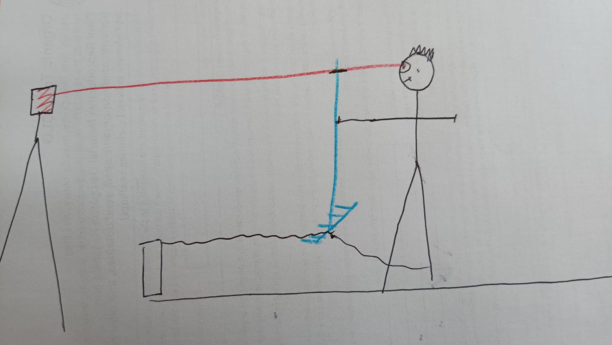

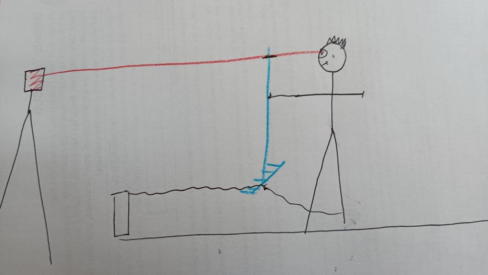

I'm sure someone will bollock me but the technique I used for levelling is was to setup a cheap Lidl self levelling laser with a view over the whole site. Looking into the beam (wait for the internet eye doctors to appear) I took a level on my rake and tightly fixed a cable tie as a datum. This enabled me to rake, check and level the floor very accurately and quickly. Especially as the "pro" beep beep beep level broke on the day.

I had a rotary laser level, so similar to your method but used the digital receiver instead of my eye....😁.
