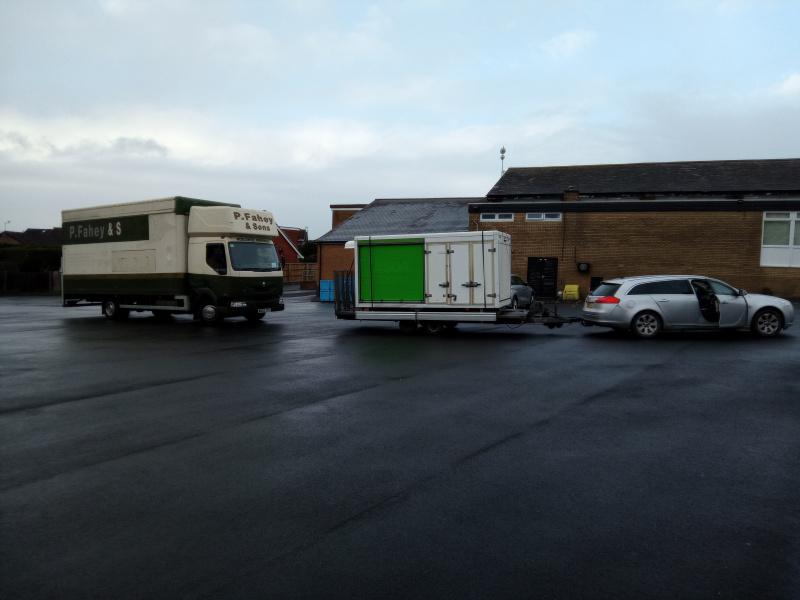

Secondly how to get everything to site.  We bought an old removals wagon - 7.5Tonne ally box with tail lift. MOT till NOV 515,000KM - 1 careful owner :)
Our hope was for this to get there in 1 piece, and be left on site as storage. the sum of £1200. all in with insurance (which may be cancelled) its has cost us £2K.

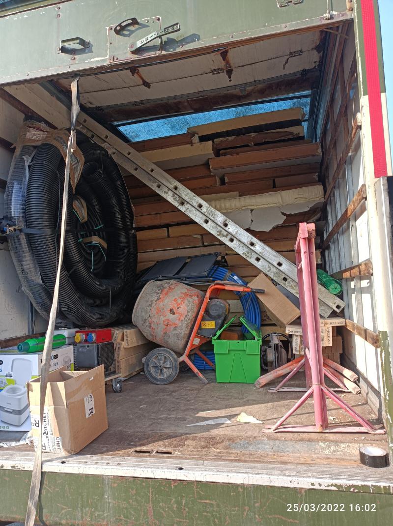

Talking with my timber supplier, he warned me of impending price rises and possibility of shortages due to the unrest in the UKRAINE. so out of the blue I bought all the timber 450M of 6x2 C24, and 56 off 11mm OSB for the PODS.
In addition to this I found a contact selling factory rejects of 120mm PIR insulation. In Scotland the pods need to achieve good U values, so 120mm on roof and in floors was required.  Basically this guy buys pallets of insulation that are usually end of production run , or slightly damaged corners etc, and not full sheet sizes.  I went to look, as he has had some bitumen coated and fibreglass coated boards. Generally the sheets are all 1200mm wide, min 600 long, most are around half board length, but will need to be trimmed to make them suitable for the warm roof.  I did a deal to buy the equivalent of 44 Boards of 120mm some Bitumen coated, some fibreglass for the sum total of £660. This is a massive saving on 'Box Fresh'
Now I had a problem, with the insulation tightly packed into the back of the truck and leaving some pockets to slide the timber in I had filled about 2/3rd of the truck, I didn't have room for all the timber or the other stuff I was taking. The revised plan was to cross our fingers and hope the truck will not only get to Scotland , but now return with a view of making another trip.

We decided to set off Wednesday evening, with the plan to see where we got before we were too tired, then to sleep in the Wagon / Car.    The picture below  was us all loaded with 430Miles ahead.  Me driving 'Nessie' as Mandy has called her, and Mandy Driving the Car / and trailer.   I know we look like 'Travellers' but needs must, what will the new neighbours think when we turn up.....
The Journey was horrendous. Setting off at  18.00 the trip was uneventful, with he exception of filling Nessie to the tune of £245 with diesel and not knowing how far these 150 litres will get us. Uneventful until we got to the A9 around Perth, then the snow started. Visibility was poor, and the local truckers seemed oblivious to it.   Mandy had a big scare on a dual carriage way where she lost visibility of the edge of the road, and found herself nearly hitting the verge, a stab of the brakes and forgetting about the 16ft trailer saw said trailer try to over take her.  Luckily she managed to correct this, and coming to a stop in the dark with snow on the dual carriageway, composed herself and set off again.

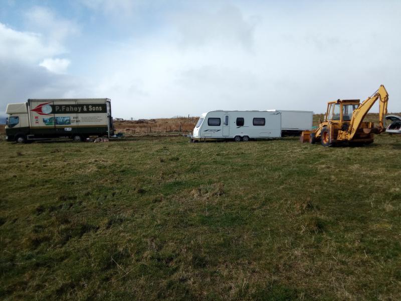

I managed to make a few calls and Borrowed a 3 berth Tourer from GOW Plant Hire / Groundworks in Caithness..  What a top bloke....

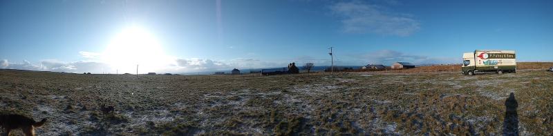

This is us on site day 1, digger arrived.....
The Plot..

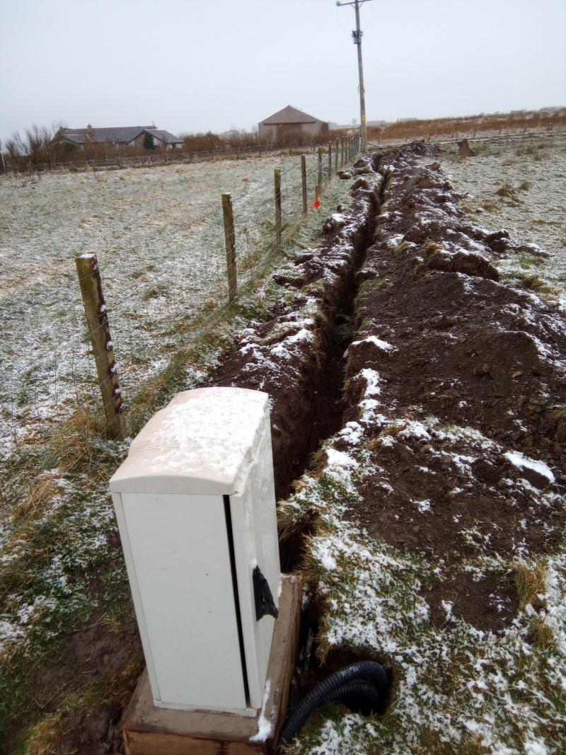

Electricity was to be connected on Wednesday 6th, we needed to dig a 30M Trench and install the cabinet / concrete base.  This had to happen.  Over to the digger to fire her up.... no go. Quickly the battery went flat.  We moved Nessie closer, did a quick 30Mile round trip and bought some jump leads and by lunchtime and still no joy, turning over but not firing..... it was running the day before but they had to jump start as it had been sat in the yard for a few week.

Now to get to grip with an old backhoe, I've experience with up to 5 tonne 360 machines but never a back hoe, so this took a while to understand how to dig a straight trench next to a fence..  I managed to excavate the connection pit and around 15M of wandering trench by the end of the day.

We also started unloading the insulation and timber from the truck.  We sandwiched timber and insulation with visqueen and ratchet straps to create a heavy mass that hopefully wont blow away whist were not there.

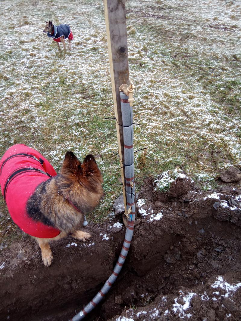

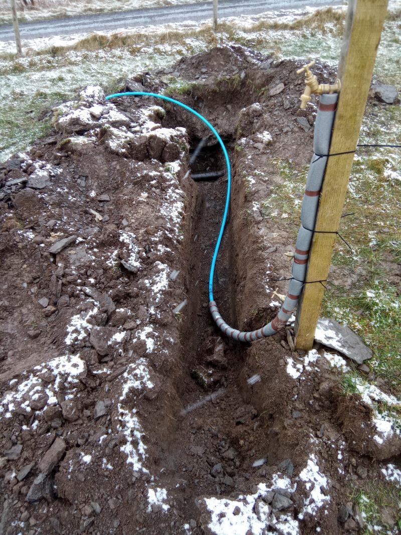

We dug a small trench for the water (we new the main was laid in a blasted trench to a depth of 800mm)   we had to breakout our trench with a 110V Breaker to obtain the 600mm depth and hand dig to expose the water main, I left Mandy to this while I dug the septic tank hole, I got to a depth of around 800mm before I hit the rock. This will need pecking out now.
We installed a homemade standpipe, and blue pipe, then asked for a track inspection via the online portal.
We were given date of 11/12/13April, but we put a note on to say we were on site until the 8th.
They responded and the Meeting was set for Wednesday 6th - result.

A cold and wet start, We finished off the electrical trench, laid the ducting / draw cord and all was set for connection the next day.

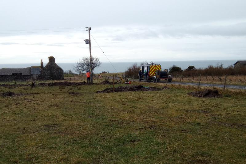

Day 7 Wednesday - electrical trench was full of water, and the ducting was floating.  the heavy rain drains towards the sea, and thus straight into this trench, I was concerned that the Install may be called off.
SSE turned up around 10.00 and were not bothered in the slightest.
They connected a new length of 95mm Wavecon to the pole and jointed the existing 2 houses and our new supply - 2 core 35mm straight concentric to this 95mm cable. Resin pour joint box, and fitted the 100A cut out in the cabinet.  They were done in 2 hours. left me to throw the cable in when the resin had gone off.
Scottish water inspected the trench, and this has been signed off and will be added to the works list, hopefully a few weeks.
1709287428_WaterTrench_Standpipe.thumb.jpg.fe50f855b6c742d2d6345f99a8f9ed89.jpg   Water_dogs.thumb.jpg.6bb927241b9a0a44c35730a6284768ca.jpg

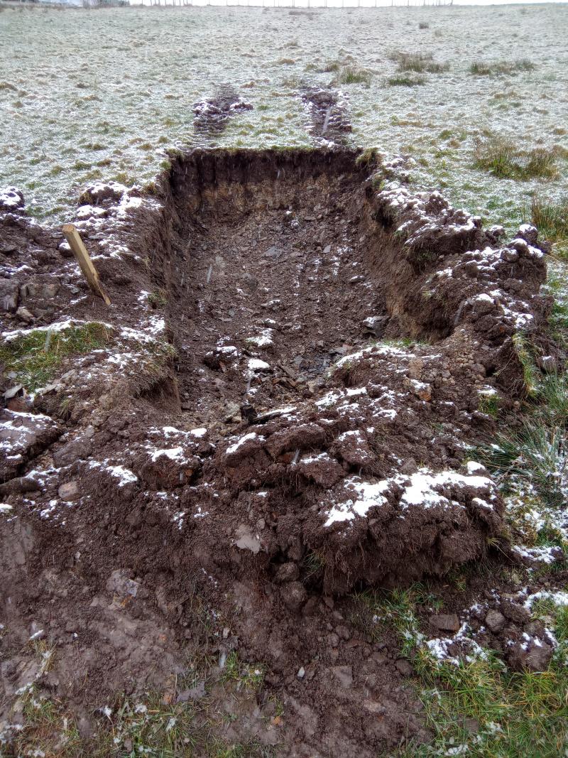

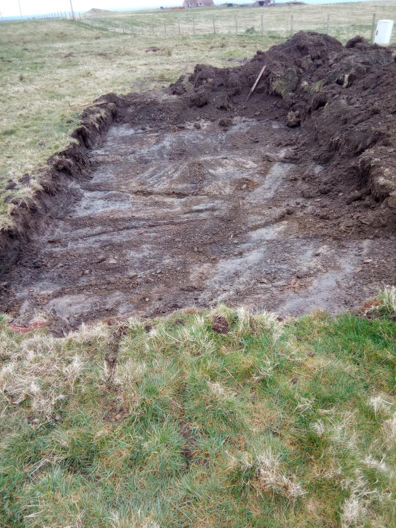

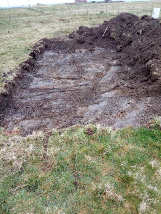

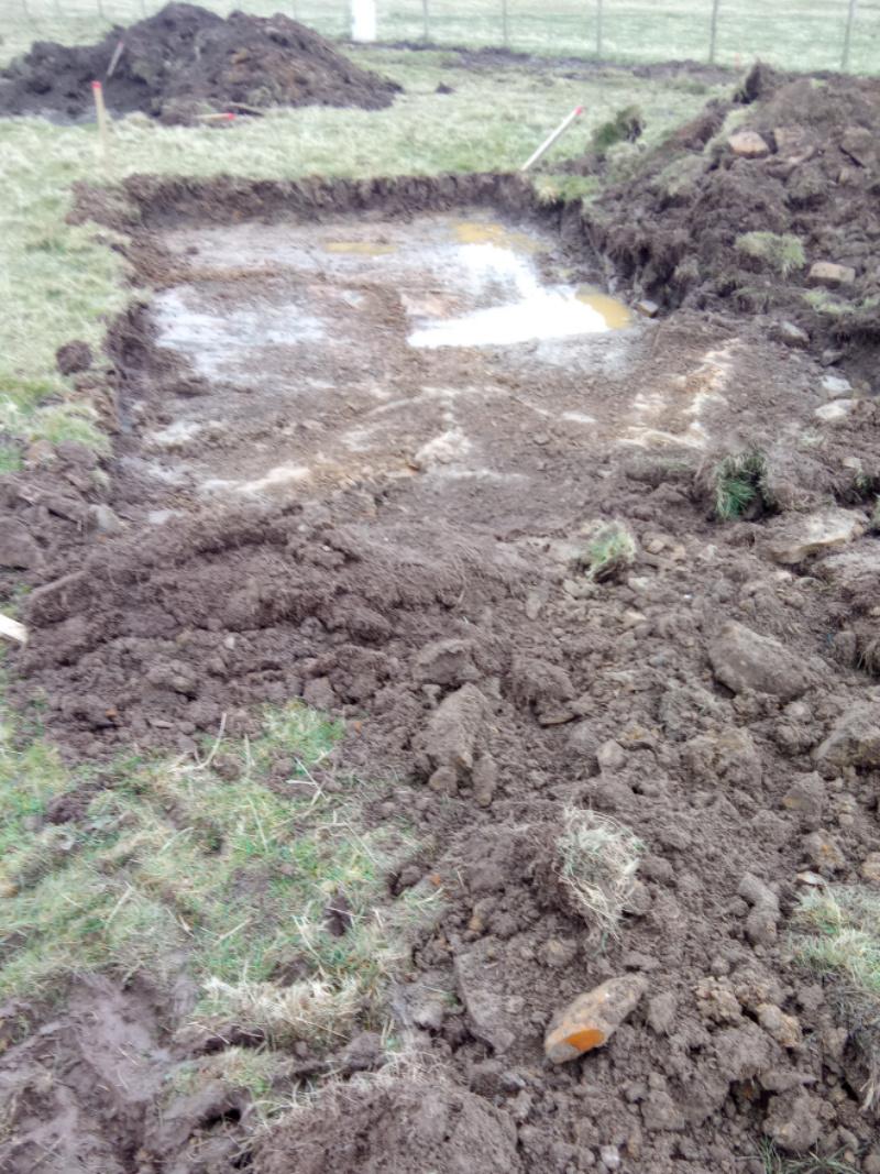

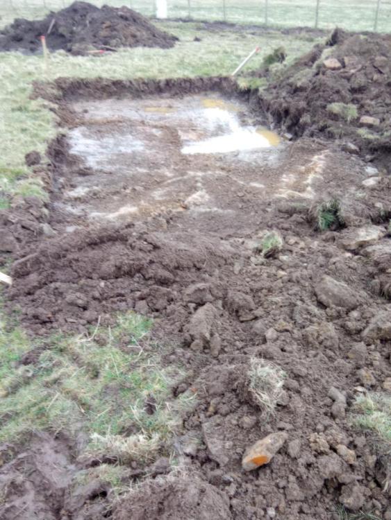

We managed to rough dig out the pod foundations and found the rock is close to the surface. so the slab foundation will be pretty much mass fill concrete around the perimeter, with some MOT to reduce the thickness to 4" for the slab. This will then have a Radon barrier on top and a floating floor insulation on that,
Pod1_Foundation.thumb.jpg.1362045a3d15bceee77f342e00574d22.jpg        Pod2_Foundation.thumb.jpg.df2704982150df231286662b9db2f3bf.jpg

How deep is that soft ground? A while ago you were discussing breaking granite out for trenches: is this handier than you had expected?
Link to comment
Its not granite 😀. its a layered stone, (Flagstone) so breaks into sheets, similar to slate.  Where the pods are the rock is only 250mm - 300mm below the surface. Which will work well , as  I will use some MOT to build the centre up to reduce the slab thickness and then mass fill the lot. With the Radon Barrier on top of this and a floating floor with insulation underneath.
The Septic tank I managed to dig to around 800mm Deep, again better than I thought, but this will need pecking now to get to the required 1500mm.  And ill probably have to peck the trench for the rumbling drain
I've not started on the house yet, but the ground rises there, so I suspect I will have to do some pecking at the higher ground to get the area somewhere near level for the insulated raft.  But I'm  a little happier now I know what I've got to deal with.
I had to break a bit of the water trench with a 110V SDS Max, and it broke fairly easily, so I'm quite happy an 8T 360 machine with pecker will sort out all I need fairly quickly.
