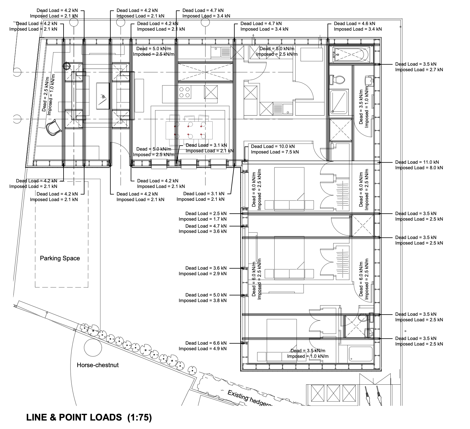

I am hoping to start work on site in May, about two-months later than my original plan. Things may well slip further and I am fine if they do.
Currently, the timber frame is being designed, by a specialist frame-designer based in Herefordshire that was recommended by (and contracted via) my chosen local timber-frame company. And the frame designer has just sent me the line-and-point loads (see below), so I have in turn just sent those on to my foundations designer in Ireland so that the insulated concrete-raft foundation can be designed in parallel with the frame. (To save on VAT, I also contracted the foundation designer via my frame company.)
In parallel, with this, I am in the midst of arranging a fibre-optic data connection to my plot. I already have electricity connected. The fibre connection comes from a local fibre ISP who have been pleasingly helpful. The connection requires a new overhead wire from the end of the access road about 40-metres to the gable of my neighbours house and thence down to the ground and on to my plot. My neighbour is being most obliging, partly because he also gets a connection and can drop VirginMedia, who has been unreliable for him. To my astonishment, the whole installation will be free as I, it seems, am eligible for a voucher from the government that covers the cost. The voucher does not cover the VAT but the company kindly agreed to absorb that cost themselves (!) when I mentioned zero-rating.
I am getting closer to choosing a groundworks team and finalising the details of the groundworks. I am pushing the boundaries of what is acceptable for what is supposed to be a "no-dig" build but it will all be done with expert tree-specialist oversight. I need clay heave protection which will be 220mm thick so digging down about 375mm was needed if my final floor level was not going to be high in the air. For my screw piles, I will probably go for a supply-only deal for the ground screws themselves and have the groundworkers install them with a mini digger (in my presence). I am told that installation is simple.
For the installation of the insulated concrete raft, I still have not identified who will be the installer. I am tempted to speak to all the local concrete pourers to see if I can find someone who has experience of insulated rafts. The raft design is going to slightly unusual. Because the insulation is not load bearing and because I have a ridge height restriction and want tall ceilings, the insulation will be thinner PIR rather than the usual EPS.
To my distress, the local water company has insisted I make a water connection all the way 40-metres back down in the access road to the 5" water main there rather than 2" main directly in front of my plot, citing "the impact of another service". Oh well at least the water pressure will be good!
