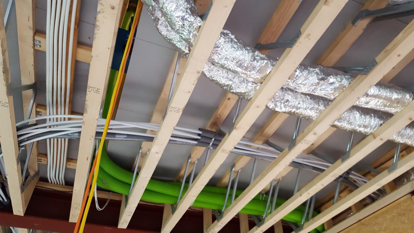

The nature of the first fix work means that it's hard to photograph the amount of effort that goes into it, but there is plenty.  Initially, the team is focussing on getting all the MVHR pipes through the metal web joists and, in time, insulating them.  Then there are all the underfloor heating pipes to be run through to the right places and the manifolds.  We're having UFH upstairs as well as downstairs - the ground floor manifold is in the very useful cupboard under the stairs, the upper one in the loft space along with all sorts of other interesting things.
Here's a nice selection of the MVHR pipes, some insulated, as well as the clipped up UFH pipes that are insulated where they are tied together and in contact with one another.

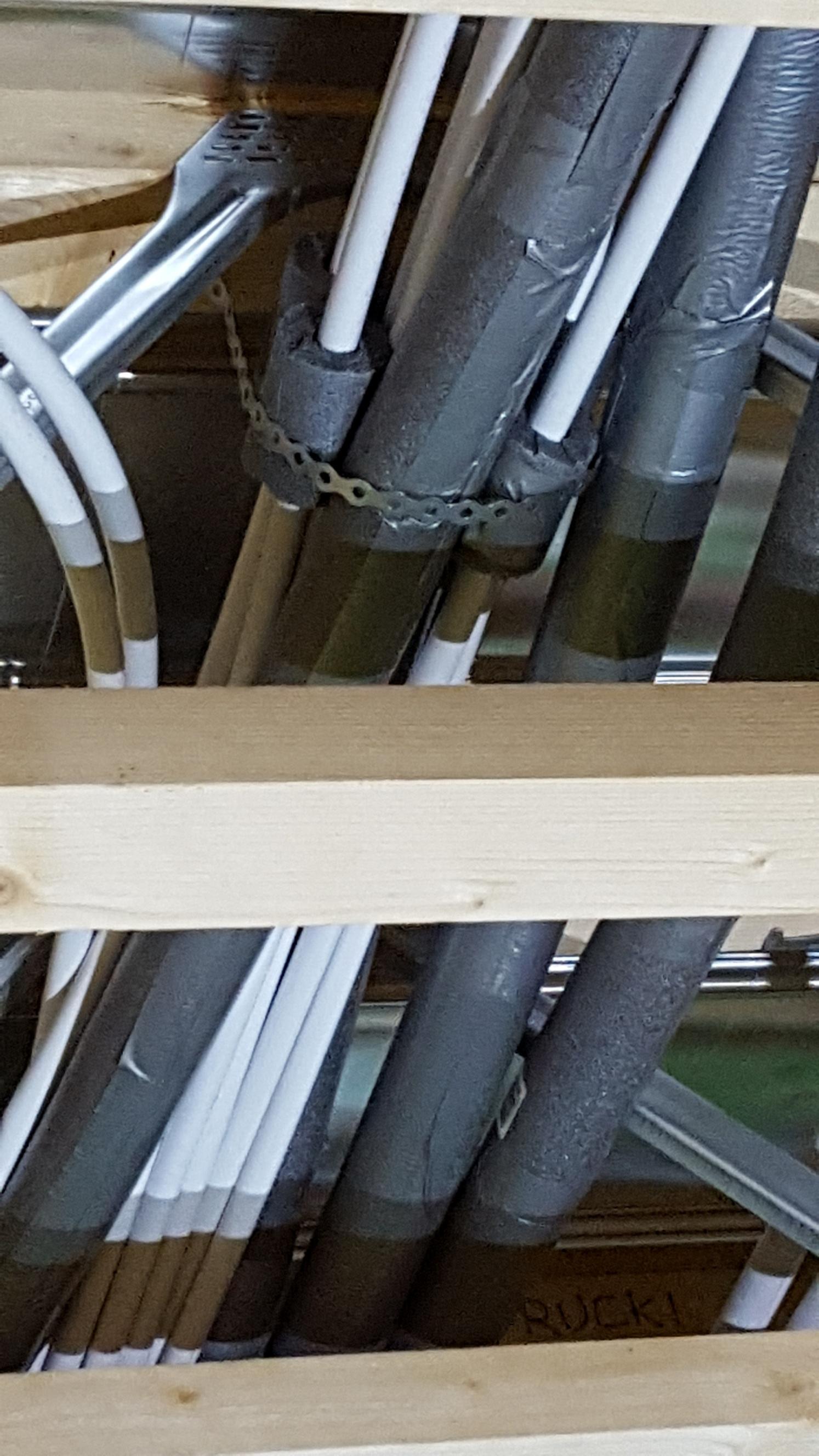

And here's a close up of the insulated UFH pipes.

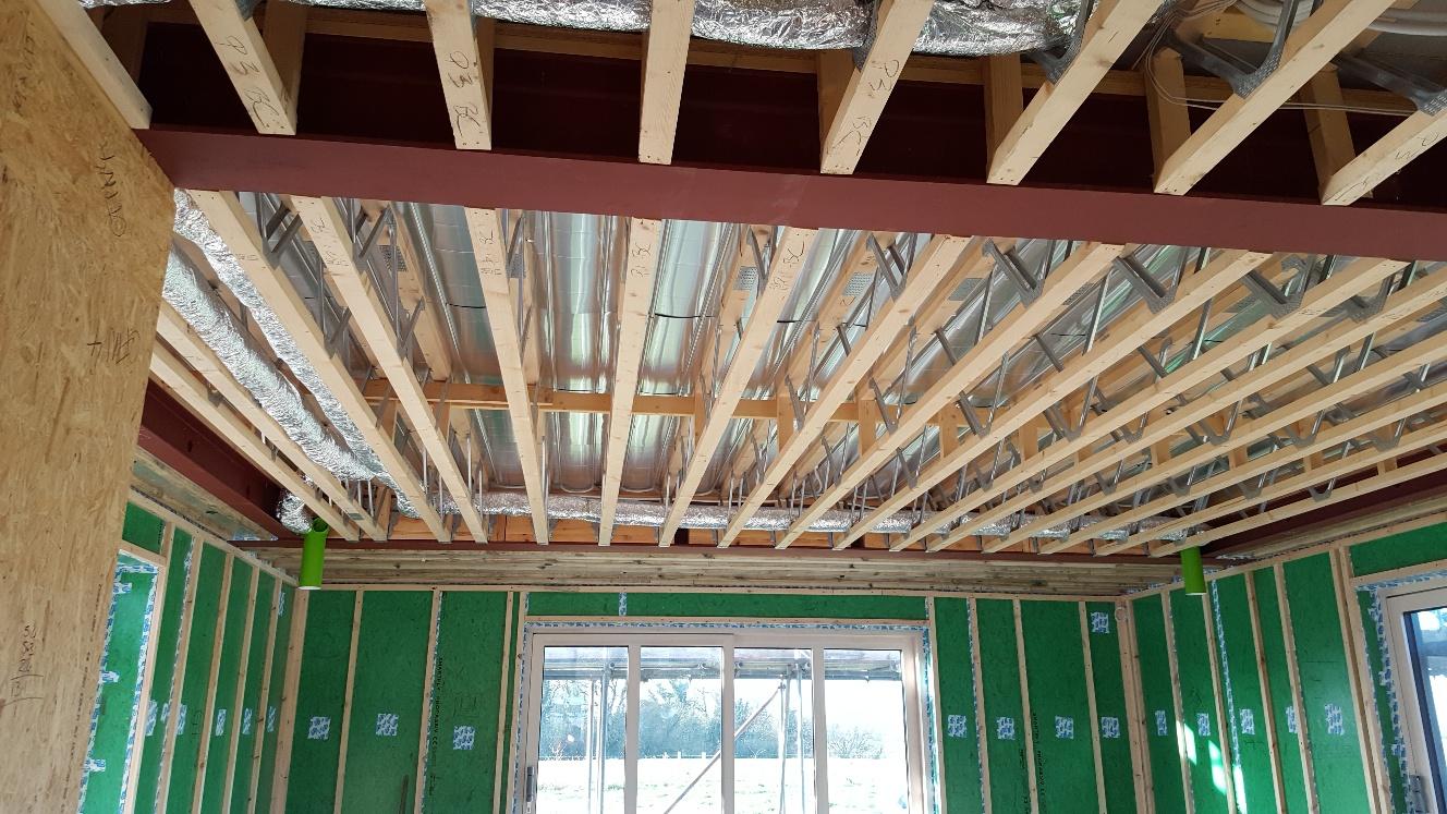

Thought has gone into how air will flow around the building with the aid of the MVHR system.  In particular, in the large open plan lounge/diner/kitchen area, and how to ensure that none but the stinkiest cooking smells make it out of the kitchen area.  As a result, there are long runs of the MVHR pipework leading to plenums at the far end of the lounge area where air will flow into the room.  The exhaust pipes for this area are (almost) directly over the hob on the island at the far end, so the airflow should ensure that all the cooking smells get sucked up and out over the kitchen area.  Here's a photo of the inlet plenums either side of the window at the far end of the living area.

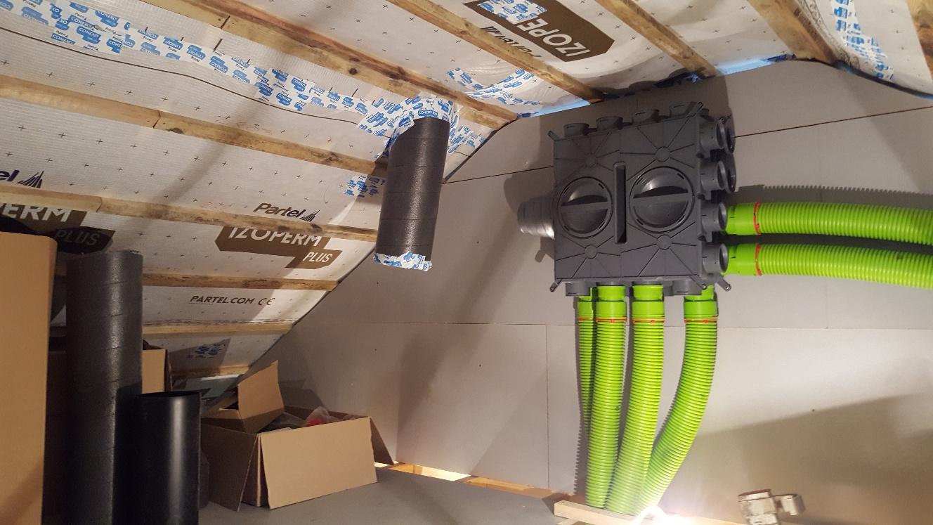

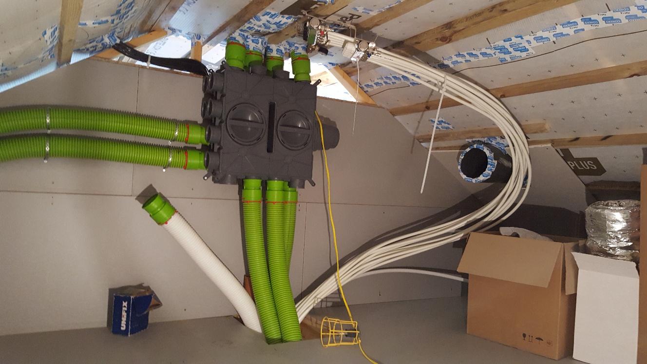

Originally, the architect designed the entire upstairs to have vaulted ceilings, including the landing.  Whilst MBC were still drawing up their engineering drawings, we asked for the landing area to be boarded out to create a loft area as this would be an ideal space to stuff a load of plant, including the MVHR manifolds.  On reflection, this was also a good decision as I think the proportions of that area would have looked very odd and felt like a vertical tunnel due to the height of the ceiling at that point (4.7m).  The MVHR manifolds have been neatly attached to racked out sections in the loft area, making sure that room is left for the upstairs UFH manifold and, in time, the PV inverters.  One note with the benefit of hindsight is that having an MVHR unit directly over habitable rooms, in our case bedroom and ensuite, should only be considered if the unit is going to be thoroughly sound-proofed.  Ours was never given the promised sound-proofing measures and it's hellishly noisy without them, but we will be rectifying this soon. Here's the loft area back in December:
And the one on the west wall.  You can also see the UFH manifold and the black cables from the PV panels that will be connected to the inverters.

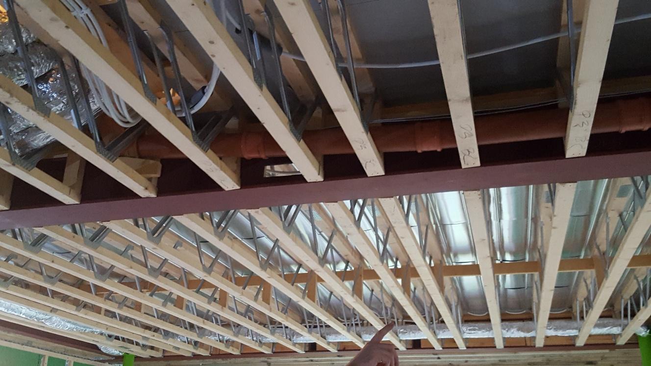

There were also the soil pipes to tackle and these were planned to get sufficient fall on them as they came through the web joists:
For anyone tackling a similar build, I can't stress too much the advantage of having your systems people involved from the very start.  It means that any holes that need to be put through steel beams to accommodate pipework can be designed in and made at the fabrication stage.  Even then, things can go awry and a couple of the steel penetrations were either off kilter or not in the right place, but the majority were where they needed to be and made life much easier.

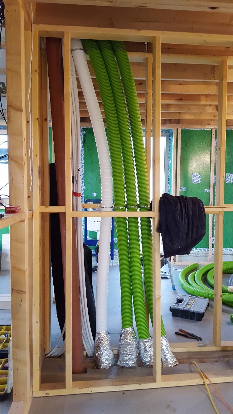

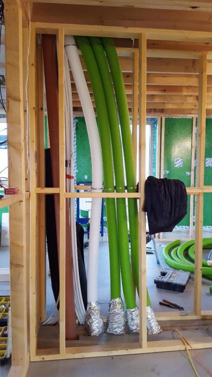

An example of this kind of thing is the stud wall between the landing and the en-suite for the master bedroom.  In order to be able to hide the various pipes that travel up to the loft space, MBC were asked to make this into a twin stud wall and specified the depth so that it would carry the pipework.  Here it is.  A bit tricky to see, but you can easily see the benefit of being able to conceal this bulky pipework into the fabric of the build.

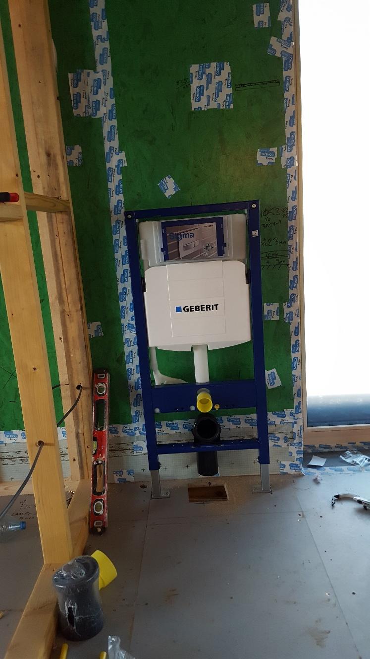

Speaking of concealing things, all the loos in the house are wall-hung with the cistern concealed in the wall.  All you see is the loo and the flush plate, and so the framework needs to be put in before walls are boarded and plastered.  Here's one such frame:
