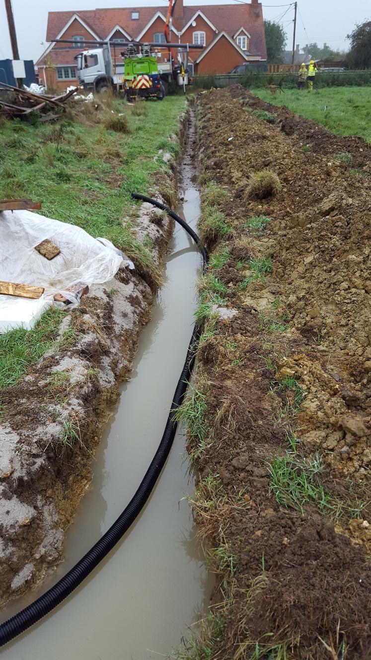

The trench was dug last week and blinding sand laid along its length.  Simple enough, but it's a really long trench, something in the order of 50 metres all told, and we got through the best part of 4 tonnes of sand to line the base of the trench.  In digging out the trench, an old land drain got smashed up as it ran directly parallel to the long run of the trench, and at right angles to where the trench turns in to the garage.  I'm really glad that it was dug last week and not this as it was lovely and dry last week.  This week, I'm well on my way to having a moat as a result of the broken land drain.
This is looking back towards my neighbours' cottages and where the new pole will go in, against the fence.  The pole to the right of the cottage on the right is where the supply runs in from.

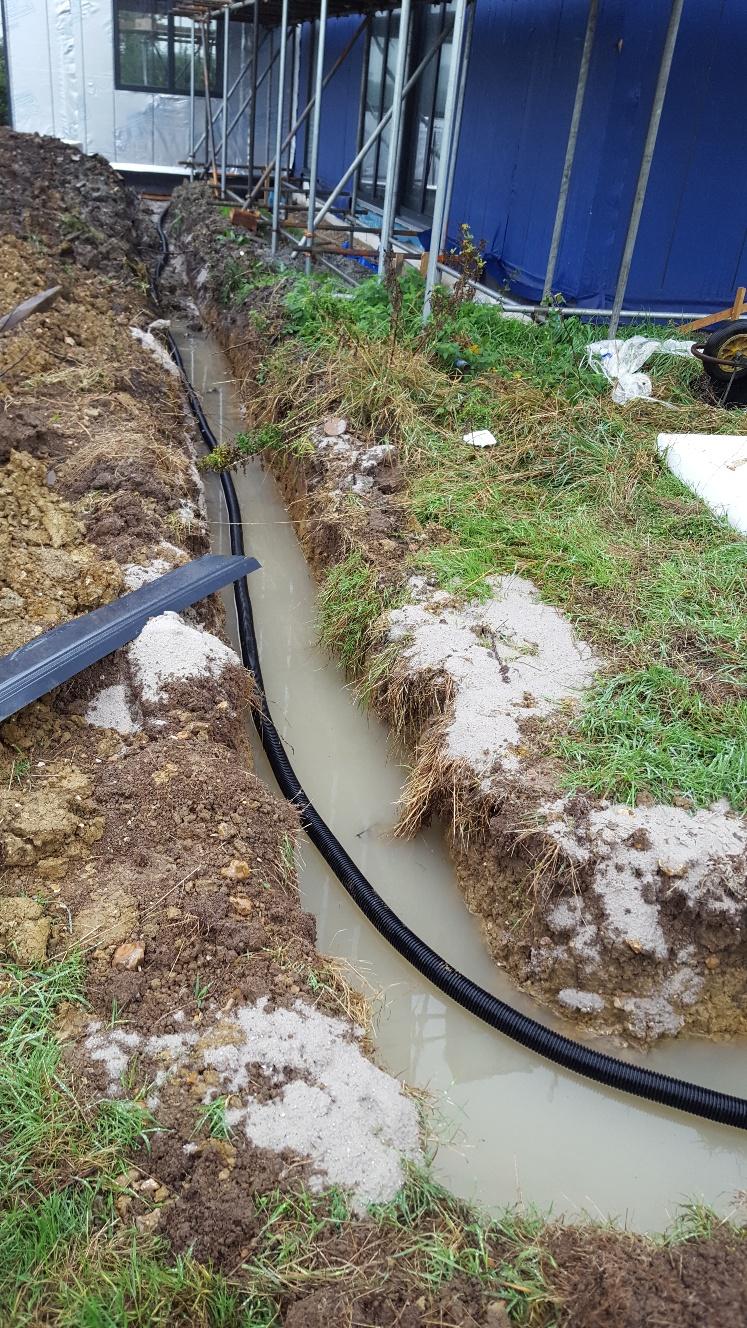

And this is around the corner, looking towards my garage.  At the end of the trench, there is a duct that MBC put in (there are a few others, too) that allows the cable to come into the garage from under the slab.  There will be a whole bunch of kit going into the garage, including my sunamps, so this seemed like a good place to run the supply in.
Because it's such a distance between the new pole and the garage, the first 30m of the supply cable had to be a very heavy duty one.  About 3/4 of the way along the long trench, there's a fancy looking connector that links the heavy duty cable with a normal one, which continues on into the garage.

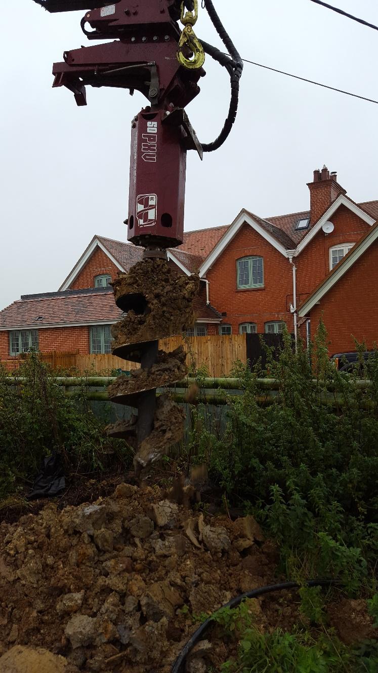

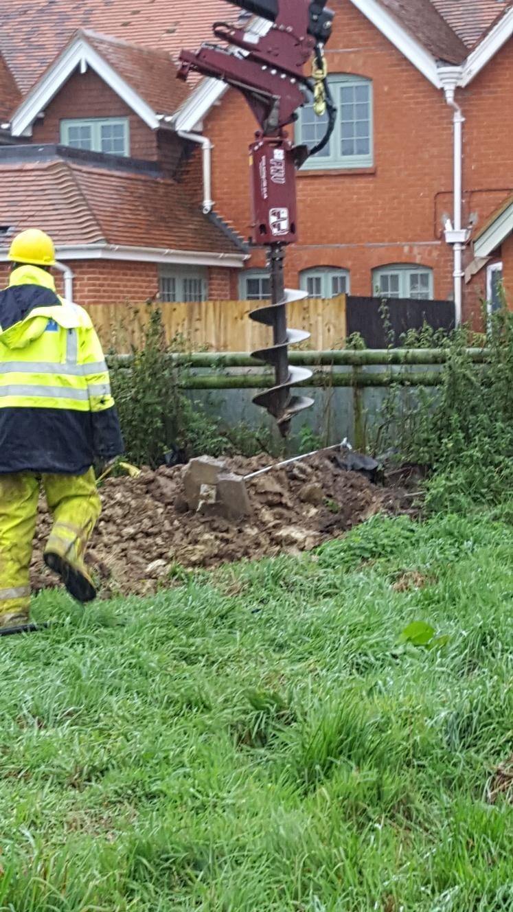

My site seems to have a natural affinity for augurs and drills.  Back at the start of the build, a rig was on site taking soil samples.  This was followed in due course by another rig drilling holes for all the piles and now we've had another one, this time to drill a hole to put the new pole and stay into.  As usual, the augur came up caked in clay but the soil was still dry at depth and it came away nicely.  Here's the augur going in for the pole.
And here's what it drags up.  I really should consider a pottery business.

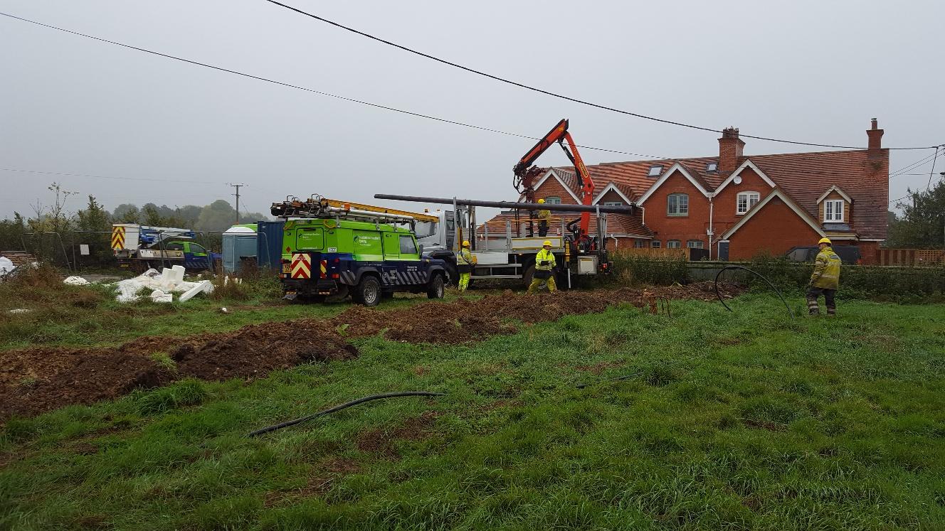

The guys from SSEPD made the job look very easy, but a reasonable amount went on and there was a fair bit of equipment on site including the cherry picker, drilling rig and the ubiquitous land rover, with 4 guys in total.  They finished just before 1pm and worked efficiently and were a very nice bunch of guys.  A couple of them will be back in due course to do whatever is deemed necessary to the poles carrying the oversailing wires, but that may be a little while off yet.

Once the snagging work is done, the next big push is to get the various roofing jobs finished off so that the building will finally be watertight; my parapet walls may look lovely, but they are leaking like mad right now, so I shall be relieved to get finished there and let everything start to dry out.  I'll also get the trench back-filled as I don't really want a moat and certainly not that close to the building.  It does serve to illustrate very well why a soakaway wouldn't work, though.
