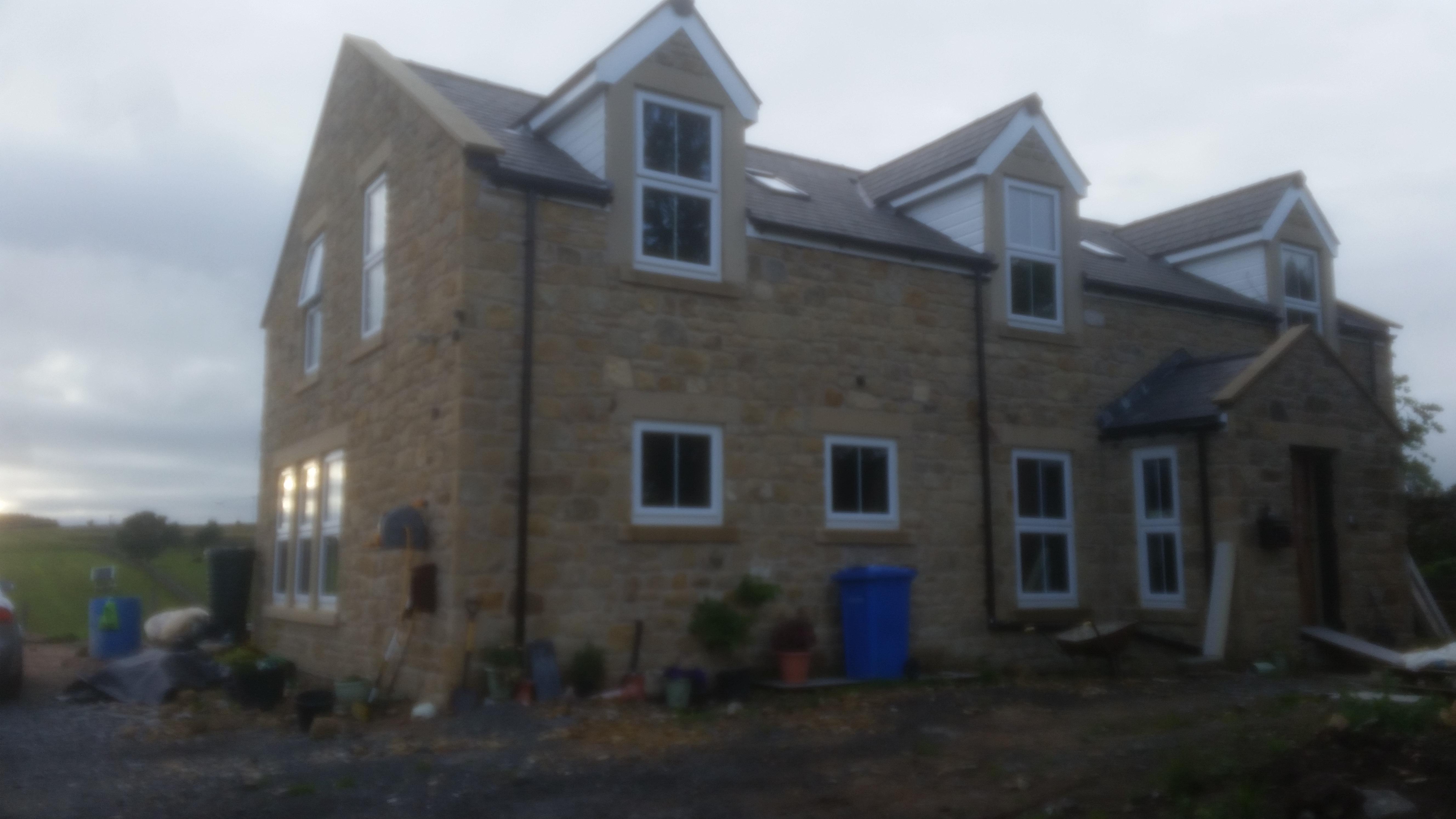

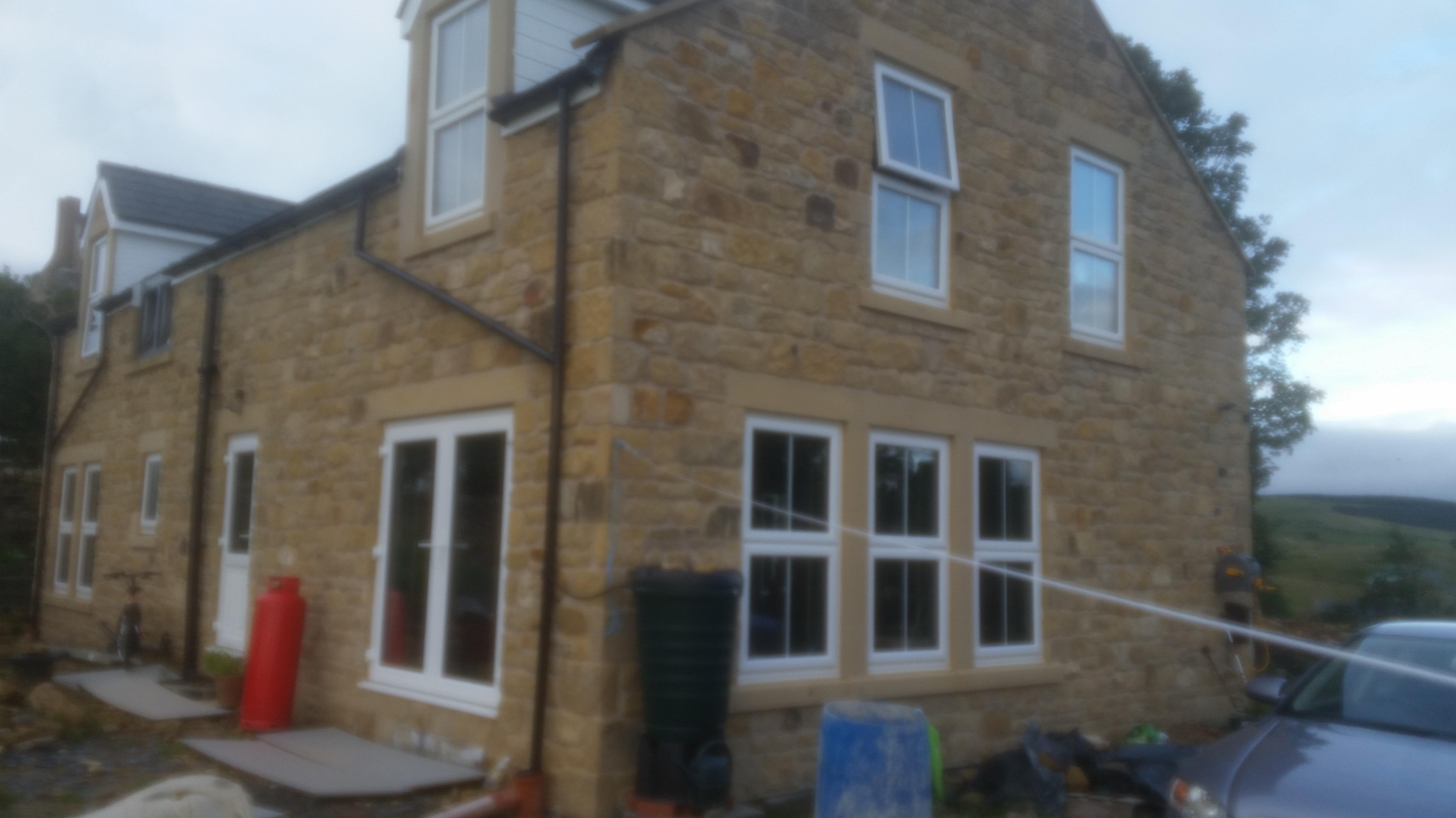

Well it has been some time since I did an update. Really busy at work and of course with the house.  Things have slowed now as money reaches an end, and as time goes on the finishing will be on a "when can afford" basis, but we always knew this, and one of the points of this whole exercise was to end up with a house we could never have afforded to buy of course.

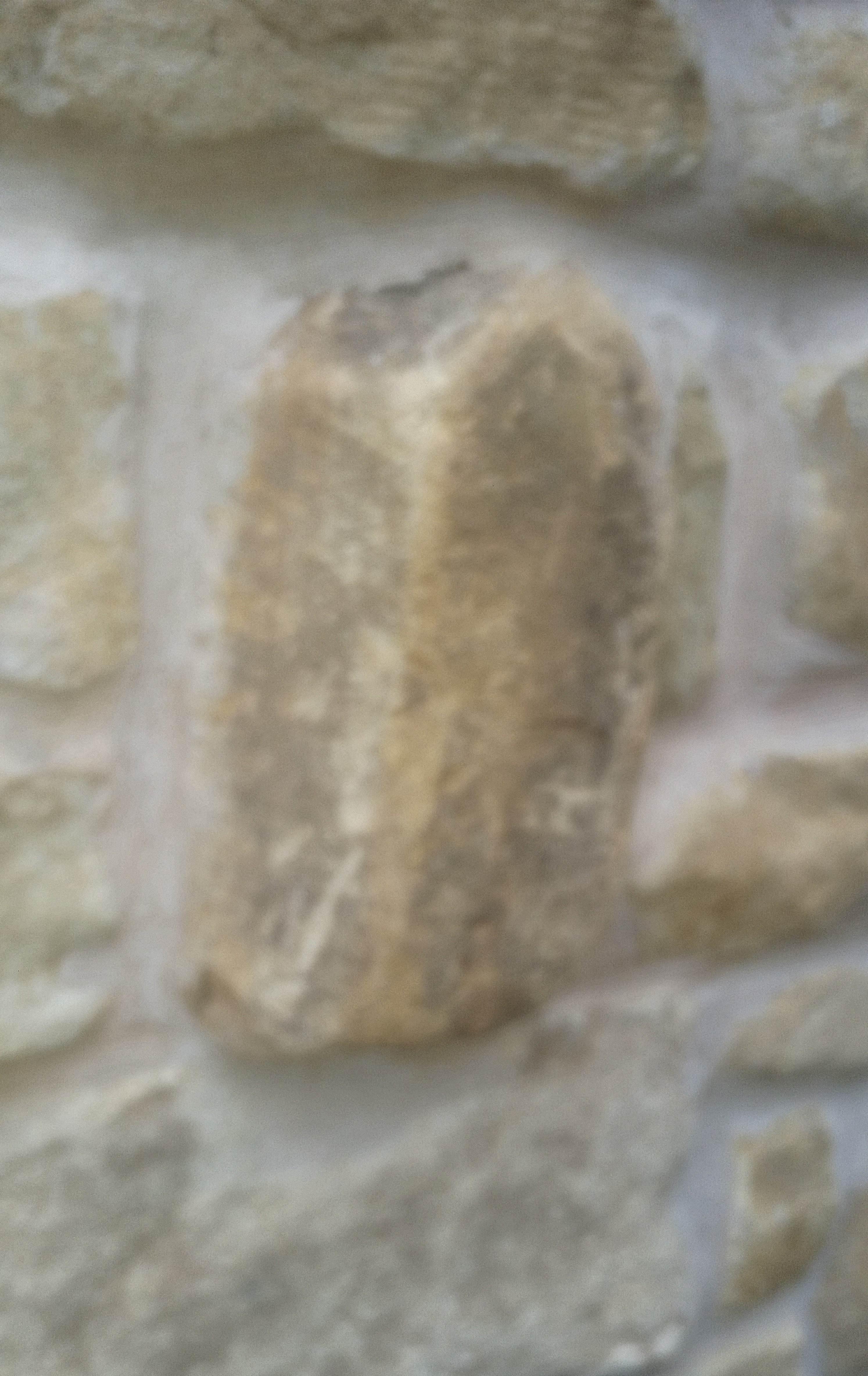

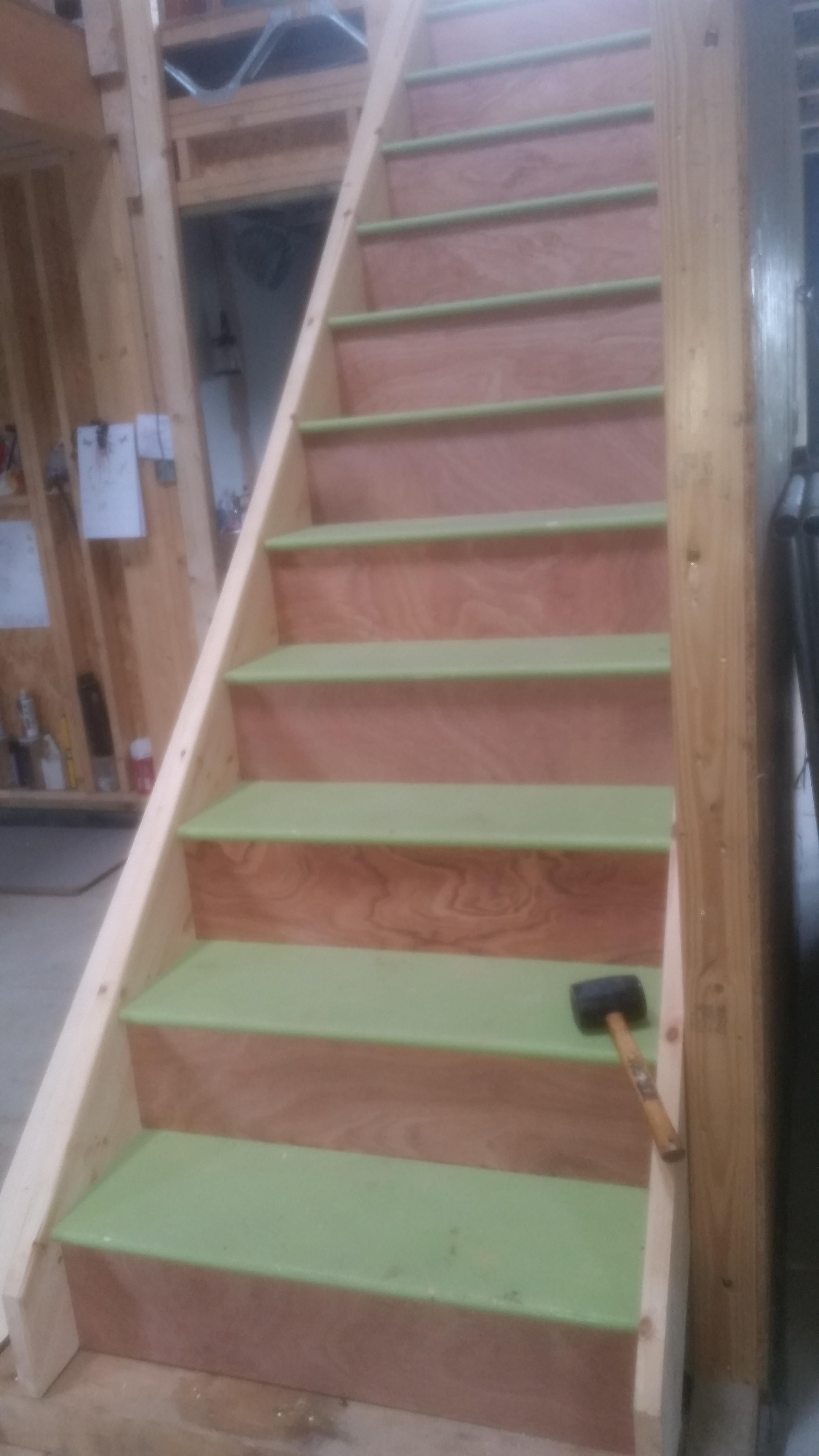

So the stonework is all done and looking great, and I have built the stairs and gave them a temporary coat of paint (they will be carpeted and the outer wood stained and varnished).   We even have a stone from a Saxon church incorporated into the house wall. This was found incorporated into then old drystone wall on the site which had collapsed and identified by the archaeologist we had to have on site. He said use it maybe as a garden feature but I felt that it would one day be lost so had it incorporated into the house wall - I plan to get a little plaque made for future generations to know what it is (there had been a Saxon church on the village green about 10 metres in front of our house before the "new" Norman church was built).

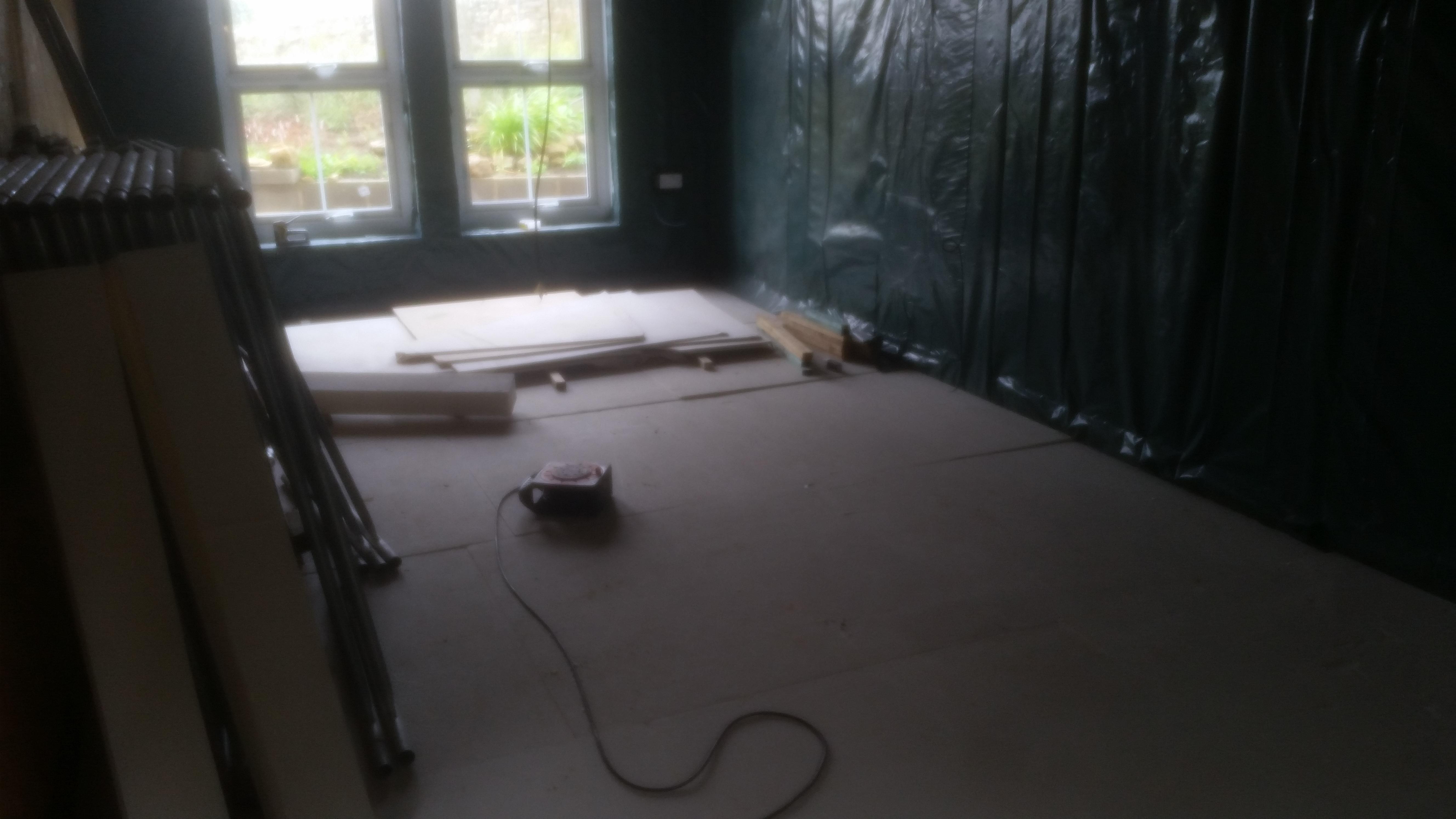

Next job is to finish the floor insulation. This is to be 200mm thick with a  100mm  screed and just under a kilometer of UFH pipes laid in.   So far we have the first 100mm in and I saved a fortune by buying seconds for that. At the end of the day it doesn't matter how pretty it is! Also, I've struggled to see why most of it is even "seconds" actually - one lot had a makers date of only 3 weeks earlier, was still shrink wrapped and immaculate.   It is not foil faced, and initially I bought some "proper" foil faced Celotex for the top layer. But I did wonder about the function of that foil in reality and what if anything it actually adds to the function. Reading a post on Buildhub suggests nothing in fact, with the poster stating that he believes that foil facings only serve a purpose with air space in front to reflect "into".  This kind of coincides with my own thinking and so I'm planning on doing the top layer in "seconds" too. I'm not convinced that even if the foil does some reflection of heat, that it would make a measurable difference between 200mm with foil facing or 200mm without. There being a polythene sheet of course over the top of the insulation before our 100mm thick concrete screed. The 50% saving on buying first quality from the builders merchants will buy us one hell of a lot of gas heating anyway, and if I've calculated correctly, several years in fact. The panels we got have a thin glass fibre covering which also makes them if anything stiffer than the purely foil faced ones. In total, they've allowed me to do the insulation for about half the price by buying them by the pallet load.   In the photo is the "snug" room, which is about 7.5m x 3.5m to serve as a sort of second sitting room with the large TV in it. The beauty of this room is that should we need it in years to come when maybe stairs become an issue when we get old, it will make a downstairs bedroom quite easily.  Shown here, it has the first 100mm of insulation down.

That's a fine looking house.  I have read some of your old blog posts and it seems that you are living in it now - is that correct?  Are you just living in the upstairs part if you are still doing the floors downstairs?  Sorry to read about all the stress you have been having with loans and so on.  My own future build will have to be very low budget as I cannot borrow and so it all has to come from cash (which I have little of).  I did feel quite held back by this but having read your experiences with Build Store I feel a bit better now.

A nice looking house, that. I particularly like the gable top / roof detail, very neat way to close that junction off.
Keep going, it'll be well worth the blood sweat and beers. :)

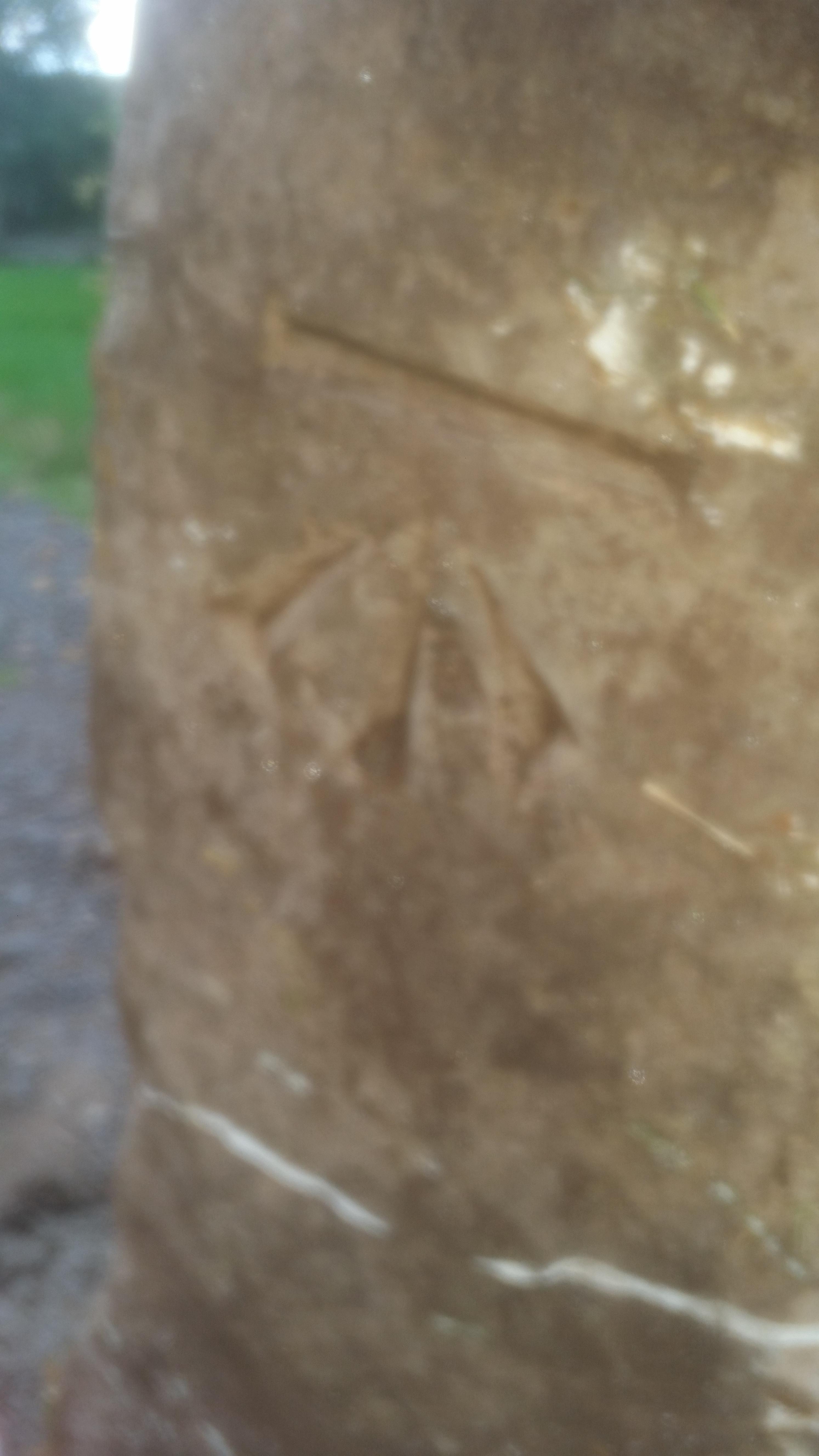

Where’s the photo of this Saxon stone then? You can’t just leave that hanging! Will it influence the name of the house? Ethelred the unreadys byre?

Lesgranepotato - the Unready could indeed be very apt! ?   Well it's not particularly glamorous, or a new rosetta stone, but here it is - it is roughly hexagonal but obviously you only see 2 sides now it is built in. The mason deliberately made it stand proud of the other stones so it can be seen - I think he really liked the idea. Excuse the quality, but I smashed my phone lense!   A better camera would probably make it a lot clearer as to why it stood out when it was amongst other stones.        As for the house name, it was to be Curlew House, since you see and hear them here and it is also my favourite bird (the call of the bird just fits into the Northumberland moors perfectly) as well as the symbol of our National park, but then I found someone had given a twee holiday cottage the same name. So we went for a historical name (Todcroft - meaning Fox house) as the next house down was called that in about the 17th century  before becoming the village school, so the name has a historical connection.  Interestingly, we also found a Henry VIII coin on the site!

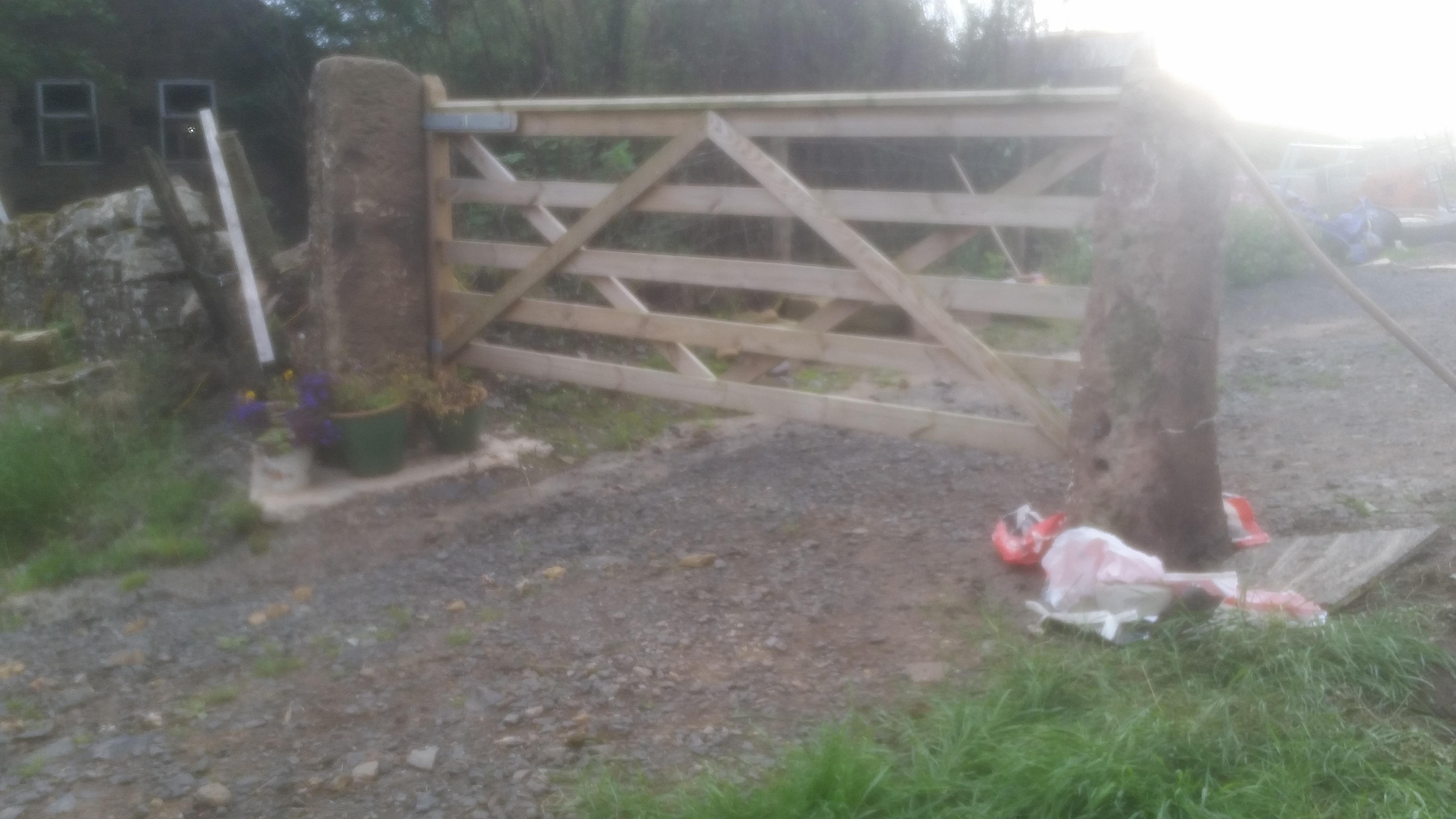

So for out the front  I've managed to scrounge another 2 stone gateposts free of charge! (making 4) The beauty of these is that now I've concreted them in, they will be entirely maintenance free for the rest of my life. I plan to add a third one beside the gate to make a small "wicket" or pedestrian type gate alongside.  Fortunately a farmer friend had a massive machine on loan which was capable of picking these last 2 up in one go and carrying them down for me (another reason I love living in a rural community is how much we all help each other - in the winter whilst living in the caravan we were very genuinely offered accommodation if we wanted it from no less than 5 different people. It is amazing how kind people can be, and even though we did not take them up, I'll certainly not forget who they were should I be in a position to help them in the future). One has an old "bench mark" which was how the old ordnance survey system was done with spot heights. The post had long fallen out of place and was more than half buried in the soil when we found it. It makes you wonder how many of these are slowly disappearing into the soil. I know of several, but having the machinery on hand to move them is the problem since they are too heavy even for most farm front loaders on tractors to manage.  I've also seen them snap when lifted!  I really like the character and story of using recycled materials like this. We can only begin to guess at the age of these posts for example, but what is nice is I know exactly where each has come from.  It also makes the development feel "organic" to the place I think.

Those gate pillars are fantastic - very jealous, though they would look a lot out of place on  y house

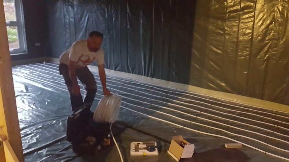

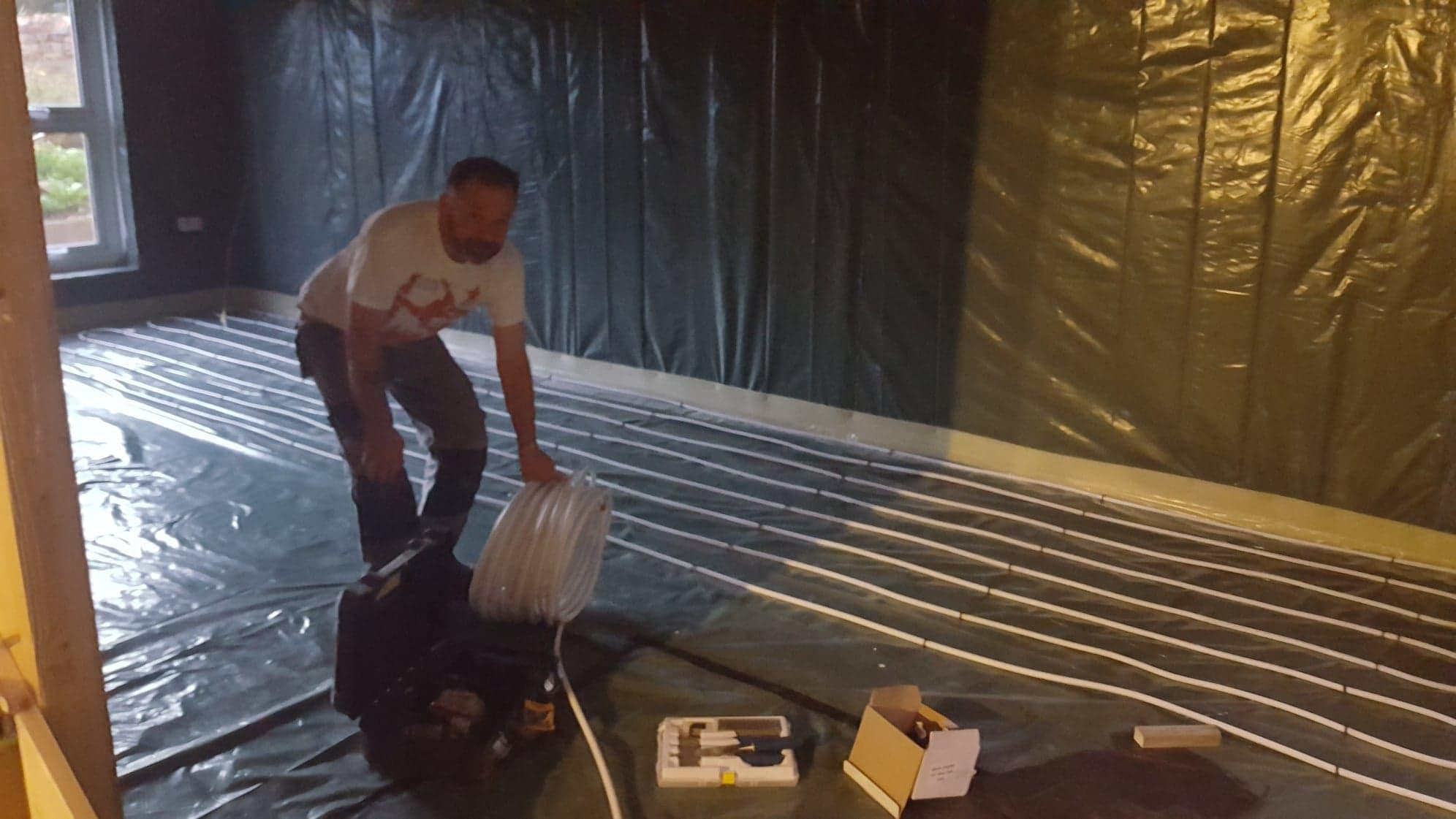

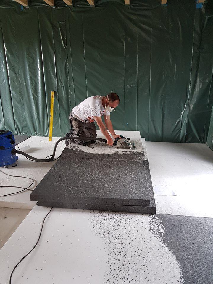

So, in the small sitting room, or "snug" as we are now calling it, which is 7.5m x 3.5m I have 100mm of Celotex type PIR stuff (from Seconds & co) as a first layer, then to keep costs down went for EPS70 for the upper layer in the end.  Oddly I found some of the pallets from Seconds & co of Celotex/Kingspan type, worked out more expensive than new, so I did a lot of shopping around. For the difference in u Value, because the whole is 200mm, using the EPS over PIR for the top 100mm proved irrelevant really, but saved me a lot of money at a point in the project where this is beginning to matter greatly. We are still talking massively over and above code and I think the reality is in real life use, the difference between using EPS or another layer of PIR will have no measurable effect.  Your definitely well into diminishing returns I think.    So next was to get the UFH pipes down. In this photo I'm half way through, with the first 100 metres of pipe (96 metres actually) down and the second loop going down.  I did get a quote for the screeding of the entire ground floor (though I did the downstairs bathroom and utility room (currently functioning as a temporary kitchen) myself with dry mix), I am considering doing this room myself. We have 2 mixers available and myself and at least 2 other men to mix and barrow, so I'm considering taking a few days off work and doing it ourselves. The large room I'll definitely leave to the pros as it is A. large and B. "L" shaped.  The advantage would be that we'd then have somewhere to put all the stuff currently in the large room whilst its floor is being done, whereas at the moment it would all have to go outside for about 48 hours!  It's quite a physical undertaking though as I learned from the bathroom and utility, so I'm going to give it a bit more thought! ?
