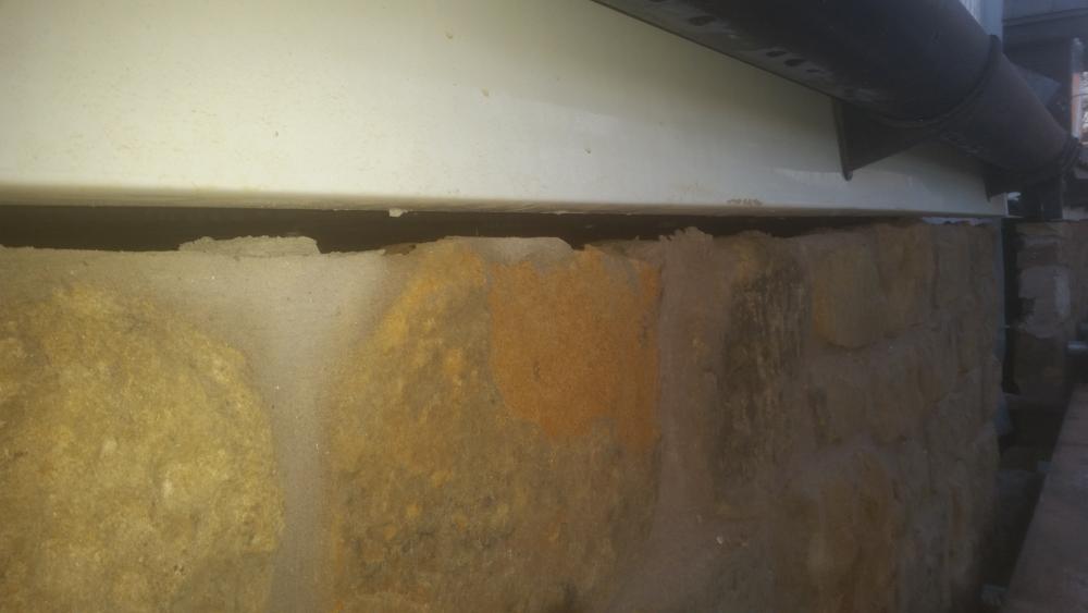

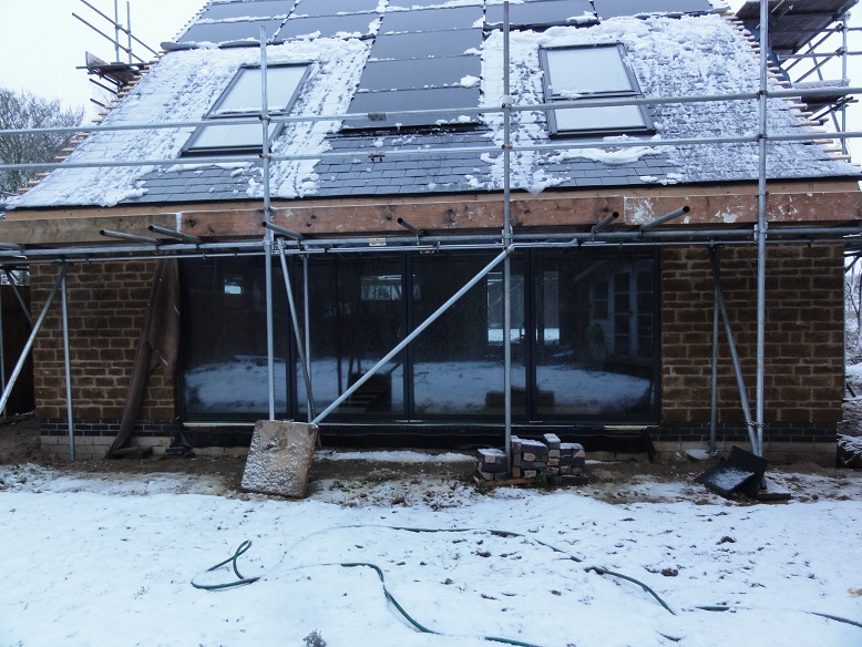

Anyway one of the many issues our BCO/Warranty Inspector has with SIPs is that he is convinced they shrink massively. One of the numerous enquiries he made me do with the different companies for him was to find out the shrinkage (yes, I know, I too pointed out to him that OSB has, as the name would suggest "oriented" strands, which by going in different directions, largely mitigate against this when compared to standard timber) from Kingspan - as around this time I'd had enough and told him that as a BCO he was more likely to get a comprehensive answer than I was when he kept making me go back time after time to the suppliers, challenging their methods and suitability of the materials (even the BBA markings on each SIPs panel were not enough for him to believe them to be an "approved" building material in his view!) . So he contacted Kingspan who gave him a figure (I forget now, but it was absolutely tiny). So he spoke to our mason and made him leave a whopping great gap  around the entire house between the stonework and the fascia/soffit  to allow for the SIPs shrinking.  Now on one level I get his thinking, that if the soffit was hard against the stone, then if the SIPs did shrink to any appreciable degree, it would presumably force the soffit out of place or crack it.  But this massive gap all the way around makes for fantastic and constant convection from the air bricks at the bottom, and none of us are convinced the shrinkage will be anything like he fears, if it happens at all.  Yes, the cavity definitely needs to be ventilated to stay dry, but this big a gap all round will set up a constant and quite massive convective flow in my mind - and we are trying to build a low energy house!  OK, so the cold air will be rising against the outer OSB, behind which is all the SIPS insulation, but it's still going to be a constant and high flow situation (I used some smoke on the one still day we've had and there is a clear constant convection going on, even with the tiny amount of heat we have inside right now) drawing heat off.
So my thought is to use foam or similar compressive material to close most of this gap up. Though I think I'll insert something like wire mesh in places to allow some air flow still for obvious reasons, but I think it surely doesn't need to be a raging flow 24/7 around the entire perimeter. The trouble is, if I were to ask the warranty guy what material he'd recommend, he'll either insist we allow the place to lose heat and do nothing, leaving this gap all around, or he'll make me contact the SIPs manufacturer/foam manufacturer/builder et al to "ask if its a suitable material to use with SIPs" (as that's the answer I get to everything from him if I ask - making me seem a pest as I keep having to go back to these companies and pass on his often silly questions).

You need a fibre cavity sock to close that off - they are a standard product which you can just leave a few small “gaps” in to vent but that is all you want.

Good point PeterW, and there are cavity socks all over, round all the openings etc. Unfortunately the gap is too small to fit anything much in now.  I guess something more compressable than the fascia & soffit board will be the thing (I suppose I could stuff it with rockwool and maybe close the front of the rockwool off to keep it dry with silicone, all tucked well back so it's not visible so doesn't look odd.
Our mason also pointed out (quite rightly) that we'd have the worlds supply of wasps nests, bats etc in our walls with that gap left as it is.
Link to comment
Have a look at compriband expanding tape.
Now is the perfect time to install it, while it is cold (keep the roll somewhere cold until you need to use it)
In this cold weather it takes a long time to expand, so plenty of time to unroll it and slide it into the gap then it will gradually expand to fill the gap.
How big is the gap...?? And how many airbricks are there..?
Not condoning this behaviour at all, but I'm with your mason and tbh as soon as its signed off I would be stuffing all but 2 of the airbricks with expanding foam, and the others would get stainless steel wool in them to keep the wasps out !
Link to comment

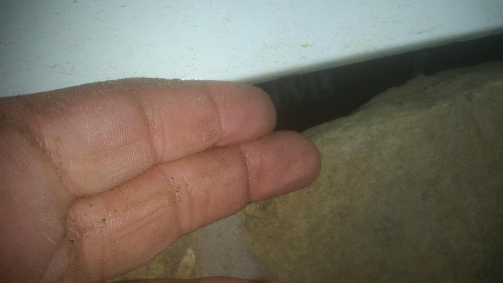

Airbricks are every 1800mm as per architect plans/regs, but its more that massive all-round gap (200-300mm all along on the front & back elevations of the house) that concerned me really. On their own the air bricks are not an issue and it was that massive all round gap ensuring far more than the gentle air movement required to stop damp/moisture build up which meant we'd be wicking off heat constantly, albeit on the far side of the insulation, which concerned me (not to mention all the beasties which would be living in the cavity of course) . I don't know anyone else whose doing timber frame or sips with a stone/brick/block outer to know if this big and all round a gap is normal or if its yet another of my BCO/Warranty Inspectors own special rules.

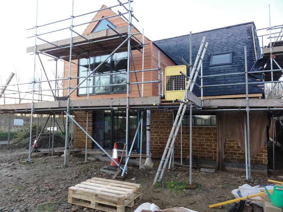

I haven't got any airbricks in my stonework.
I am worried now that I should have.
I didn't see any on @TerryE stone work.
I have a closed panel timber frame.
I have 1.5 m of stonework on the rear, either side of the 6m of glazing, & 1m & 5m on the front, to the underside of the roof overhangs. Single Storey.
50mm cavity.

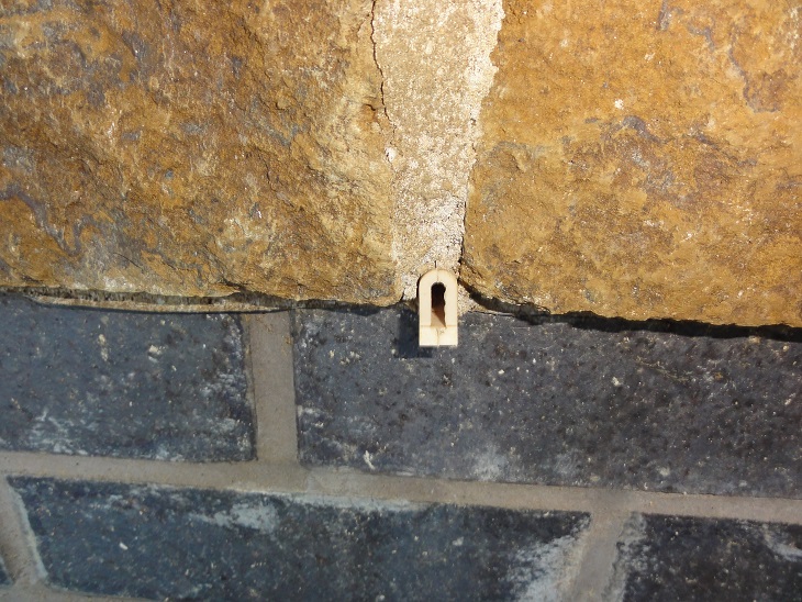

Moira, don't worry, in fact your post made me go back and look and of course you are correct! My ventilators actually only ventilate the underfloor cavity and only appear to be in the walls because they have telescopic extensions ... as I should have remembered since I fitted them  Image result for Doh .
 Image result for telescopic ventilator
So the current high level of air flow coming out of the top gap is coming in via the cavity openings where I have not yet fitted all the cavity closers. After that the only real in-flow should be via the weep vents at the sides of the ventilators, sills etc.  So thinking more about it, the incoming air flow will be greatly reduced, but I still need to block a lot of that top off to keep it in check and keep out all the creatures that would no doubt end up accessing our cavity via it. Compriband does seem an ideal solution, with a wire mesh gap at one or two places to allow some flow to ensure it doesn't get damp.

I took your advice and bought a roll of compriband to try. I'm well impressed and have ordered more rolls. As the stone is random sized,  the gap varies considerably, so the ability to buy different expansion sizes makes it  the perfect solution. The soffits themselves are of the ventilated variety though I'll still leave some air gaps of course, but with mesh to stop insects. Where we are, there's a good 10+ miles  clear down the valley between our house to the moors opposite, so we get a fair old blast from the prevailing wind off the moors so I'm quite happy we'll still get ample ventilation in the cavity.

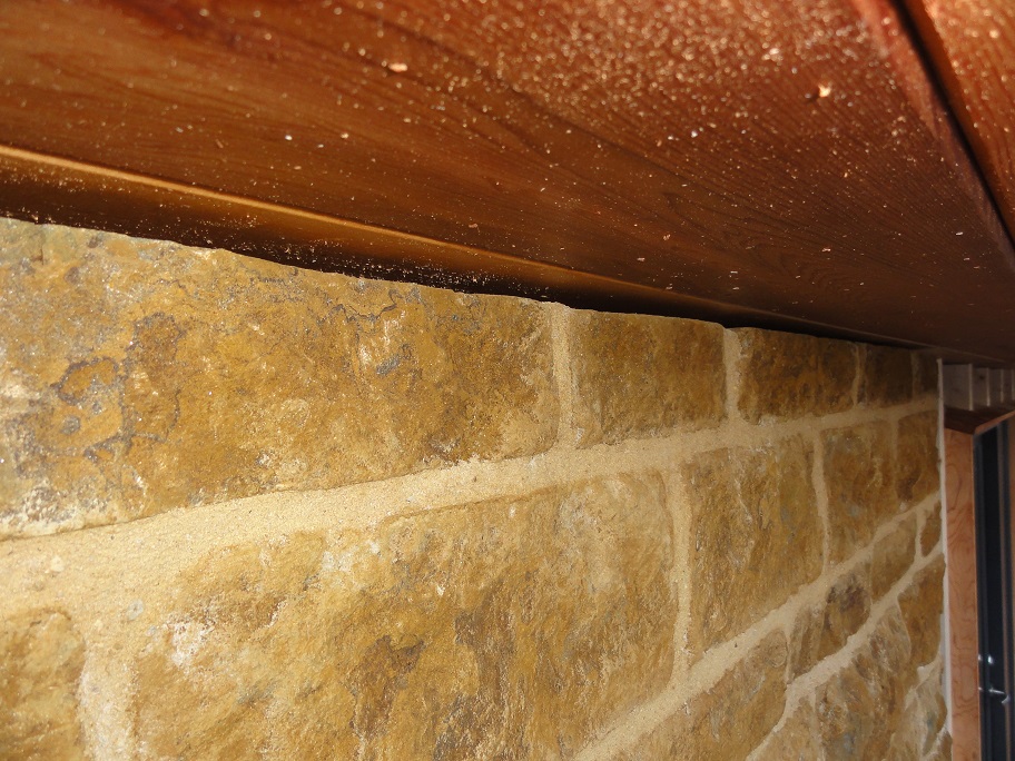

This thread has made me think about my build.
I do not have an architect on board so am learning as I go along.
I have a small 10 -12mm gap from the top of my stonework to the underside of the cedar clad overhangs.
I was going to have this pointed up to close the gap.
I have a closed panel timber frame with a 50mm cavity & ironstone cladding.
This is only for relatively small areas on the front & rear elevations.
There are weep vents at the base of the stonework.
Your thread makes me think I will need some air vents at the top.
The gap is so small I may have a problem finding something.
Would manthorpe weep vents spaced & placed horizontally be suitable with the lime mortar pointing in between?
Any ideas gratefully received.

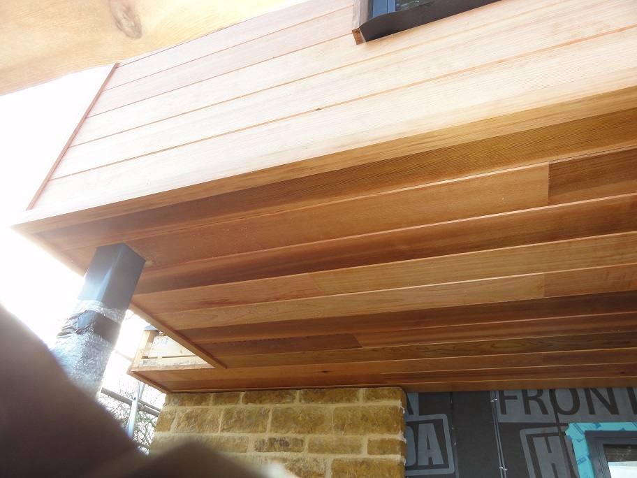

The cedar cladding is going to continue either side of the glazed front door & sidelights on the right of the photo.DSC01422.JPG.aca8dd537b6722efffc479f87bd2a7ad.JPG

You need to start by asking the question as to where will moisture get in from ..??
Continually venting cavities has been proven to be inaccurate - just look at how we went from 9” solid to a pair of 4” “cavity” walls  to stop damp and now we pump them full of insulation ..!
You may need a small vent every so often but I would want that filled to stop wasps etc getting into the gaps
