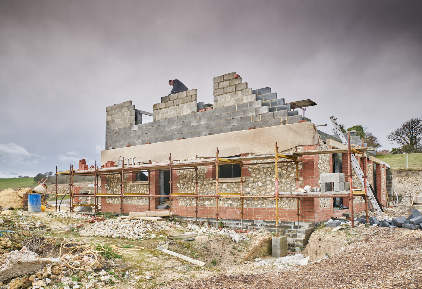

Photos of work on new house Entry posted by sussexlogs March 29, 2017 2651 views Share More sharing options... Followers 0 1
Declan52 1668 Posted March 29, 2017 Hope the health & safety Nazi doesn't come round and see that guy building like that!!! Link to comment
sussexlogs 134 Posted March 29, 2017 (edited) 3 minutes ago, Declan52 said: Hope the health & safety Nazi doesn't come round and see that guy building like that!!! its me and all my own work Edited March 29, 2017 by sussexlogs Link to comment
Declan52 1668 Posted March 29, 2017 Wouldn't get away with building overhand and the outer scaffolding not up to the same height here. I would have the mortar board up another block, save the back a bit. Link to comment

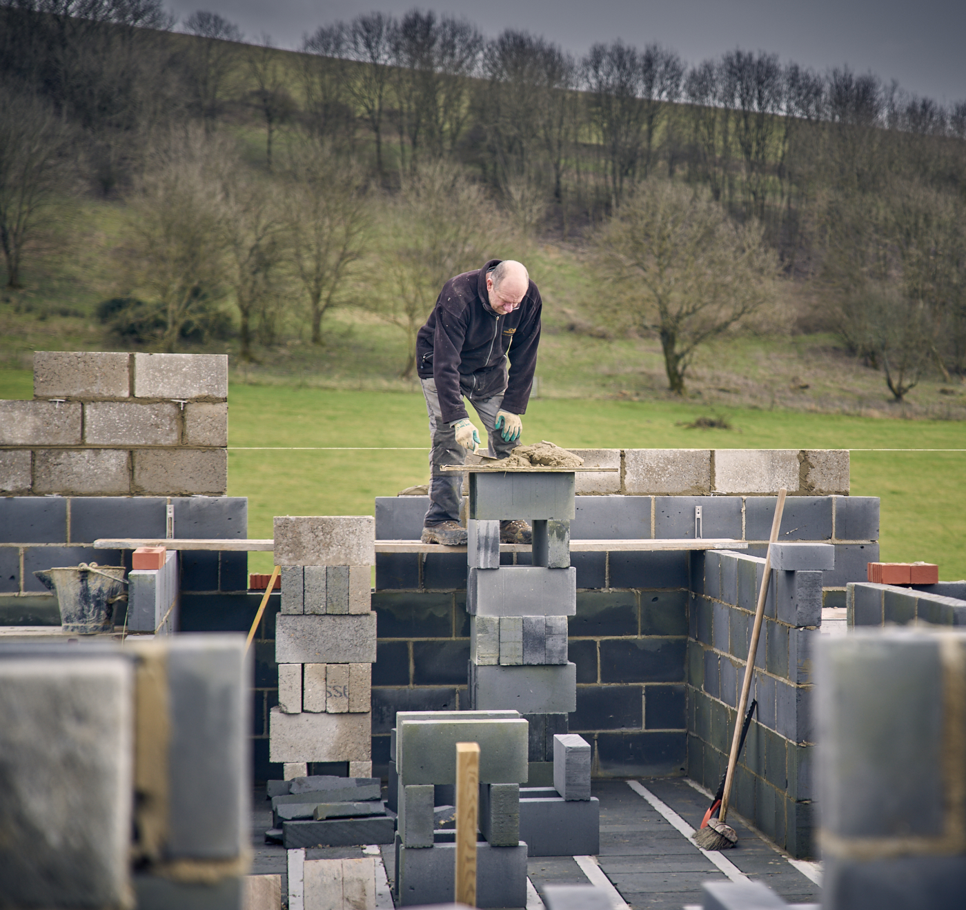

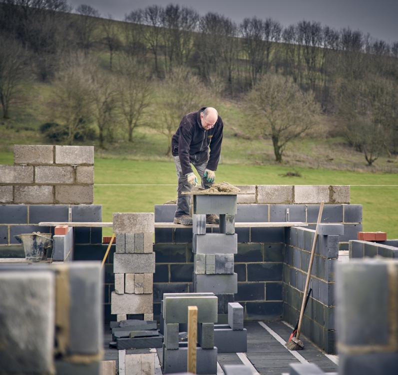

Declan52 1668 Posted April 1, 2017 Nothing gave me more satisfaction that building my own house so hats of. Slightly curious why you have the line you are building to on the 2nd last pic on the inside of the block. Link to comment
Oz07 601 Posted April 1, 2017 It's being built overhand. Guessing he doesn't want to climb out on the corner to take the line up! Link to comment
Declan52 1668 Posted April 1, 2017 Has line pins under the first block so makes no difference, still has to lean out and move the line up. Can only plumb one side of a wall so the most plumb bit of that wall is on the inside. Just never seen it done like that before. Link to comment
sussexlogs 134 Posted April 2, 2017 (edited) The reason the corner isn't built up Is It is a catslide roof and the reason the line isn't on the outside is because the wall ties which hold the flint work on and on the outside and would interfere with the line hope that makes sense Edited April 2, 2017 by sussexlogs Link to comment
