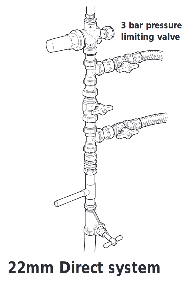

If you have a Combi boiler, or SunAmp, or pretty much any device with a built in Plate Heat Exchanger (PHE) and live in any region which has hard water (about 80% the UK population), then you will need a water softener if you want any decent life out of your plumbing installation.  As far as I can see you are down to one of two options for a direct plumbing solution: the UK Harvey twin tank system and the US Kinetico range.  All of the rest are niche suppliers, IMO.  The Harvey system seems to be viewed as the best in terms of performance and running cost; and a few of the others on the forum use one and have recommended it, so we went with this choice.
The basic Harveys internals are boxed and rebadged by a number of suppliers: Harveys, TwinTec, Fountain Softeners, but the versions currently shipping are one of four standard Harveys models under the hood: 500, 750, 1000, 1400 (which relates to the volume of water in litres per flush).  And these have a guideline maximum PPM of 320K/<model no>, so the 750 is advised for a maximum of ~ 430 ppm water hardness. This is the one that we have.  Each flush on the Harvey is 17l, so the 750 flushes 17/750 = 2¼% of the water (which incidentally is under the 4% threshold on the Water Usage calculation required for Part G approval).
So in our household we use ~250l /day and so will do 10 flushes / month @300g salt per flush or 36 Kg of salt p.a. 12 × 8 Kg block salt costs £72, so our expected annual salt cost is approximately £27.  A lot cheaper than some alternatives, and this has to be offset against reductions in soap and other consumables.
Now to my big bitch. I was researching the performance data of the Harveys Softene and trying to find simple performance data on the typical pressure drop vs flow.  Talk about shifty and evasive.  You can't find this anywhere on the Harveys site; ditto the TwinTec, and the Fountain Softeners site.  I also tried an email to my named contact at the last, but got no reply one this.  There's lots of qualitative hand-waving in YouTube videos and promotional material, including from Mr Harvey himself -- all to the effect that the pressure drop is not that bad / a lot better than the competitors, etc.  Calculating this pressure drop vs flow graph isn't difficult.  These curves all approximate well to a power curve, so the tester will normally takes a few PD : flow measurements over the working range of the appliance, plot them on a loglog plot; fit a straight line; and then invert this back to the power curve.  OK, in the case of a water softener, the actual value might vary over the flush cycle so you might need to put in a upper / lower band on this curve, but all of this naaa-di-naa-daa sounds like they are hiding something to me.
So after a bit of Google searching I happened across a link to a PDF on a website run by a landlady in Reading (how Google found this, I have no idea).  This was the standard 4 page installation guide that is most of the sites, but plus a fifth "Technical Data" page: which includes this plot.  What this shows is that at a 30 l/min flow rate you are loosing 1 bar through the softener,  This equates to a couple of showers going at the same time as the kitchen sink.  However if you have power showers or the like, then by 45 l /min you are at 2 bar and with the other system loses, your water system will begin to struggle if you only have a 3 bar supply.
Of course if you have an accumulator, then this will be positioned on the house side of the filter, so this will greatly mitigate this limit.

Looking at that pressure loss curve I don't think I'm going to fret over it, TBH.  With our shower running the pressure drop through the softener is only around 0.2 bar, and I can say from experience that we can't notice a 1 bar difference at any of the outlets, as that's the normal variation we get between the borehole pump turning on and off (it turns off at 3.5 bar and on at 2.5 bar).  Given that a 1 bar variation seems to have no noticeable impact, and as we'd need to draw off at three times the shower flow rate to get a 1 bar drop, I'm not sure that it's something really worth worrying about, unless you have a low mains supply pressure.
Our accumulators are on the hard water side, too, as they have to be in order to not put a reverse flow through the softener if one of the garden taps was used.  As I mentioned elsewhere, if the pressure at the softener outlet is slightly higher than that at the inlet then it can overflow the brine chamber.  Even with an NRV in line I think I'd be wary about fitting an accumulator on the outlet side, as NRVs aren't perfect one-way valves, they will momentarily allow a small reverse flow as they shut.  I found this out with the ones I fitted to the water treatment system, at the ozone injection point, and having discovered this the regs that say you must have a double NRV on the incoming supply makes perfect sense; it's to prevent that tiny, momentary, bit of reverse flow, I think.
If you have a high enough incoming mains pressure then the option of fitting a PRedV after the softener, to regulate the pressure to a usable figure, say 2.5 to 3 bar, might be an option.  That way the pressure drop through the softener might well have no effect at all.

True, but they are all on the input side, and they still give a 1 bar variation in pressure between the pump cut-in and cut-out pressure, so as far as the input to the softener is concerned it sees between 2.5 bar and 3.5 bar incoming pressure, so it's just the same as a mains supply with that amount of normal variation.

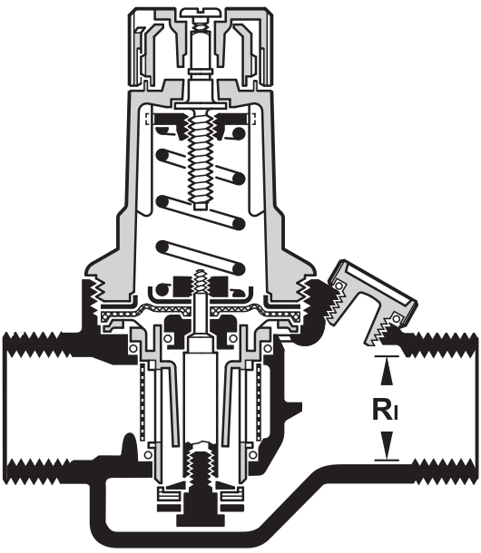

Here's the schematic of my PRV.  The slider which controls the flow from the inlet is set by an equilibrium between dynamic water pressure on the output side acting on the diaphragm and the compression is the adjustment spring.  The next figure is the Harvey recommended positioning of the PRV.
58a9b9a6ec19f_HoneywellPRV.png.042a1fe1d543fefaaa4436ce505dfad8.pngHarveywithPRV.thumb.png.e1202dda4bdb524798634c53097e847f.png
Since my static pressure is barely 3 bar, the dynamic pressure under load is going to be less than this.  The typical dynamic pressure on the PRV inlet side also include the pressure loss through the Harvey, so for anything other than trivia flow rates, the valve will be pretty much fully open.  And in fact on our system, I suspect that the PRV will always be open if set at 3 bar or higher.
Jeremy is correct that any accumulator on the manifold side will have a standing pressure of around 3 bar, so if the garden is suddenly fully opened then the mains supply side could drop below 3 bar causing a small back flow until the double check valve kicks in.
@JSHarris,  Jeremy a little Q:  what would happen if you replaced the bypass stopcock with a 2 bar PRV?  :)
First off, if the pressure on the manifold side of the softener is even a tiny bit higher than that on the inlet side I think there is a risk that the situation we had may occur.  Once this happens, it doesn't self-correct when the pressure differential is sorted out, water continues to flow slowly into the brine tank until the softener is isolated and then the pressure released, using the valves and an open outlet on the house-side.  When the valves are then operated in the correct sequence (outlet valve closed, inlet valve and main supply stop cock opened, bypass valve closed, outlet valve opened) the softener resumes as normal, but the brine tank needs to be emptied of excess brine and there is a chance that there will be brine in the water supply, too (we had pipes full of salty water that had to be flushed).  Having experienced this, I think I would be extremely reluctant to fit an accumulator on the manifold side of the softener, attractive as it may seem in terms of buffering the pressure loss in the softener itself.
I guess you could fit a 2 bar PRedV in place of the bypass, but they are usually also NRVs, so I'd be concerned about the pressure differential issue.  I keep meaning to call Harvey's about this, as it's not clear from anything I've read from them that this reverse-pressure problem can occur.  It may well be that it's not something that happens except under a very rare set of circumstances, as we only had it happen once.  In our case the higher pressure on the outlet side was because of the small pressure vessel on the old thermal store; it was enough to retain a 3.5 bar head on the outlet side with the valve closed, and I'd released the pressure on the inlet side deliberately to alter the upstream pipe work.  I just didn't think it mattered whether I opened the inlet side or outlet side valves in any particular order when I turned everything back on, and the outlet side valve was nearest..............

On reflection, I agree about the accumulator.
So let's focus on this PRV option.  If you thing about it, a PRV bypass can't cause a back flow whatever happens.  If you replaced it by a direct through pipe then all this is doing is connecting the input and output of the filter to the same source supply and you'd get no flow, surely?  What the PRV does is to open the valve based on the dynamic head in the output chamber of the valve so that at a two bar setting it is fully closed if this dynamic head is 2 bar.  With a mains pressure of 3 bar this pressure would be greater than 2 bar if the PD across the filter was less than 1 bar.
Let's say we had a demand flow of 40 l /min, say -- as the PD across the filter started to go to more than 1 bar (which is roughly the 30 l/min flow rate), then the  bypass PRV would start to open allowing a second direct flow bypass limiting the PD across the filter to 1 bar so roughly 30 l/min would flow through the filter and 10 l/min unfiltered would bypass it, giving a 3:1 mix of filtered to unfiltered water.   This is a pretty unusually high rate and might only occur <1% of the time, so the potential scaling risk from this is negligible.  However, at least the supply could then cope with these higher flow rates in a graceful manner. OK, the mix thresholds would vary according to the mains pressure, and if this did drop to 2 bar or below then you'd have the filter largely bypassed since the balance would by determined by the PD across the TMV.  and if the mains was higher than 3 bar, then the percentage mix would be higher.
I don't see our demand really ever getting above the sort of 25-30 l/min level, so I would bother with doing this, but I think that it would be an option for someone with a teenage or young adult family with high shower loads first thing in the morning.
