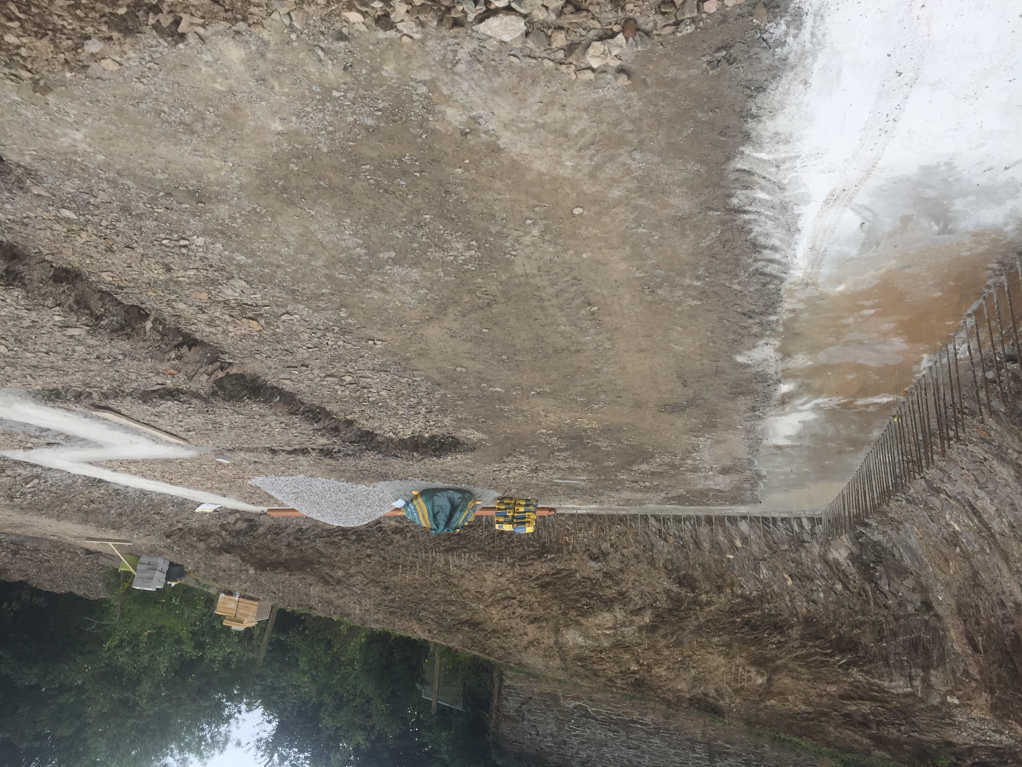

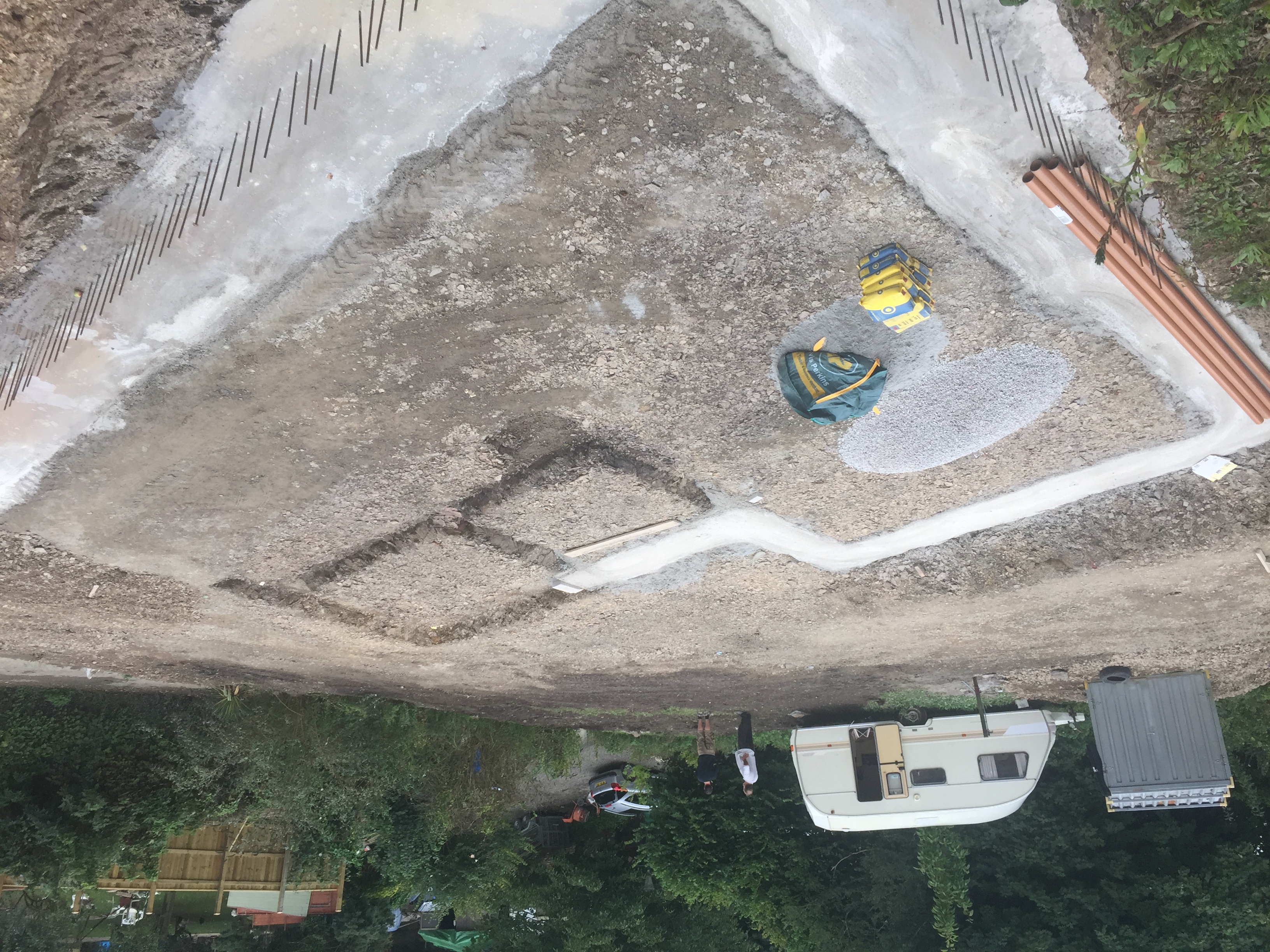

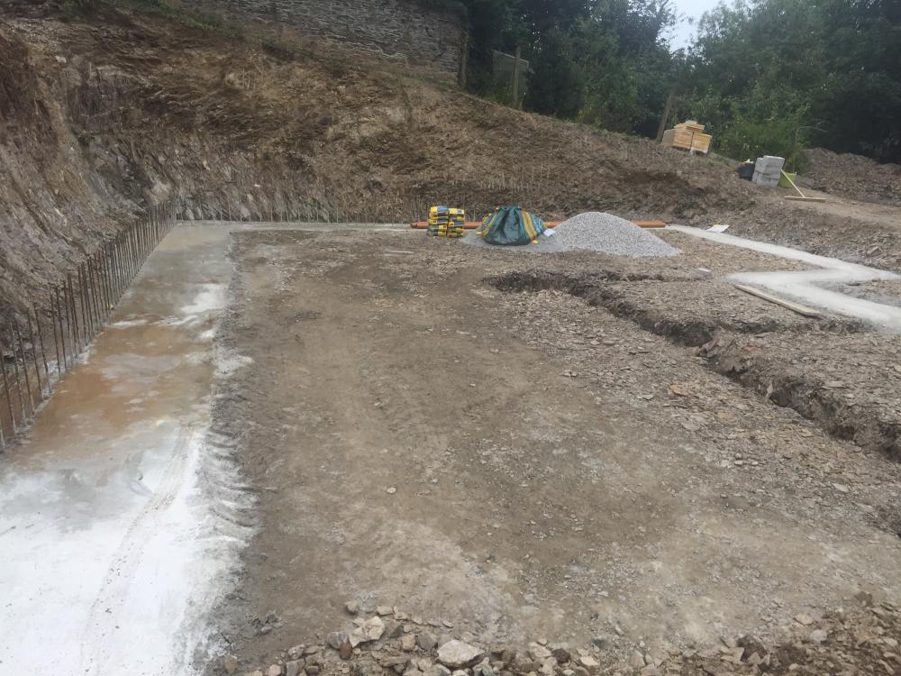

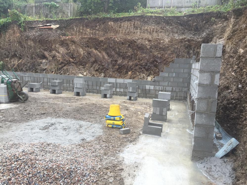

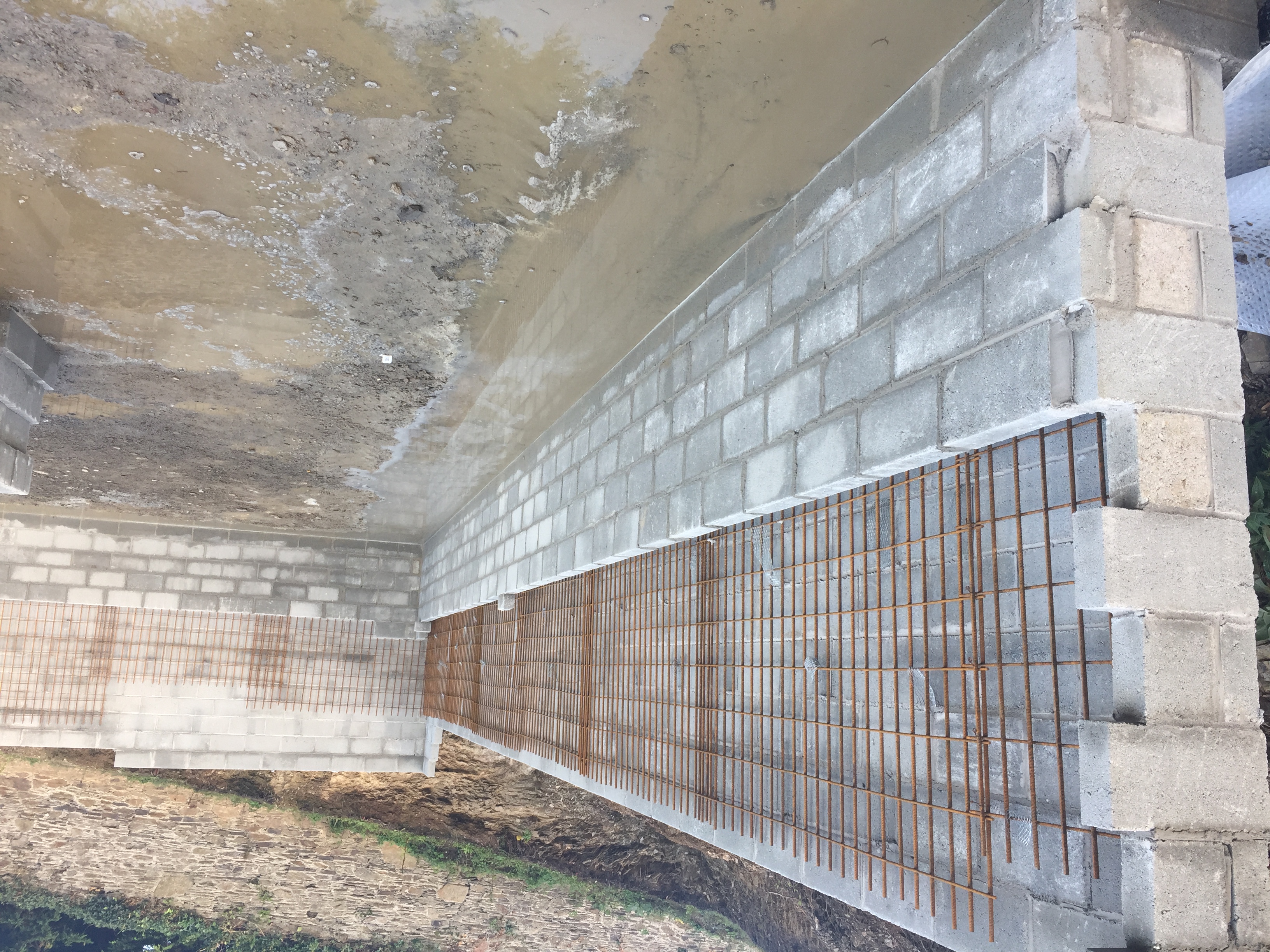

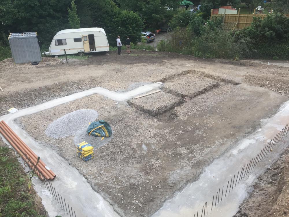

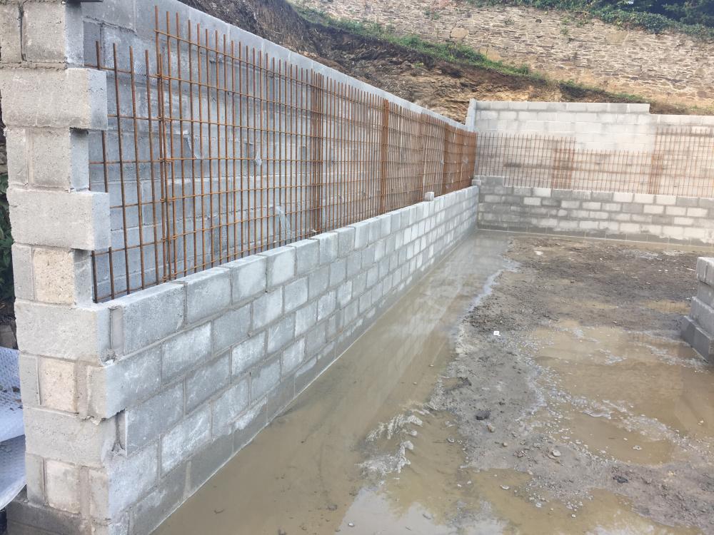

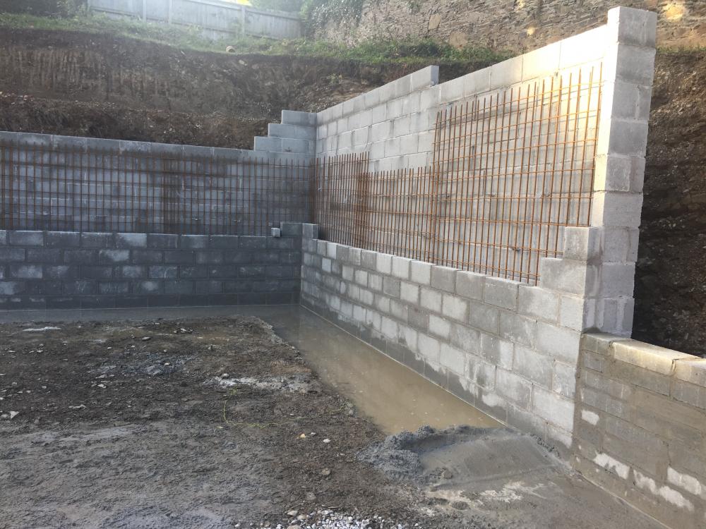

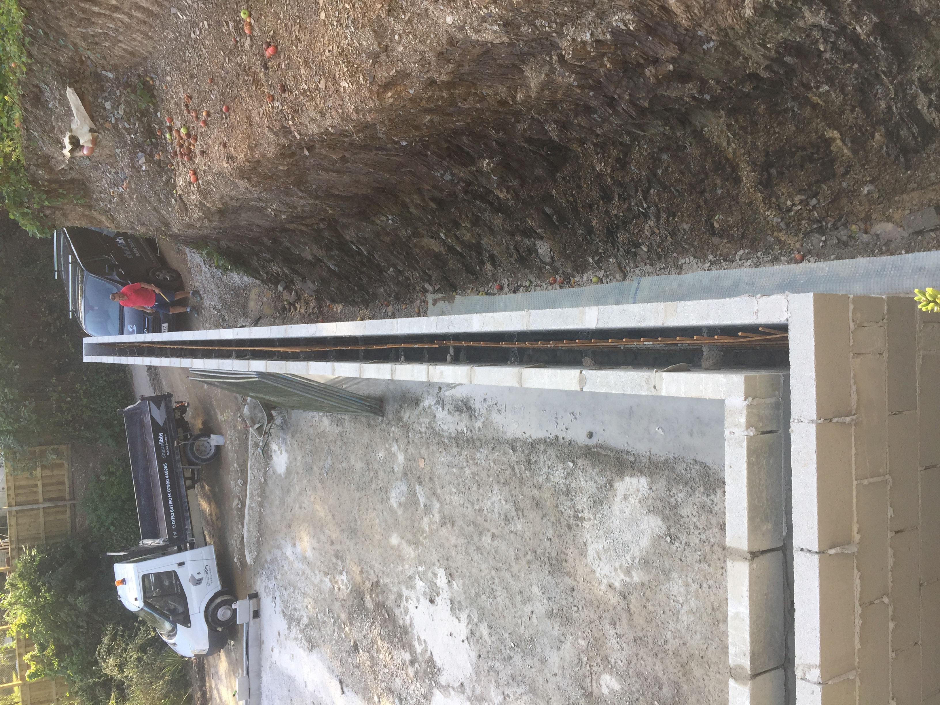

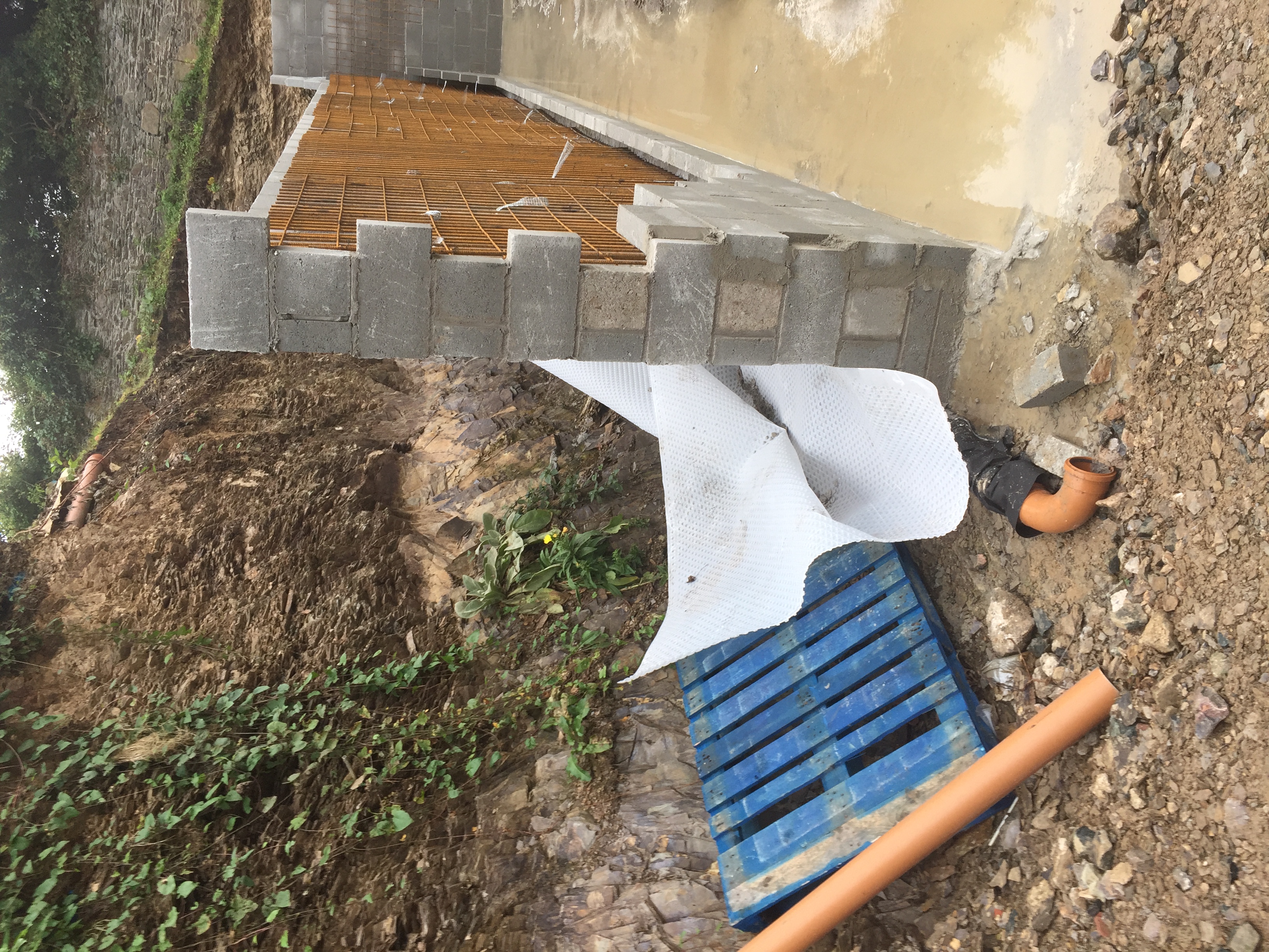

Finally starting to feel like I'm building a house! Steel reinforcing for the retaining wall has been put in, concrete in, first Building Control inspection and first warranty inspection all passed.
Builders lockup is now on site, I'll be taking my caravan down tomorrow so we can have bacon and brew facilities.
Feels nice ice for the property to be moving upwards in direction after so long going down in the ground!
If the concrete is in am I finally out of the woods with groundworks, or is there still potential for any nasty surprises to come out of the ground?

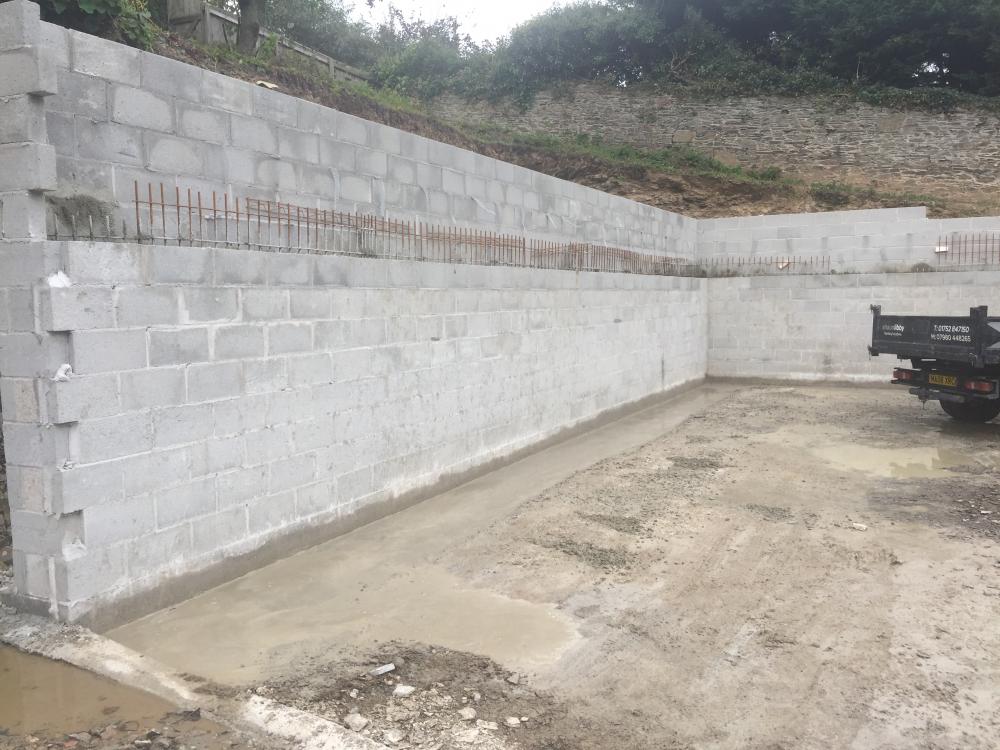

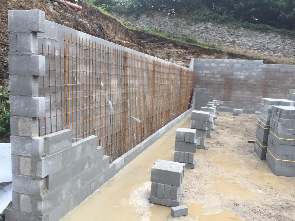

Okay, I have to ask. What makes that a "retaining wall?
I would have expected at least block on flat, if not two layers filled with rebar and concrete.
you appear to just have a single skin wall.
I am sure there is more to it, it just doesn't make sense -  yet.
Grosey

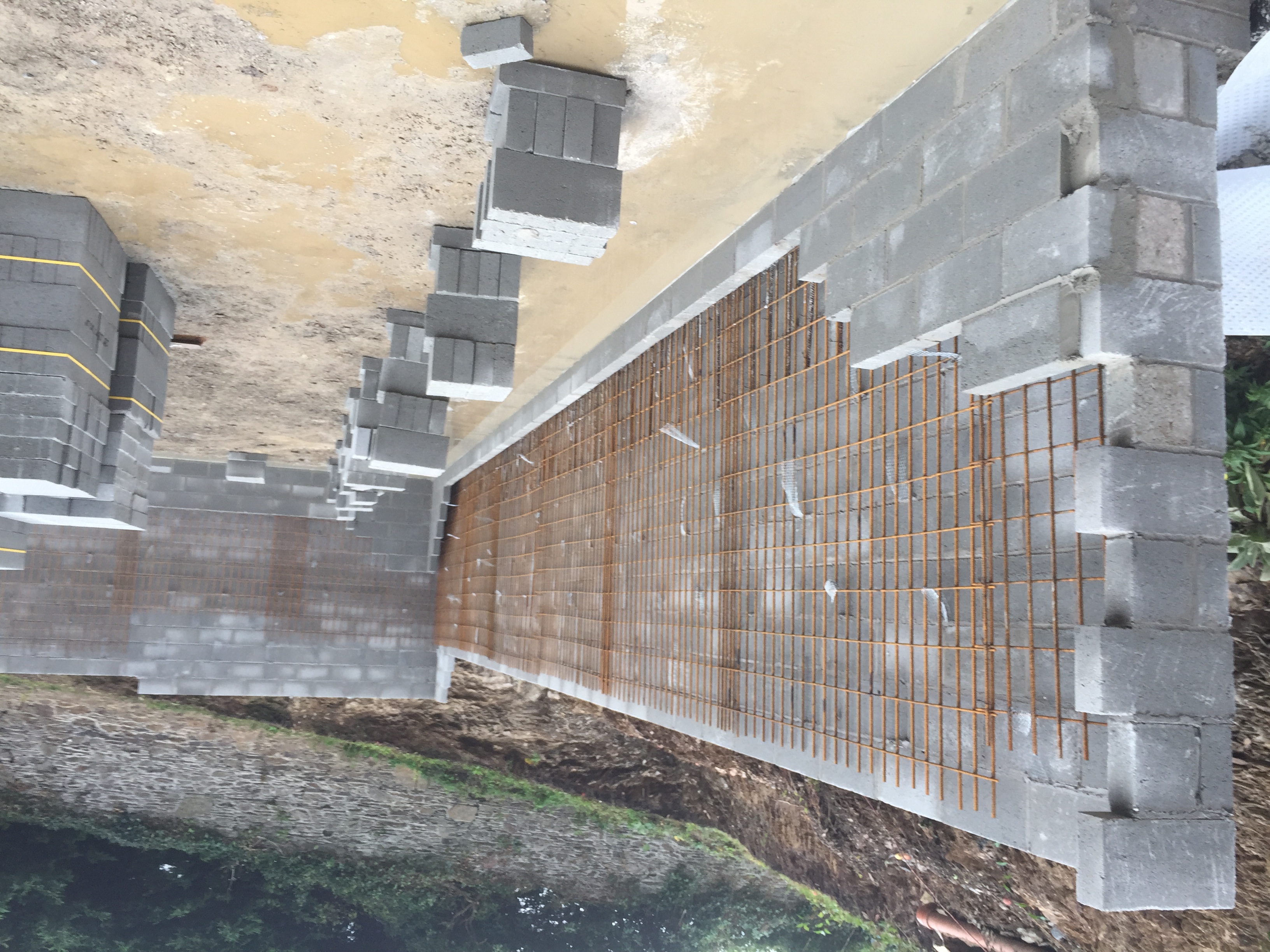

1st skin, steels already set in to the concrete, second skin will be built in front in approx 6 course batches then concrete between the skins, along with additional reinforcing mesh in the "cavity". The external side of this wall will be tanked, as will the internal wall of of the second skin.
Once all all that is complete a standard cavity wall will be built inside this lot to form the structure of the house. So this whole wall will end up with 4 "skins"
By all accounts apparently this wall is majorly over specified and could probably retain a mountain when it's complete.
Yes that makes sense now. Look forward to seeing it take shape.

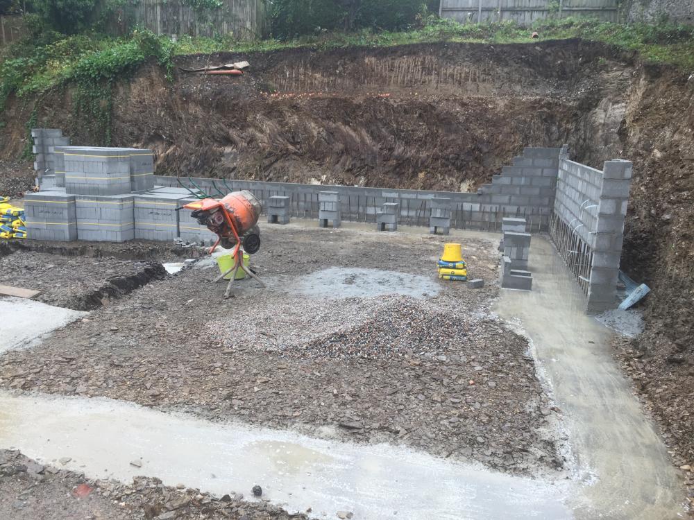

Grosey

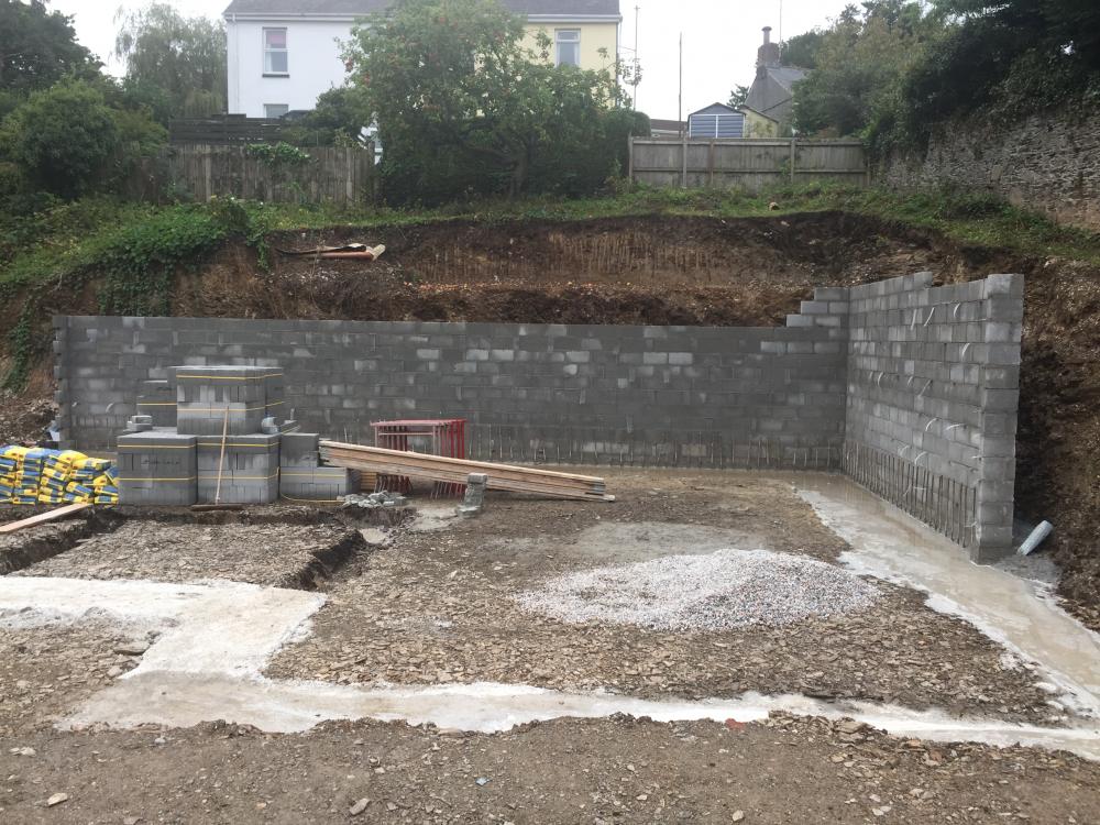

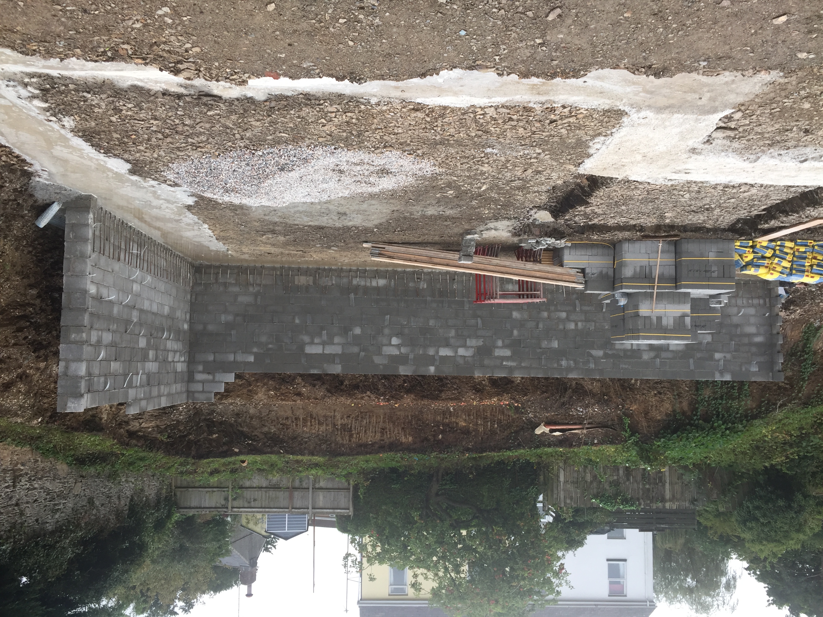

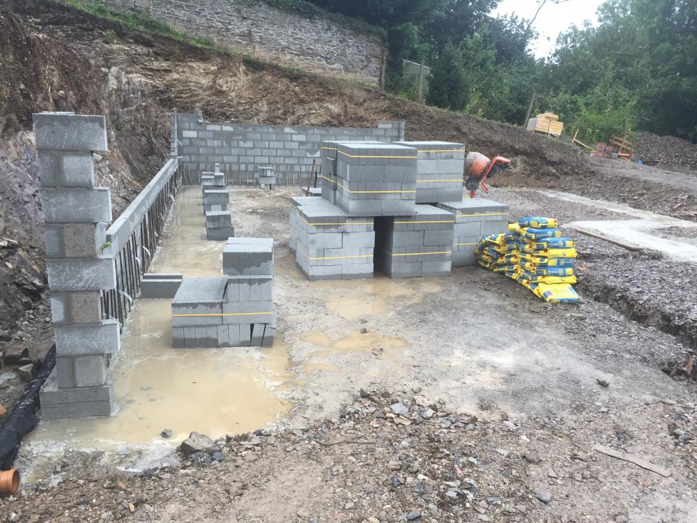

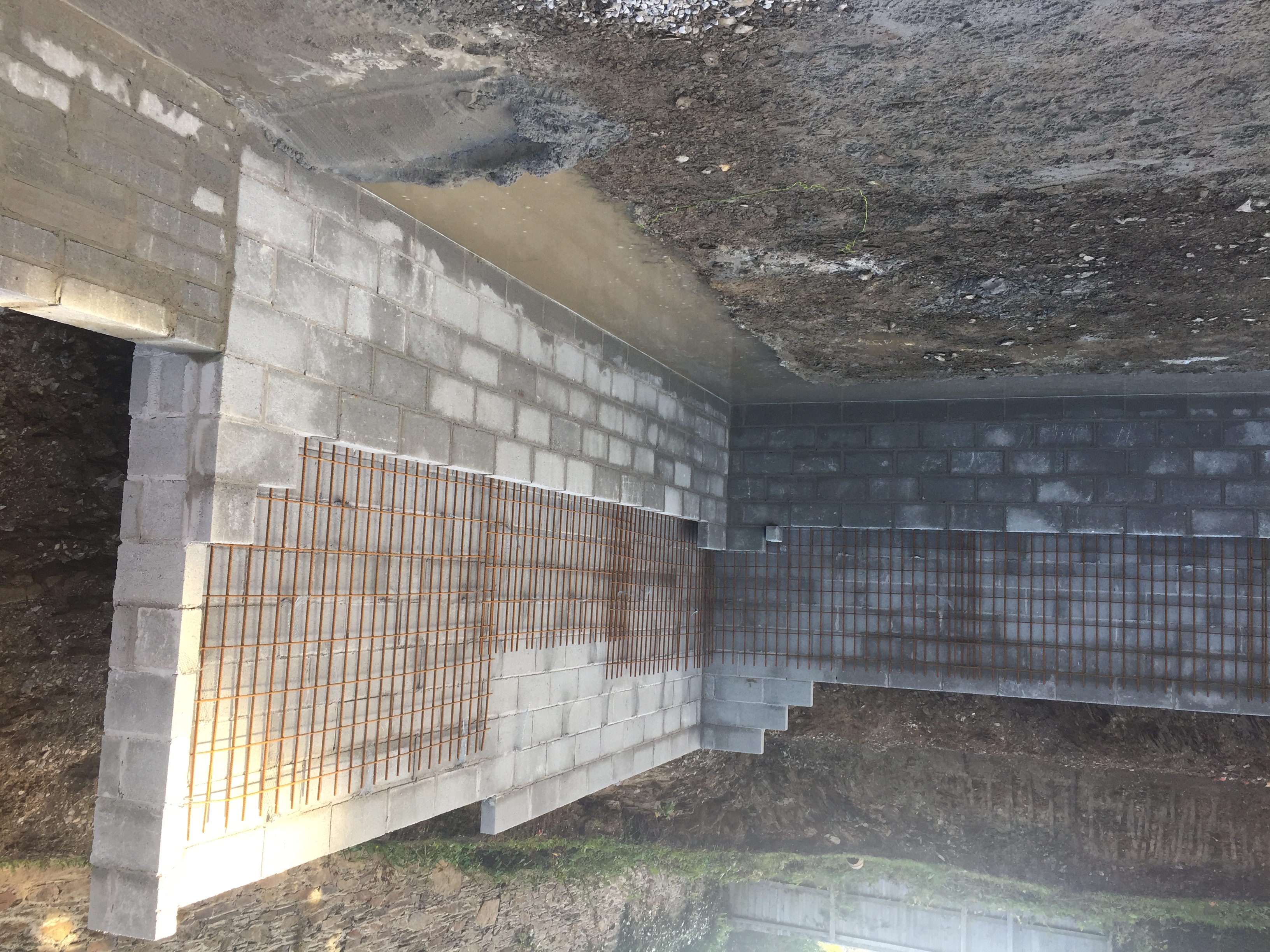

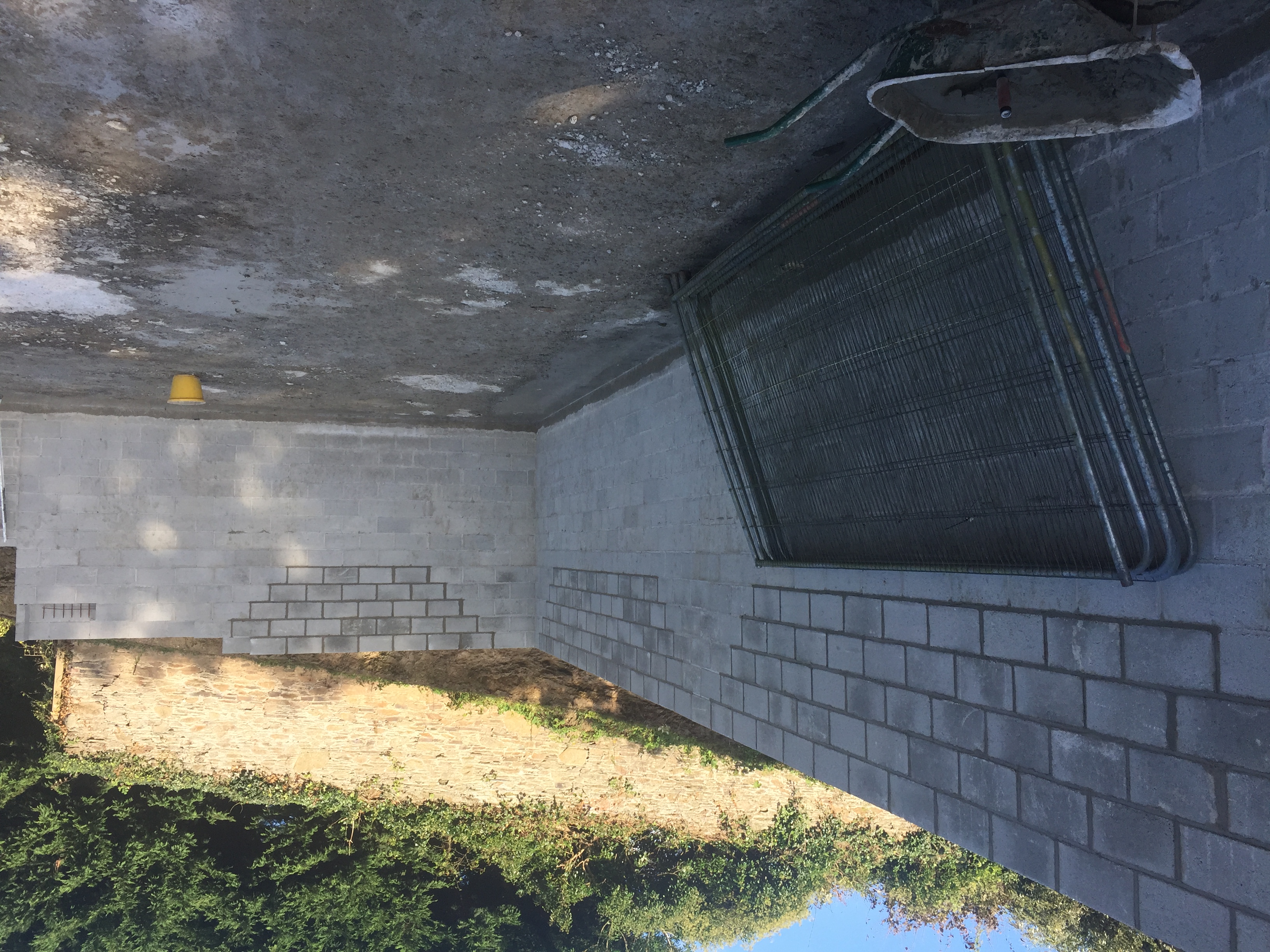

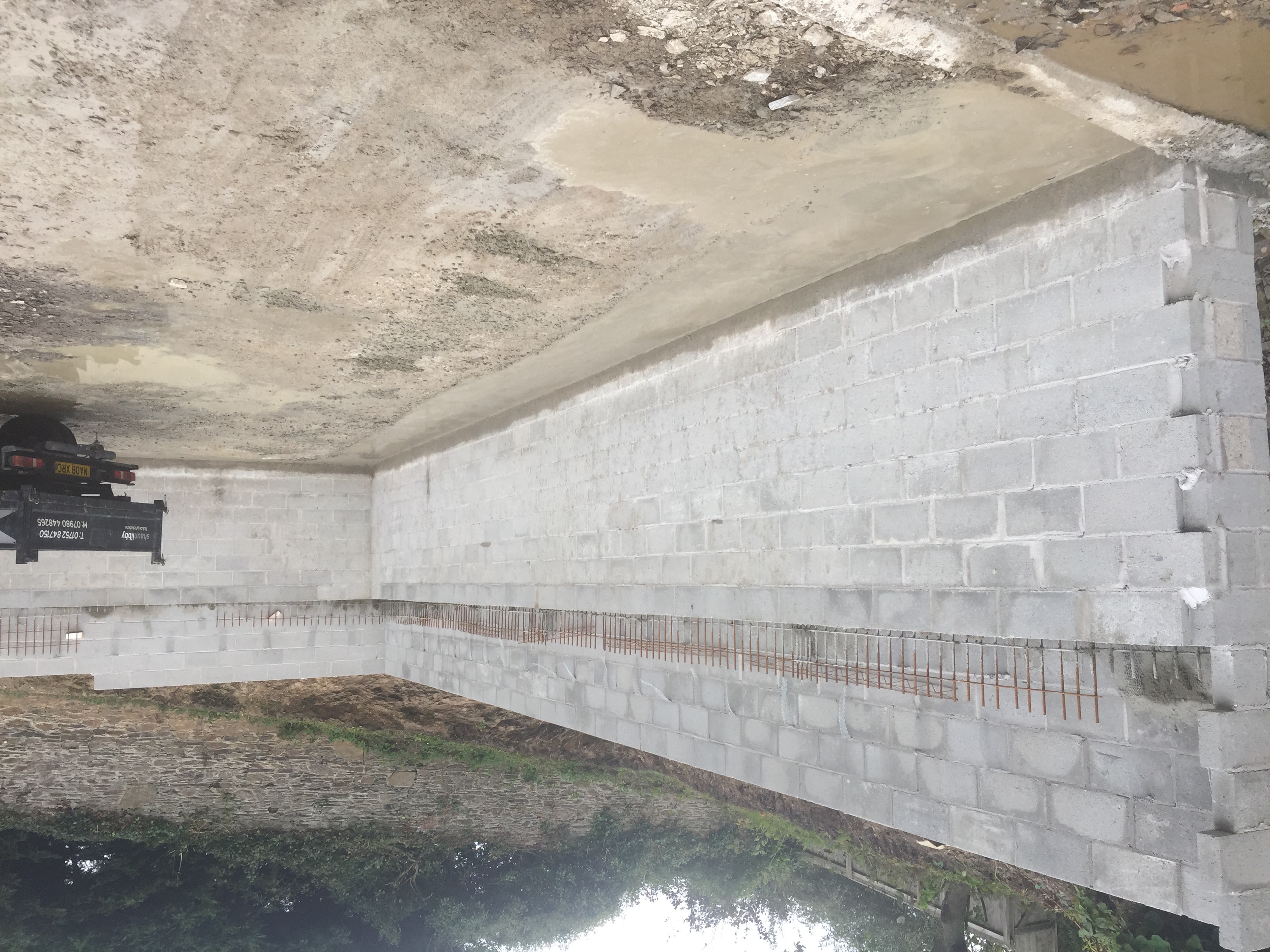

These photos probably best show the full structure of the retaining wall, 5 courses complete on the inner skin now, ready to be filled with concrete tomorrow. Then another 5 courses next week and repeat...

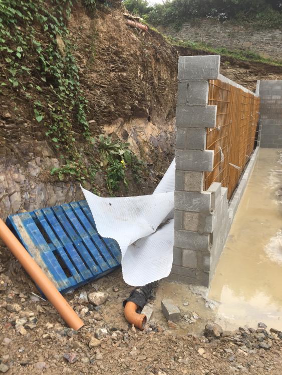

I hope it all went to plan! Which waterproofing membranes are you using?

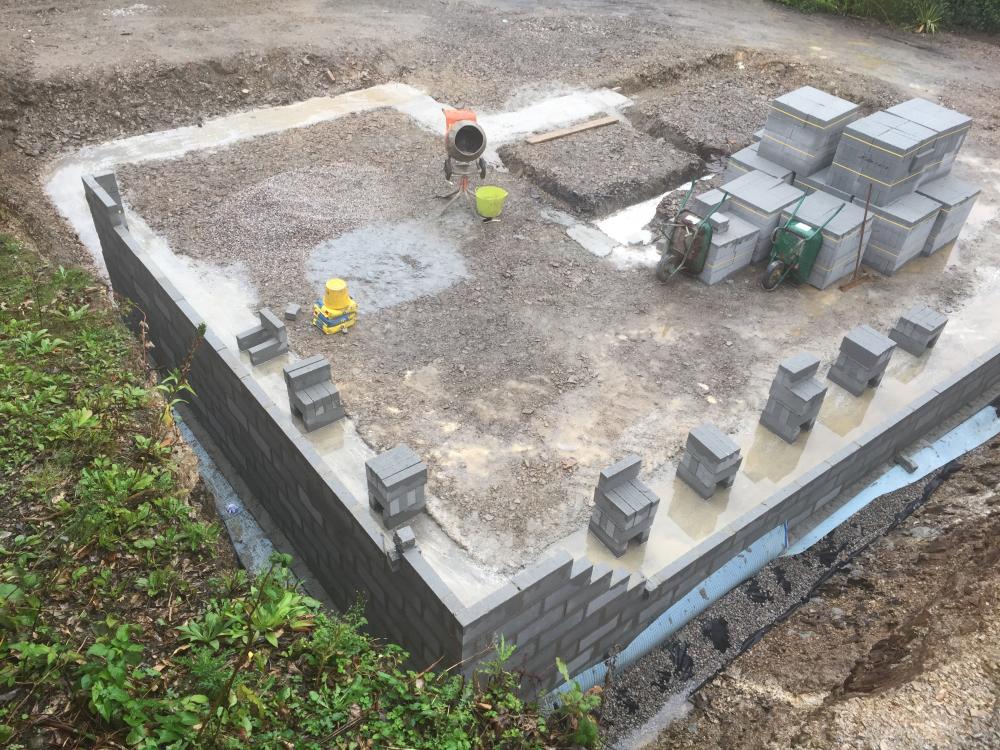

Concrete in to about 3 courses, everyone has accepted this will be a slower process to avoid issues such as you experienced, I think a couple more concrete loads over next week then hopefully finishing the pour early next week.
Tabking is RIW double drain on the outside face and RIW flexiseal on the inside. That's what the structural engineer spec'd however speaking to my builder last week he said that the tanking supplier is looking at designing and specifying a different system, we shall see what they come up with and make a decision.

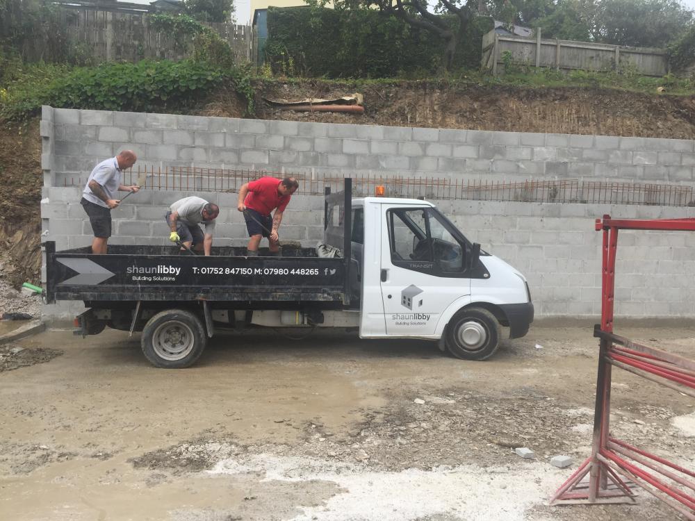

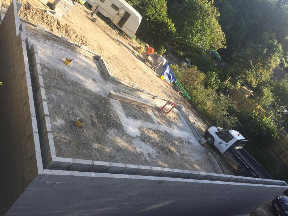

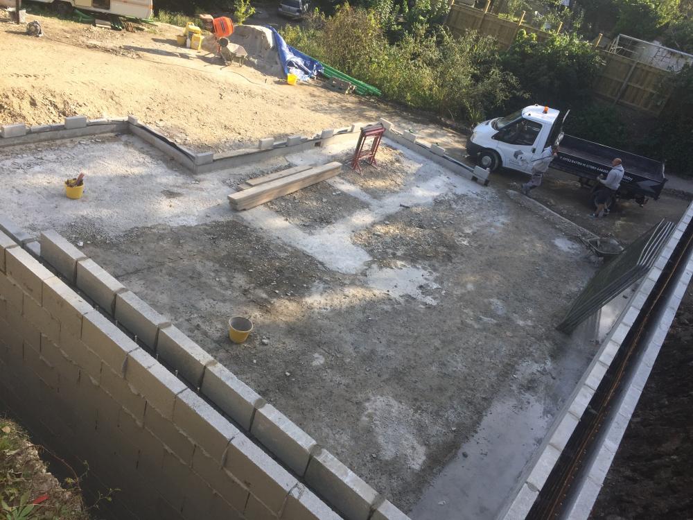

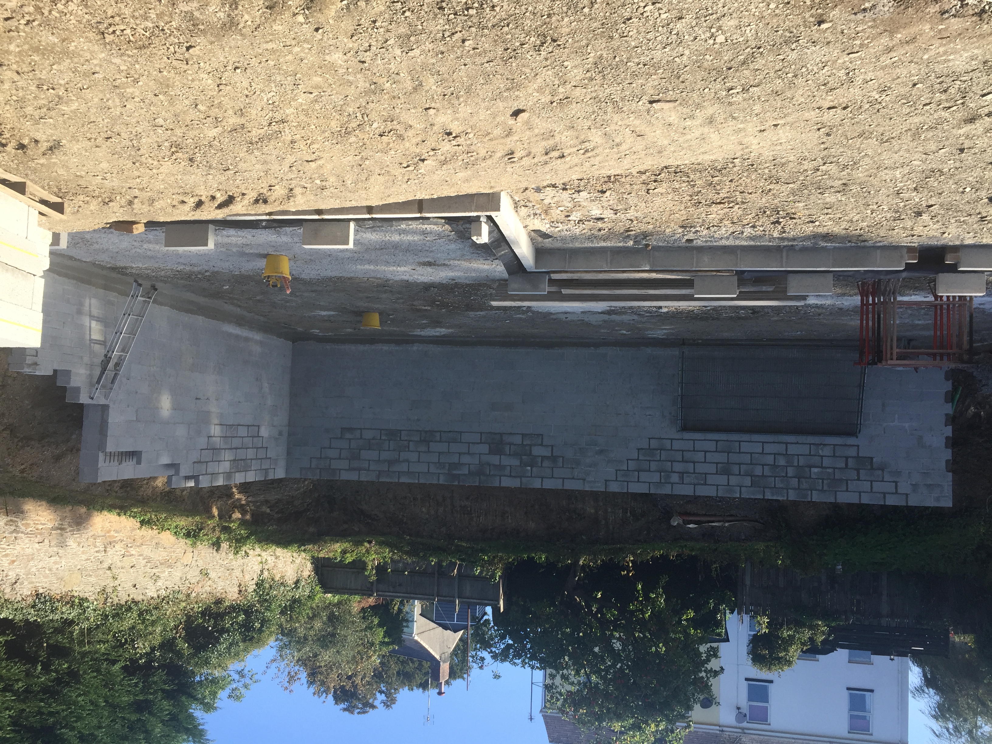

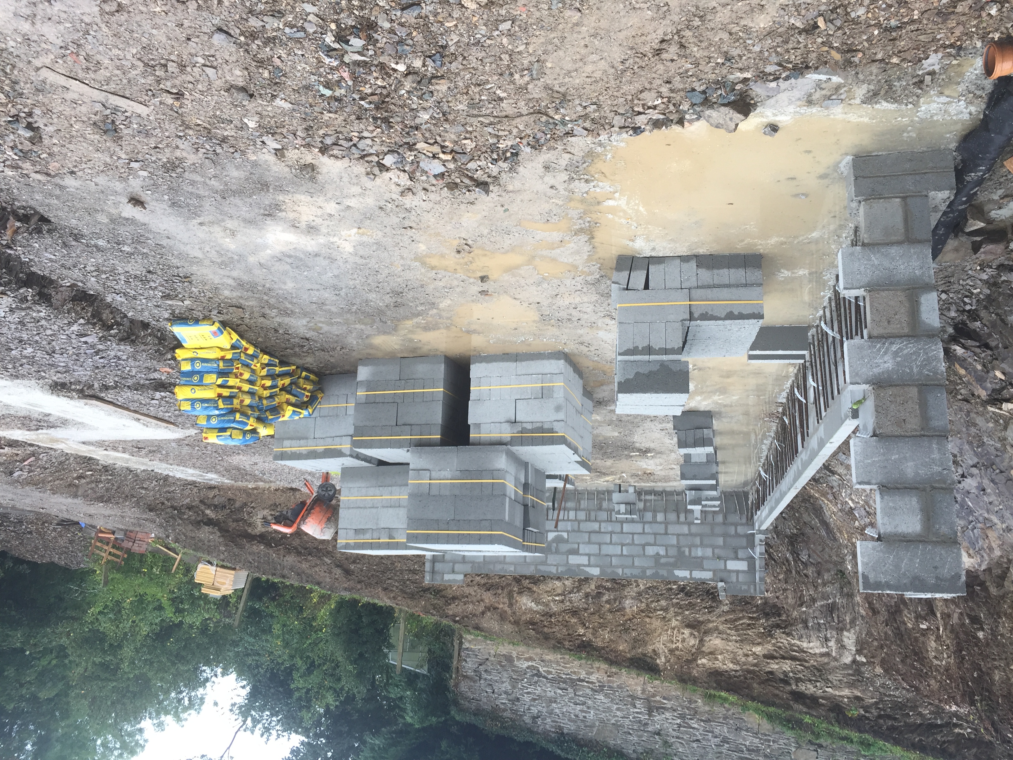

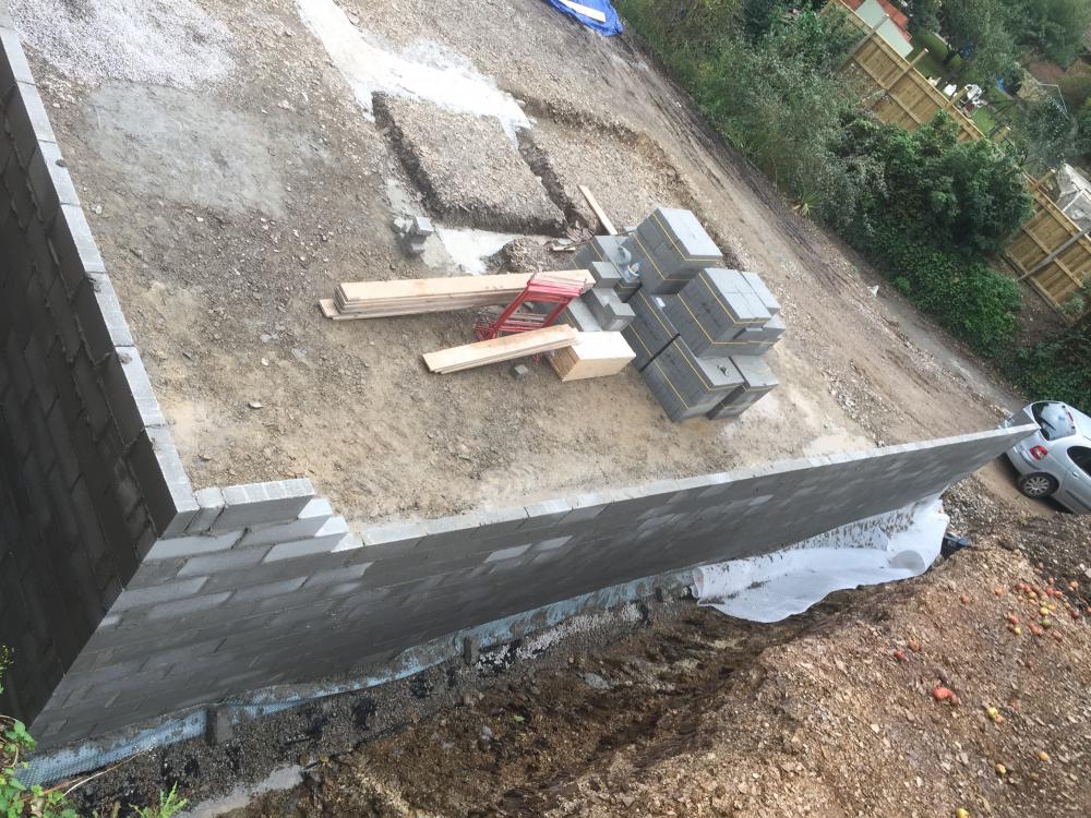

Updated pic pic as of today BTW -

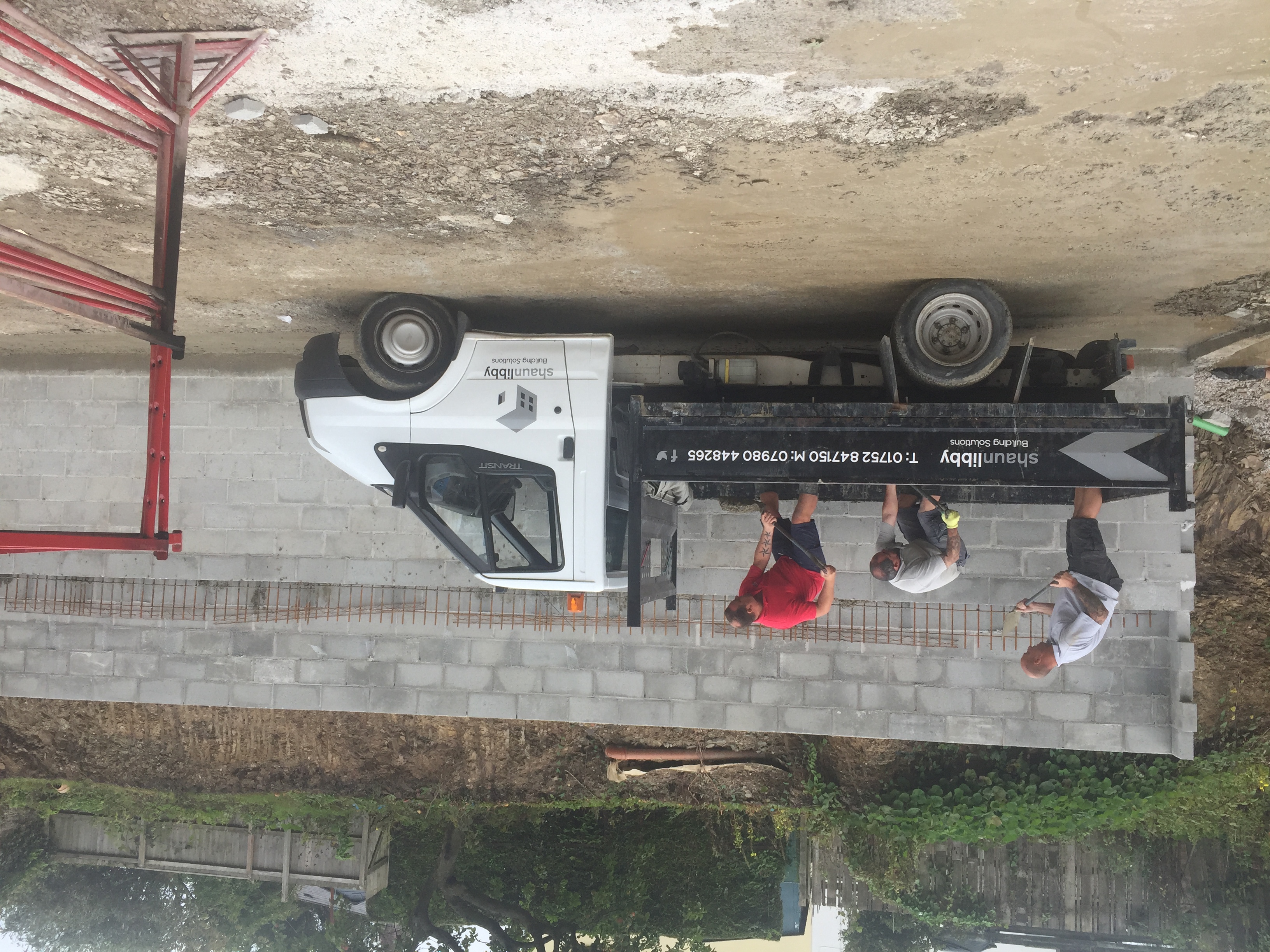

Also concrete being shovelled in by hand - the lads earned their brew after this lot!

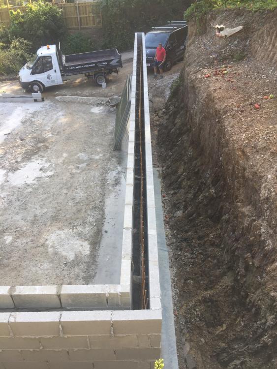

Ah, I see still surprises me that they would do it like that as it looks like you will end up with massively thick walls and of course the real wide foundations which must be a bit with the concrete. The shovelling in surprises me also, I would have thought it more usual to build to the top first then concrete mixer pour into it all in one continuous form without split. Not that it is likely to be a problem necessarily with a wall that thick and I guess it looks like you have the space there for thick walls but I still wonder if the method is best practice. Would be interesting to see what Pro Dave thinks of this or another engineer perhaps.
You couldn't pour concrete into that wall if it was built both skins to the top as it would burst out. The wall would need to be 225mm wide min with extra thick piers built in every 4-5m.
What are the guys using to ensure the concrete is fully filling the gap, a vibrating poker or a long stick???
Grosey
Vibrating poker, first experience of one of those today - Crikey that's a powerful vibrator!!!
Grosey
If you think the wall is thick now there's still the standard cavity wall to go inside this one which forms the structure of the house!
Gimp

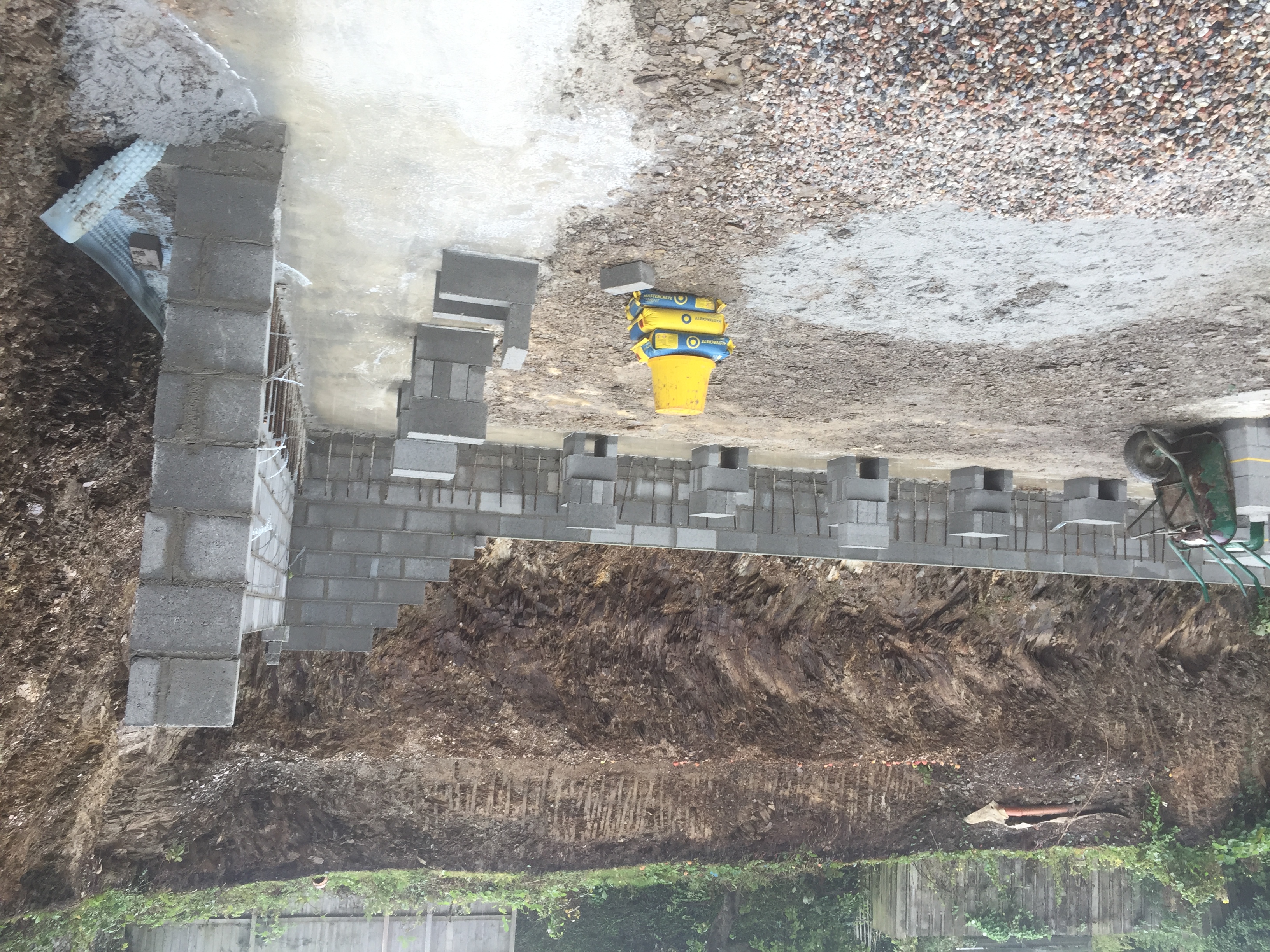

Would be surprised if it would burst out with the walls having a few days to set. I know this is often the pitfall of ICF blocks which is part of what puts me off them, but a can't see why a wall with set joints would act like that.
The pressure of the wet concrete would cause the bottom row to move out. It's only held in place my the weight of the wall and friction. Have seen many a retaining wall burst out that where thicker than that.

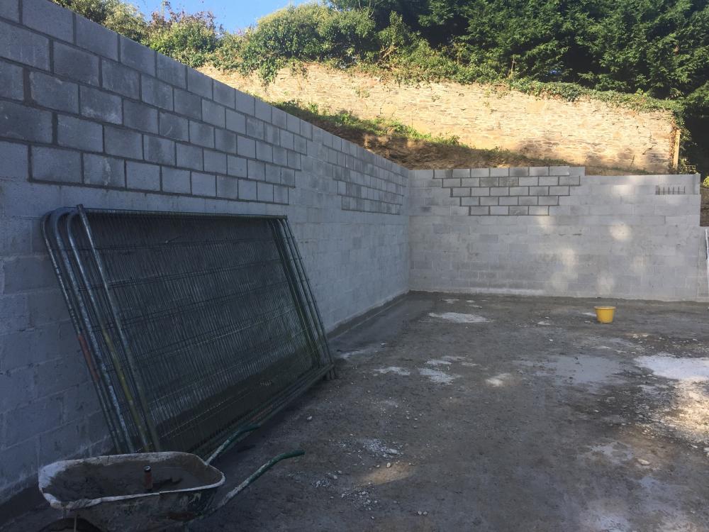

Grosey

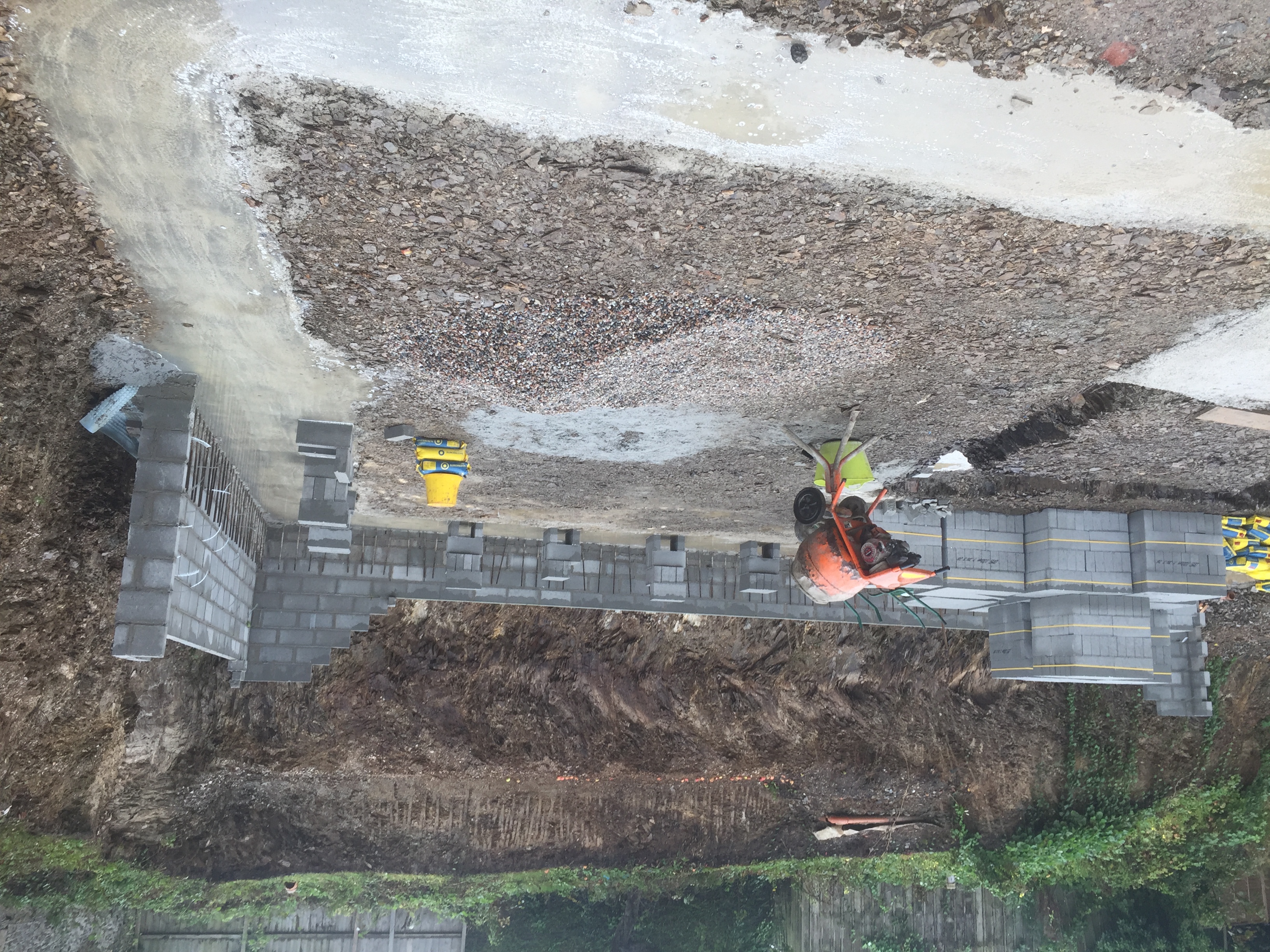

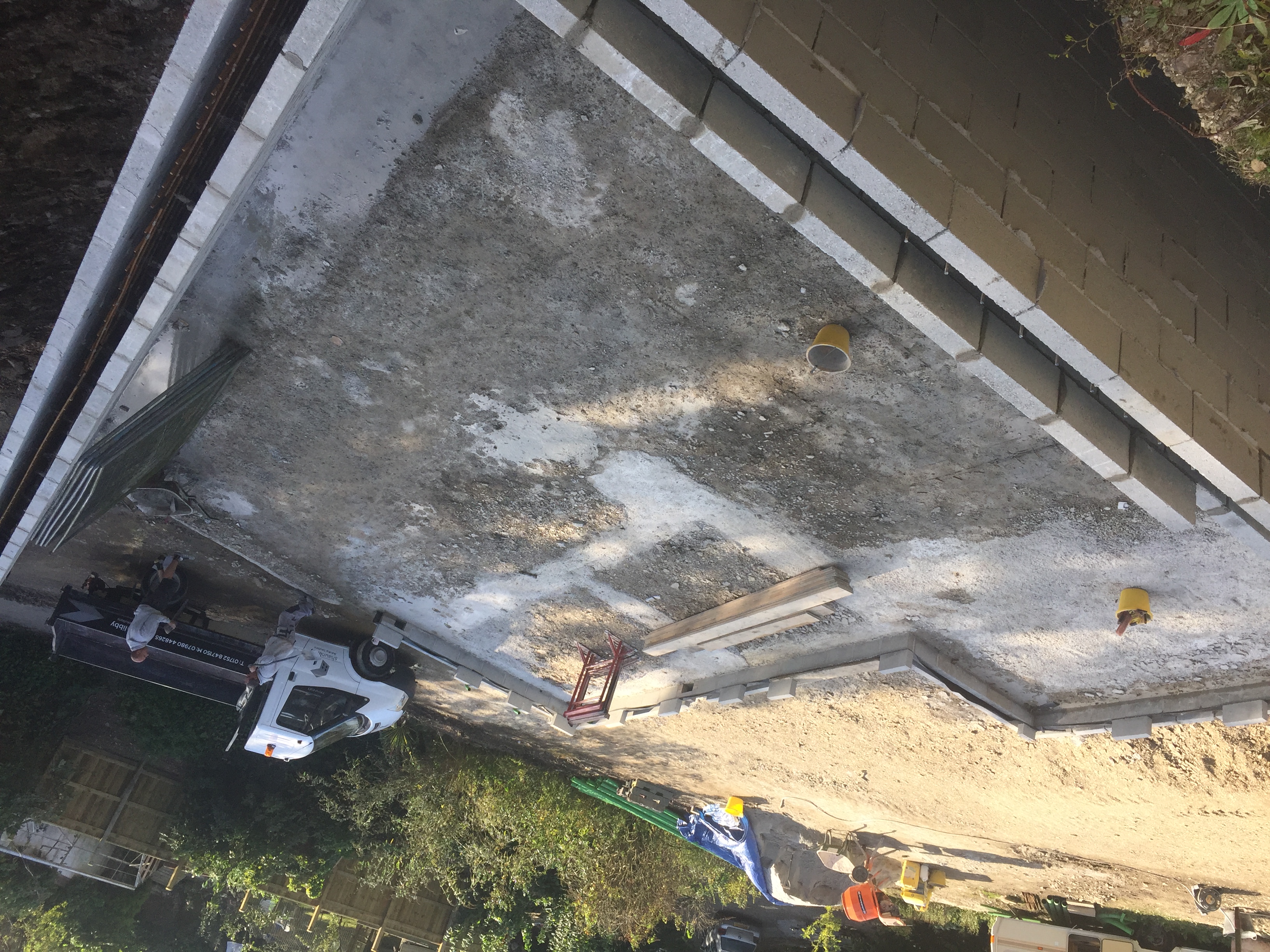

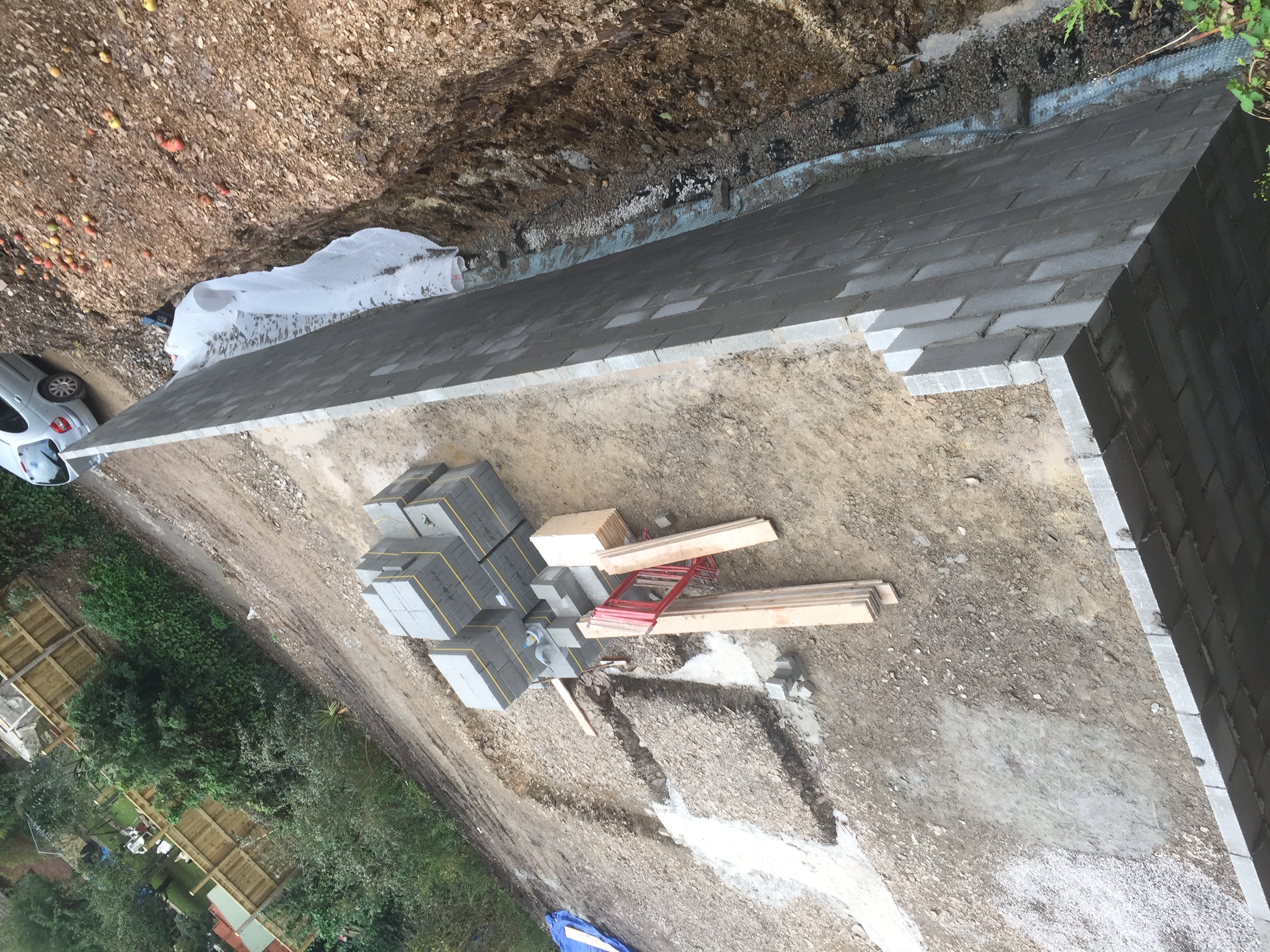

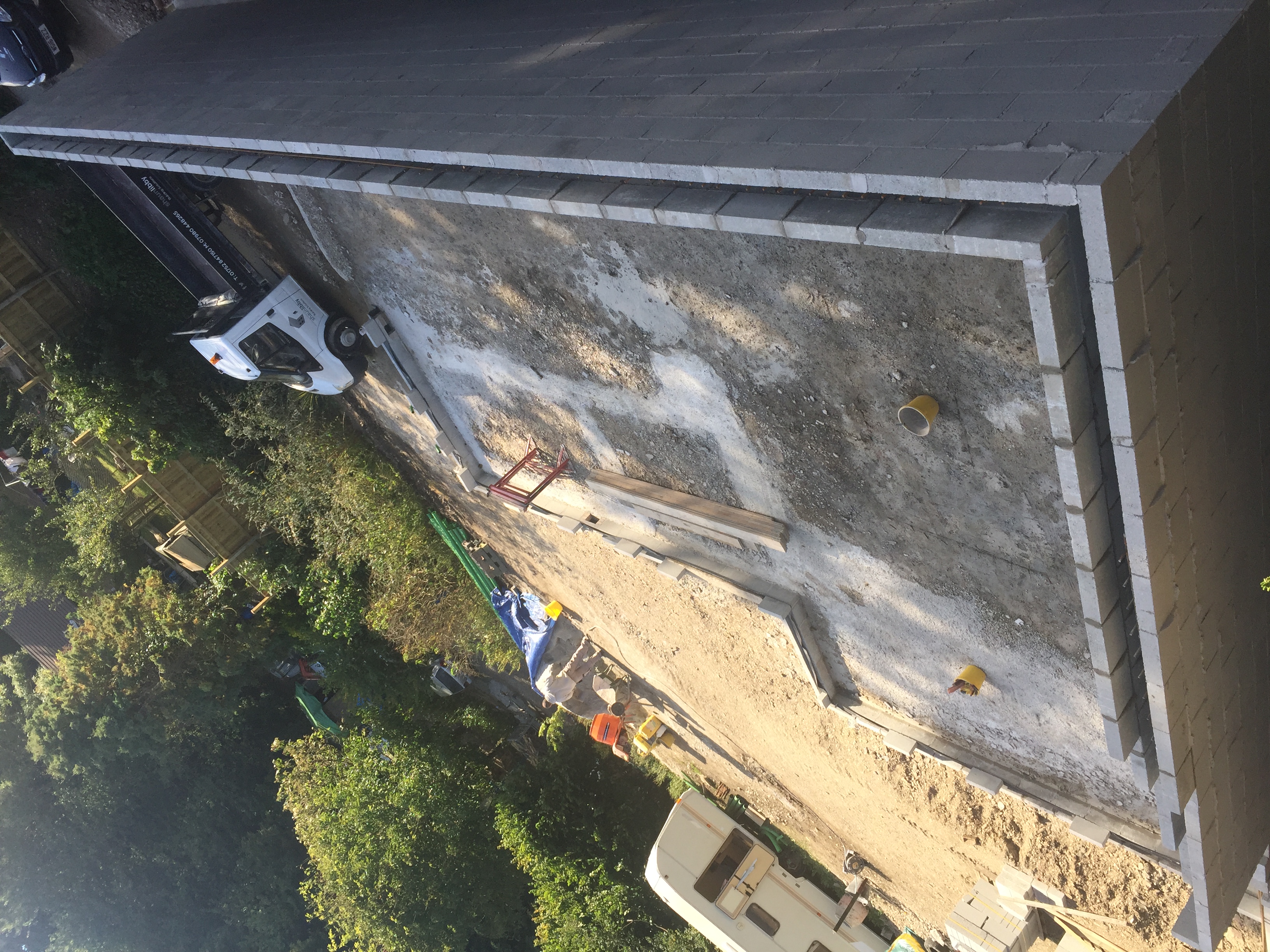

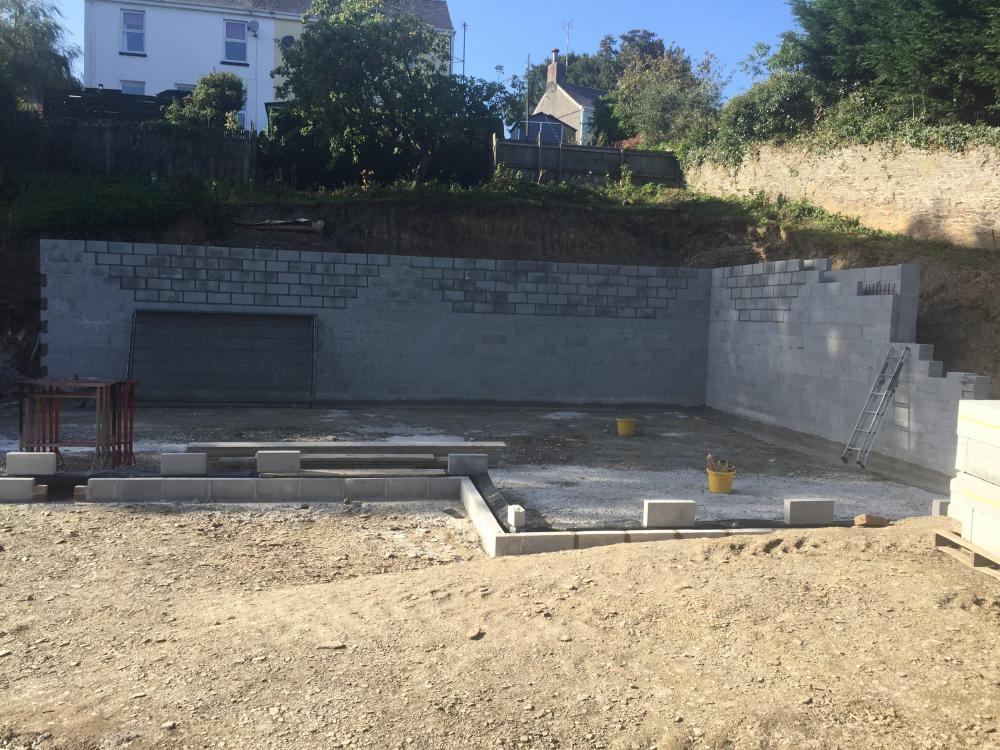

Wall fully up, 2 more pours next week on Monday and Tuesday to fill it. The logistics of this caused a bit of headscratching as to how to get the concrete up and in that wall - the plan seems now to be a bucket on a telehandler, 2 blocks sat straddling the wall with shovels scraping out of the bucket and in to the wall - or if the drivers good pour it straight in. We shall see.
Then to tank and backfill behind, then I'll finally stop the civil engineering and get on with building a house :D
