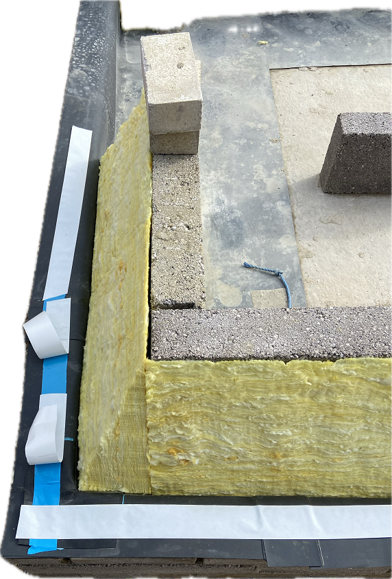

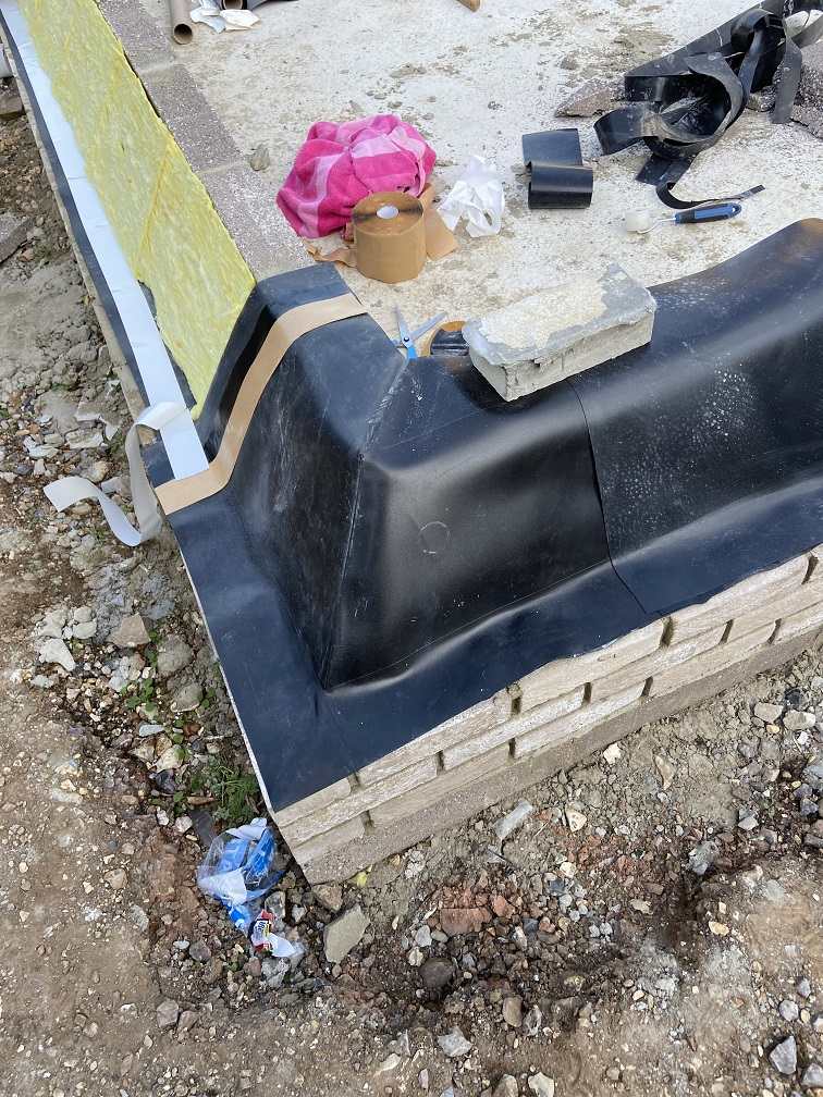

Here are a few photos.  I made a jig up to cut the insulation at the angle of the cavity tray and I was chuffed how it turned out.  A rather laborious task though, but I said I would get the trays and insulation all ready for them

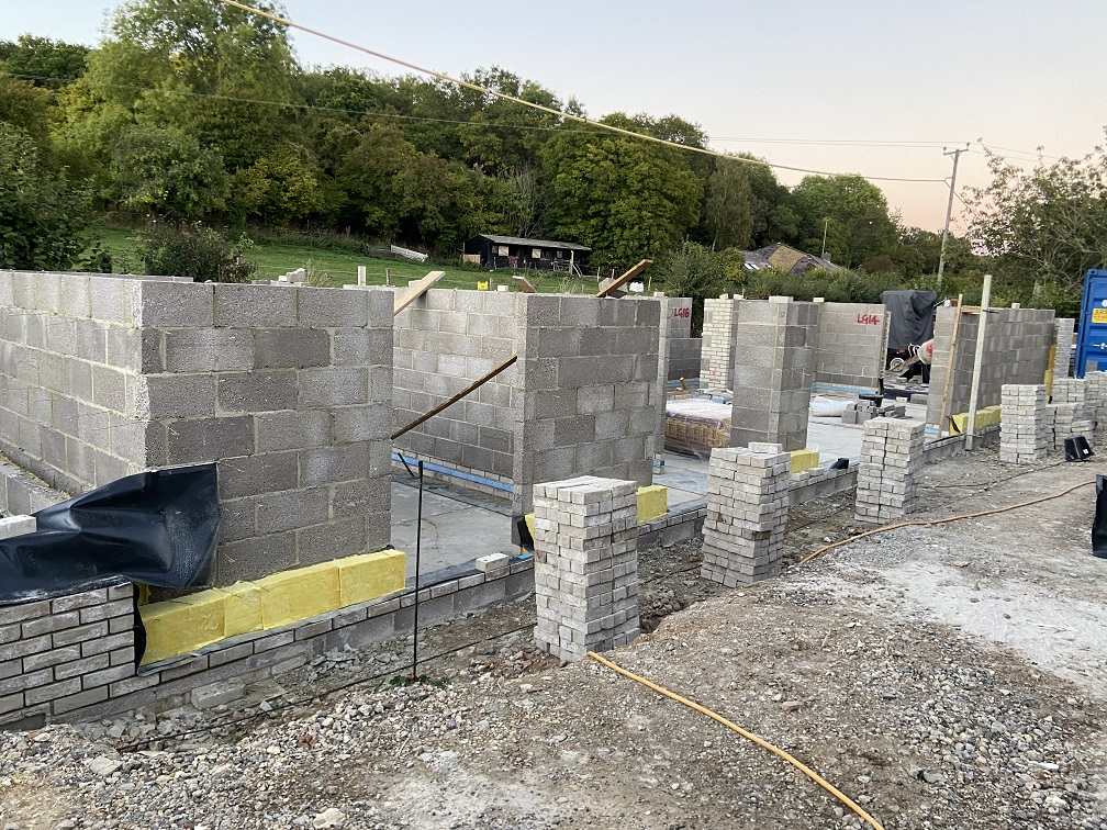

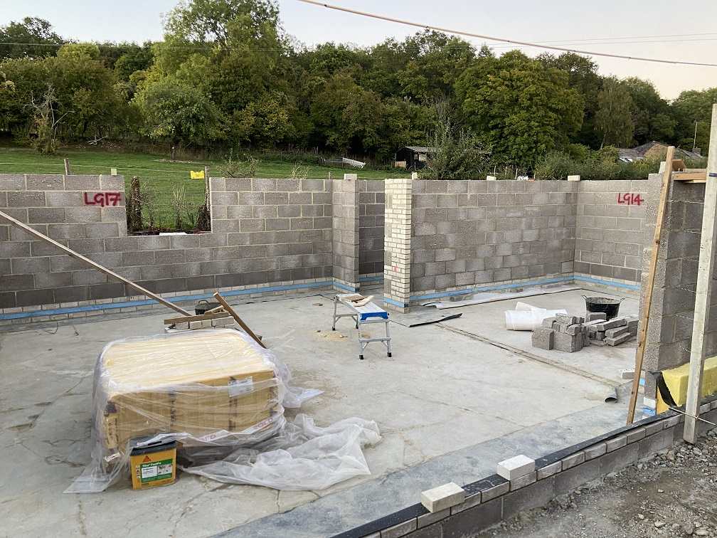

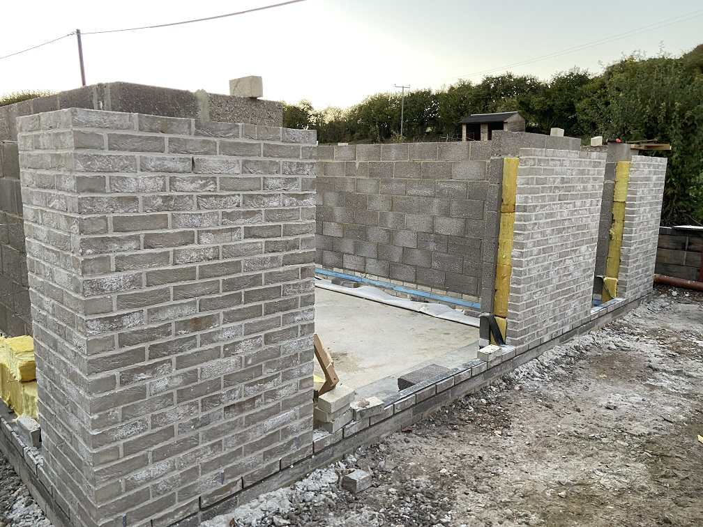

I also knocked up probably 12 different mixes over the last few months.  We tried 5 different sands, grey cement, white cement and lime ...., but non of them really worked and they were either too grey or too yellow, but we kept searching and finally found a local firm in Thatcham who had some sand from a quarry a long distance away.  The colour looked like it would work and as soon as I mixed up the 5 sand, 1 white cement and 1 lime mix, we both said "that's it".  Sand cost us about £90/ton, which is not cheap, but I didn't want to be looking at the house thinking "I don't like the mortar colour".   Here are a few pictures of progress from the last two weeks.

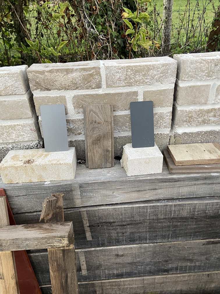

Good to hear. Materials in last photo looking good. Which window colour are you going for (assuming that's what 2 colours are)?

Brickwork looks the nuts.  DPC / gas membrane anal but in a nice way.
I bought sand from Cornwall for the colour.  £80 a pallet haulage but the alternative was awful.

flanagaj
We originally decided on the left, but that has changed to the one on the right.  The left is more muted though 🤔

Redbeard
1 hour ago, flanagaj said:
I wasn't planning on doing that?
Please do. Fibre insulation 'sucks' a lot of rain. Visqueen and block/brick offcuts will keep a lot of it off.
