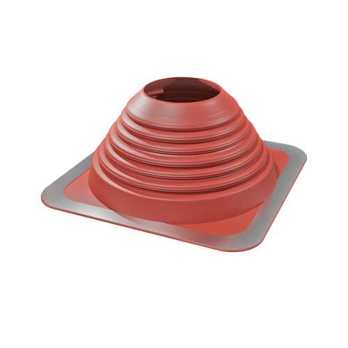

ProDave
Posted
51 minutes ago, saveasteading said:
That was an option I dismissed.
It was a flat aluminium roof.  Unlike tiles, there is nothing to slot that under.  So it would rely entirely on being stuck down with some glue / sealant to keep the whole thing watertight.  Any failure in that and it would leak.
My swage up the under sized hole forms a natural upstand to divert rainwater around the hole, and I well sealed it as well.  I guess I could have then put one of those over the top to make it look better.
saveasteading
Posted
Exactly so. Using double-beaded flexible mastic tape, and self-tap screws through it.
This is how steel clad roofs (1mm thick) are sealed, and no other material has to go over it.
Red for hot pipes, black for others.
The corrugations allow for the slope.
I must have 100 of these out in the world. It needs skill to fit on a steep slope, then they work without issues.
