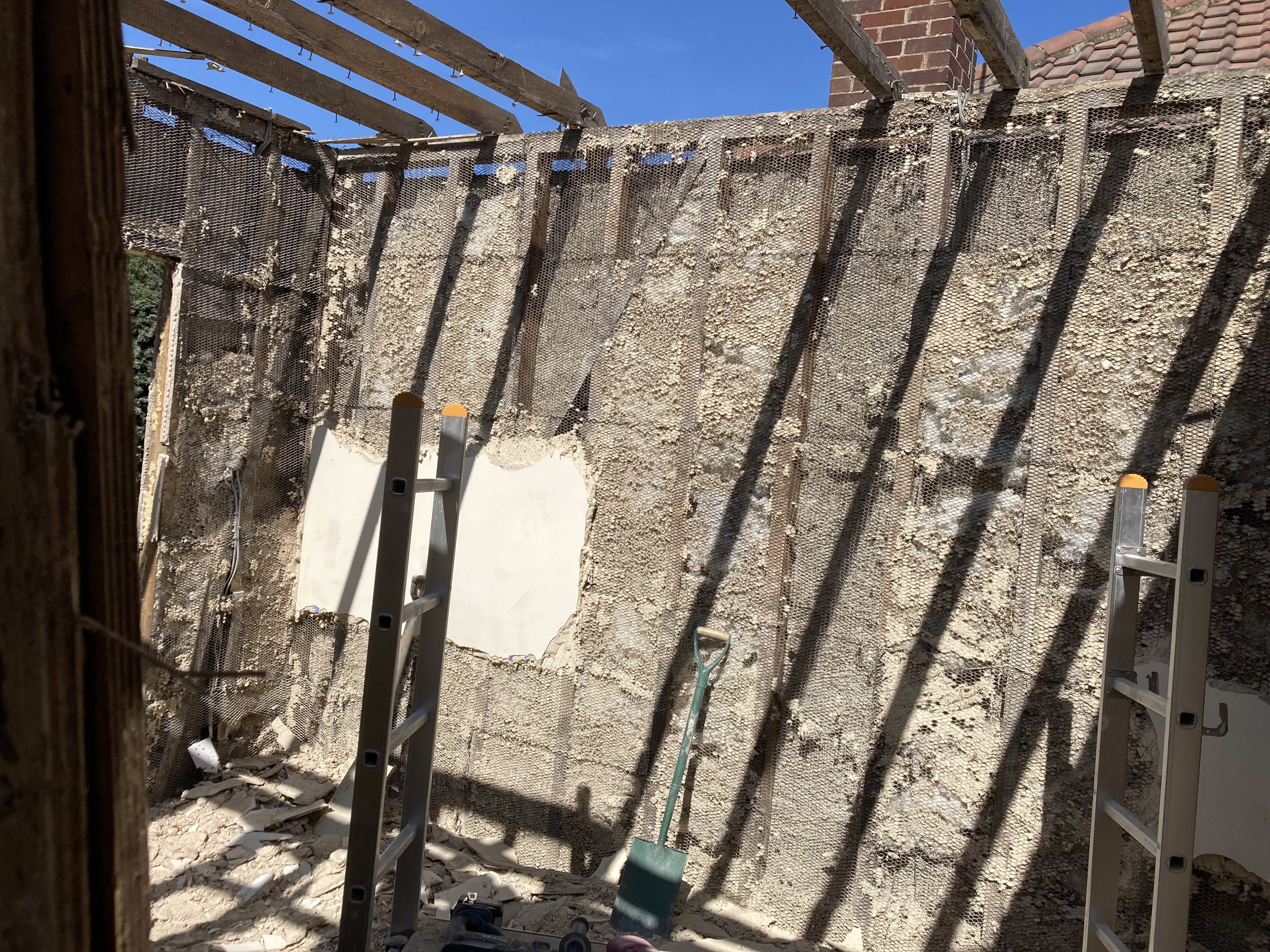

So on Tuesday we started stripping off the internal plaster.  The external walls are 4” x 2” stud with metal lathe either side then pebble dash outside and a weak cement render inside with a skim.   Between the studs is a patchy application of white fluffy insulation, which had settled significantly, or was completely absent where they missed sections.   A fantastic illustration of the cowboy insulators of yesteryear.
The plan was to knock off the internal plaster, then peel off the wire to grab and bag the fluff section by section, then thump the pebble dash off from inside.  We had visions of the whole neighbourhood being covered in wind blown non bio degradable fluff for decades to come.

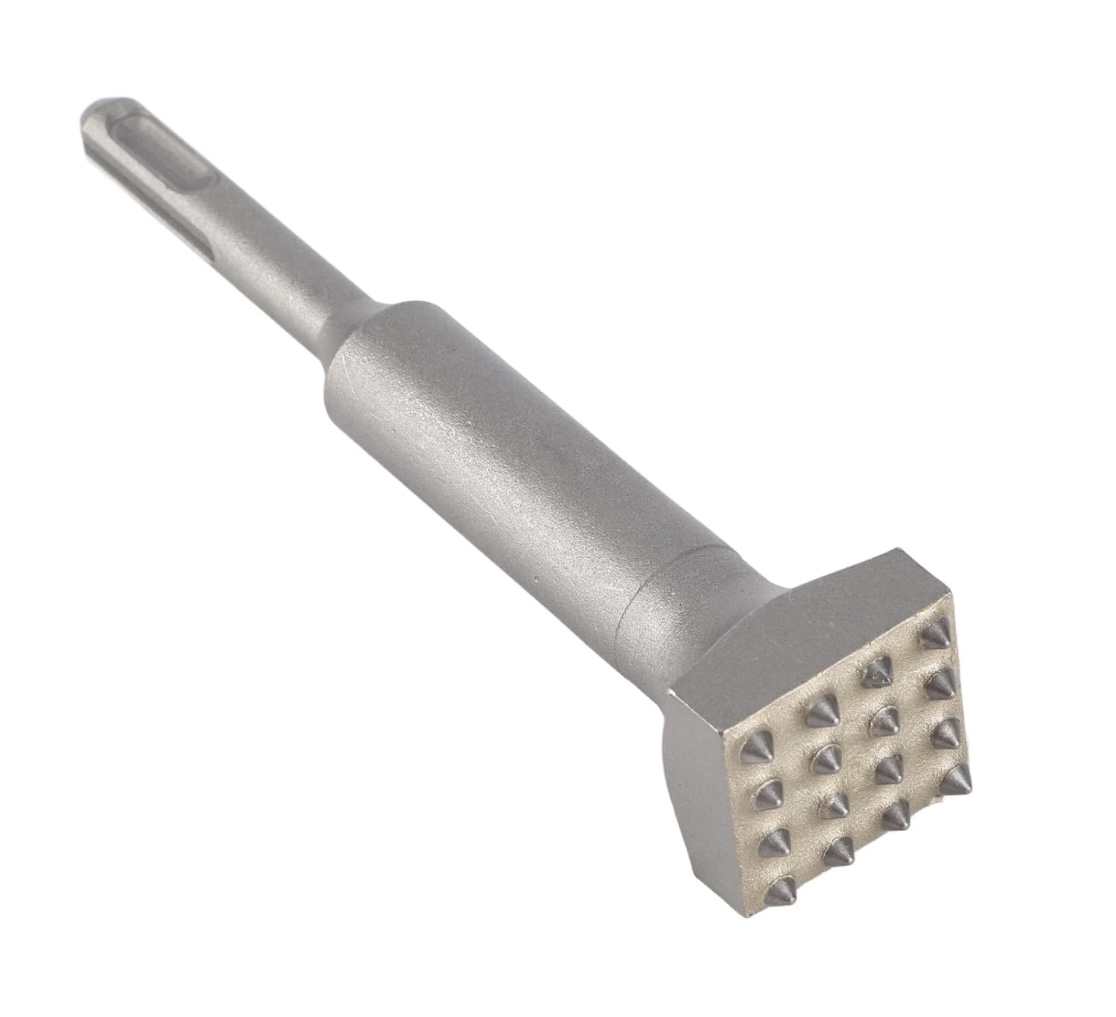

We soon discovered that the tool of choice was yet again, my trusty spade, backed up by my SDS with a funny crushing bit.   Hours of hacking leaves the wire mesh clean enough to go in metal recycling.  The render was then barrowed to the growing aggregate pile in the back garden to be used to build up the solid floor.  Peeling off the metal lathe involved much yanking with a nailbar and we generated an enormous pile of plastic bags of captured fluff, the only non recyclable bit.  Quite pleasing.
The frightening bit was knocking off the pebble dash.  Too easy. It came off in huge bits with very little effort.  It happened so quickly that once we’d cleared that up we had time to start cutting down some stud work.  We started with the end wall.  A couple of high level cuts and a gentle push and down it fell into the garden, in two sections, with a small plume of wood dust from the disintegrating rotten sole plate.  If our neighbours see these bits they’ll be scared stiff at the likely condition of their near identical bungalow, built as a pair roughly a hundred years ago.

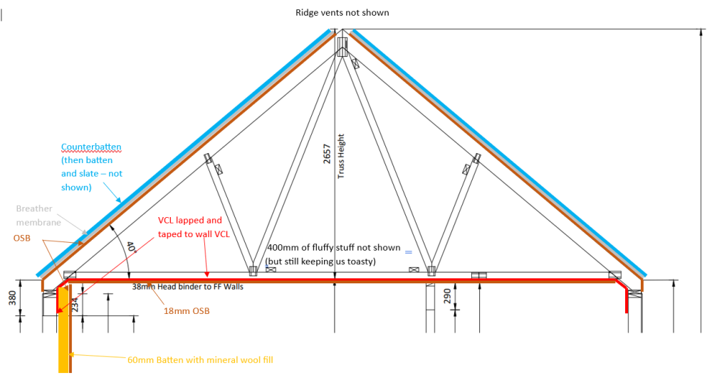

On the Roof ventilation side I think you are planning insulation at ceiling level and a pitched roof?
If so I would opt for a sealed roof and zero ventilation in the attic to prevent wind washing of the insulation.
Have a look at Tyveks detail for a non ventilated cold roof.

Bang on, and I was keen on that approach but I've erred on the side of caution - ridge vents to give some ventilation without the wind-wash gale of eve vents thus helping the soft fluffy stuff laid over the bottom cords of the trusses do their stuff.  This option feels like it’s gaining 90% of the benefits with very little risk.  And hopefully even more rodent resistant.
Bob (our SE) isn’t quite so keen on Tyvek.  He thinks they have a tendency to overstate.

I'm not a huge fan of Tyvek. I think the quality of glidevale vp400 is better than tyvek supro for less money.
Are you planning to penetrate the membrane with the ridge vents?
A sketch would help.
G and J
Posted
Expand

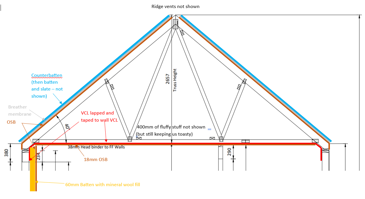

How's this....
My thinking is that the VCL, being part of our 'airtight balloon skin' (such concepts help me, regardless of how daft they sound), will reduce the amount of steamy human stuff that evaporates into the attic.  Therefore we won't need a gale blowing through there to keep it dry.  The OSB is a bit breathable, the breather membrane being counter battened will deal with what little moisture vapour there is, and the ridge vent is a belt and braces thing, and won't scare any horses.
With the eves sealed then the thermal performance of the roof should be fab.
Iceverge
Posted
Yeah, that's tops.
That'll be excellent.

The ridge vent will also allow a way for the hottest air to get out - which is my current thinking on why to keep a few eaves vents plus ridge vents. Upstairs the biggest overheating problem we have is the roof space warming up and penetrating down through the loft insulation. The cooler I can keep the air in the attic the better...
G and J
Posted
Expand
Interesting.  Our fluffy loft floor will have the best u value of the whole build, looking at 0.1.
Do you know what sort of temp your loft gets too?  I’m guessing even with fab insulation if it’s hot enough up there then some of the heat will filter through.
