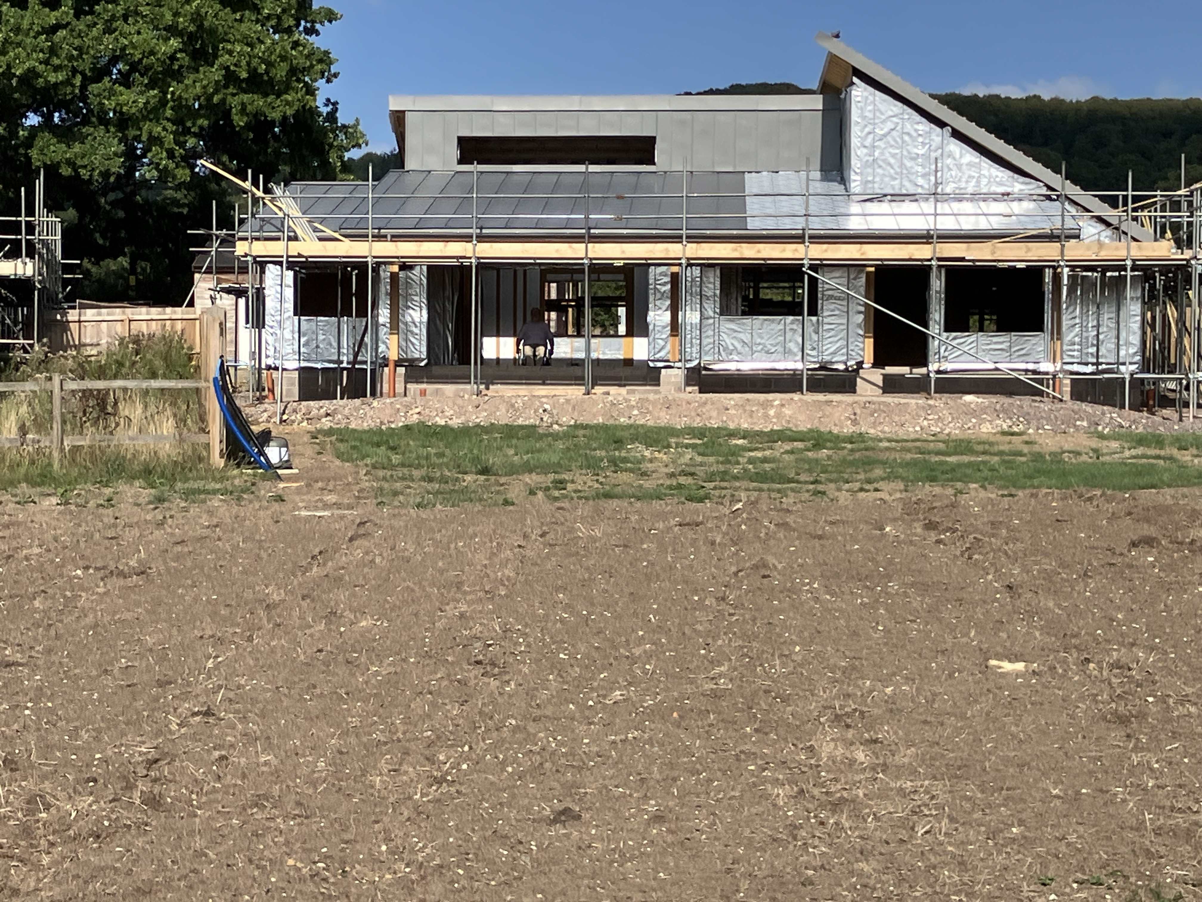

Week 10 - Membranes, cellulose, zinc roof.
A longer than usual blog - we’ve had a lot going on this week.    We definitely reached site capacity with five vans and seven contractors on-site on Thursday and Friday.   Seven pallets of cellulose bales arriving mid-week didn’t help space management either.     The whole week got fairly stressful but somehow we seem to have got through it.  Phew!   Membranes The plan was for the team from SW Insulation to fit the VCL membrane to the vaulted ceilin

Week 7 - We have a house!
…well, the shell of a house at least.   What a crazy week.   We chose the factory-built timber frame route because we like the idea that the shell goes up within a few weeks.  But the pace of progress this week has been startling.   The frame erection team of 3 arrived at 7:30am on Monday. A big yellow crane arrived at 8:00, with the frame arriving on an artic by 9:15.  First off: a careful check shows that the frame fits the footings. Hurray!  In fact the footings were withi
