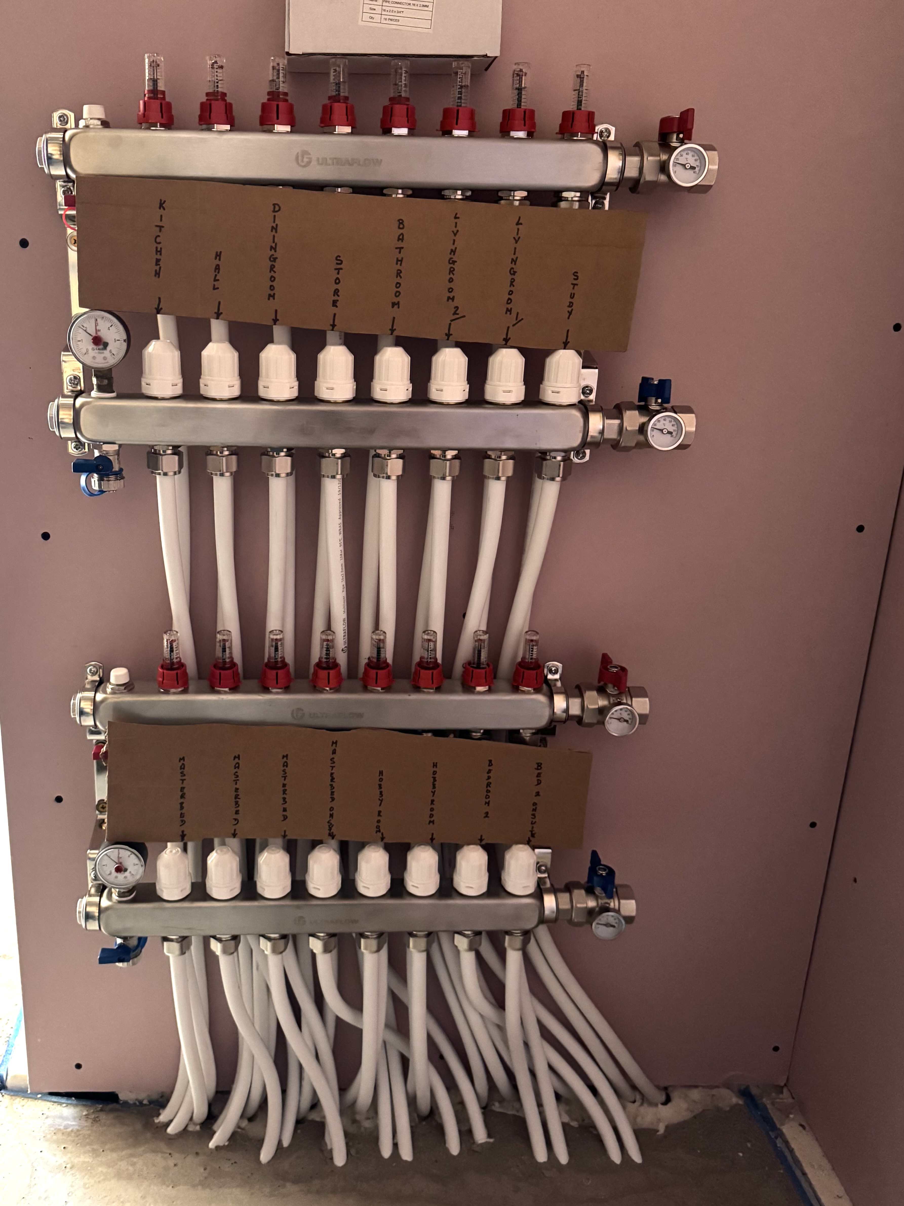

Last week's drama getting the UFH pipes laid just in time for the screed pour seems like a distant memory but as there had not been time for Ken to fit the manifold and pressure test, he came on site on Sunday evening (roping in his Dad as a helper) to get that done.
Thanks Ken - and Ken's dad!  A neat job completed...

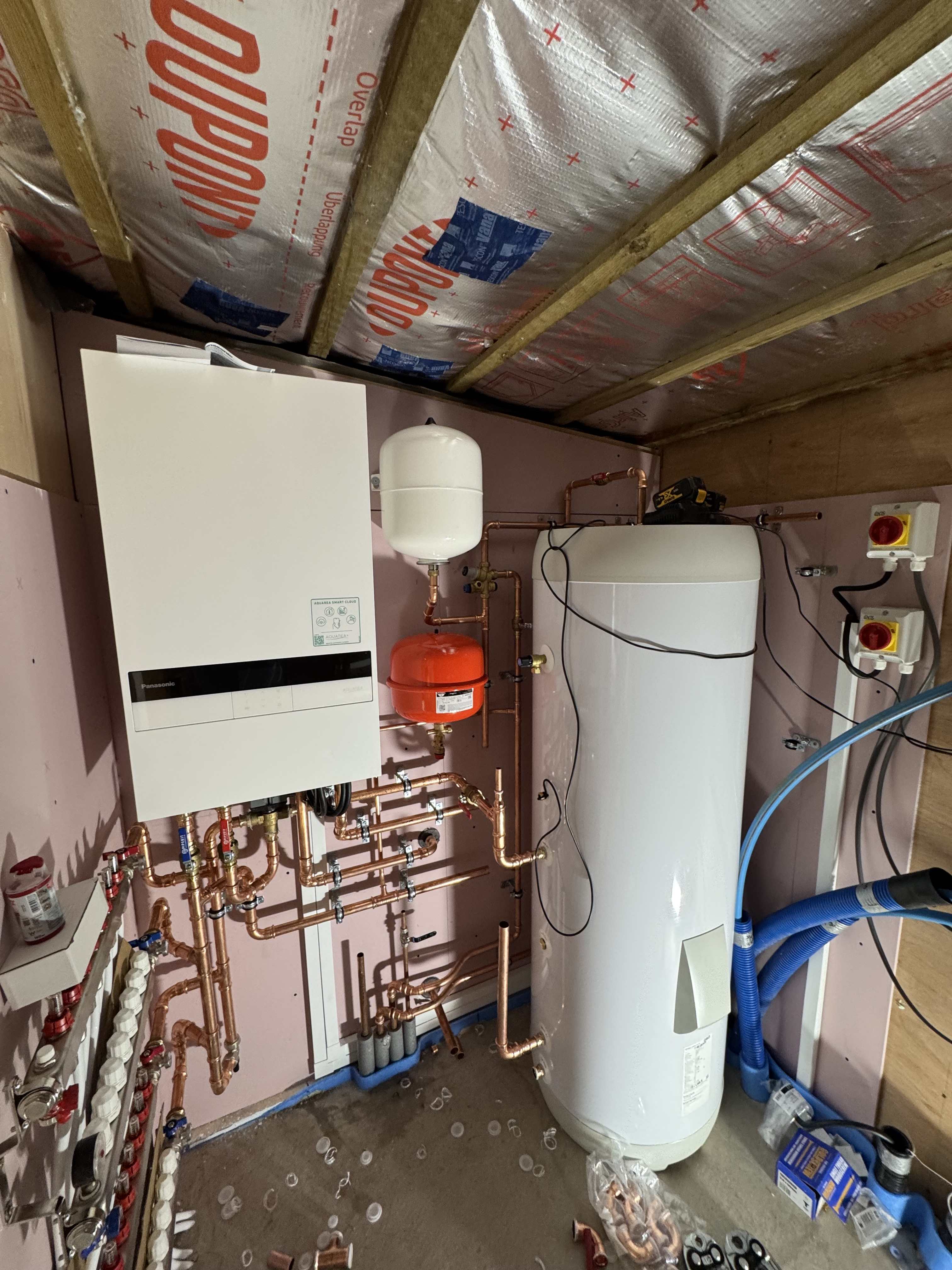

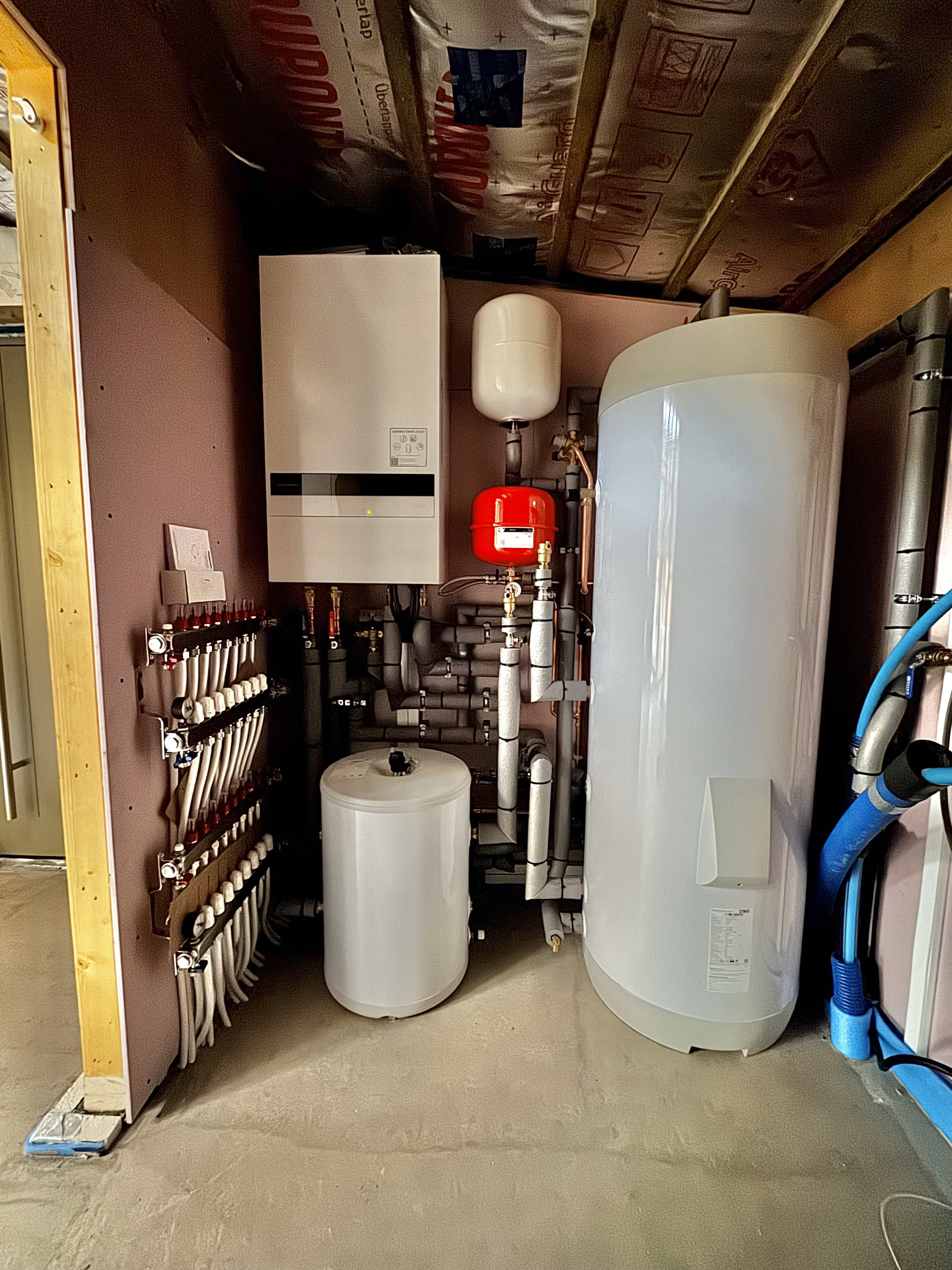

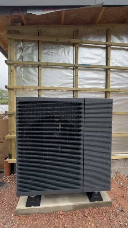

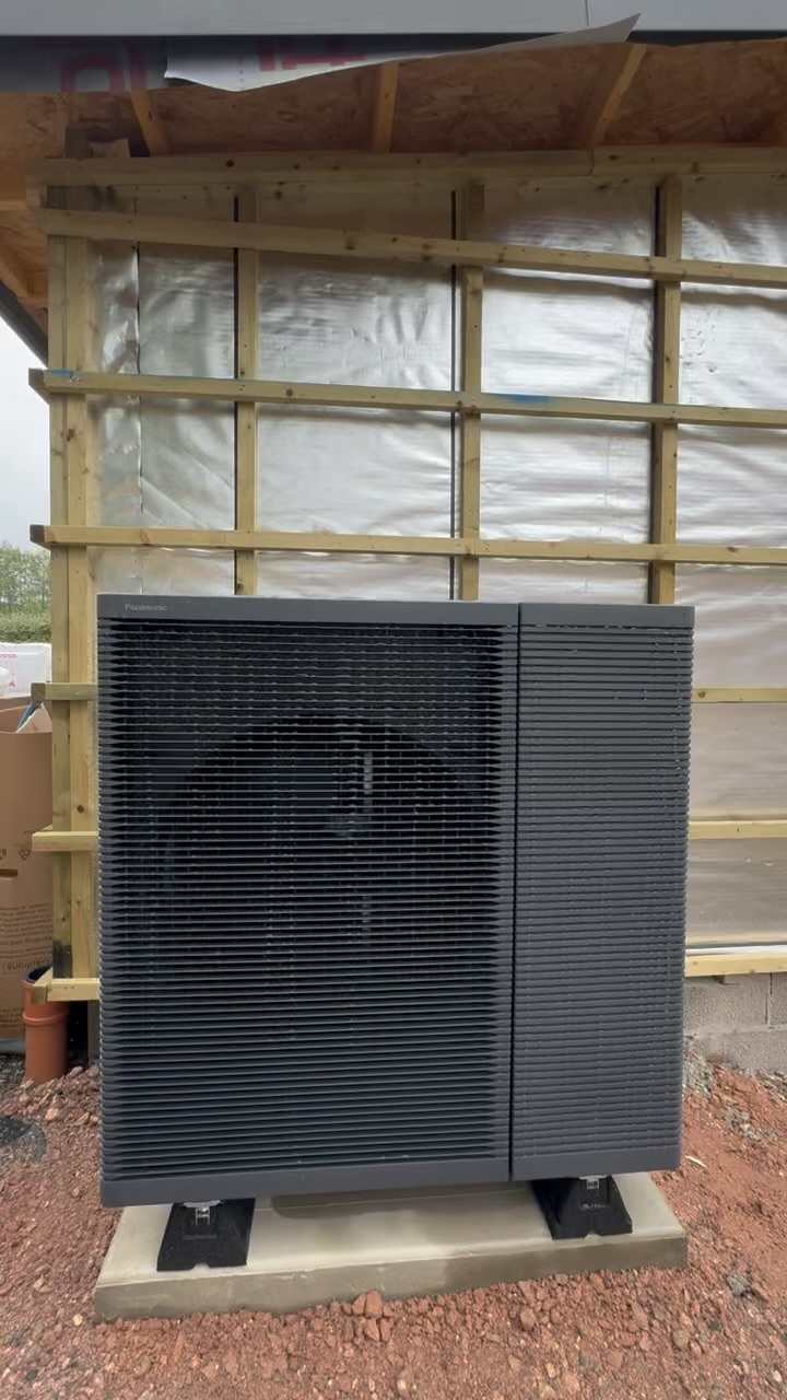

... just in time for Paul and Shaun from Air2Heat who arrived on Monday to install and commission our Panasonic ASHP and cylinder - kit which also arrived on Monday.  It's almost like it was planned!
We have opted for a 7kW Panasonic Aquarea L-series Bi-Bloc with a 300 litre Panasonic cylinder and 50L buffer tank.
We're really impressed by the speed and neatness of the install: it's almost a shame the pipework has to be hidden behind the insulation.
The external unit looks great and seems incredibly quiet - even when heating up that 300L cylinder from scratch.
Although the heat pump is working we can't use it in anger at the moment as we have to have a slow temperature ramp up to prevent the screed from drying too rapidly.  The screed itself does seem to be drying out nicely with no issues.  None of the zone stats are fitted yet so the UFH is operating in open loop mode but in reality there is no demand anyway.
I would thoroughly recommend Paul Thorney at Air2Heat as an MCS ASHP supplier and installer.  He has been super-helpful throughout our heating journey.  Initially he was just going to provide an MCS commissioning umbrella service but his price for supply of the kit was good and in the end we asked him to do the install as well - and we're very happy with the result.

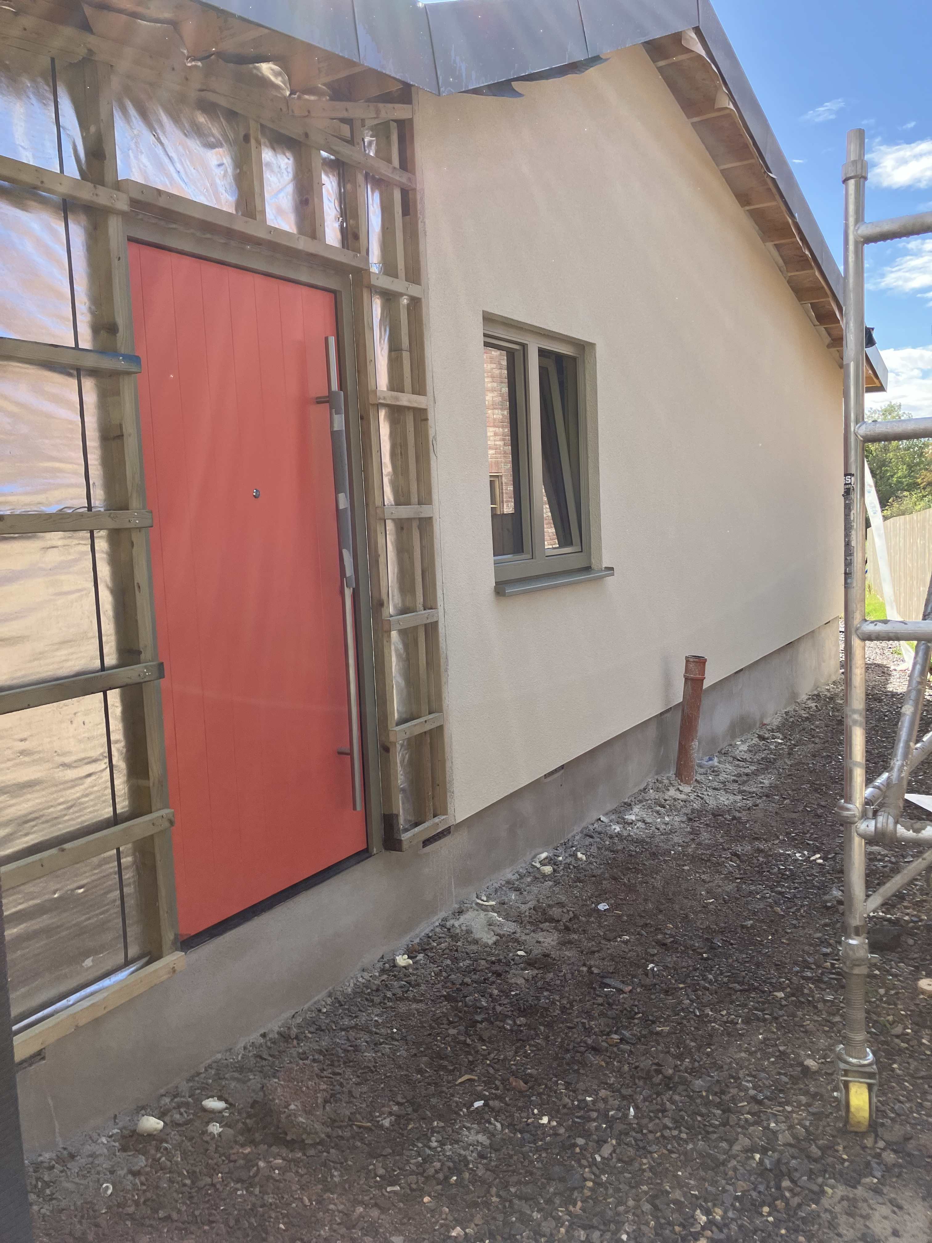

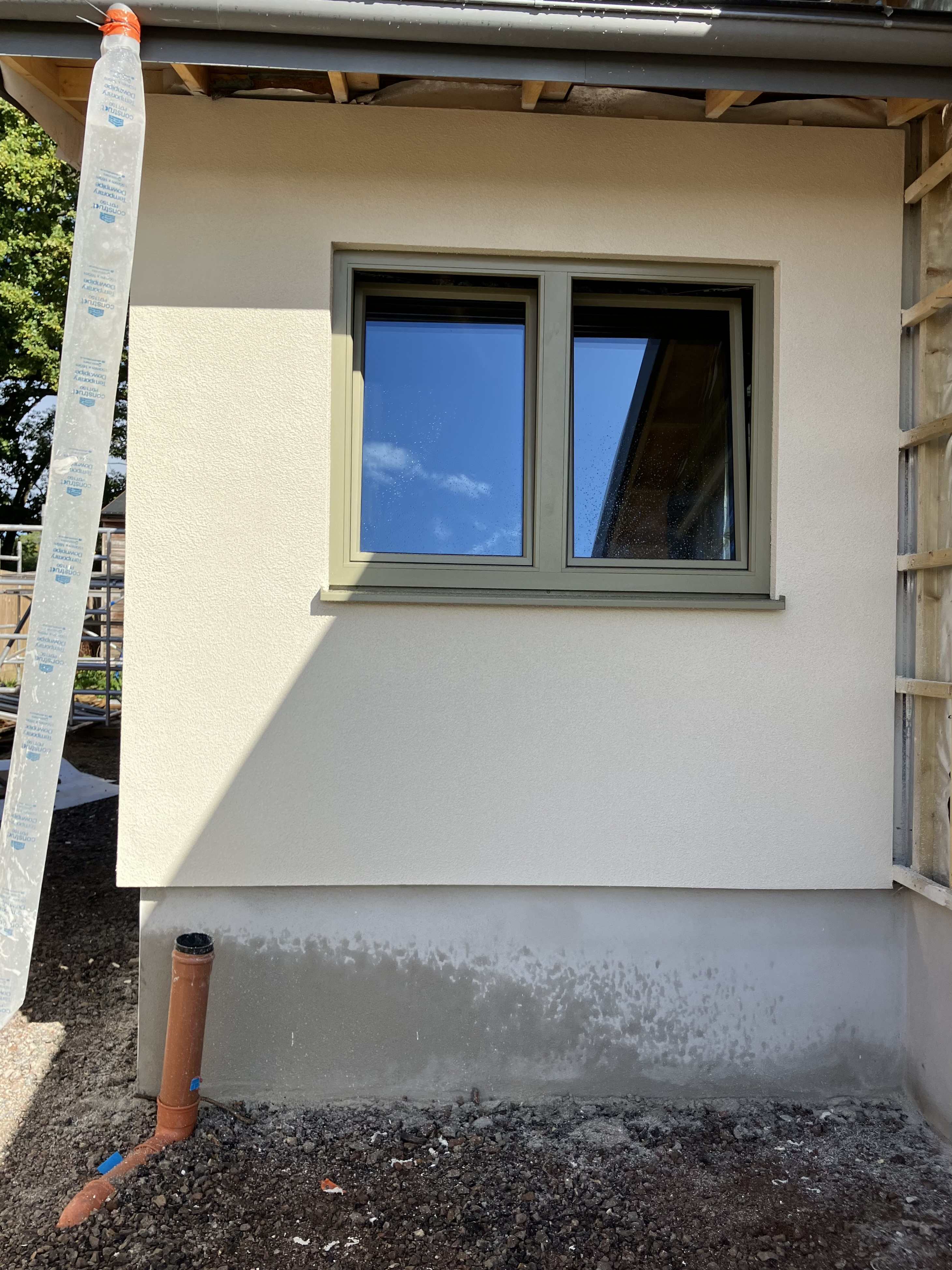

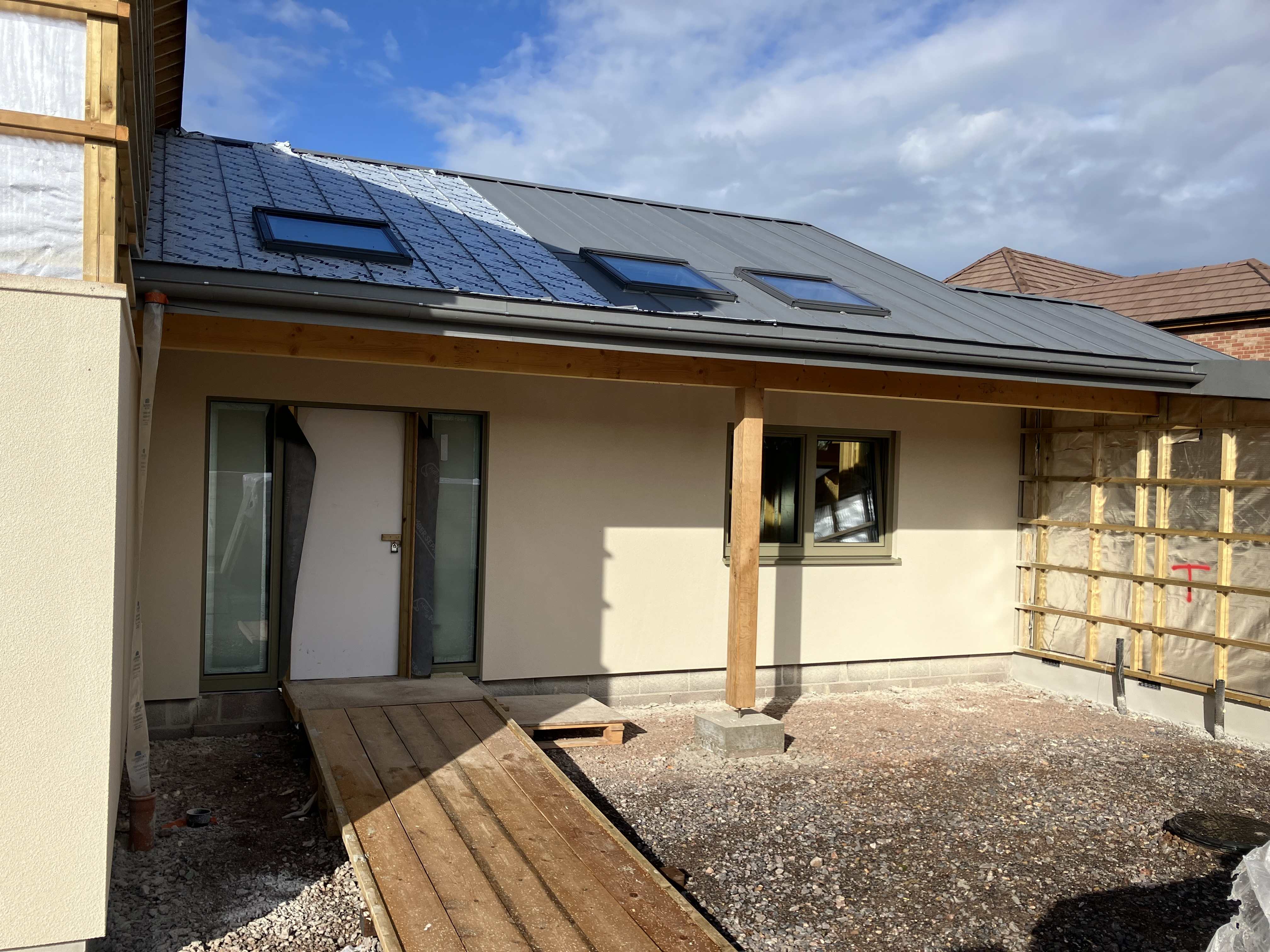

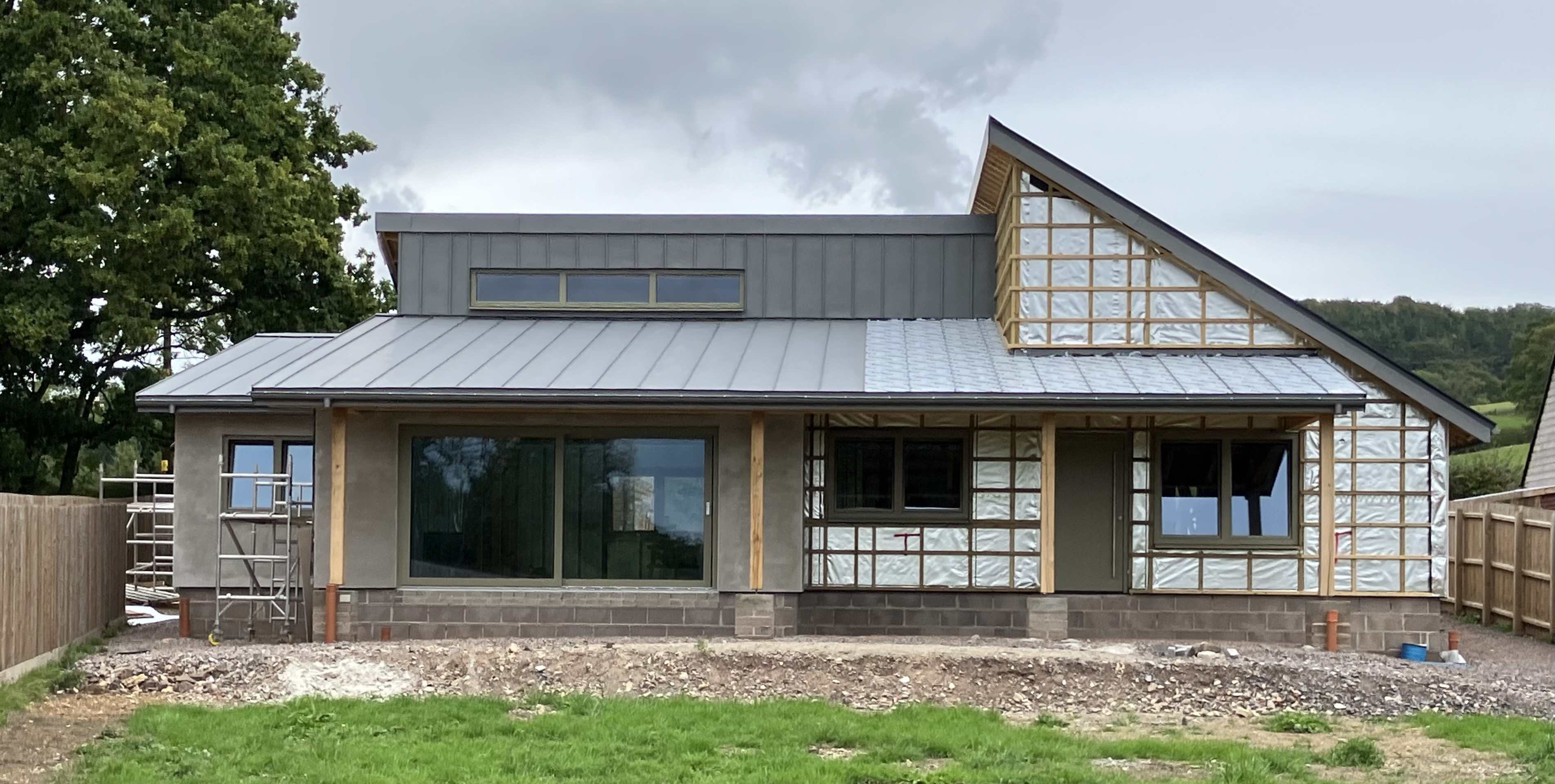

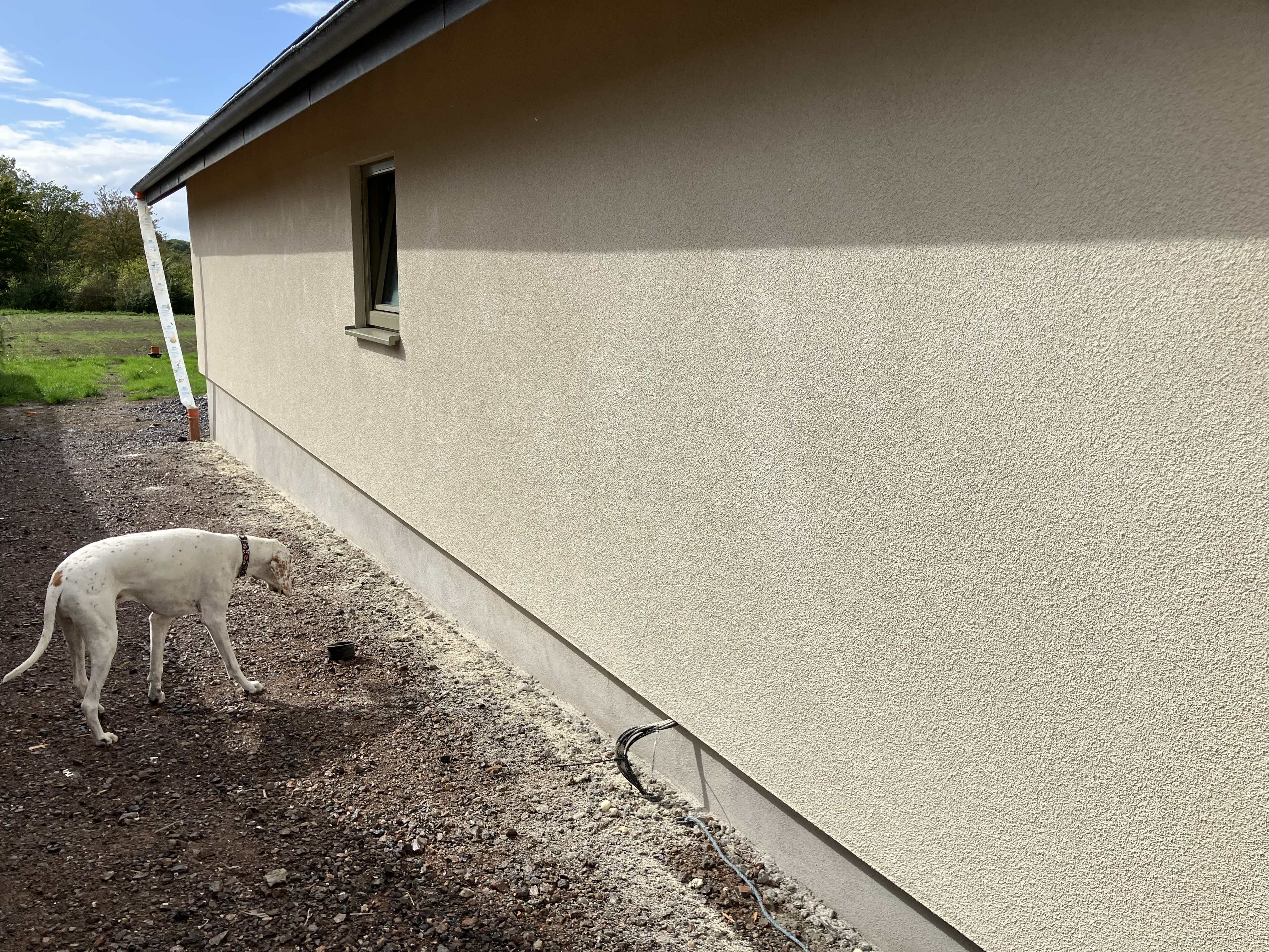

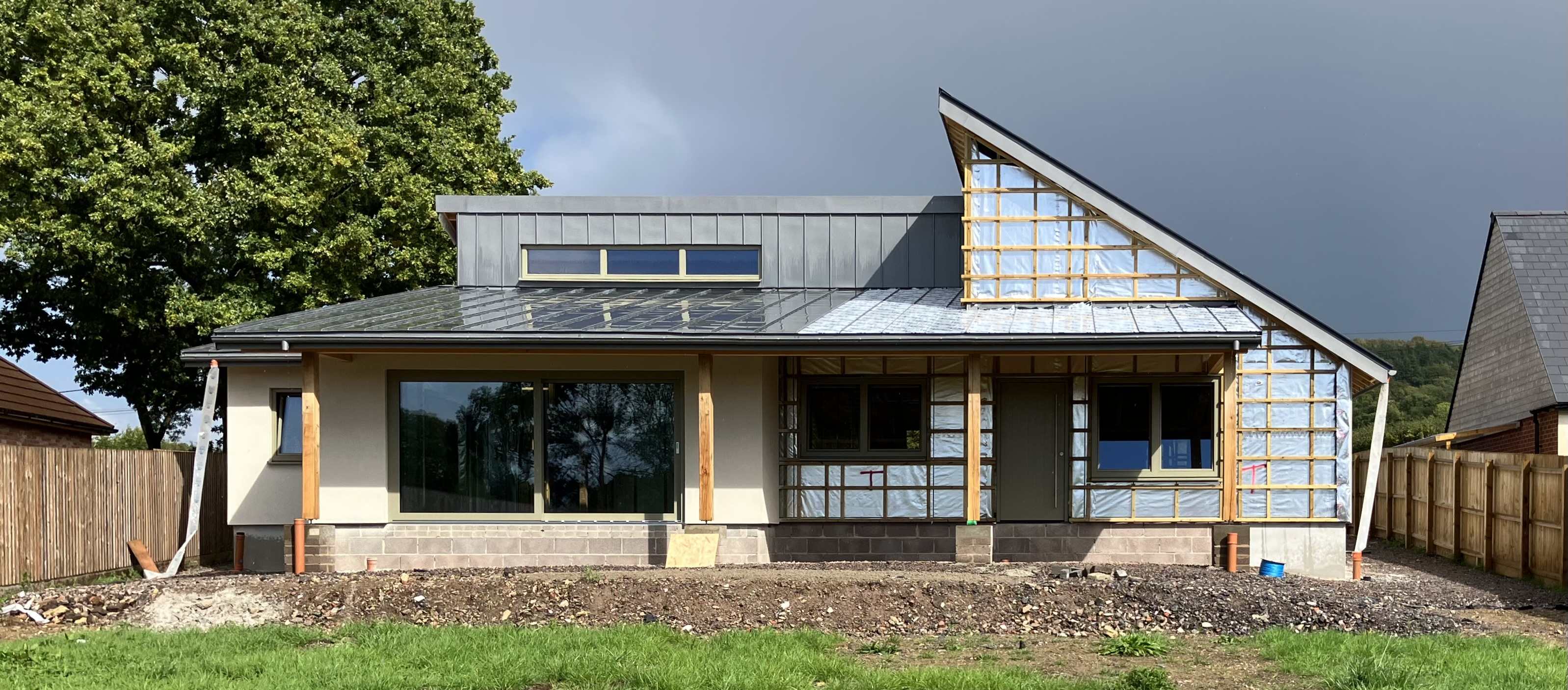

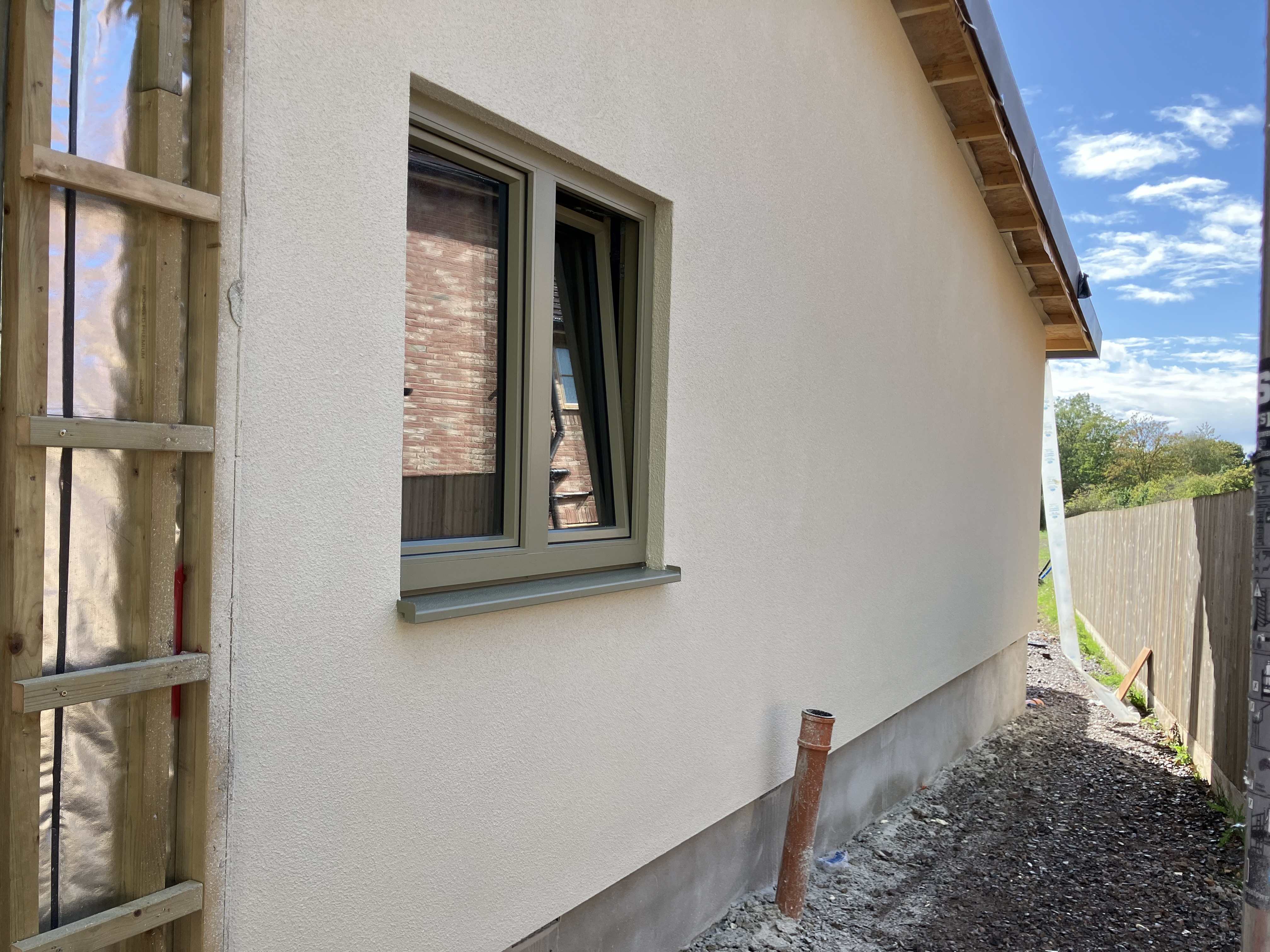

Rendering
Although the weather has been 'iffy' at best John Wheeler from Caesar Spray-Rend managed to find a window to prime our base coat and then spray the Ecorend Thin Coat topcoat in 'Scotch Stone'.  Again, we're very pleased with the result.  Once the timber cladding goes on the other sections (later, later!) we think the two finishes will work really well together.
Before topcoat
And after:
John also put a sand and cement render round the block-work below DPC to tidy that up... Although Troy seems more interested in the stray soil-pipe bung than the render:

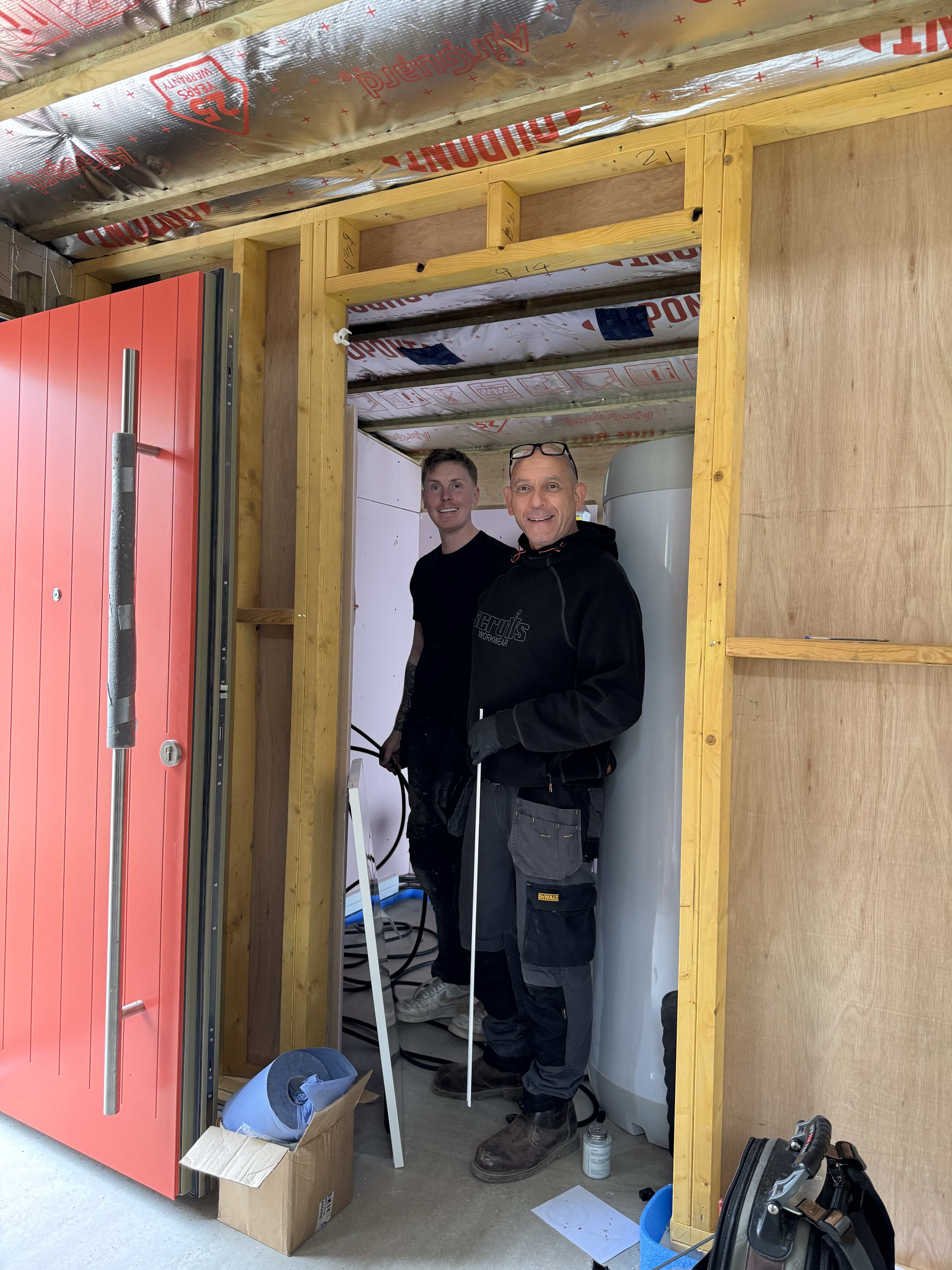

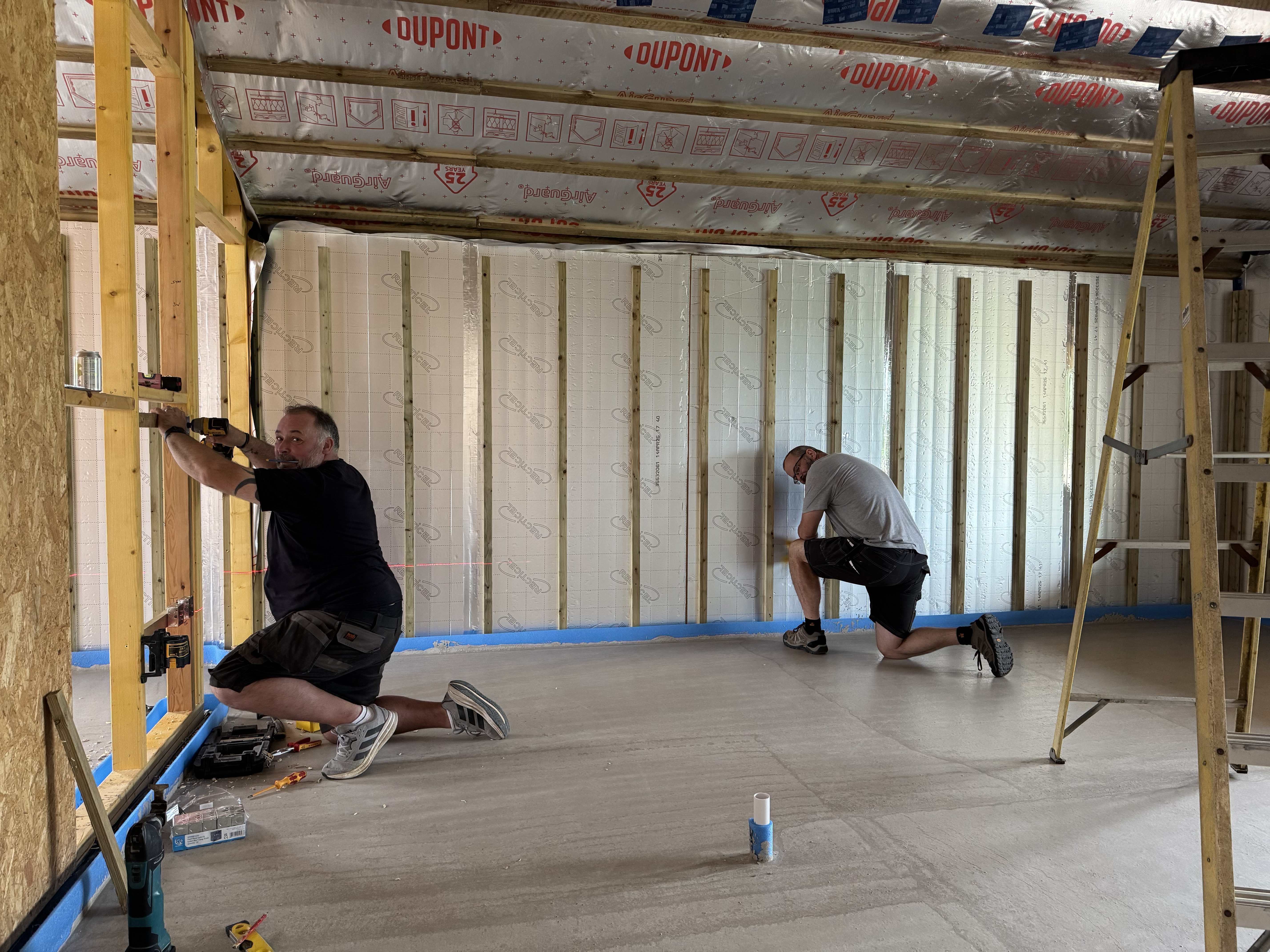

Electric 1st fix
...has started!  Unfortunately 1st fix electrics is not particularly photogenic but here are the sparkies Nick and Darren pretending to be hard at work to prove it's underway.

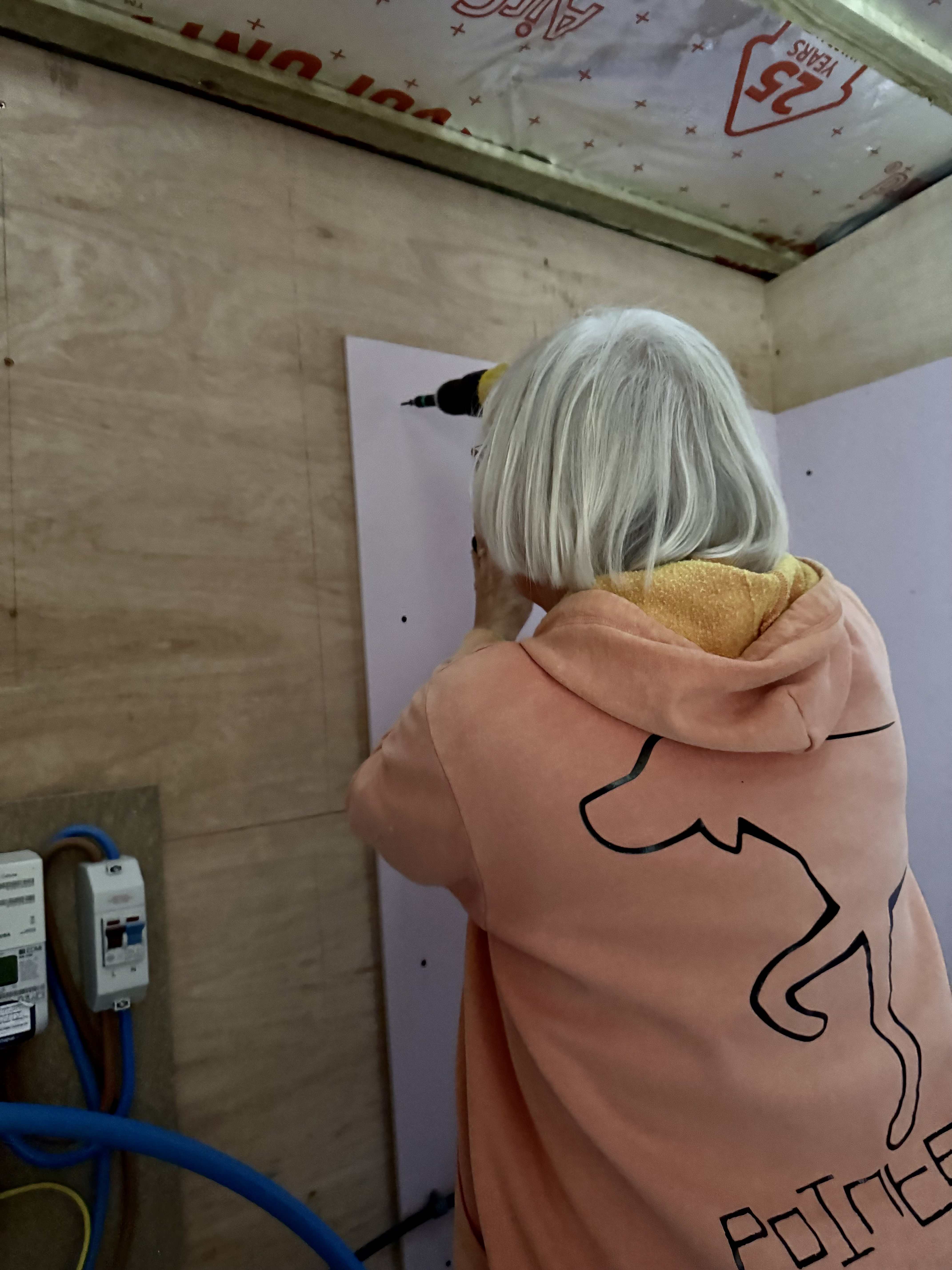

For the eagle-eyed amongst you who spotted that some plasterboard has magically appeared in the plant room... Have the plasterers started already?
No - they don't start until after 1st fix, of course, but the plant room presents a 1st fix v plasterboard conundrum - so who did we manage to rope in for some impromptu 'boarding out'?   Why, none other than Mrs P!  Seen here in action:
Great job Mrs P. - good to see you wearing the Benpointer team hoodie!

JohnMo
Why are you zoning and therefore needing to have a buffer?
Benpointer
We've had this debate on another thread John.
We're note zoning, at least not from a heat pump perspective.  We do have room stats controlling loops to specific rooms because we want some rooms (bedrooms, pantry) to be cooler than others (bathrooms).  (If you consider that zoning then ok.)
I believe your view is that we could control this be setting loop flow rates at the manifold but frankly, I can't be arsed with that 'tweaking' - I'd rather just use a room stat.
The 'buffer' is really a volumiser, it's recommended by Panasonic:
Volumiser: in the open primary circuit (when all heating – cooling circuits are closed) it is recommended a minimum water volume of at least 30 litres is included.
