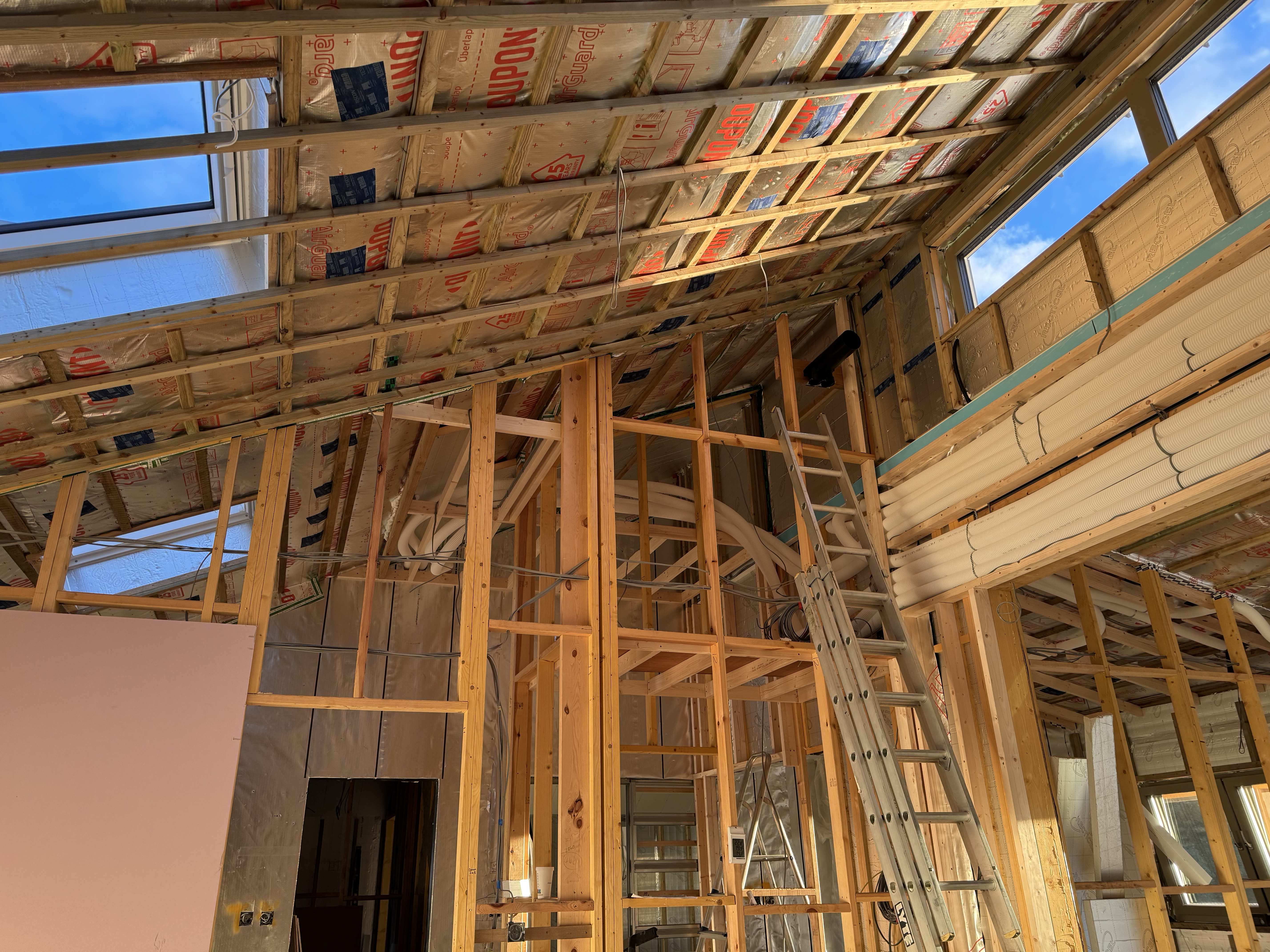

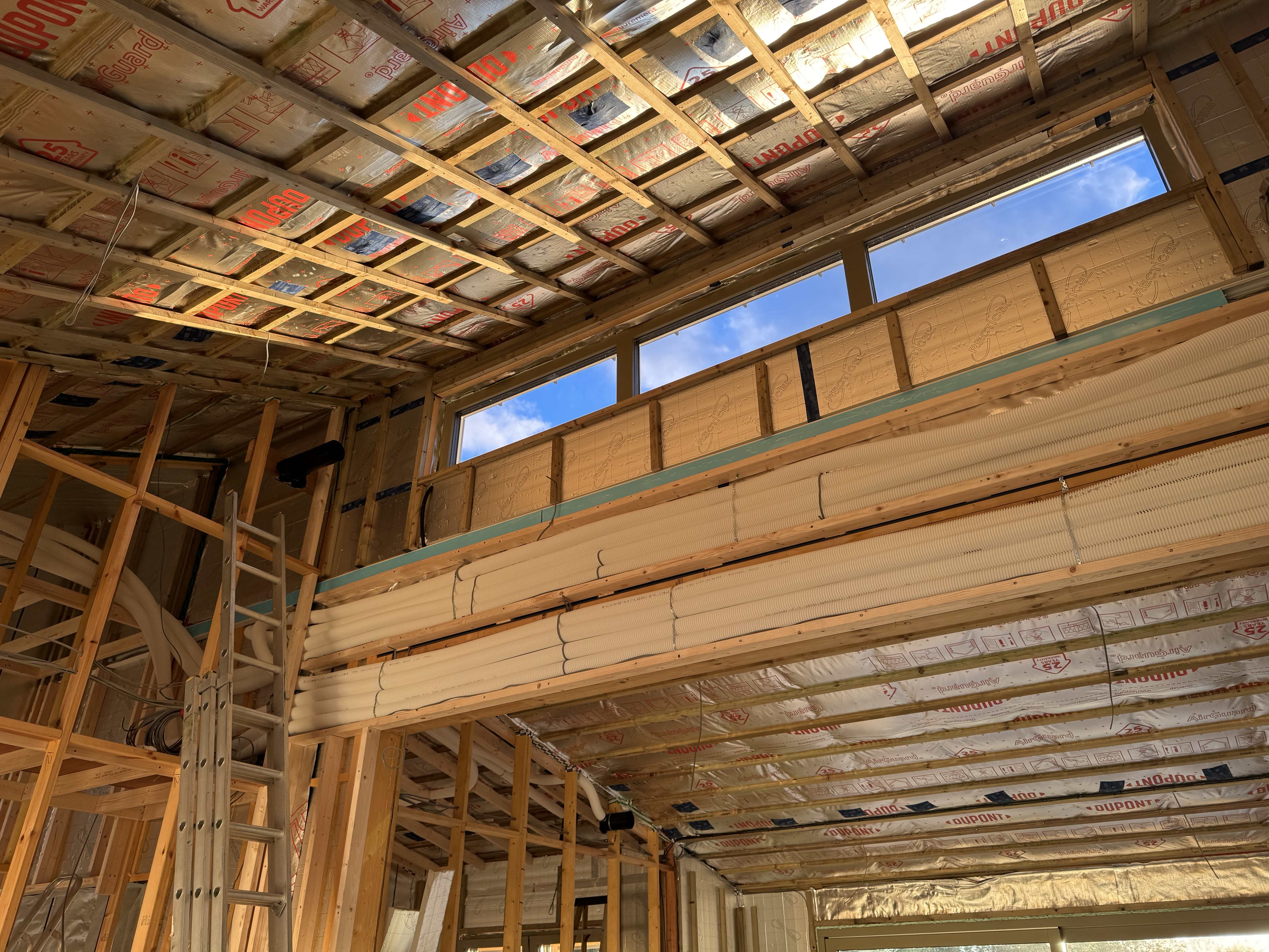

Carpentry

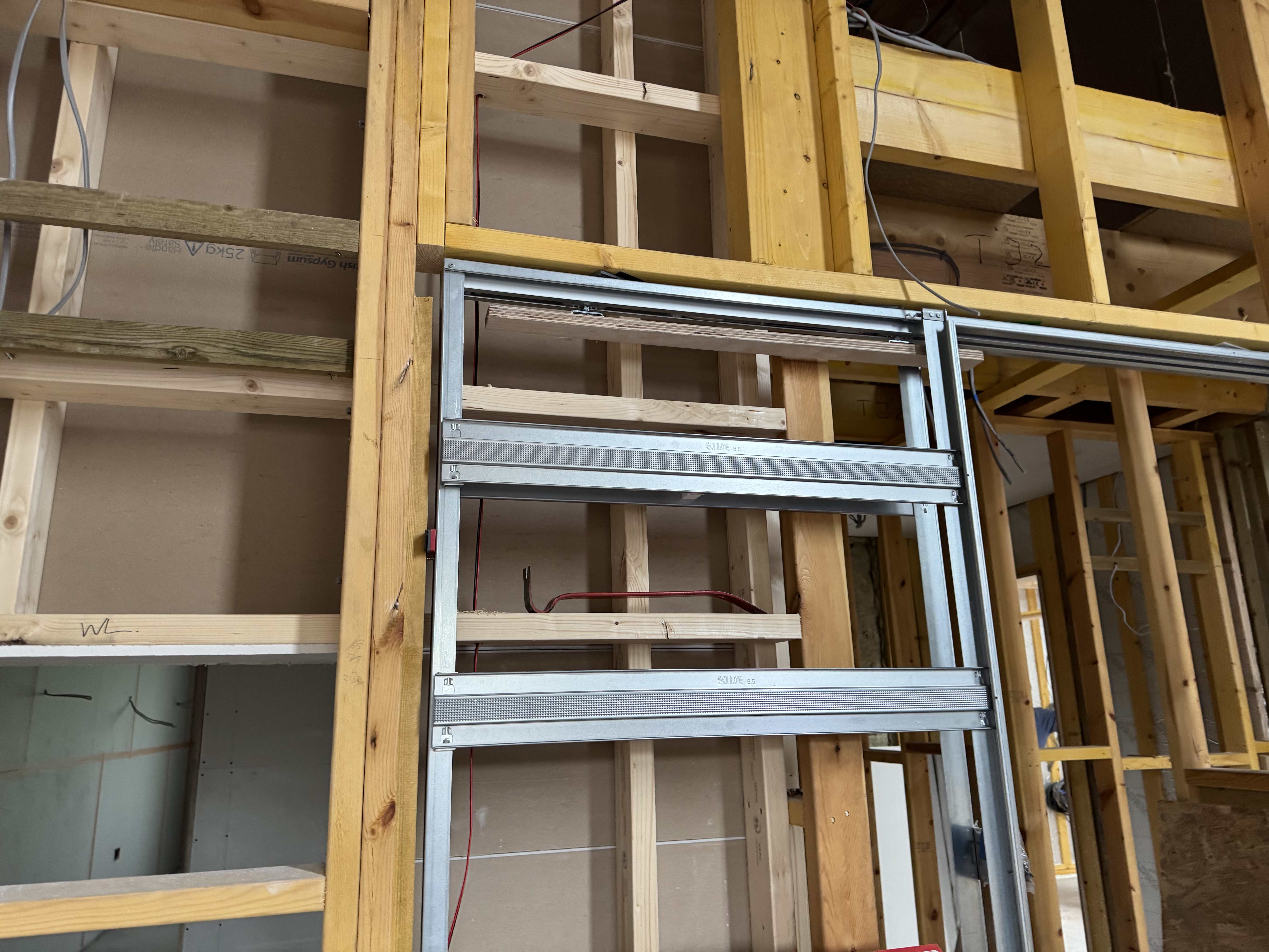

In parallel our two chippies Chris and Alan have been making sure various false walls and ceilings have been put in place ready for the plasterers.  They have also fitted three of our four pocket door frames - just one more to install next week.

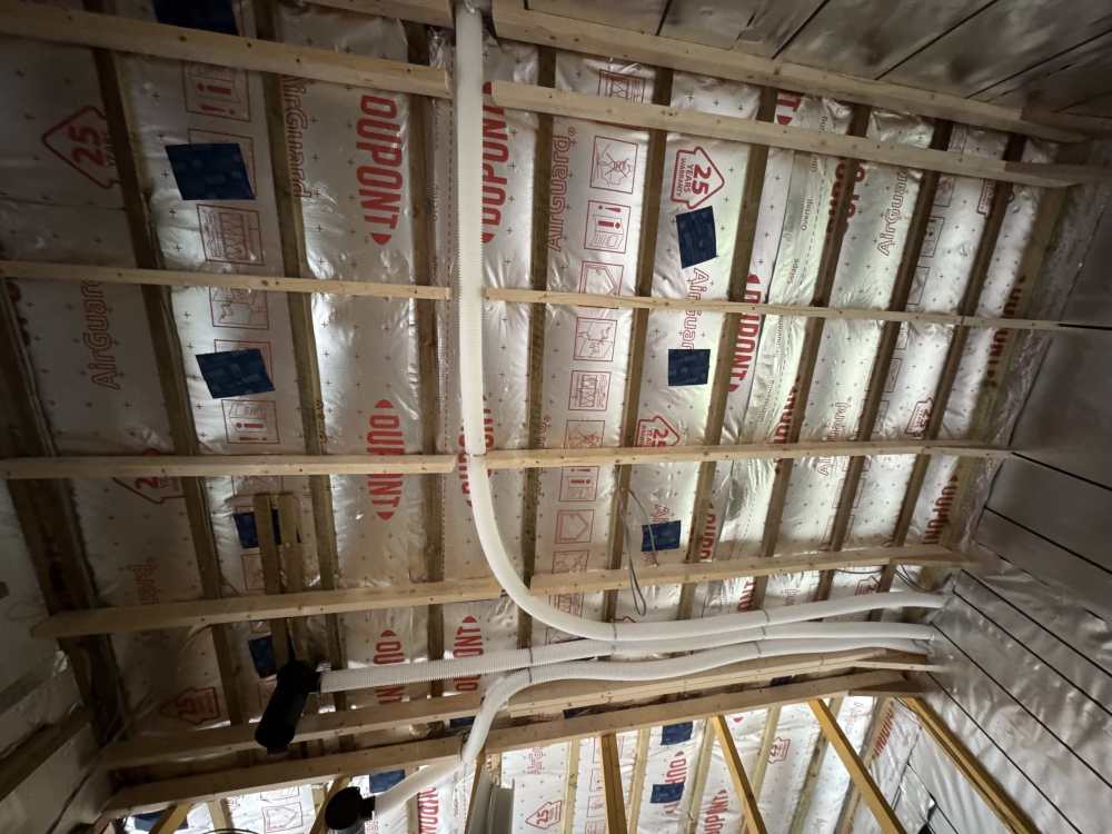

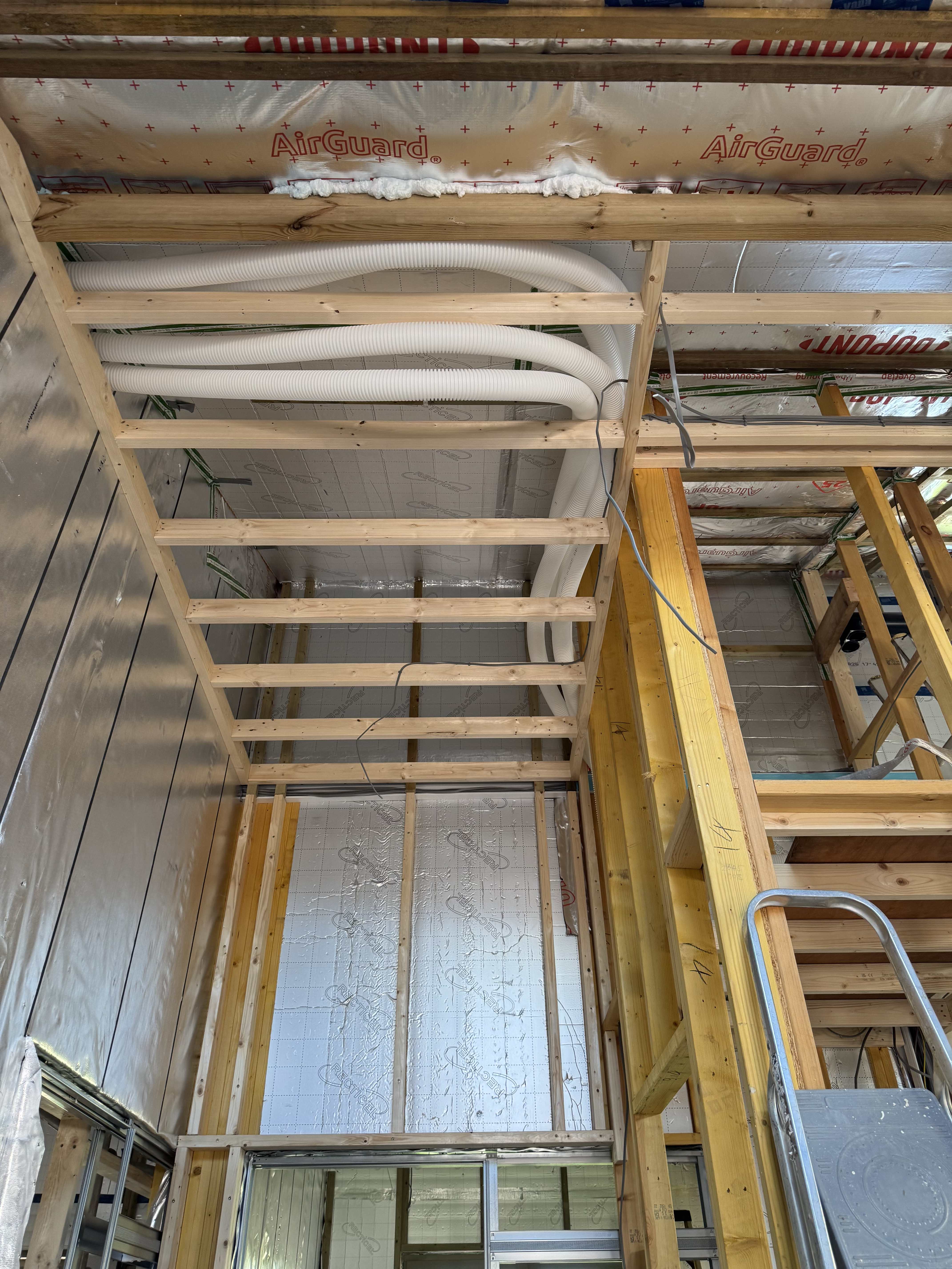

Somebody also needed to run the MVHR ducts and fit the vent plenums to the rooms the plasterers were planning to start with.  This seemed like a golden opportunity for Chris and Alan to acquire some new skills.  I am not sure it was high on their wish list to be honest but they cracked on with it nonetheless.  Regular free breakfast baps still works wonders when you’re asking people to go the extra mile.

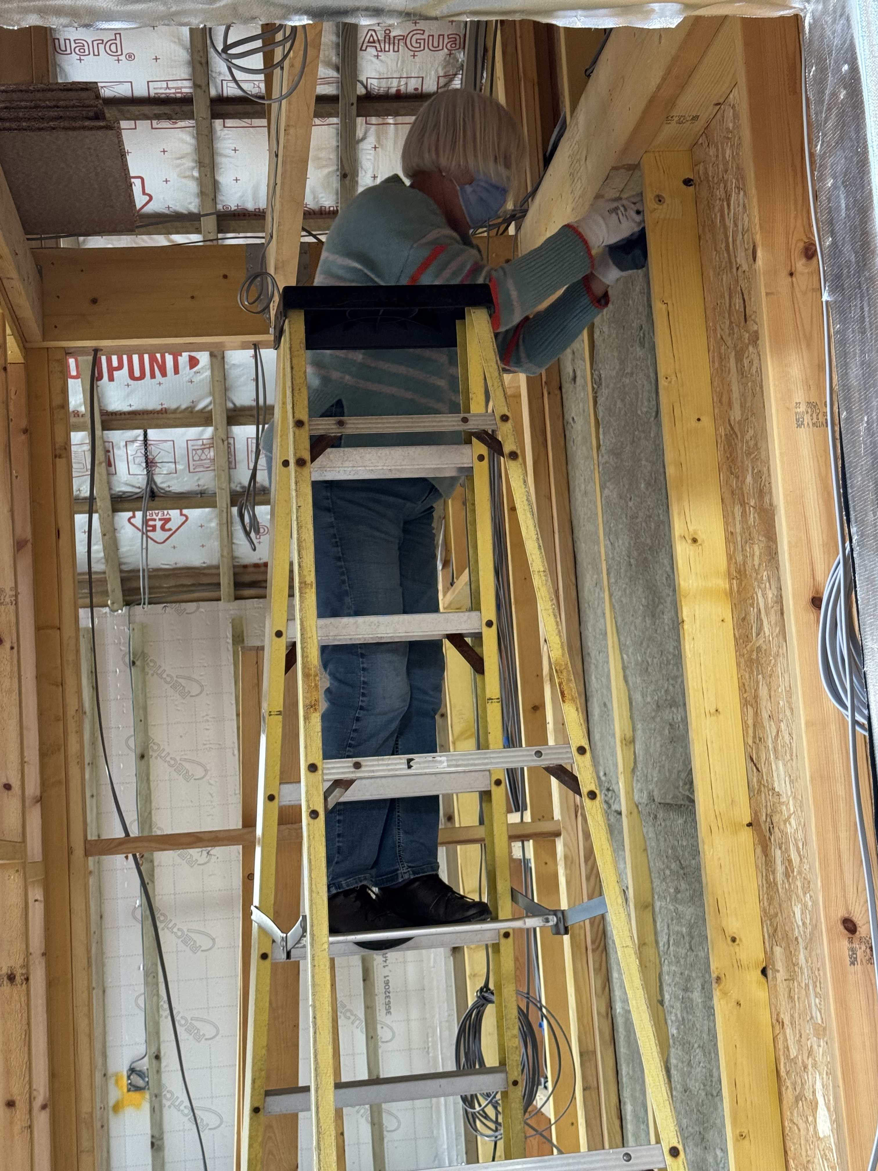

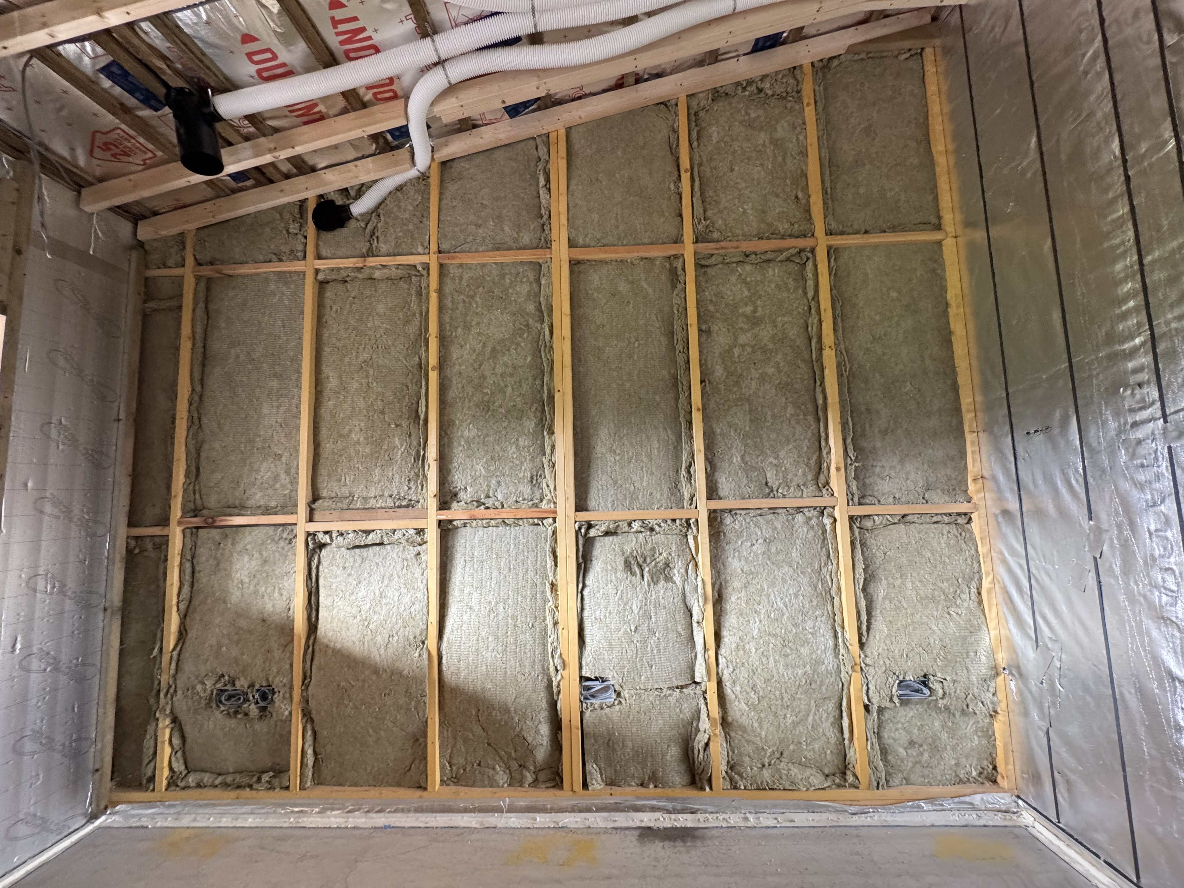

Acoustic insulation

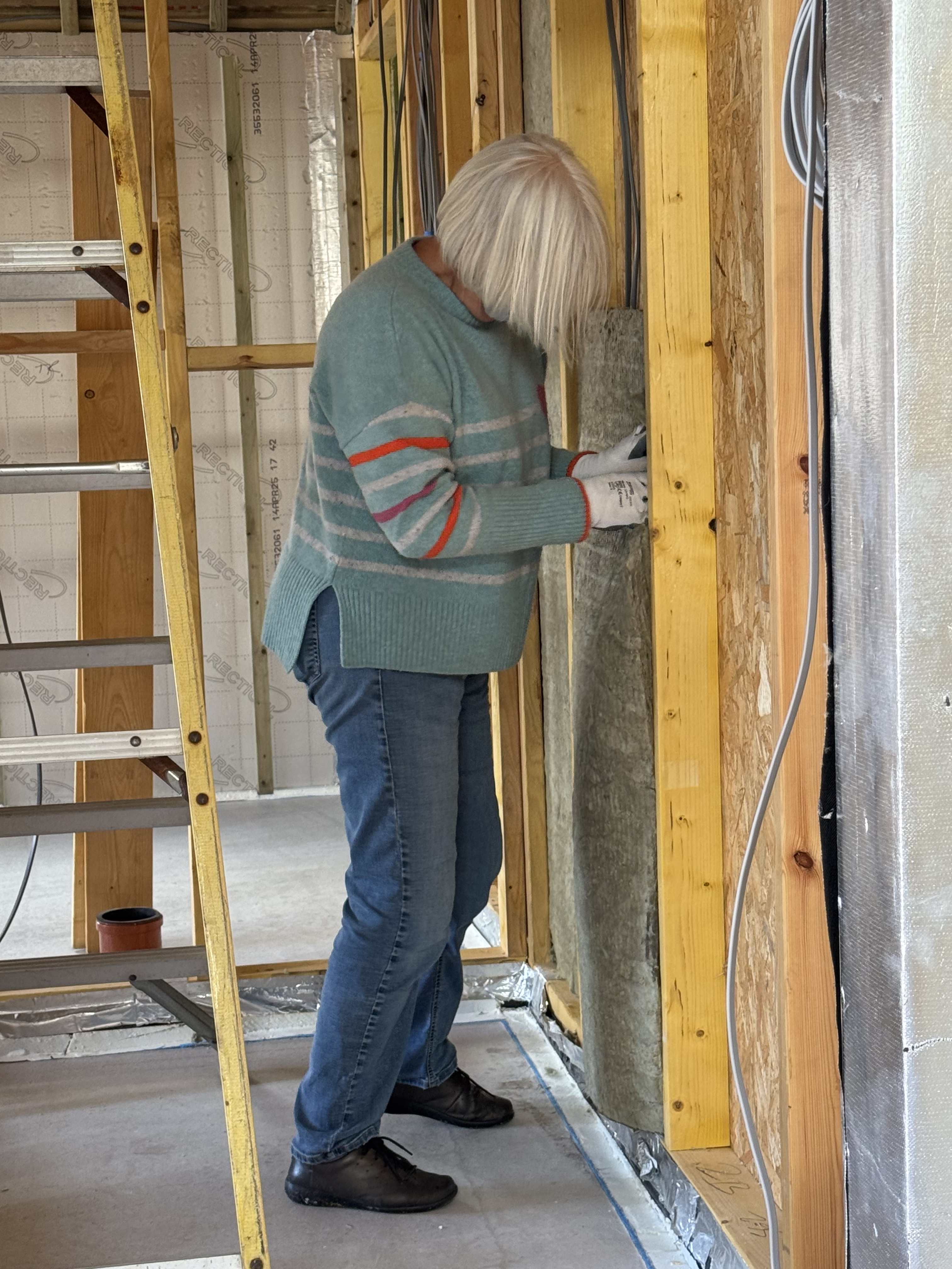

I could see that Mrs P. was itching to get involved with something and fortunately someone needed to push all the Rockwall acoustic insulation in to the internal stud walls.  Luckily as it’s Rockwall rather than glasswool no further itching was involved.  Anyway, Mrs. P has done a great job, as you can see.

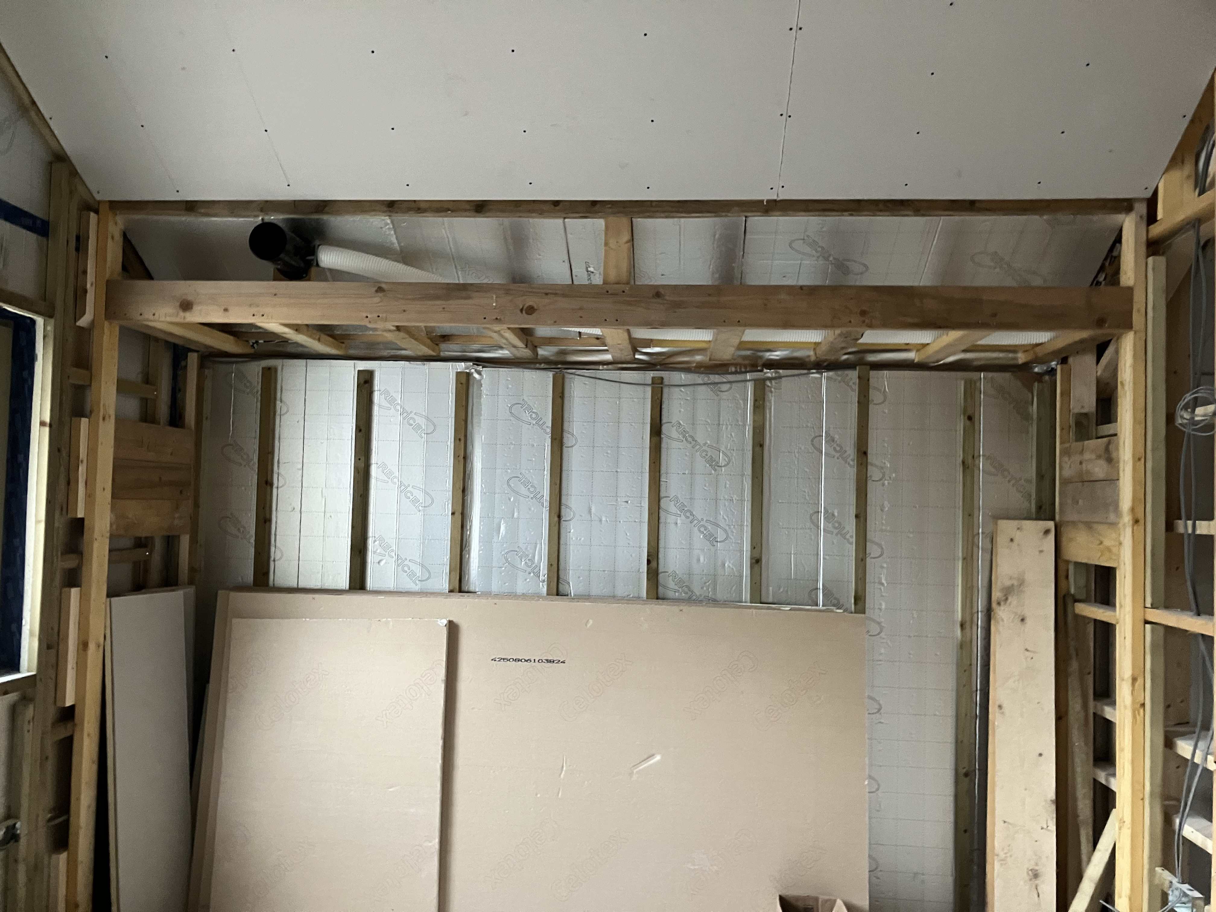

Plastering

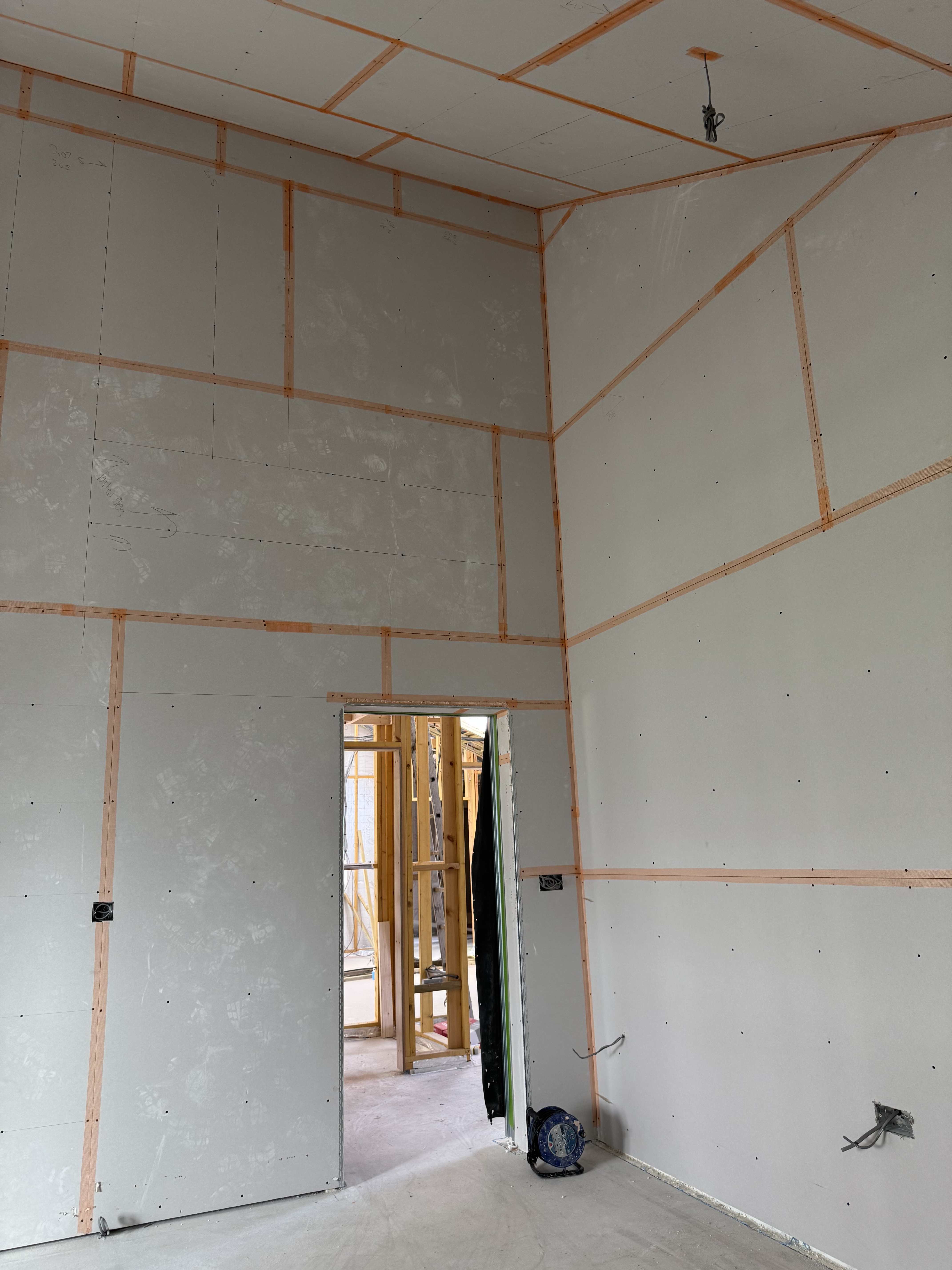

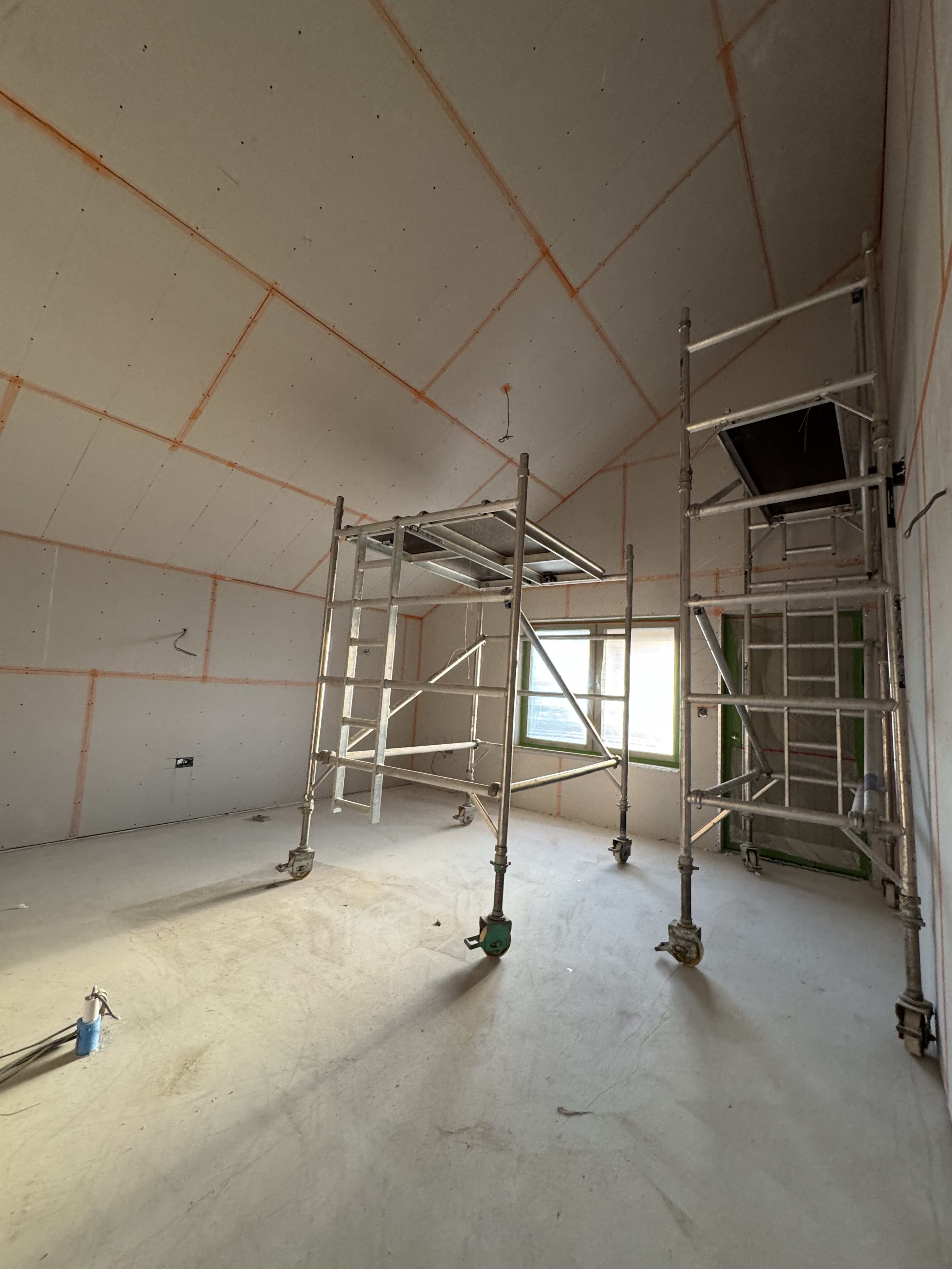

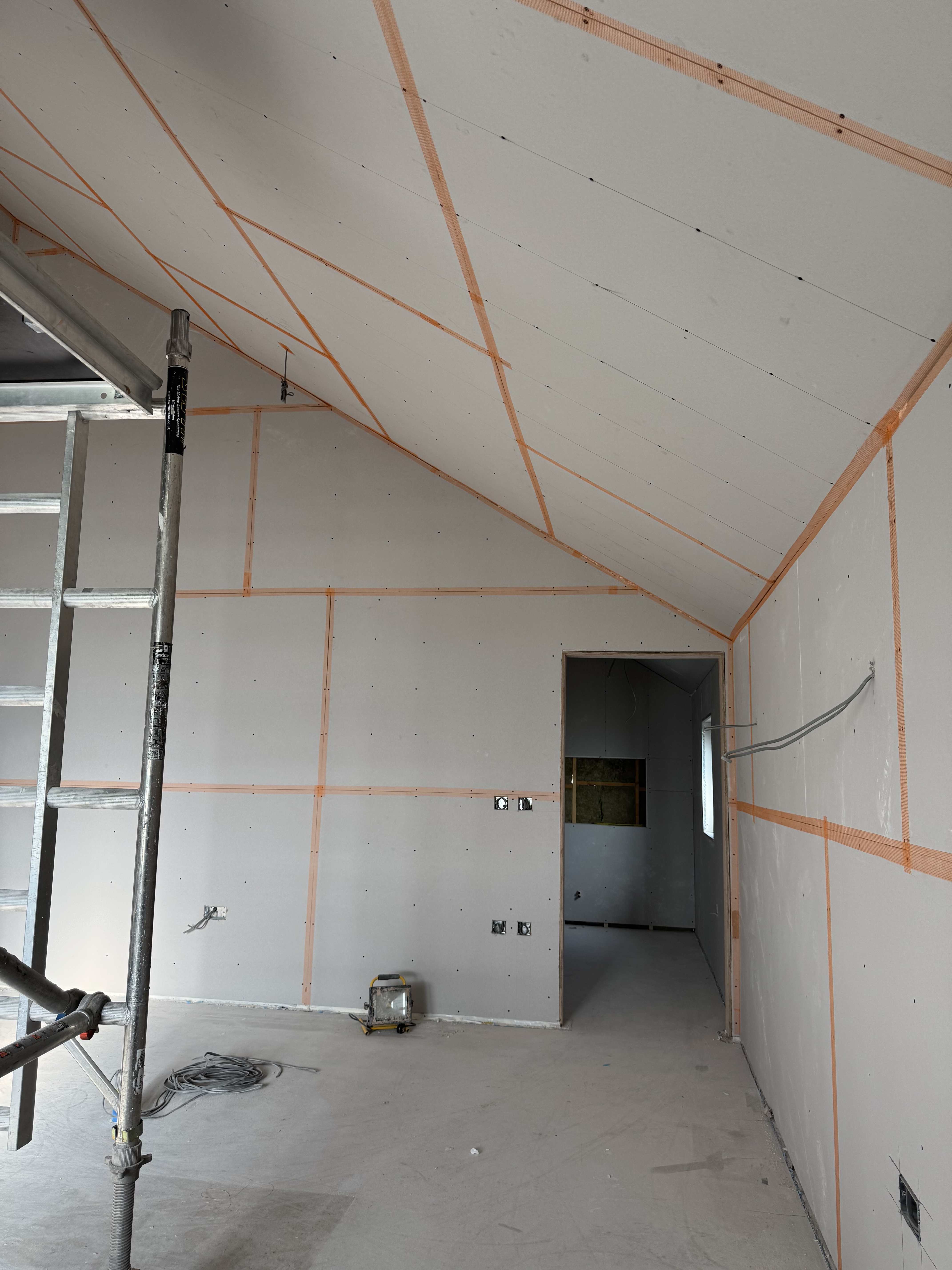

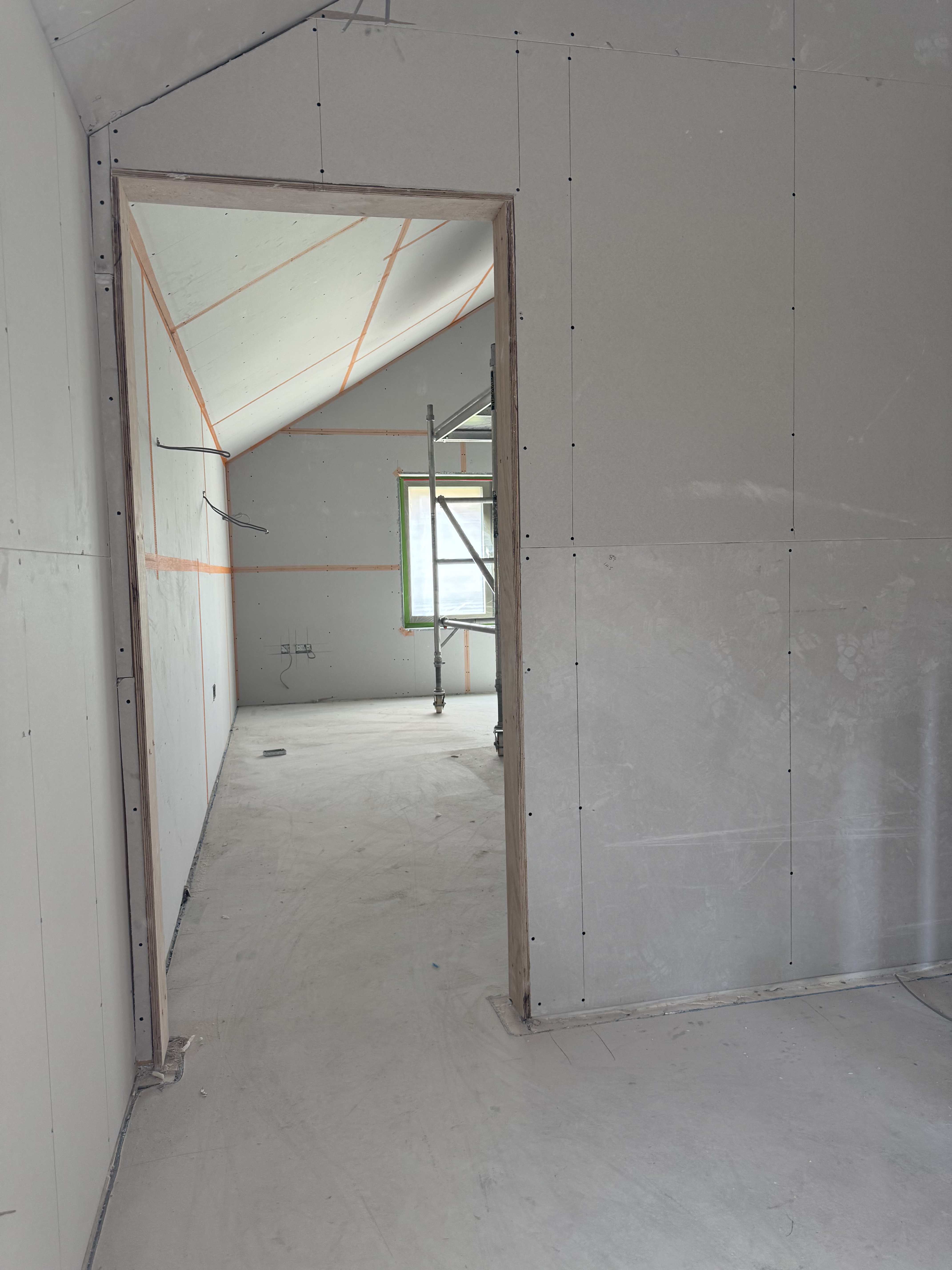

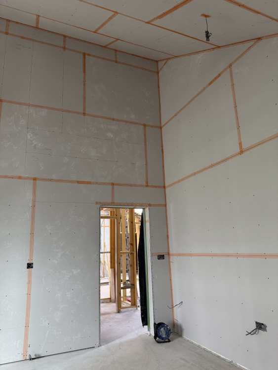

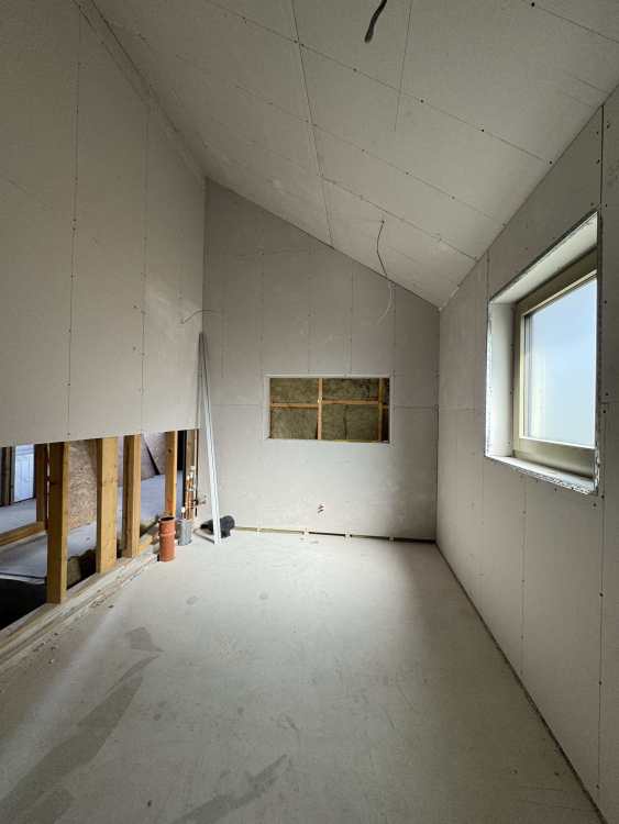

All of the above were things we needed to have done (or at least done enough) for the 8th of October, which is when our plasterers Dan, Sam and Brandon were booked to start.  They duly turned up as planned and we had enough of the rooms ready for them to get started.  In the plan, all the carpentry work would have been completed before the plasterers started but they seem happy enough to board out then skim one room at a time as the carpenters keep ahead of them.
The initial focus has been on the boarding out bedrooms 1 and 2 and the bathrooms and the early progress bodes well for the rest of the task which we aim to complete by the end of October… ready for the floor tiler!

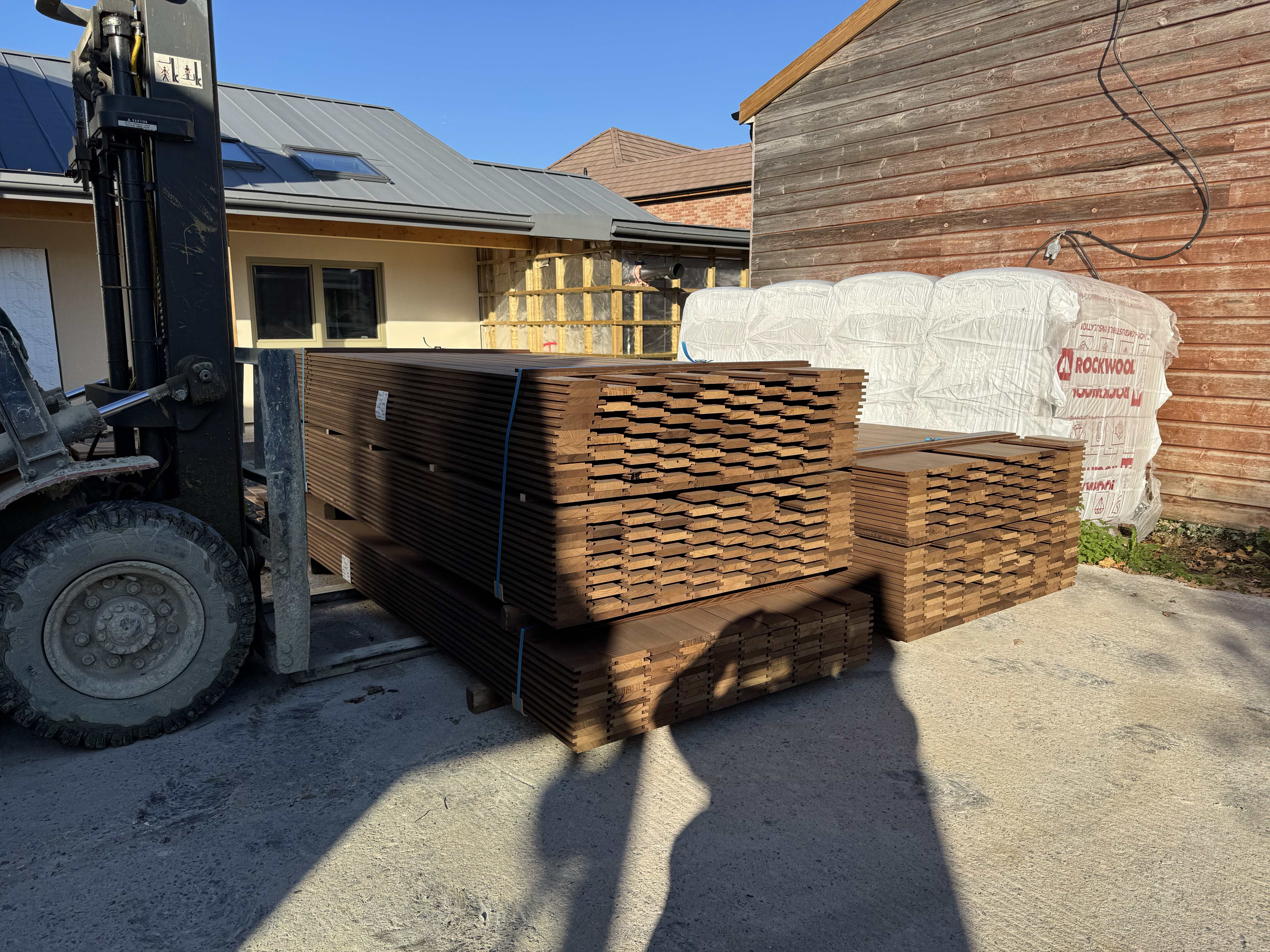

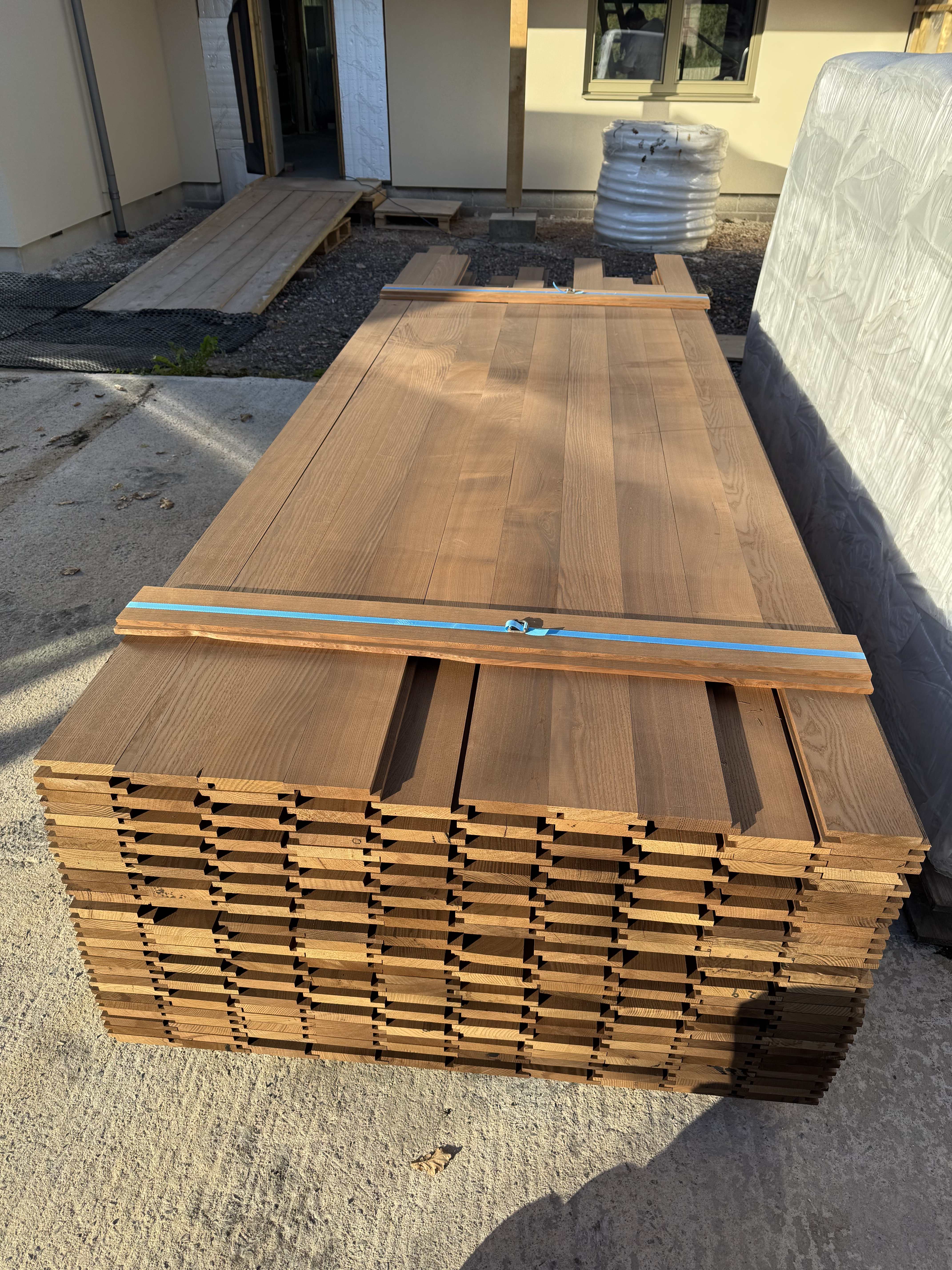

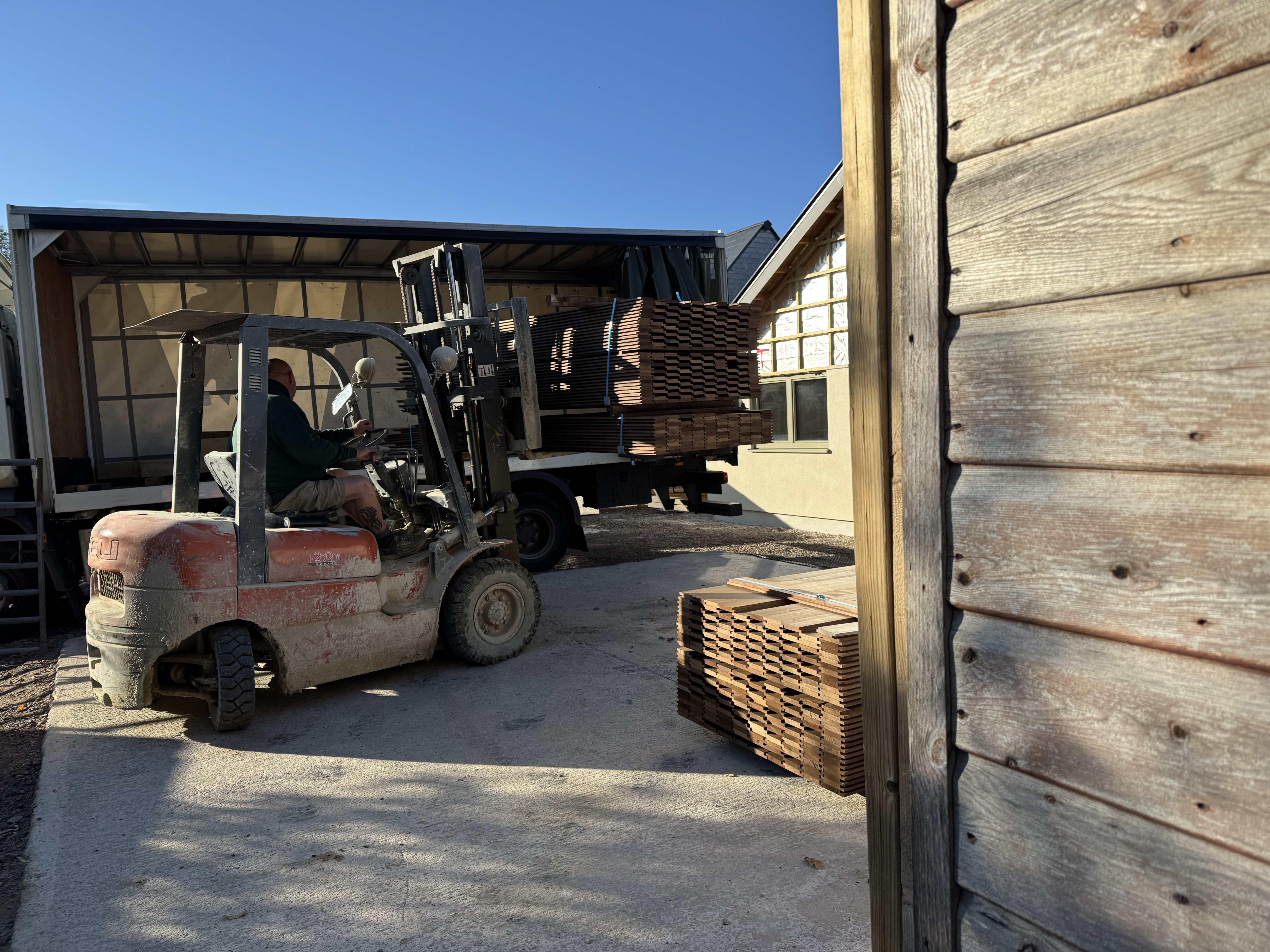

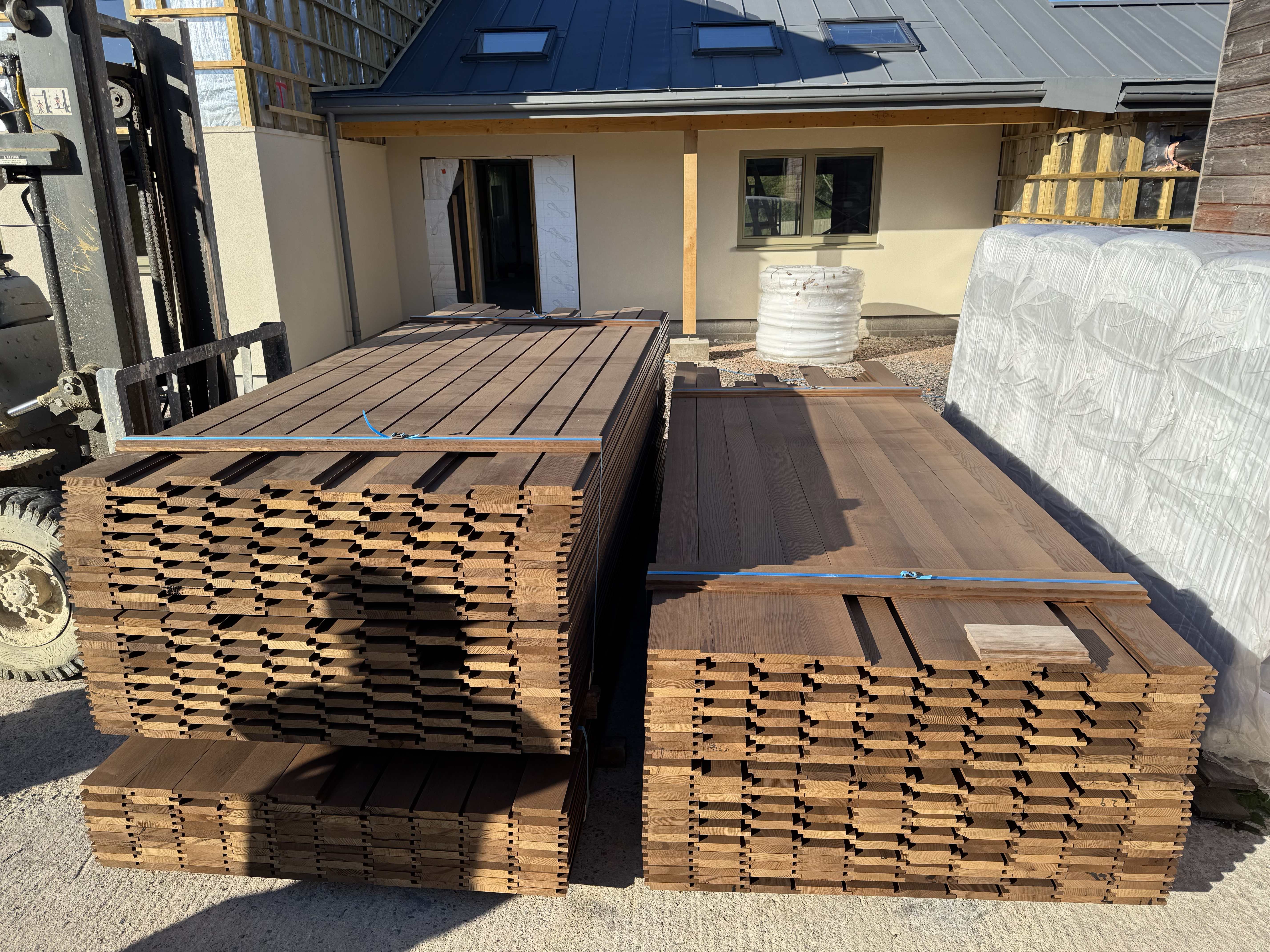

Our timber cladding has been delivered.  We’re using  Brimstone Ash from Vastern near Swindon https://www.vastern.co.uk/timber-cladding/brimstone-ash/  which we will be having fixed vertically.  Once Alan and Chris have finished all the internal work required for the plasterers the plan is for them to move on to the external cladding - assuming they haven’t had enough of us by that stage.  More breakfast baps may be required!

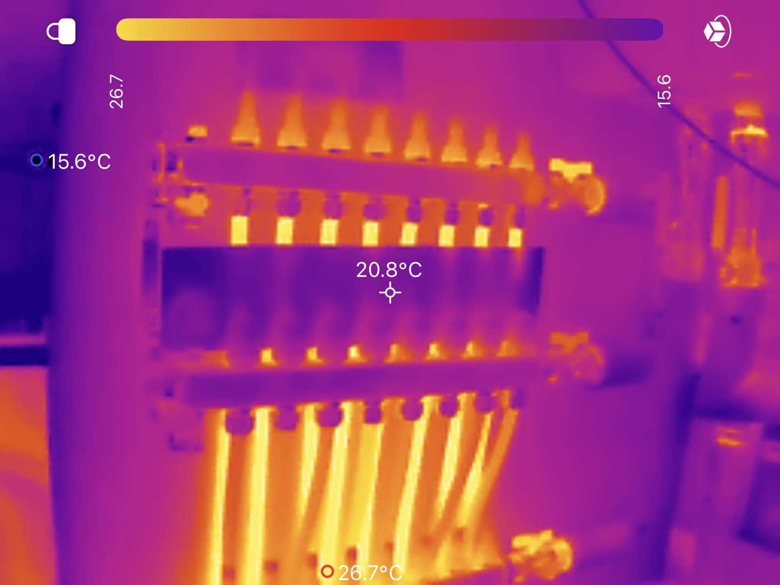

And finally, I have bought a new toy… a Topdon infrared camera to plug in to the iPhone.  Cue quizzical look from Mrs P. “er… and you needed this for what exactly?”
Good question Mrs. P, but I have at least been able to check that the UFH loops are all working:
