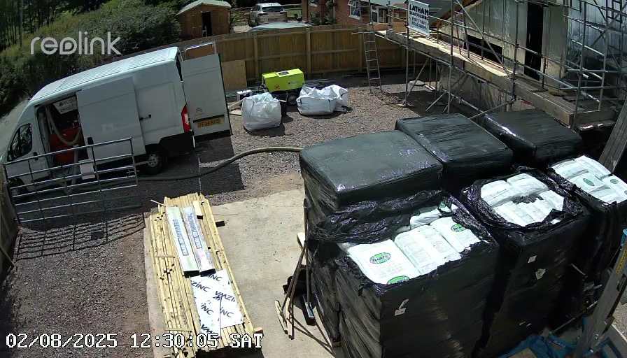

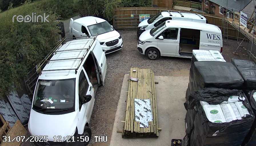

We definitely reached site capacity with five vans and seven contractors on-site on Thursday and Friday.   Seven pallets of cellulose bales arriving mid-week didn’t help space management either.

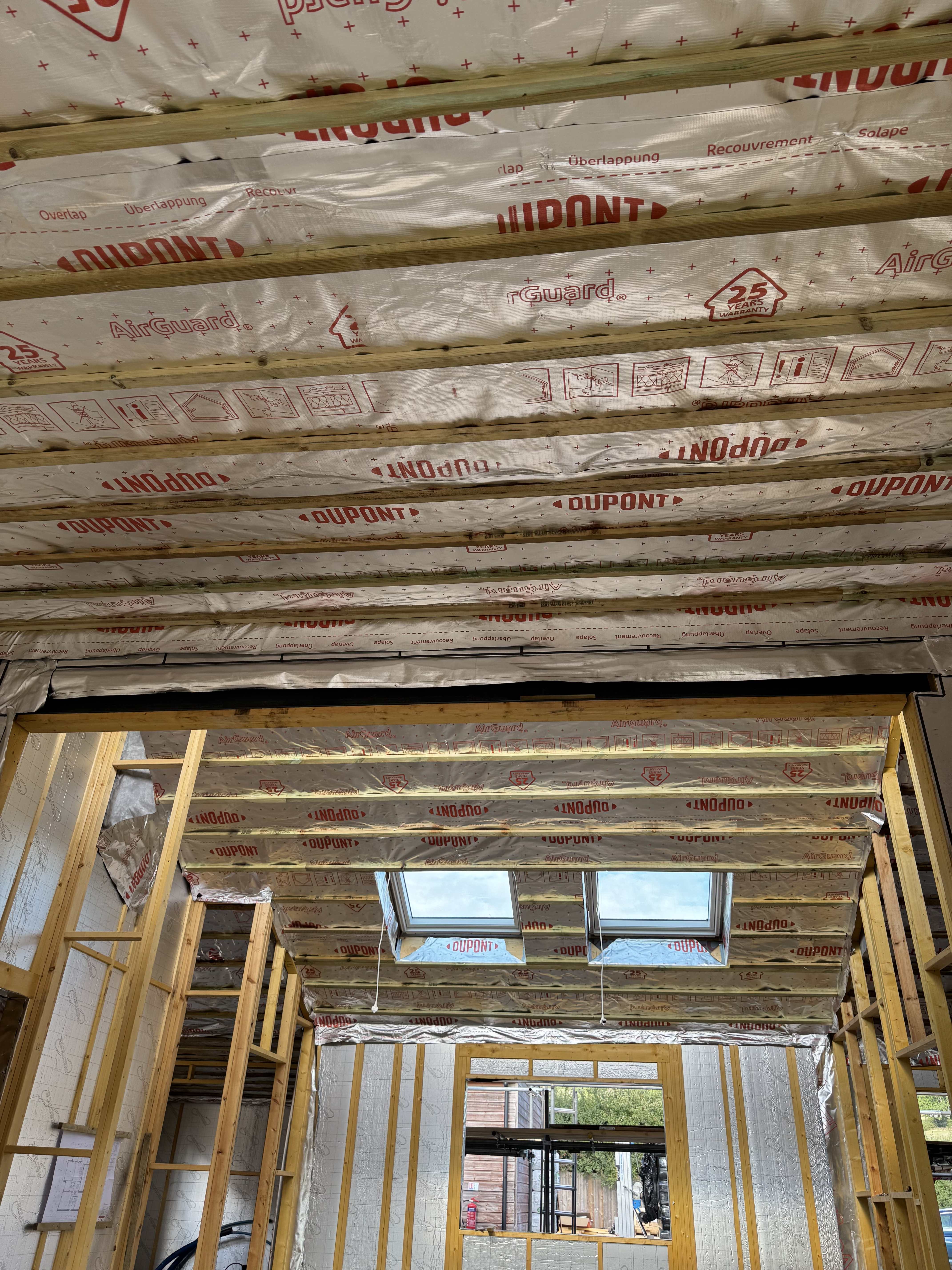

Membranes

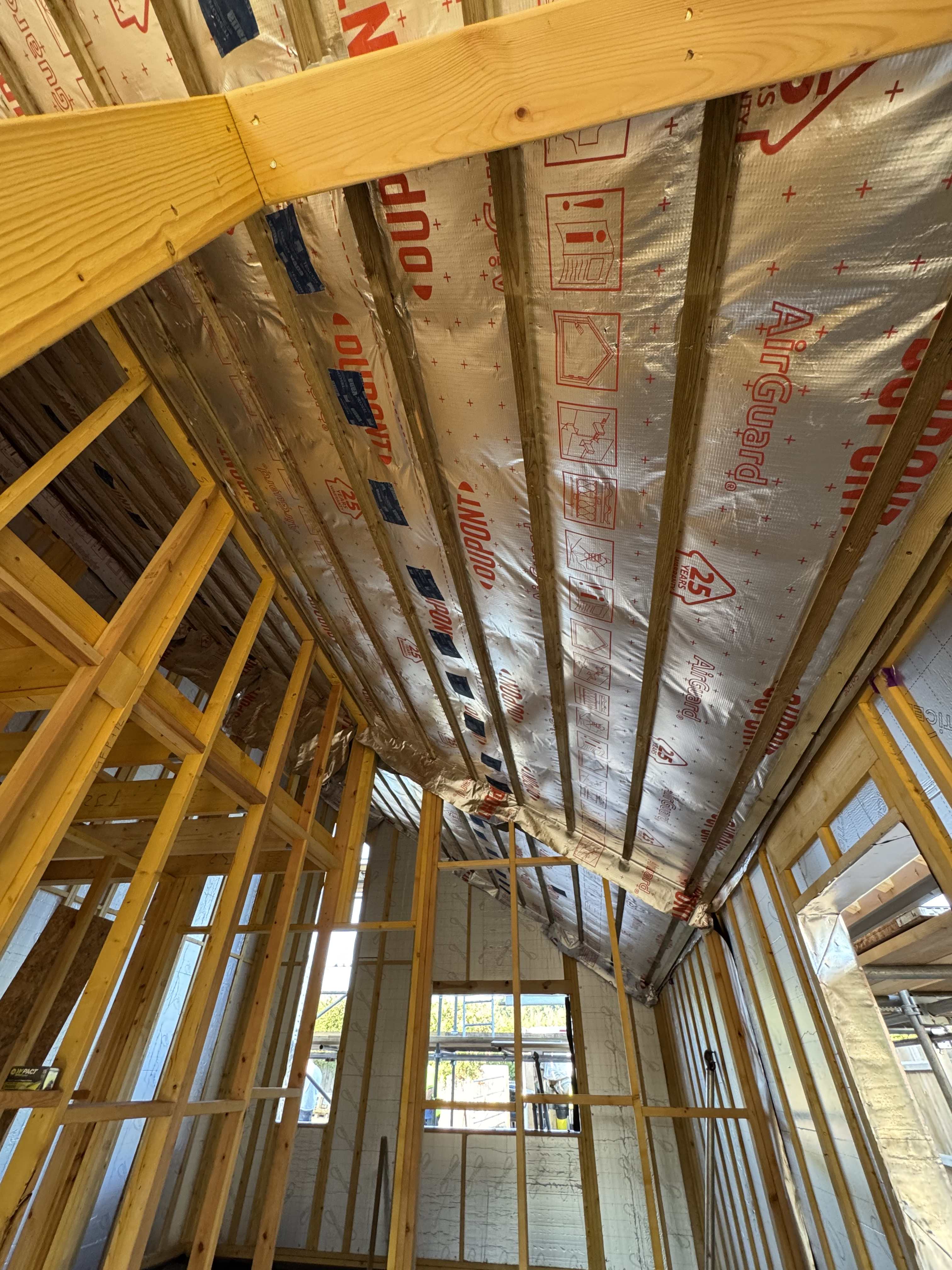

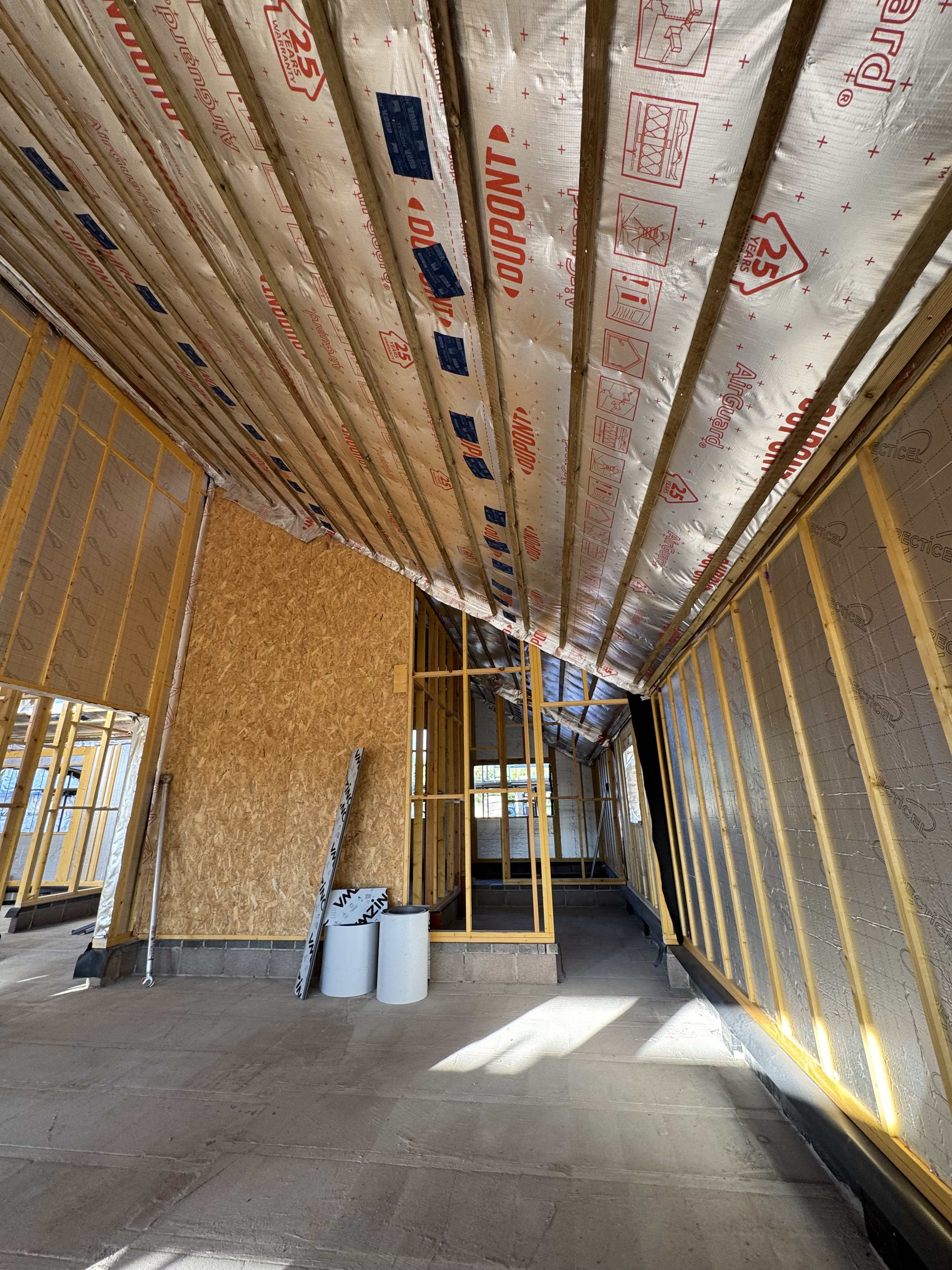

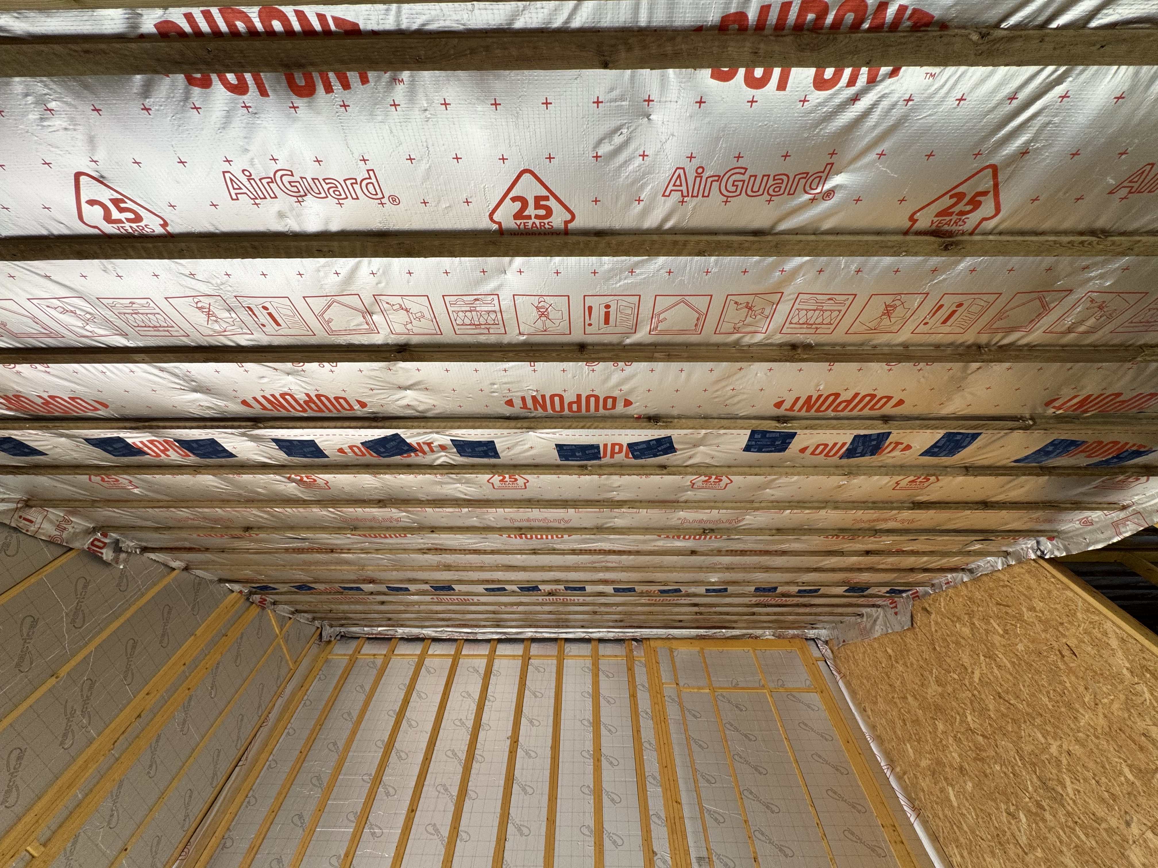

The plan was for the team from SW Insulation to fit the VCL membrane to the vaulted ceilings, cross-batten with 25x50mm in preparation for the cellulose fill, then move on to the wall VCL and the additional 50mm PIR and 38mm service cavity battens on the walls.  As I type that it sounds like rather a lot.  It proved to be too much indeed…
Our lovely vaulted ceilings turned out to be a nightmare to fit membranes to.  Those, plus the ceiling cross-battens (essential to stop the cellulose blowing the membranes off the rafters) took three guys pretty much all week to do. So the walls will have to be tackled when the team return on the 11th August.

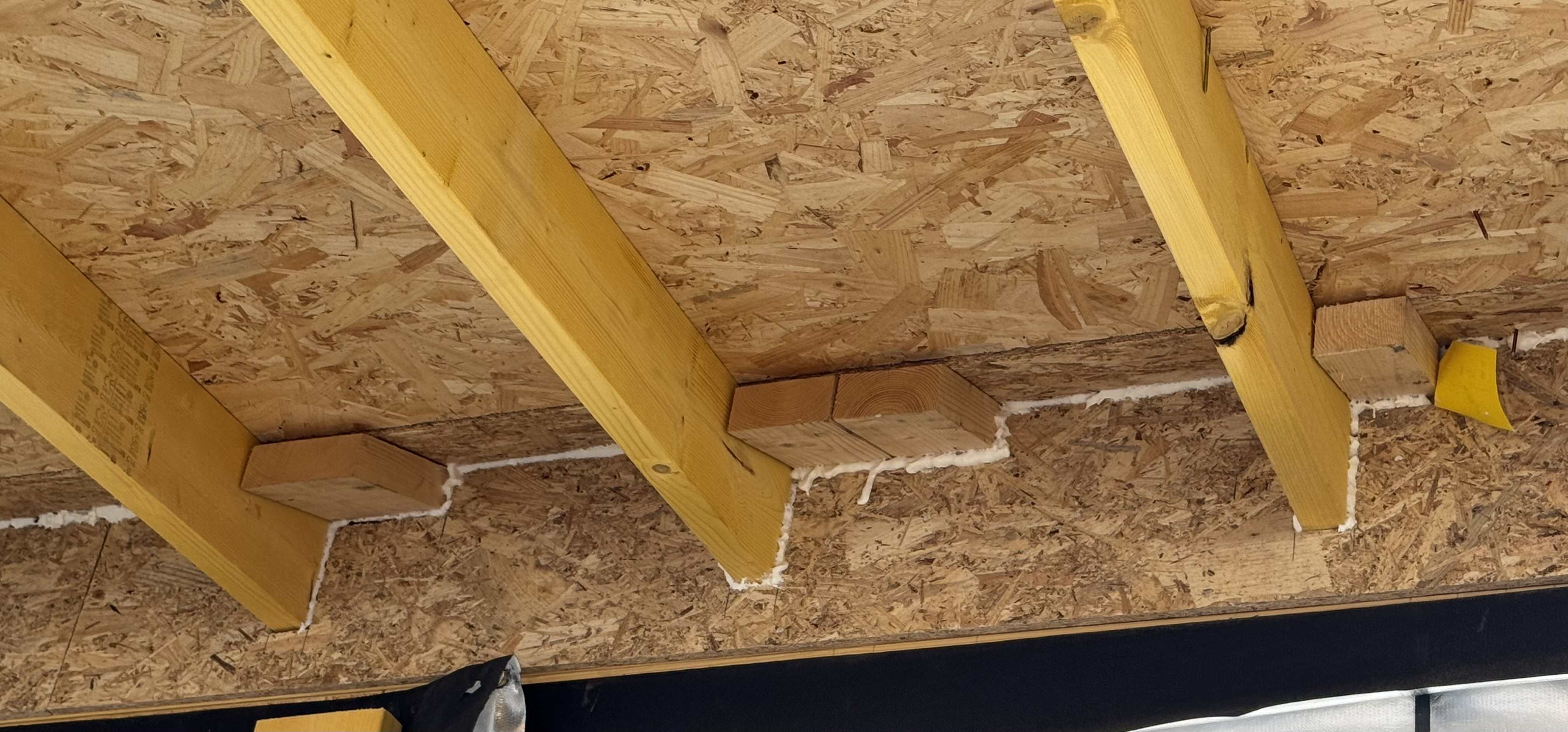

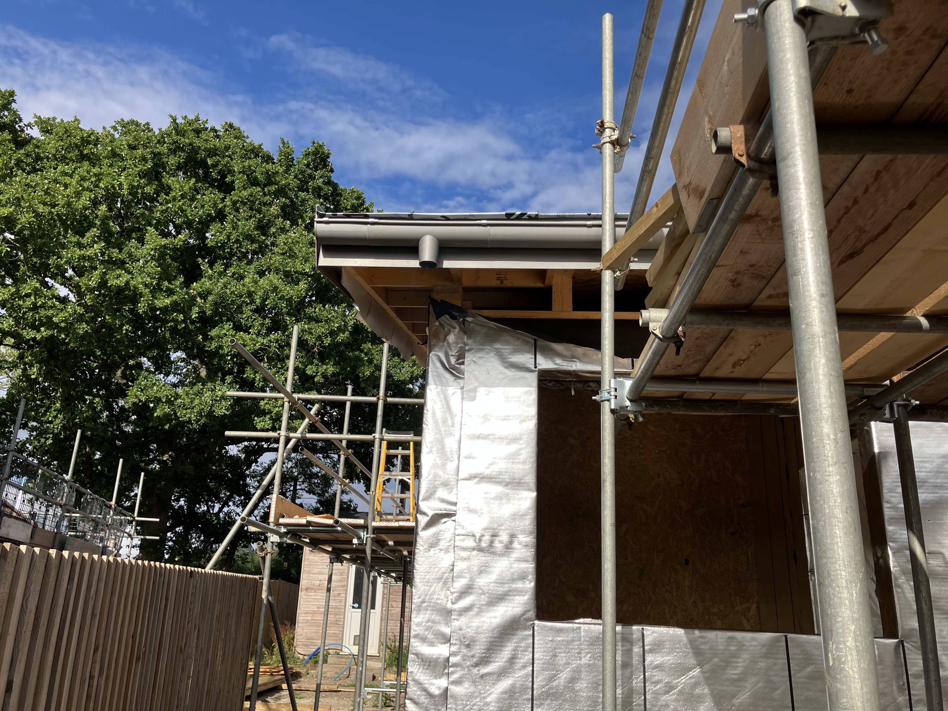

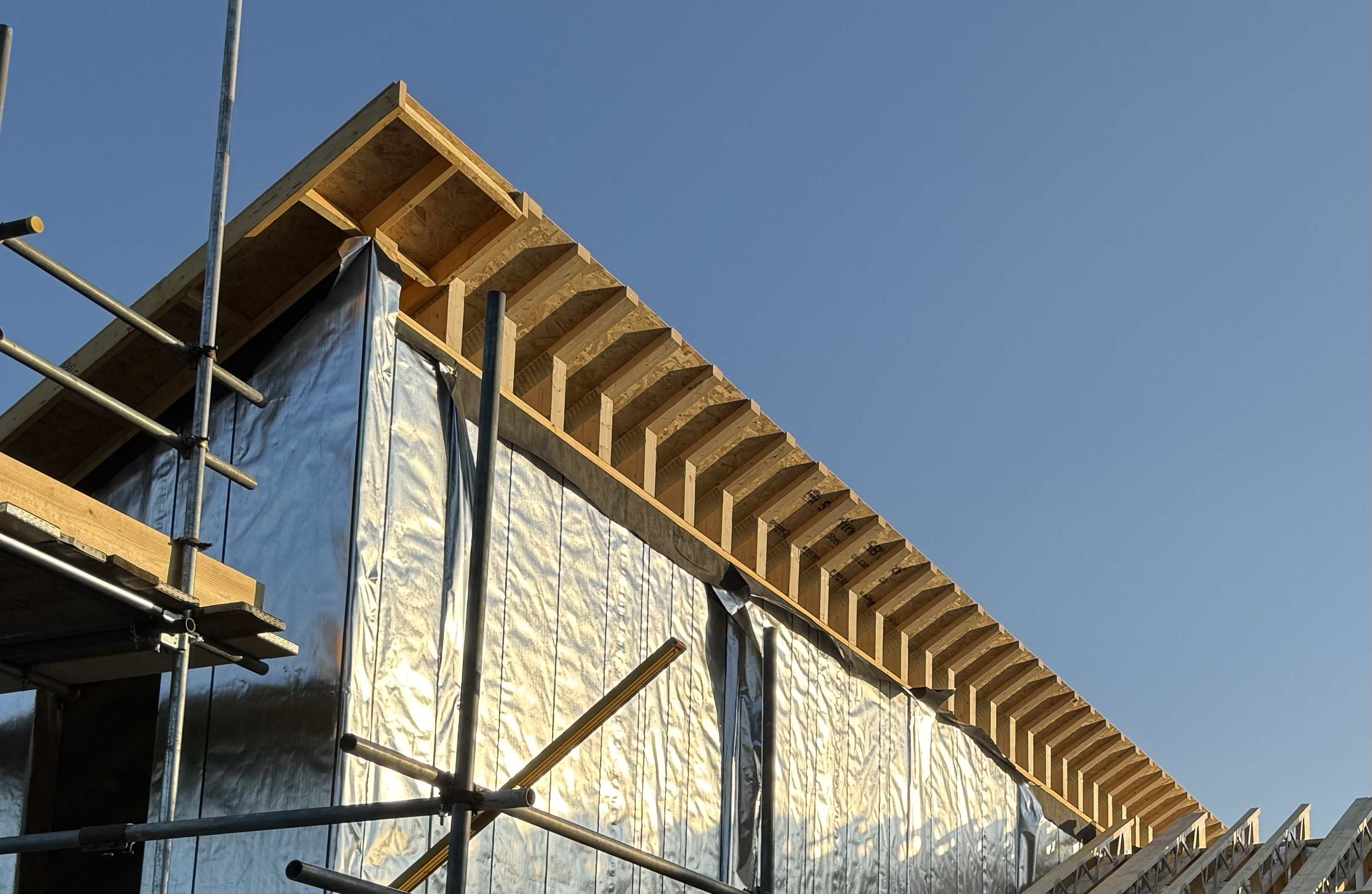

We had no carpenters available Monday to Wednesday but on Thursday and Friday both Alan and Chris were on site.  Chris rushed around closing all the external gaps around the roof edges off with OSB, while Alan worked flat out trying to keep ahead of the zinc roofers (see below).  Closing off the roof edges was essential if we wanted to avoid the cellulose blowing into the rafter space and straight out across the neighbouring countryside.
Before:
After (ok, different section of roof but it all had to be done):

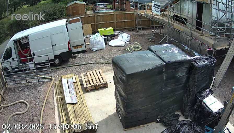

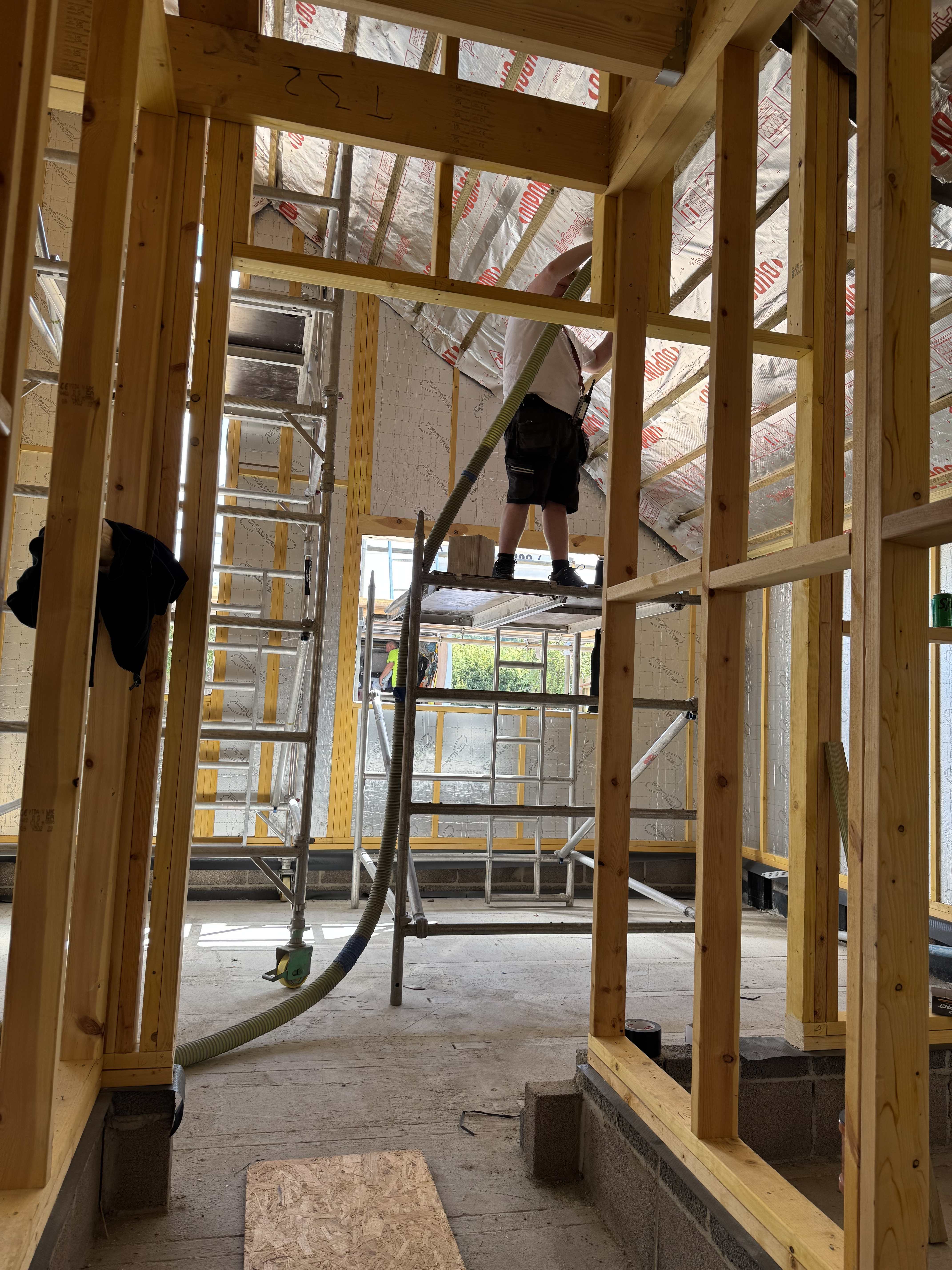

Ray and Devlin from JW Insulating arrived mid-morning on Saturday and worked straight through to 6pm to fill all the rafter spaces.  It wasn’t plain sailing - they were worried the membrane wouldn’t hold.  They had to put a some extra edge battens in to make sure the membrane did not get blown off due to the pressure of the fill and they had a couple of ‘blow-outs’ they had to fix.  Apologies for my terrible photography but here is Devlin blowing the cellulose in to one section:
After filling the first section they checked the density by cutting out a cylinder of the filled cellulose and weighing it.  The core sample came out cleanly without disturbing the surrounding cellulose and after weighing they pushed it back in place and taped it up; it's amazing how the cellulose (which is simply pulped paper, treated to make it fire and mould resistant) seems to bind and 'set' in place once it is blown in.  The test showed we were a tad over target density.  I asked Ray whether that was a problem: “Not for you” was the reply.  I assume they could end up using more cellulose than planned but they were happy to carry on.

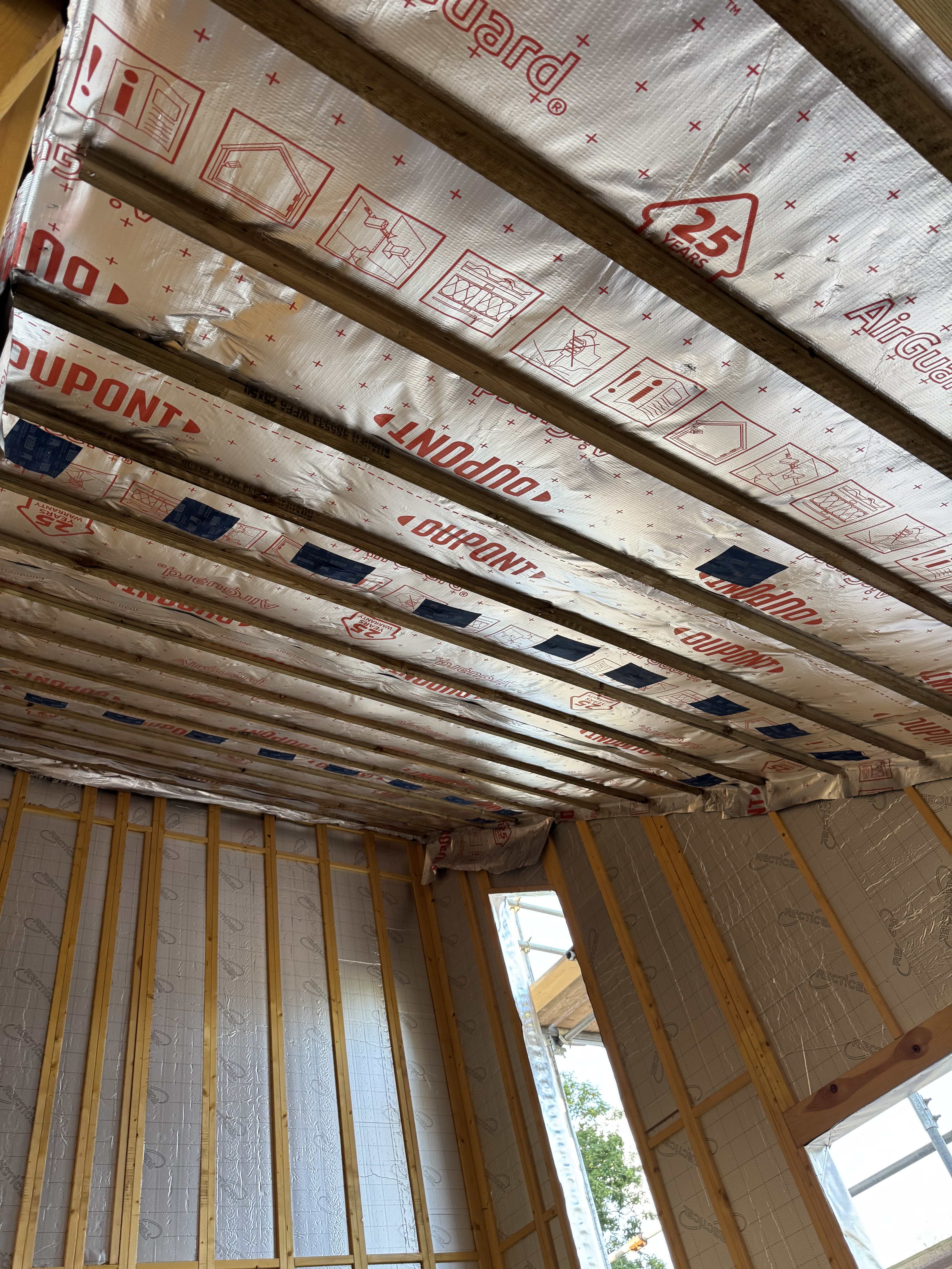

By the end of the day we had a fully-filled roof.  Another milestone achieved!
The photos don’t show it too clearly but the visual effect is as if there’s a vast silver duvet placed over the house.  You can see the patches they used to cover up the entry points for the 'blowing hose'.
We hadn’t realised the cellulose blower was 3-phase and came with its own noisy diesel generator which ran for 9 hours non-stop. Not much fun for our neighbours - we’re hoping they forgive us.  Fortunately it was all done in one day, so peace was restored today (Sunday).

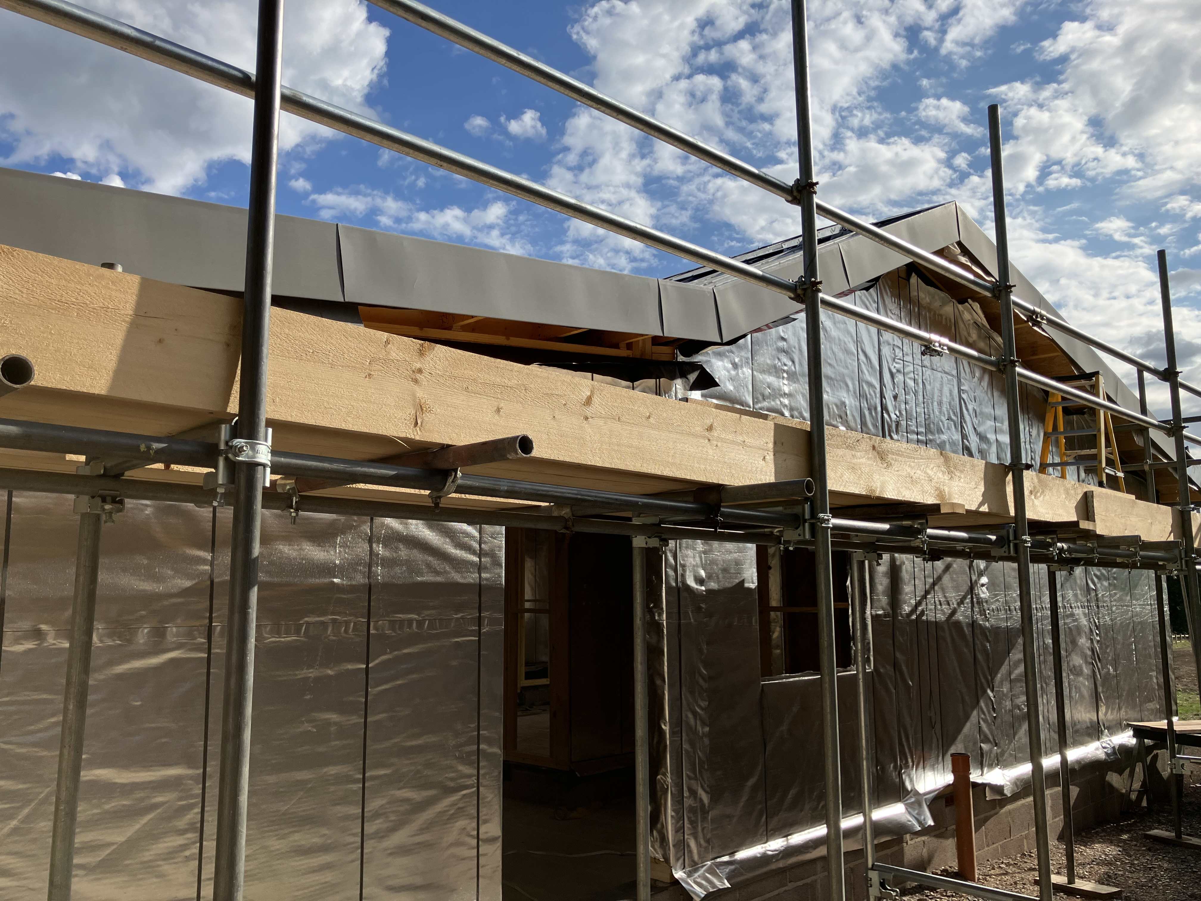

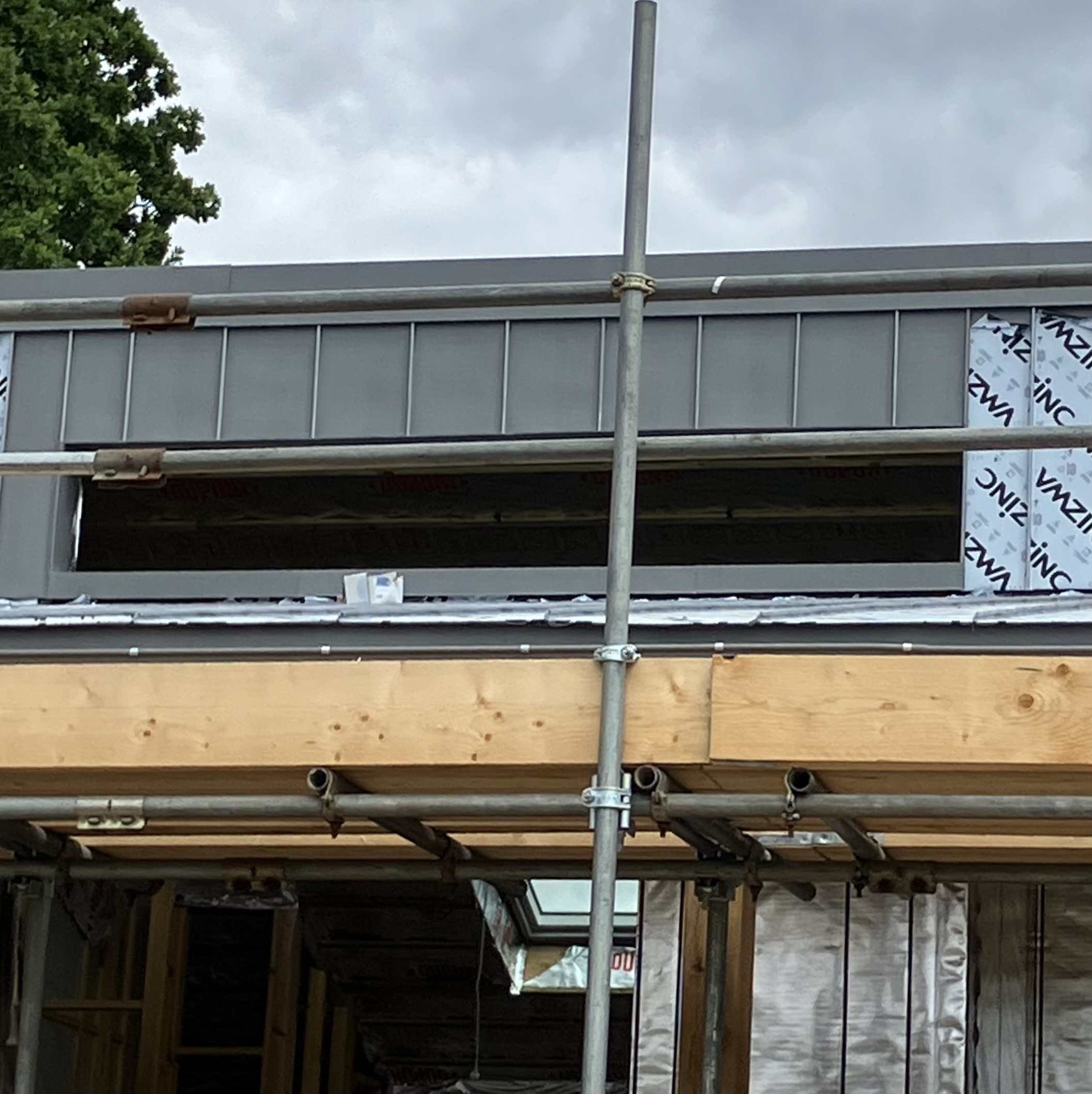

Zinc roof
The zinc roofers, Wessex Metal Roofing were also working through the week, finishing the main roof, fitting the small areas of zinc facade, and various facias, ridges, and gutters trims.   They also kept Alan busy on Thursday and Friday making sure the necessary ply backings were in place to keep ahead of them.
