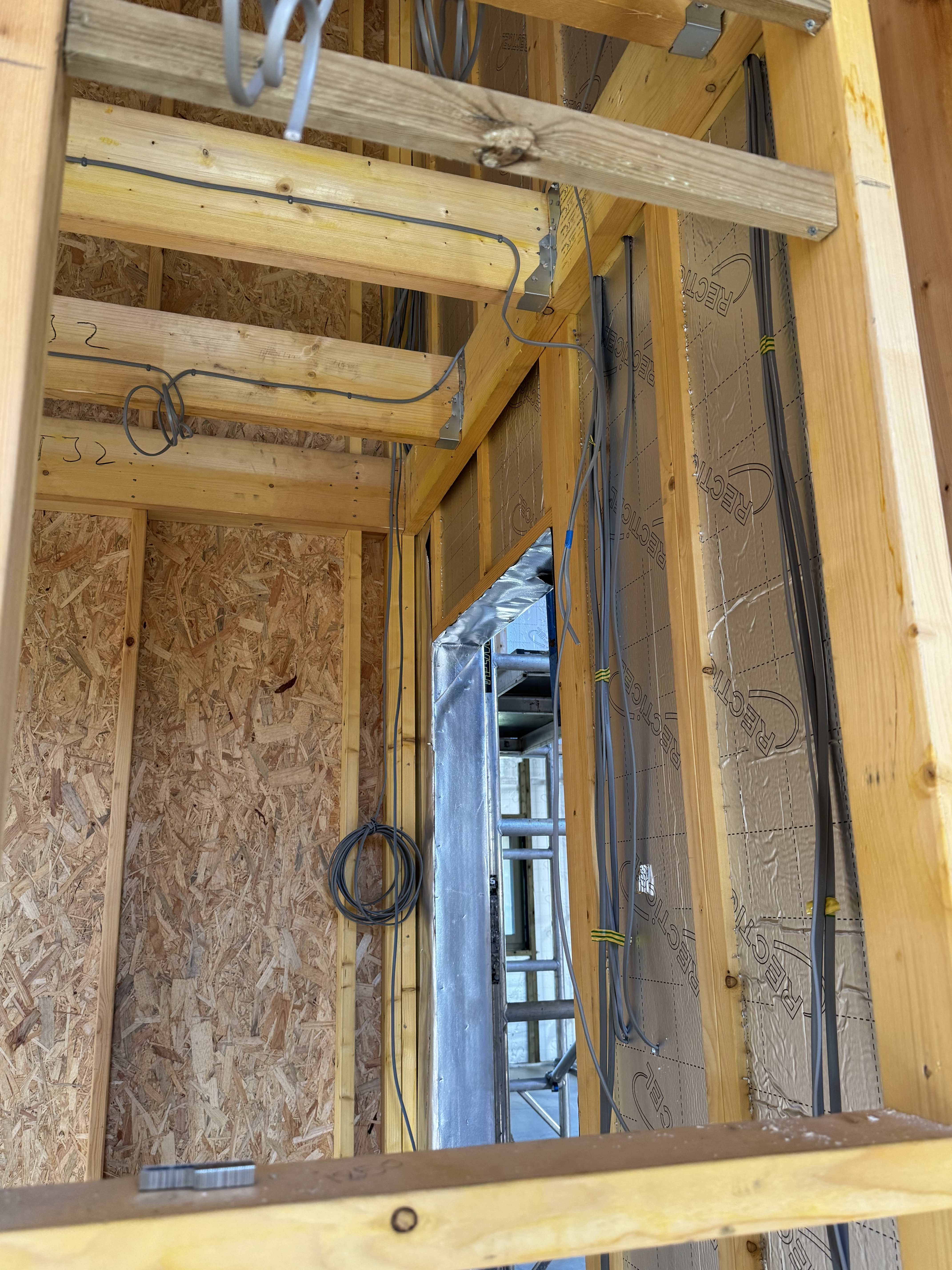

First fix electrics

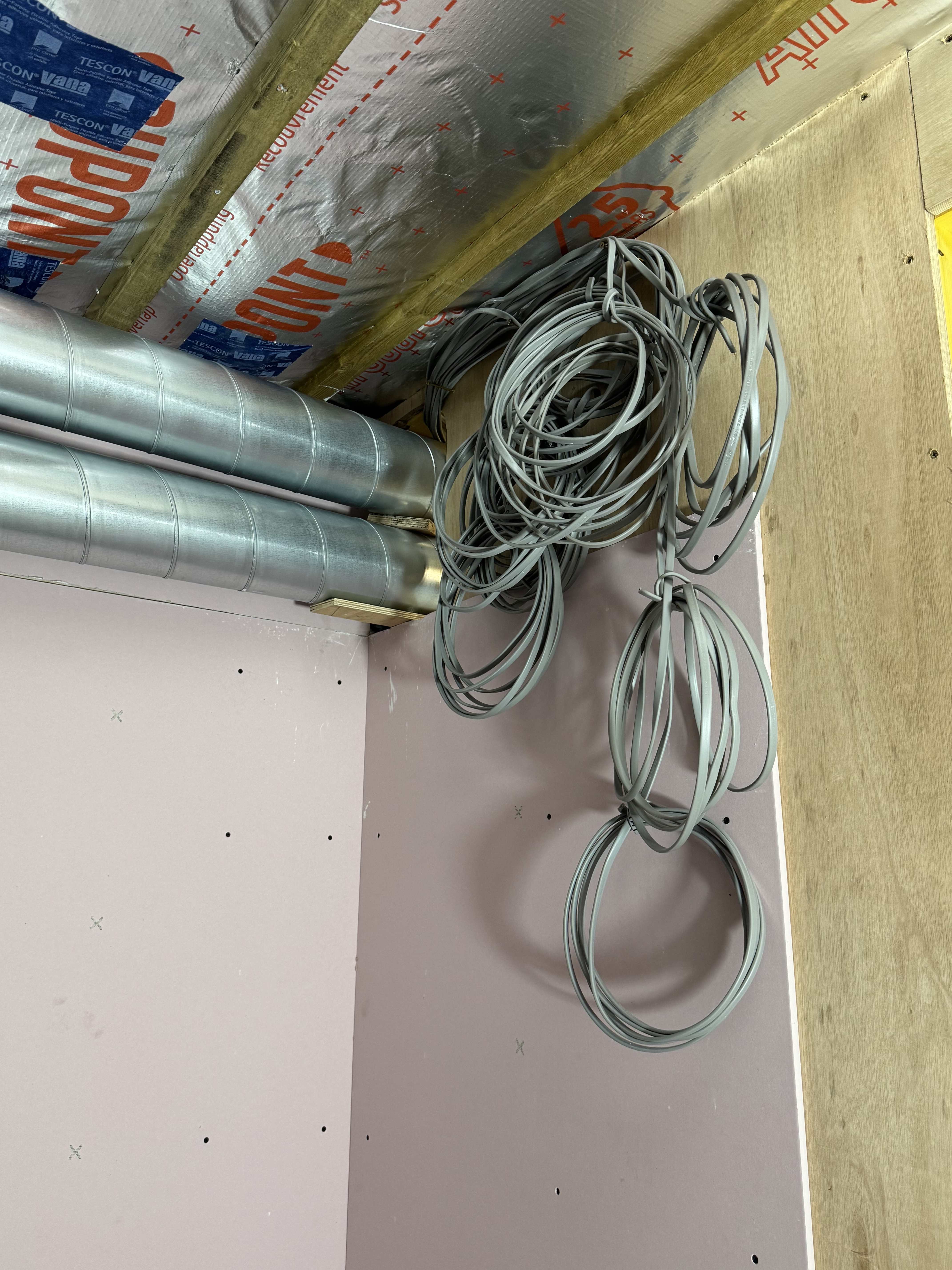

I think we must be closing in on a kilometre of cable now installed: power, lights, room stats, data, PIRs… there seems to be a lot more to do than there used to be when we did our last big project.  Our electrician Darren has been toiling away every day and making good progress - he’s certainly far enough through that for the plasterers to start.  Not very photogenic though, first fix electrics, but here goes anyway:

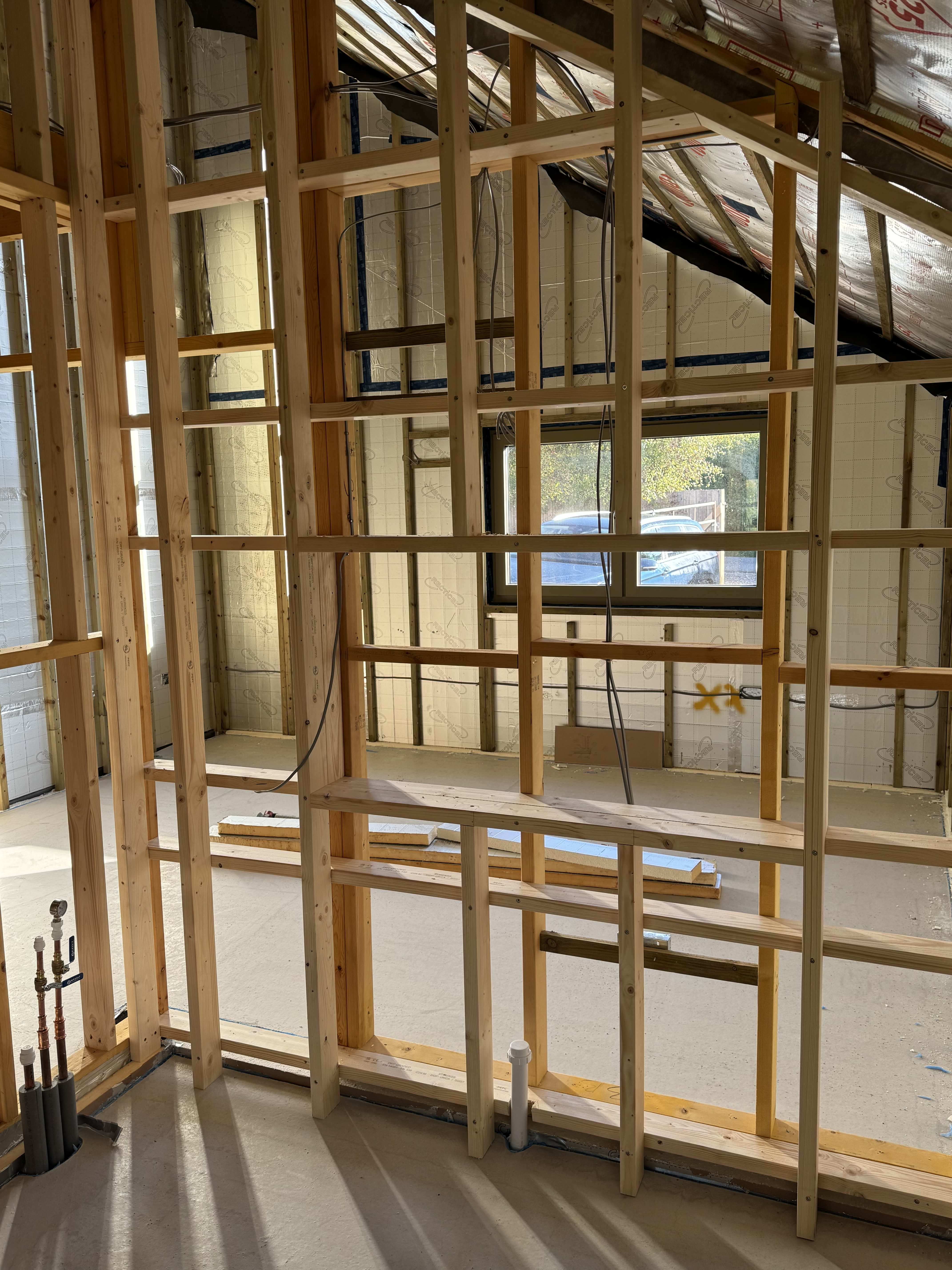

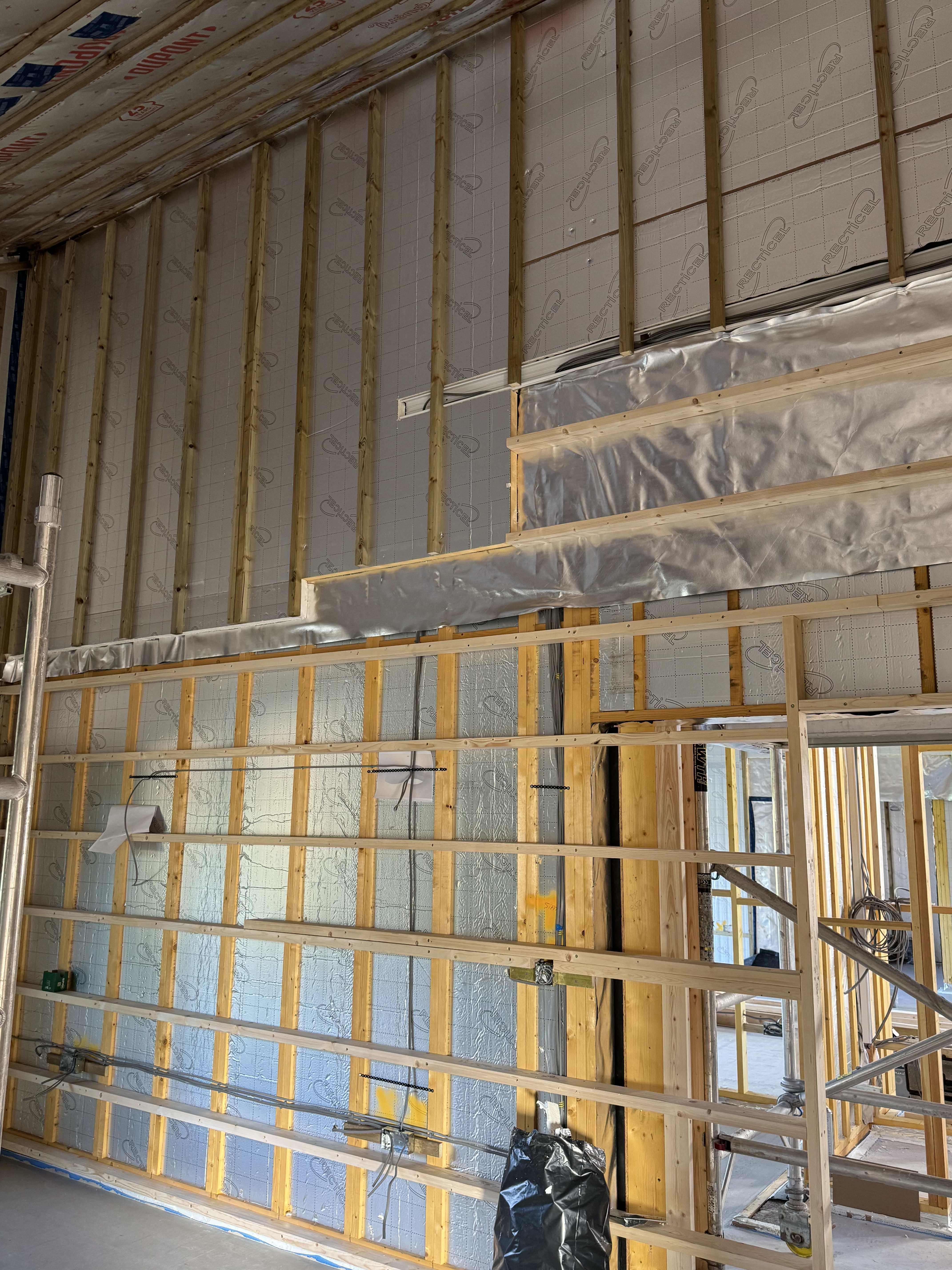

We’ve got a surprisingly long list of jobs that need to be done by Alan and Chris our chippies, including wall and ceiling battening, walls and ceiling studwork to create space for ventilation ducts and plumbing, pocket door frames.  A bout of covid has put them behind schedule but they still seem (reasonably) confident they can be ready for the plasterers.
Double-skinning the wall between the Bed 1 ensuite and Bed 2 - to allow for a bathroom niche and for sound insulation between the rooms:
Top part of wall is external, so has extra insulation; lower part is not (it's a complicated roof!) but has extra studwork to avoid a step in the wall:

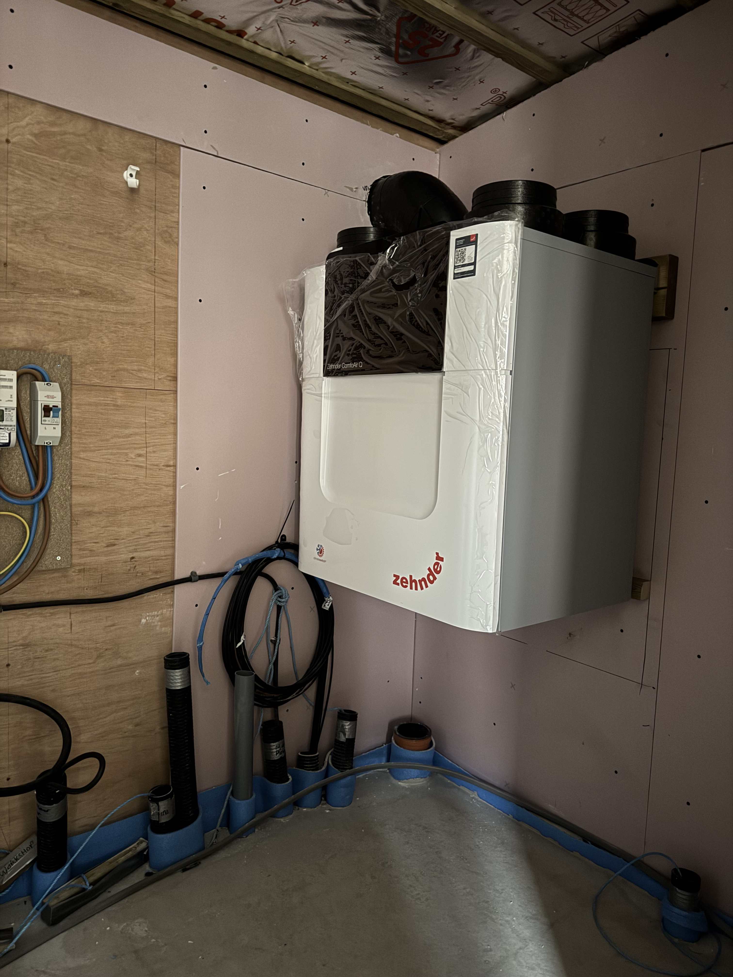

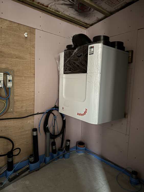

MVHR

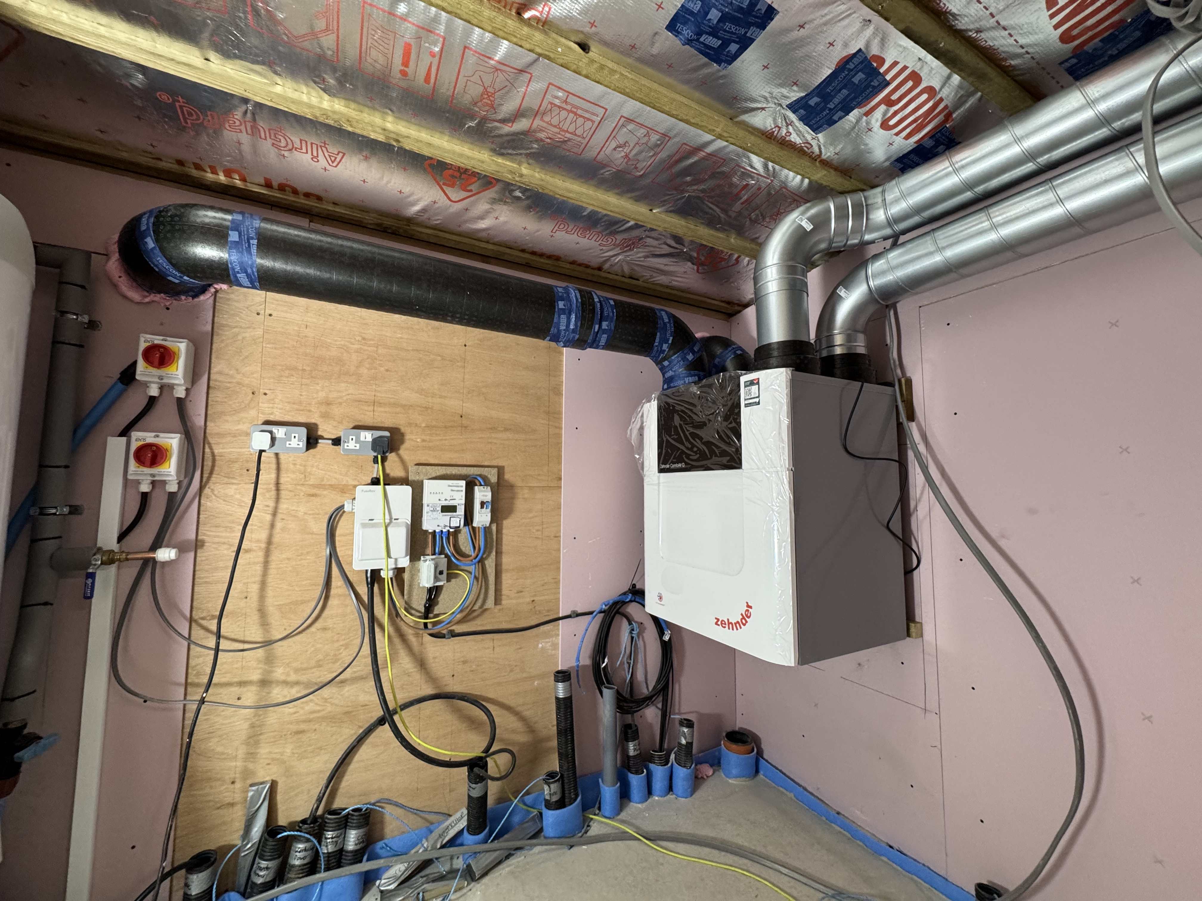

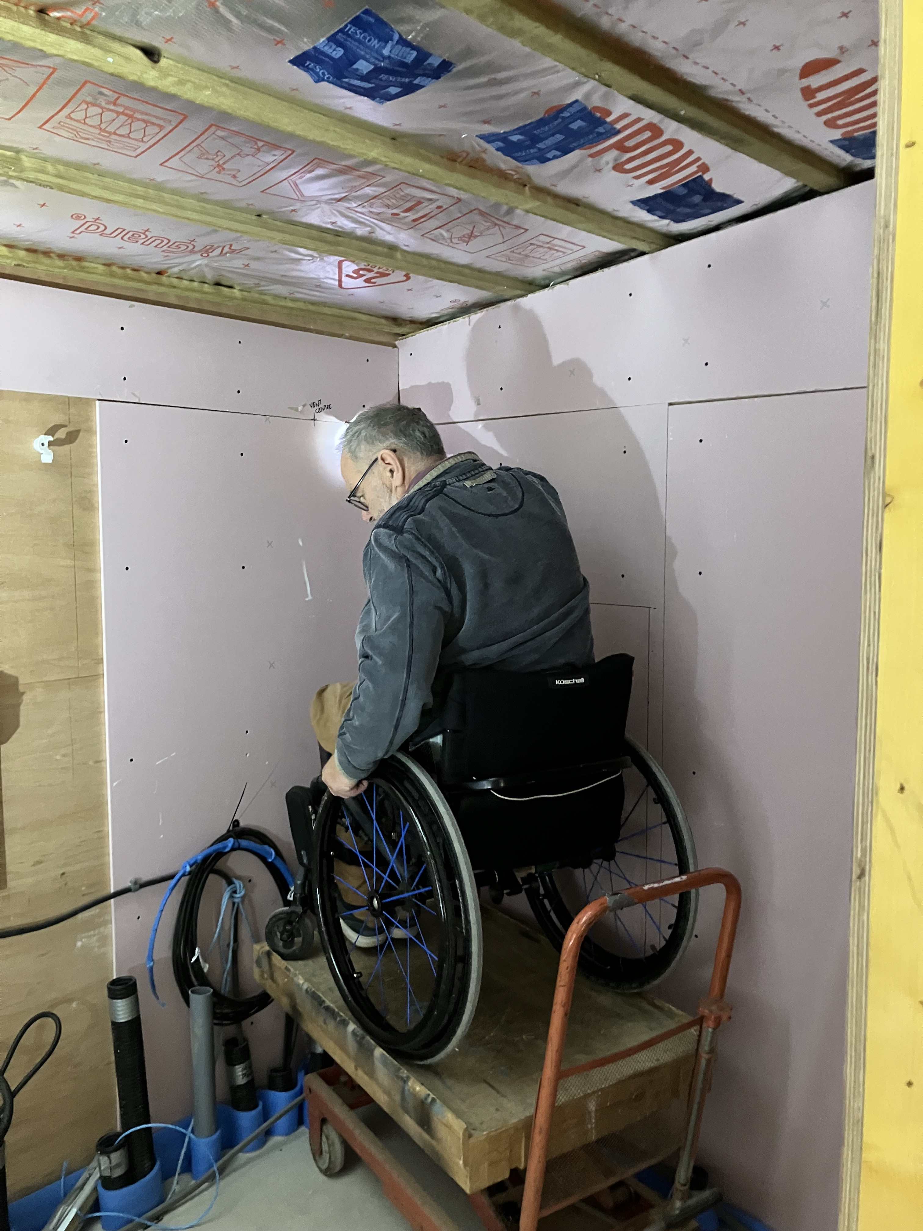

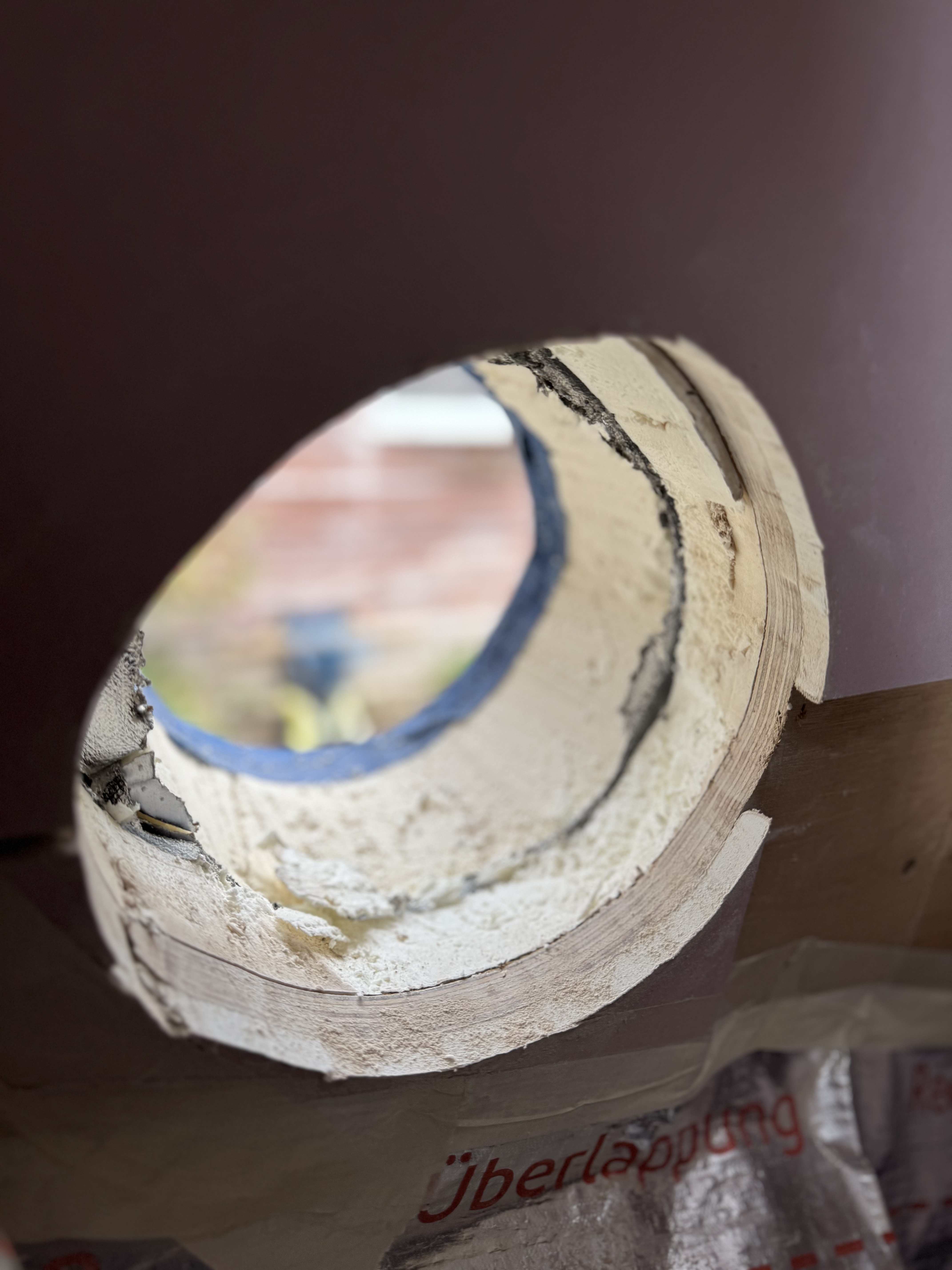

Mrs P. and I decided to have a go at fitting the MVHR unit (ok, I decided, Mrs P. humoured me).

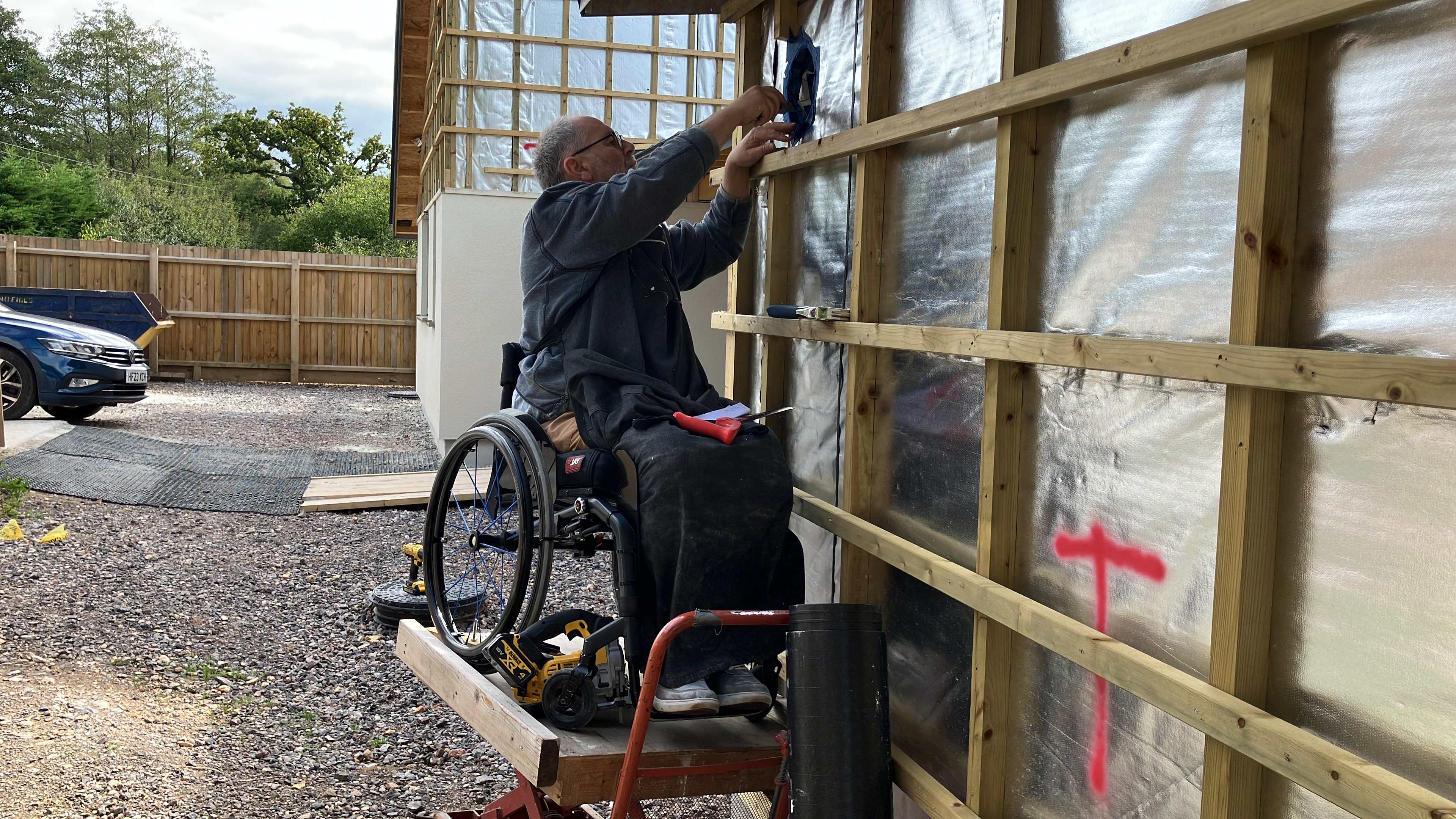

Through the outside wall:

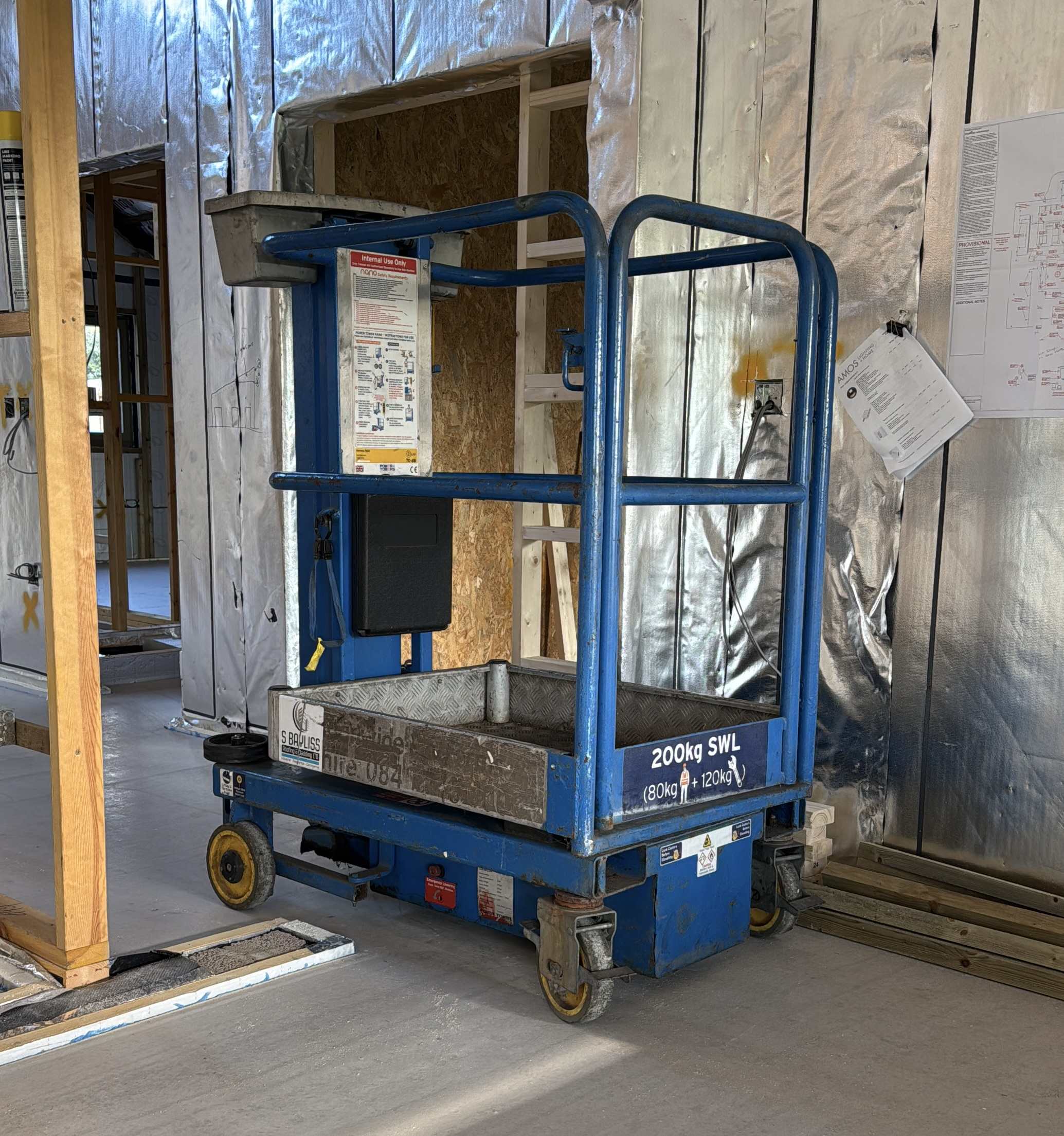

Reaching high enough to cut the holes for external ducts is surely what a scissor lift trolley was really invented for:
The scissor trolley only gets you so high but never fear, I bought a new toy - a bargain Nano Power Tower for £305 off of eBay!
Next project: wheelchair ramp to get onto it.

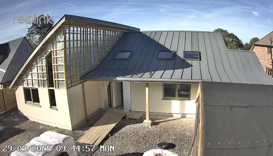

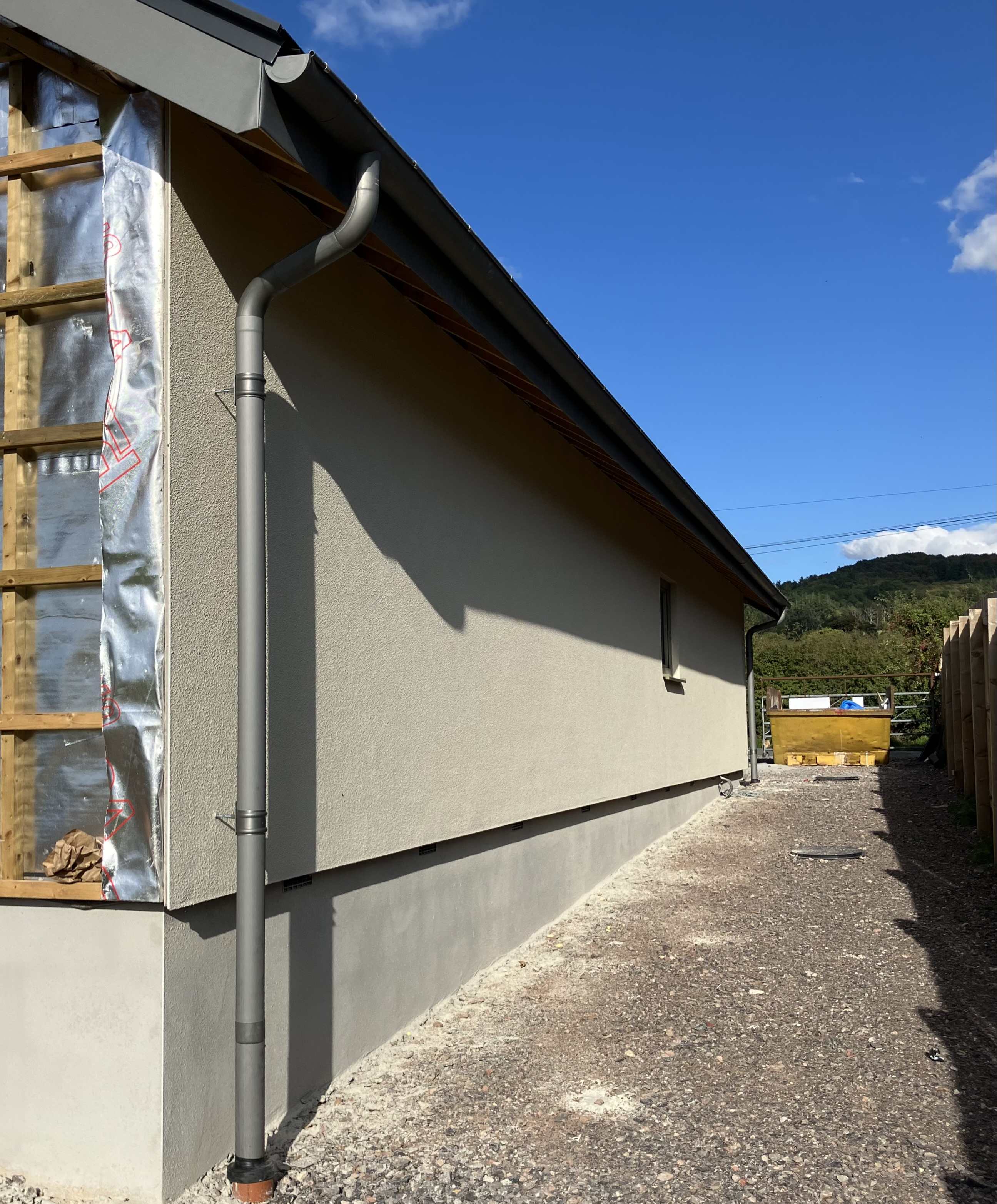

Moving on - remember the zinc roof?

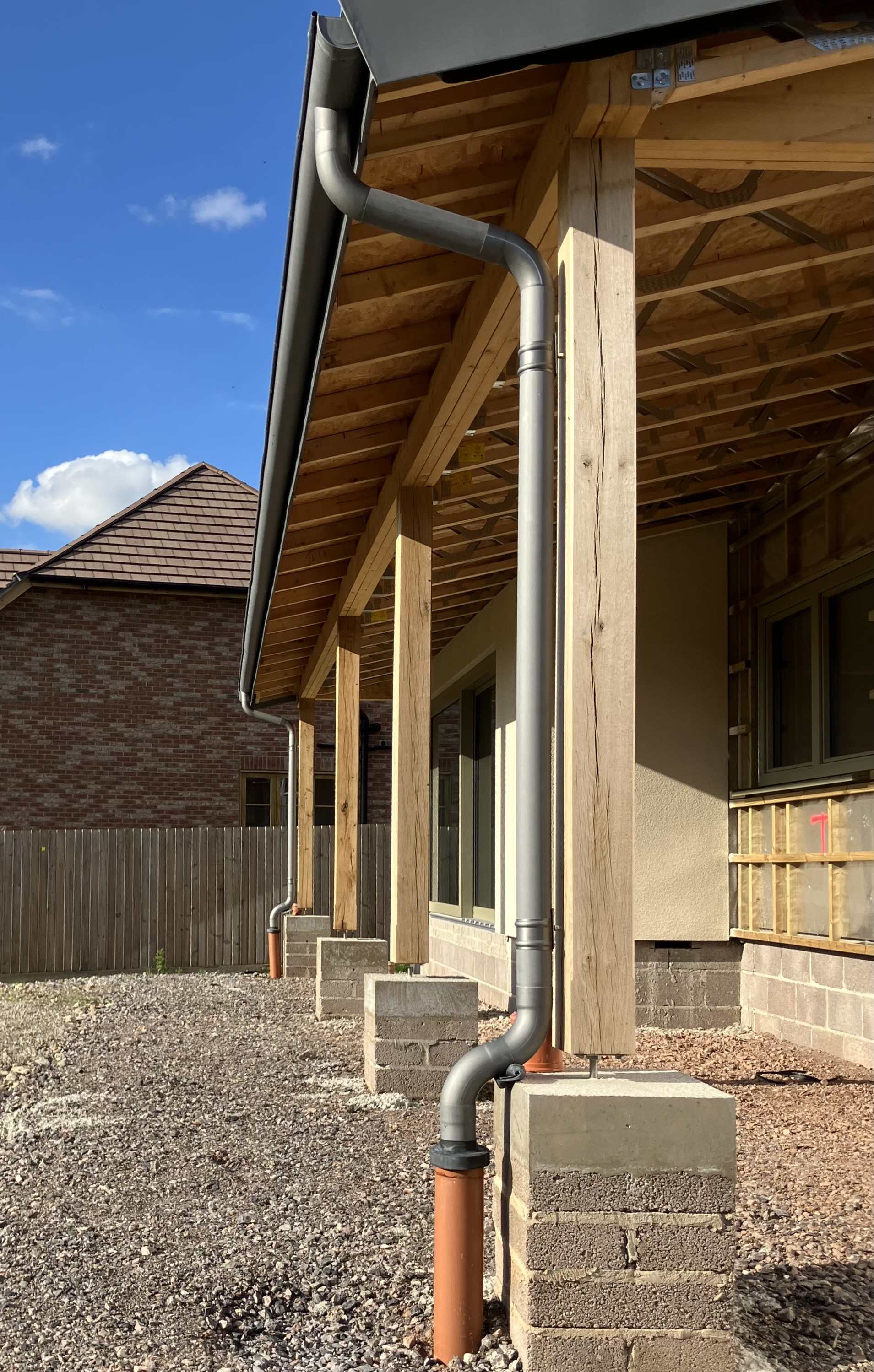

Well, so did we.  And now the render is dry, Tom from Wessex Metal Roofing came back to fit the down pies and remove the remaining plastic protection.  We really like the roof.
And the drainpipes:

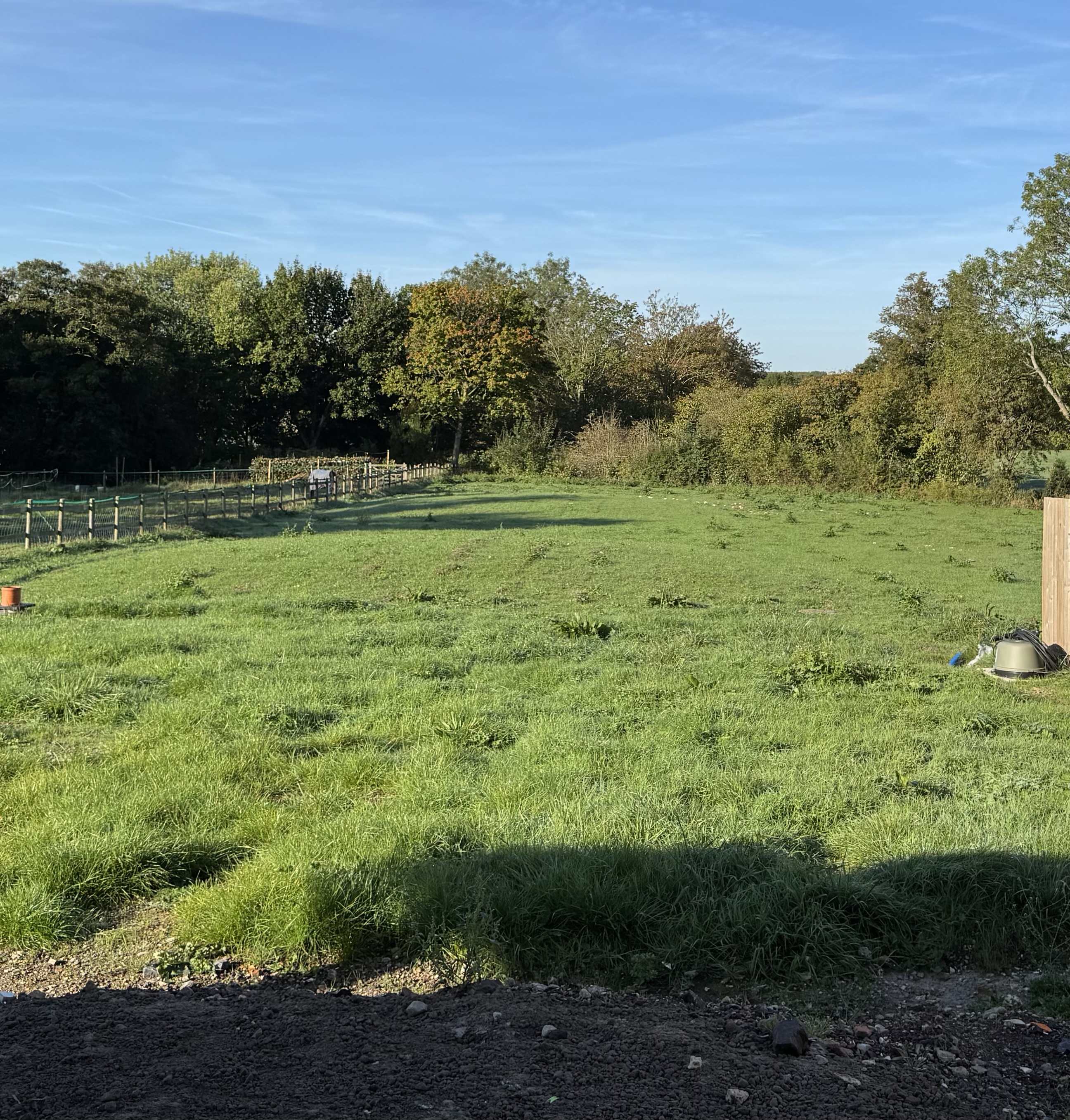

Garden started!

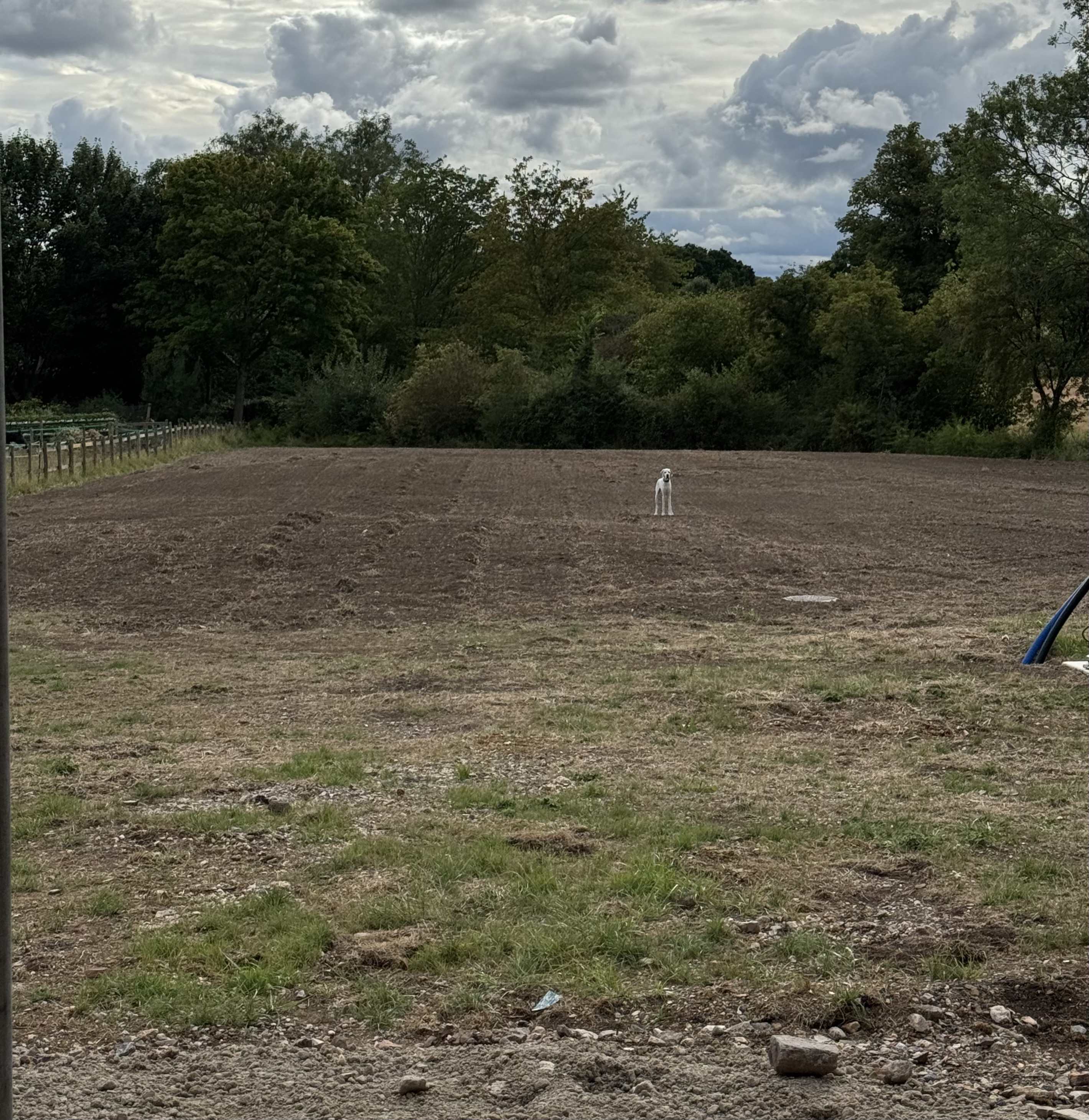

Well sort of… the paddock area has been seeded.
Before:
After:
Watching grass grow - far more interesting than watching paint dry.
