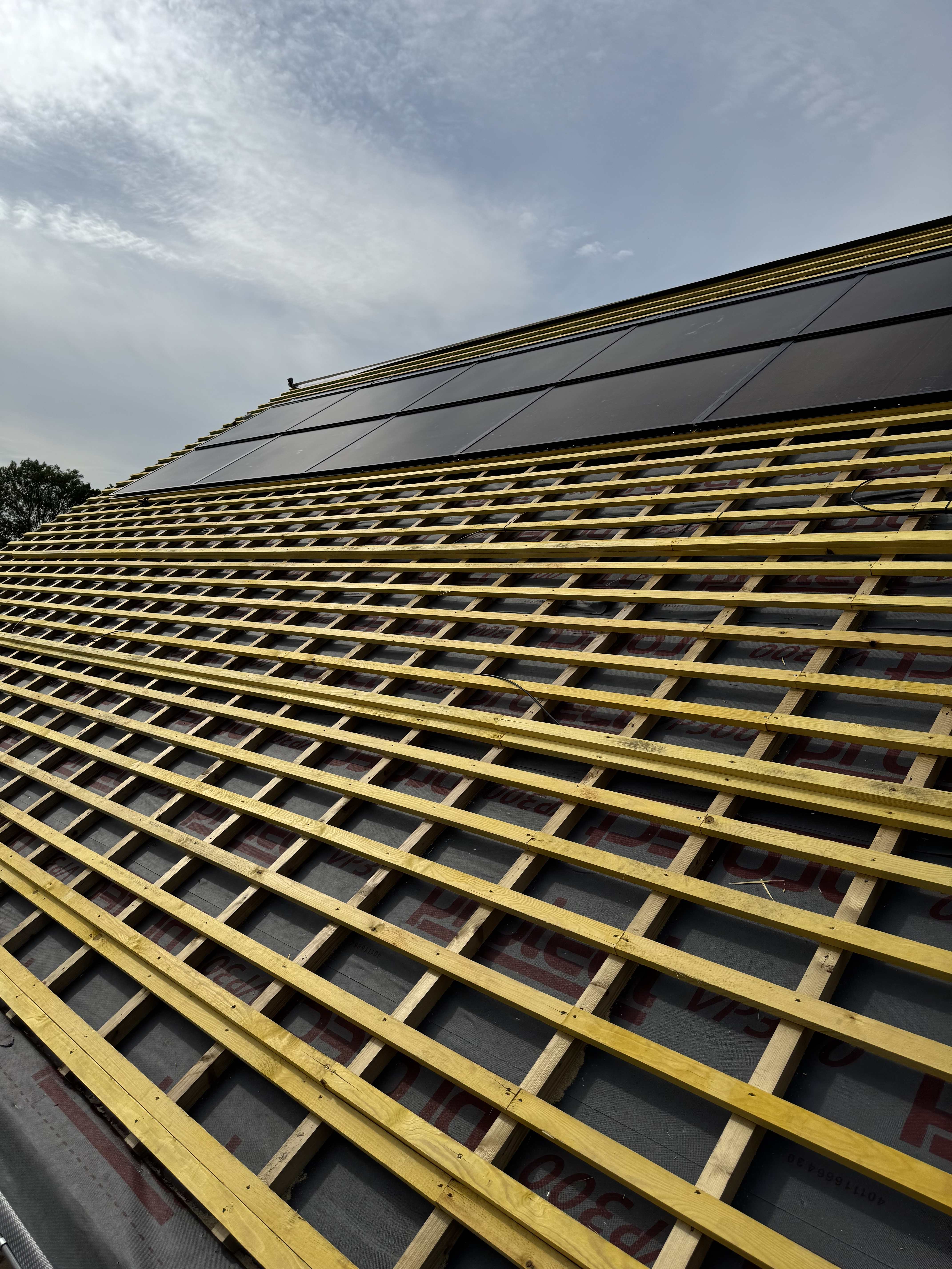

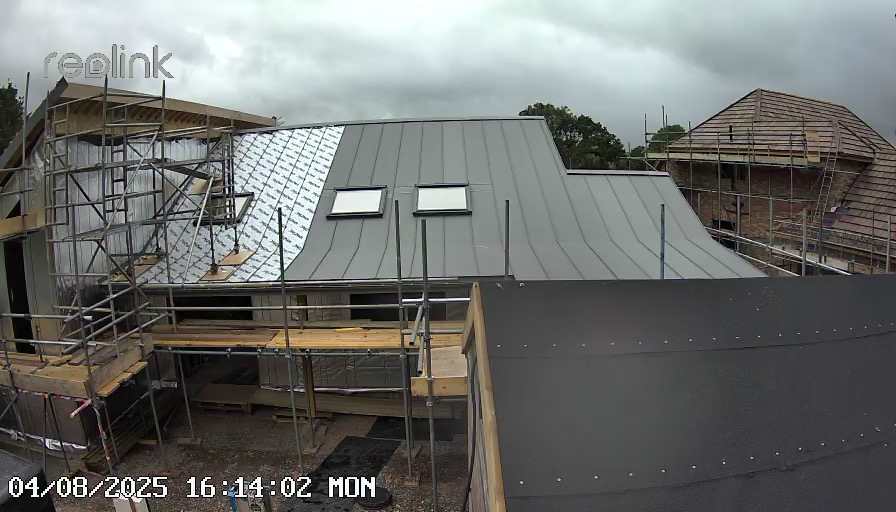

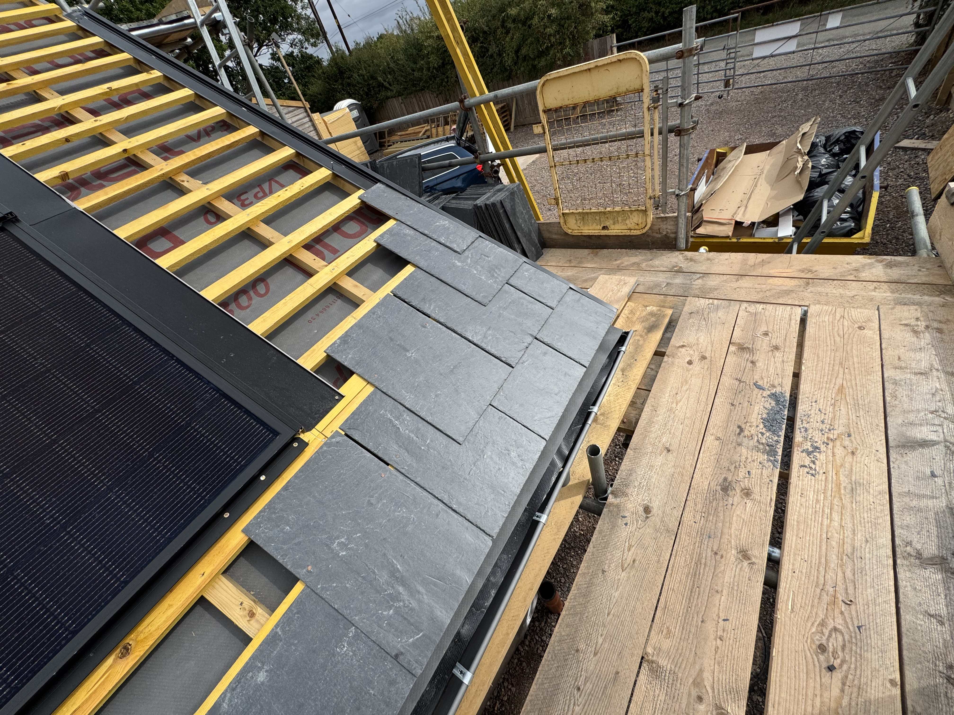

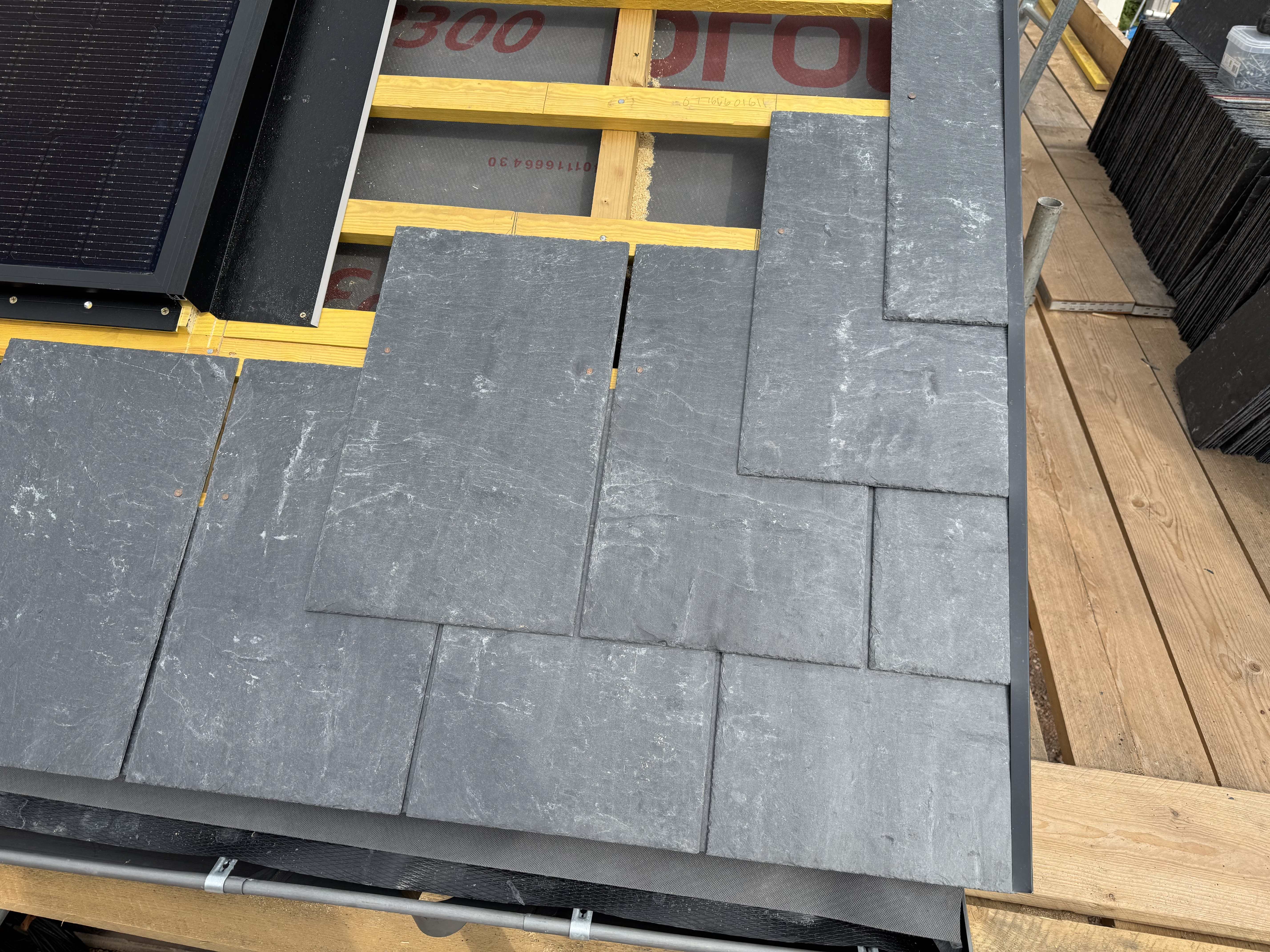

The main build focus this week has been on the south-facing single pitch roof which is to be covered using in-roof solar panels with slates around the boundary, then zinc facias to match the rest of the roof.
It seems the zinc roof guys don’t do slate roofs and the slate roofers don’t do zinc, so two roofing teams required.  Fortunately, both teams have been excellent: professional, tidy, friendly and turning up when they say they will.  All you could ask for really.  Also fortunately, the slate roofers (Pete and Dave from G M Spicers) will fit the solar PV panels under the guidance of our electrician Nick.

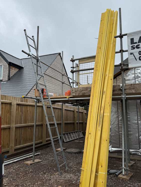

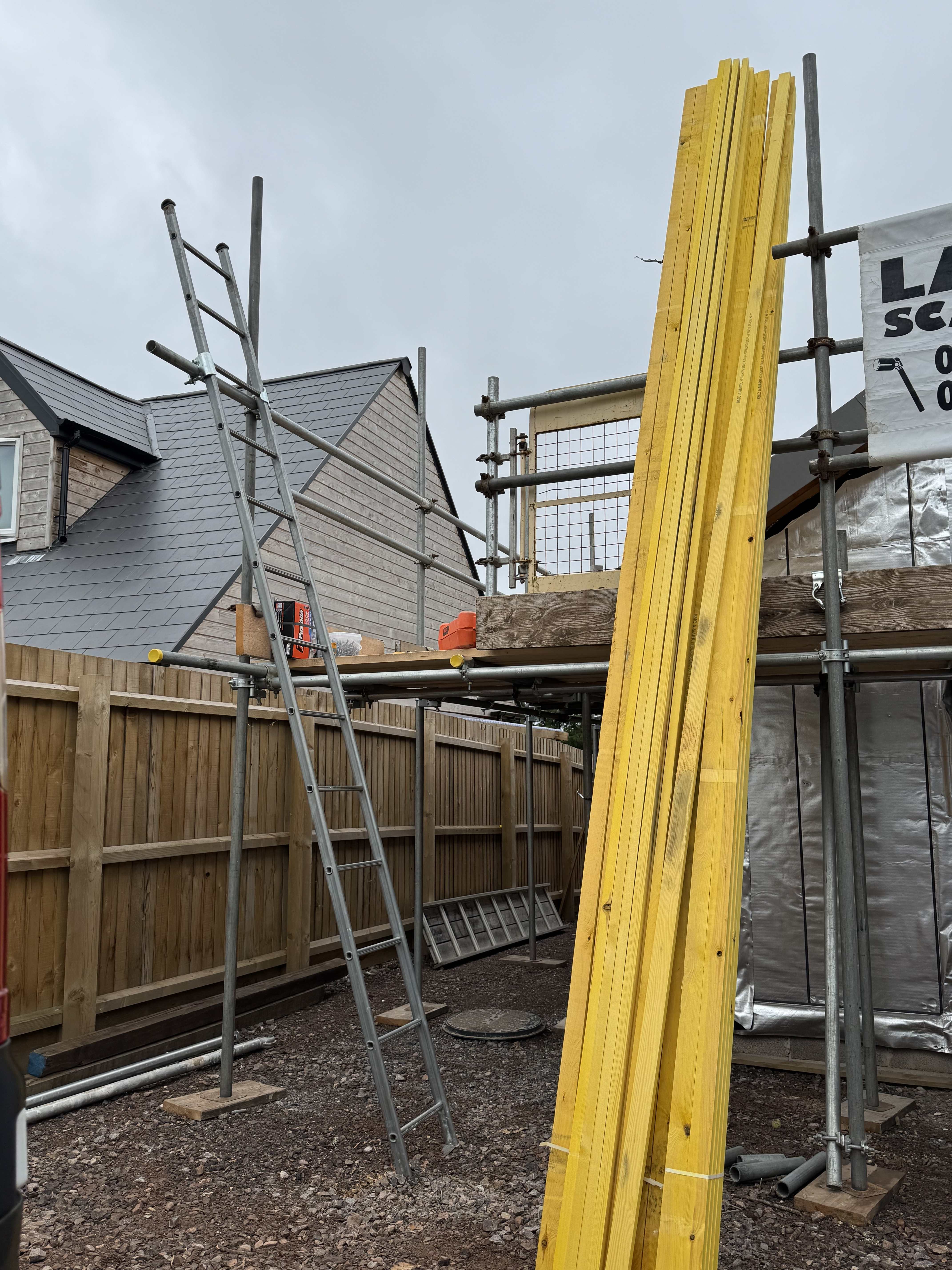

And that has been the main activity this week - roofing battens and then the solar PV panels.  (I should just give a mention to Travis Perkins who supplied the cleanest, straightest 2 x 1 battens I have ever seen, barely a knot anywhere.  It’s a shame they’re florescent yellow - I wouldn’t be surprised if they glow in the dark.)

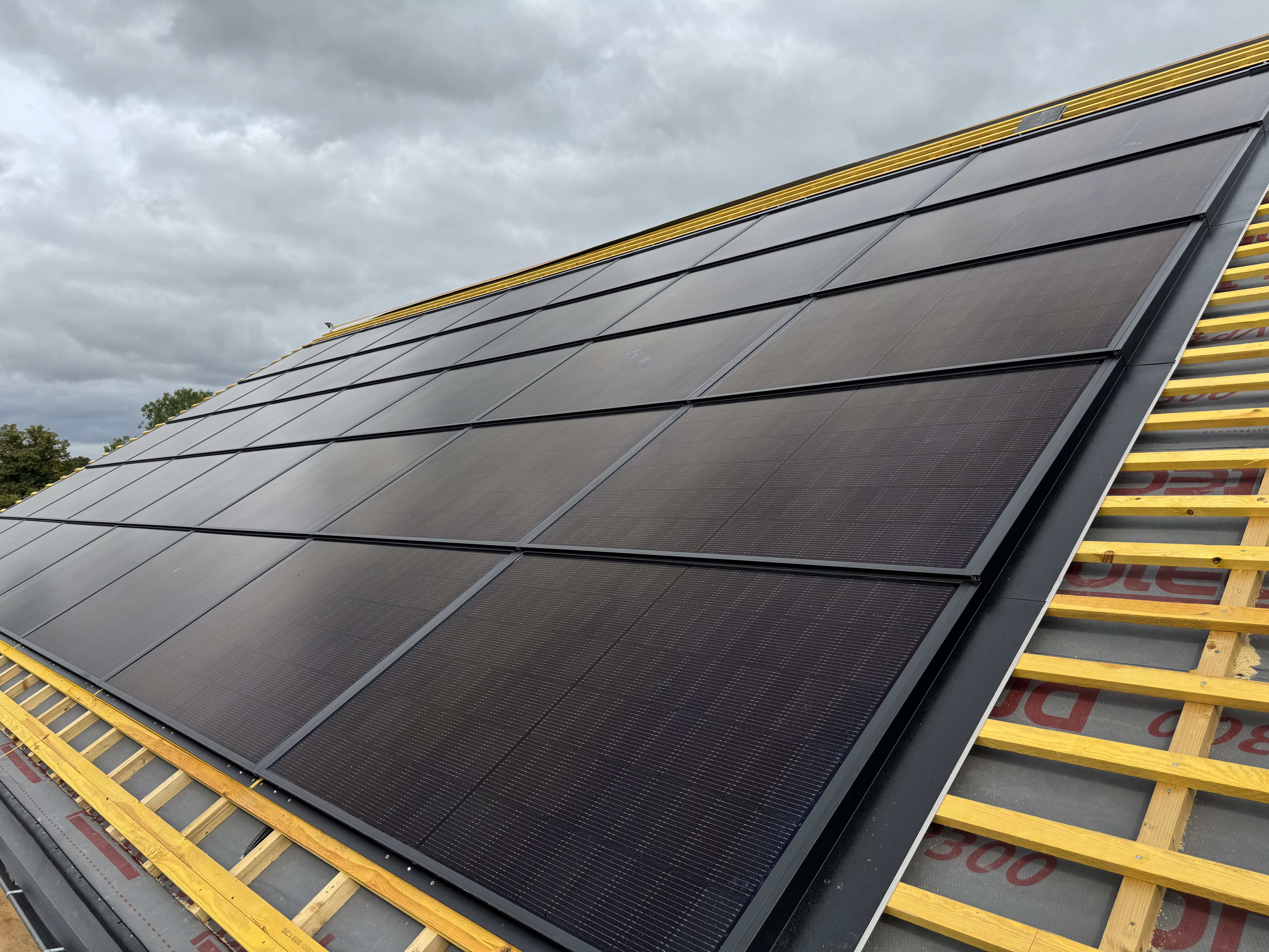

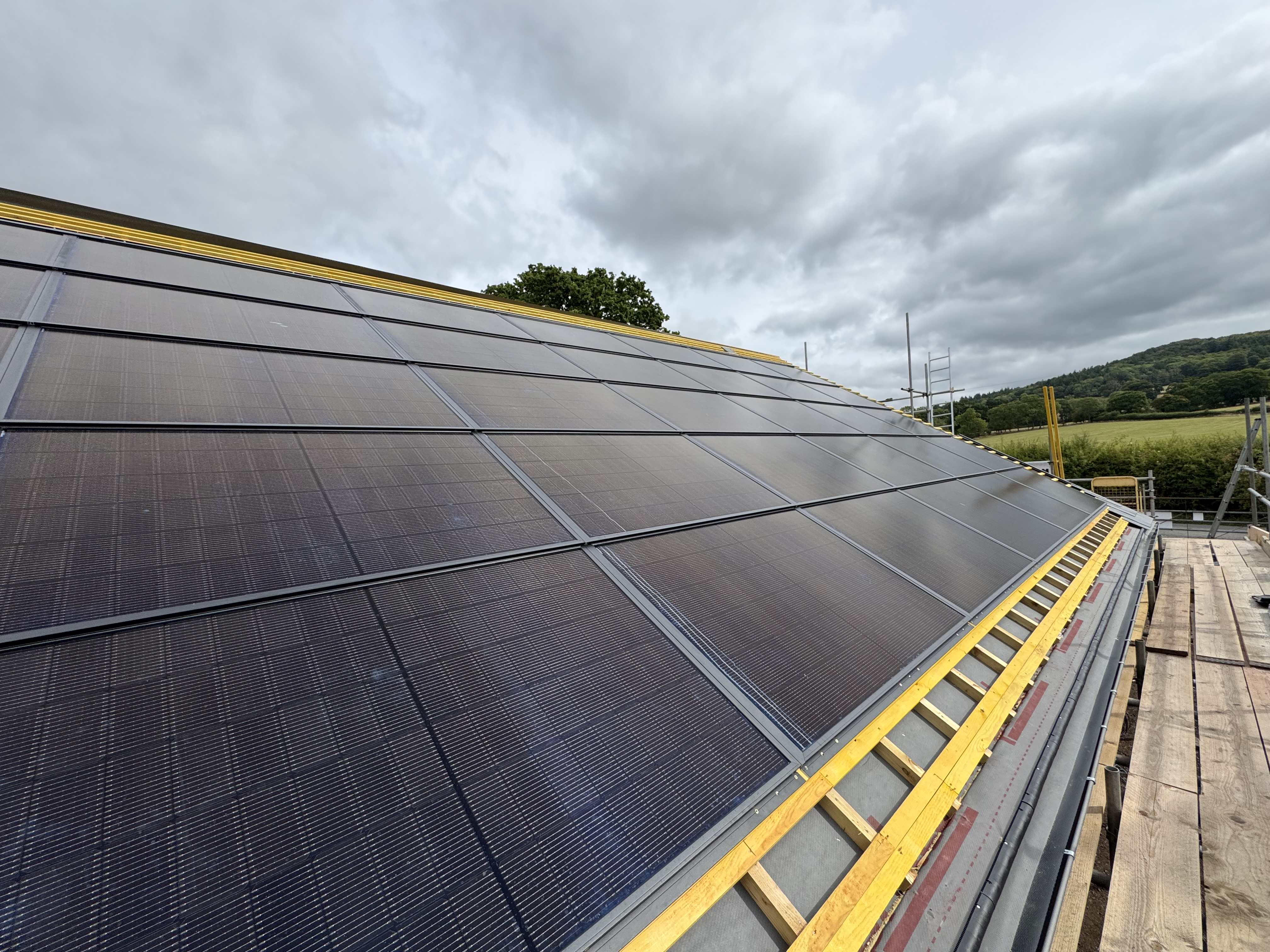

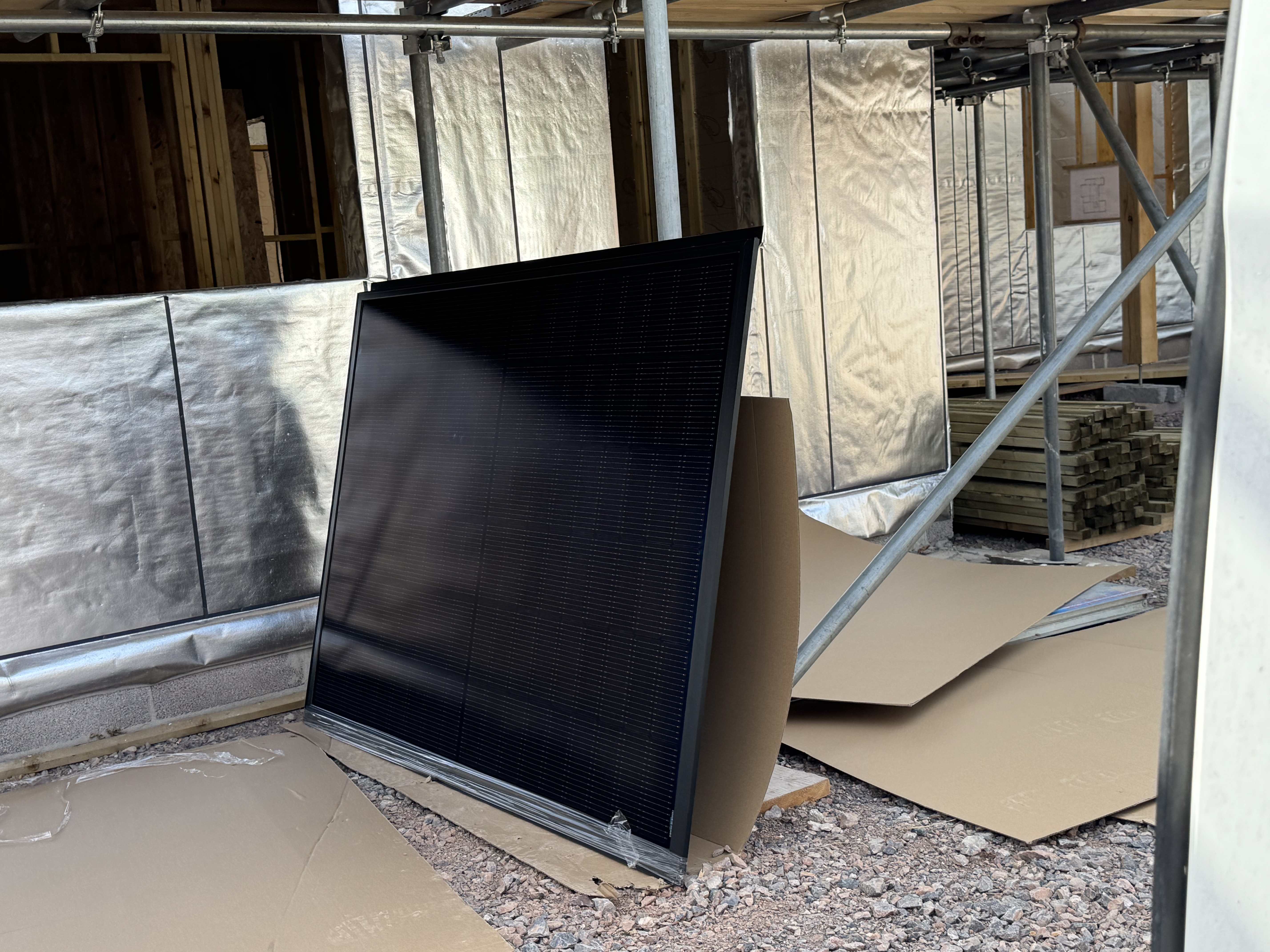

The solar panels are by Solfit and clip together to form a watertight roofing surface - no trays, they just fit straight on the roofing battens.  They’re about 1790 x 1220mm and weigh 26kg each, so getting them on roof is no easy matter but the Pete and Dave seemed to manage ok.  We have 35 landscape format panels (5 rows of 7) at 425w each giving 14.8kW total generating capacity.   There are no doubt cheaper panels available but we have saved 77m2 of slate or zinc roofing, so that helps the economic case.

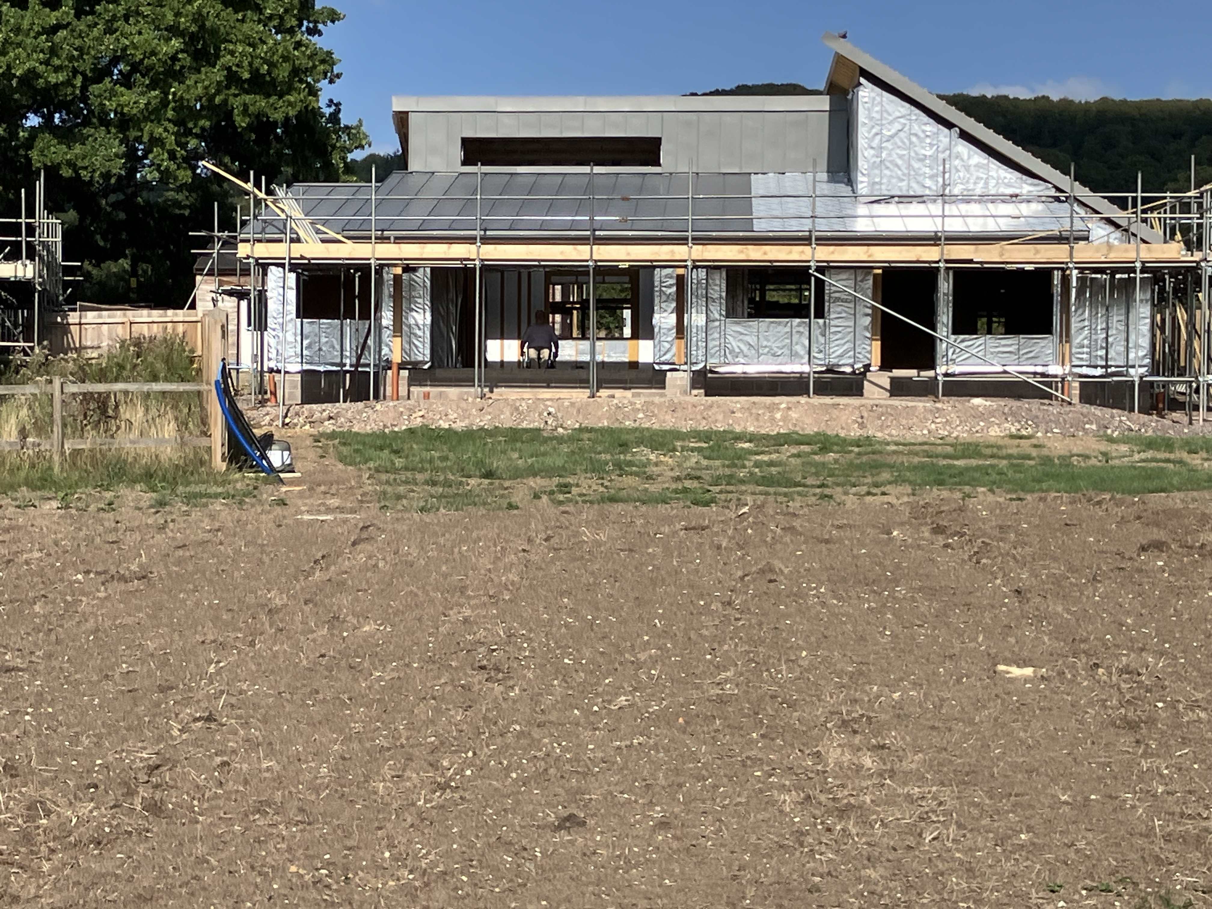

By the end of the week, all the panels were on and the team had started to fix the slates around the edge so we can see how that will look.
Also this week the zinc roofers stripped off the protective film from most of the roof so we can see that now and I have to say it looks really smart.
