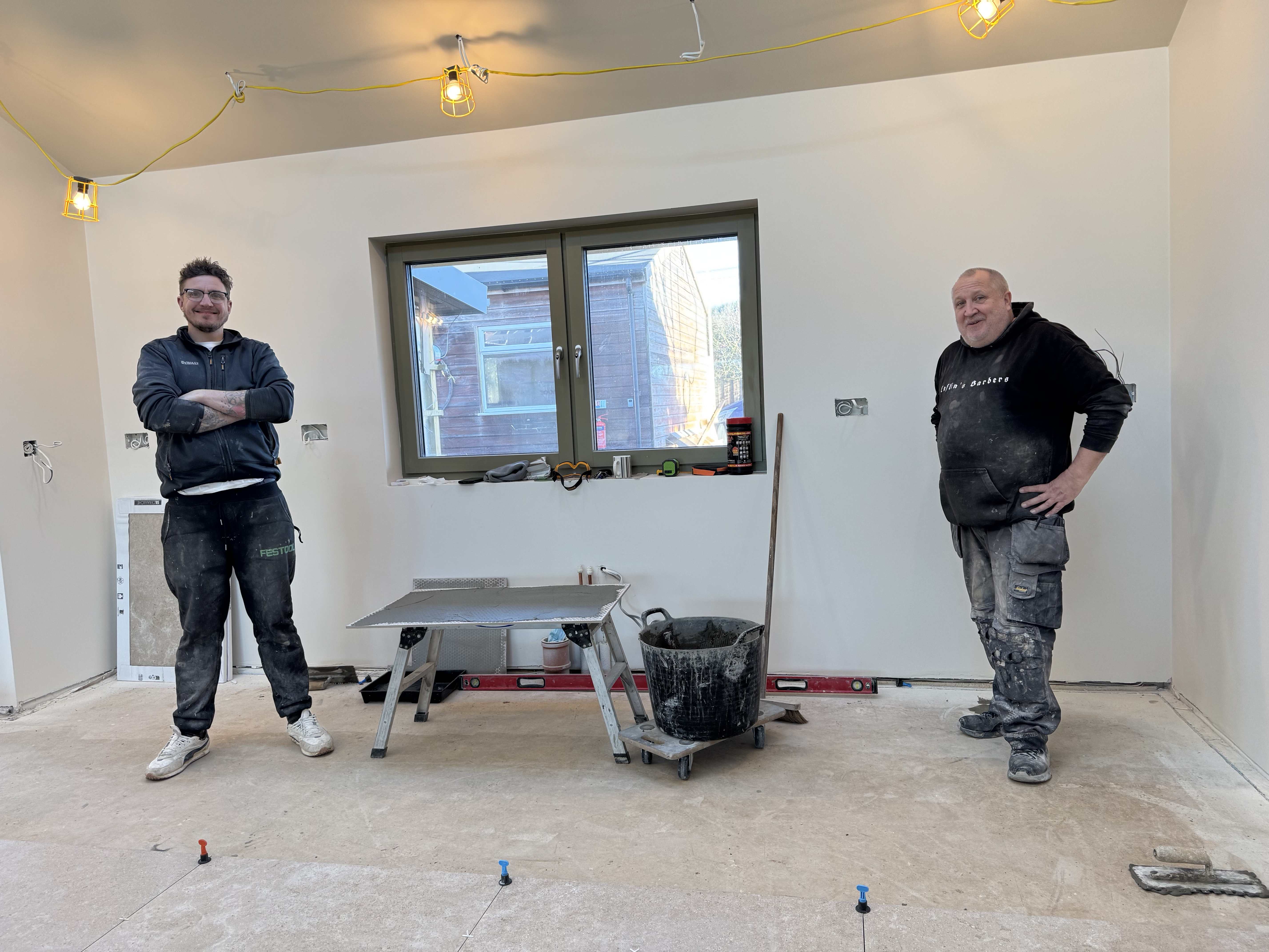

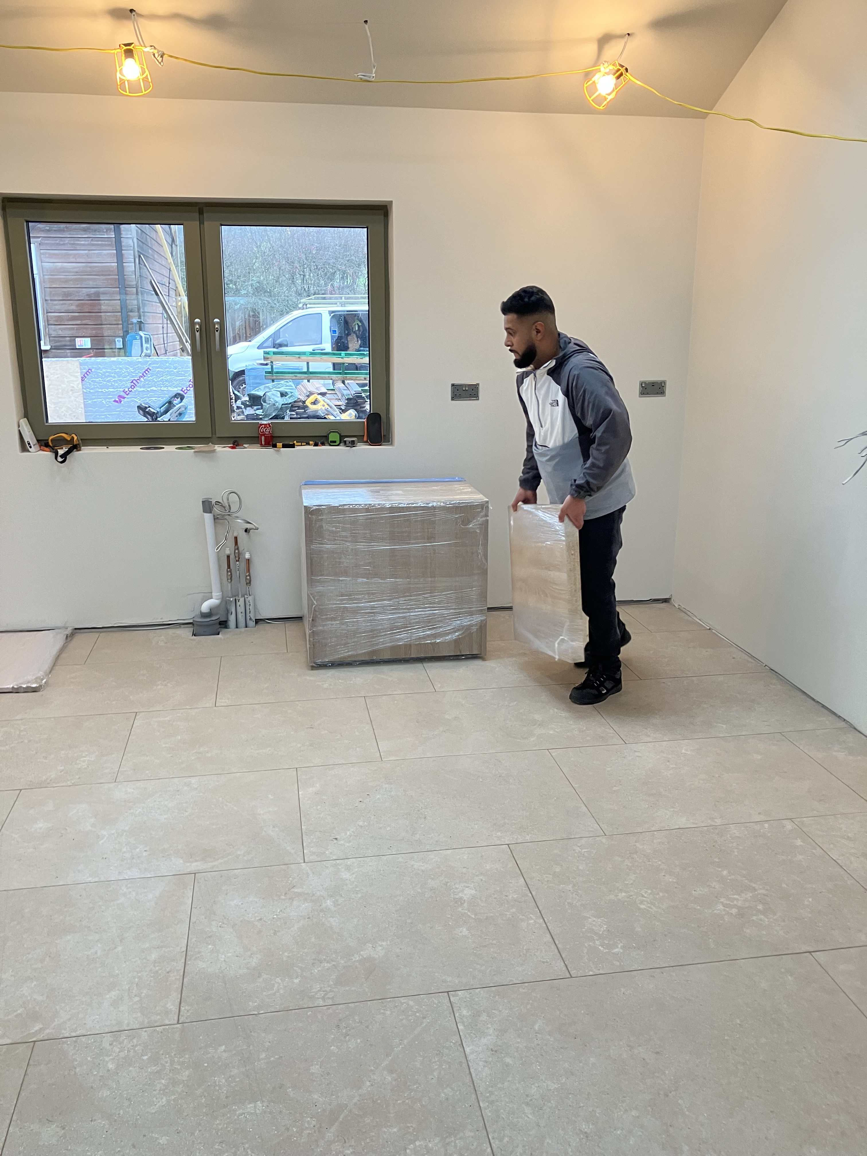

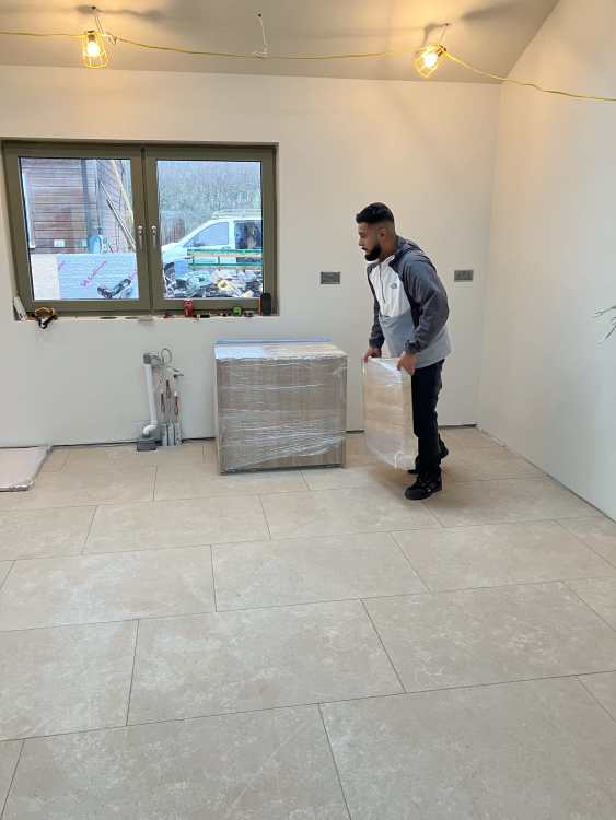

Floor tiling
The original plan was for the floor tiling to be done during the first two weeks of November but the screed not being quite dry enough delayed that.  Contractor sickness and the need for the tilers to try to juggle their other booked work around ours have led to us being about 3 1/2 weeks behind now and still not quite finished (a few tiles still to lay and about half the house to grout). The overall impact on our plan is not to severe though as we managed to schedule the decorating in early to gain a week back and overlap the tiling with second fix plumbing.
A big plus is that the quality of the tiling is excellent. In years to come, we won’t remember the delays but we’ll be constantly reminded of the quality job the tilers have done.
Tilers: Lee and Steve
Kitchen floor down - kitchen units arriving!

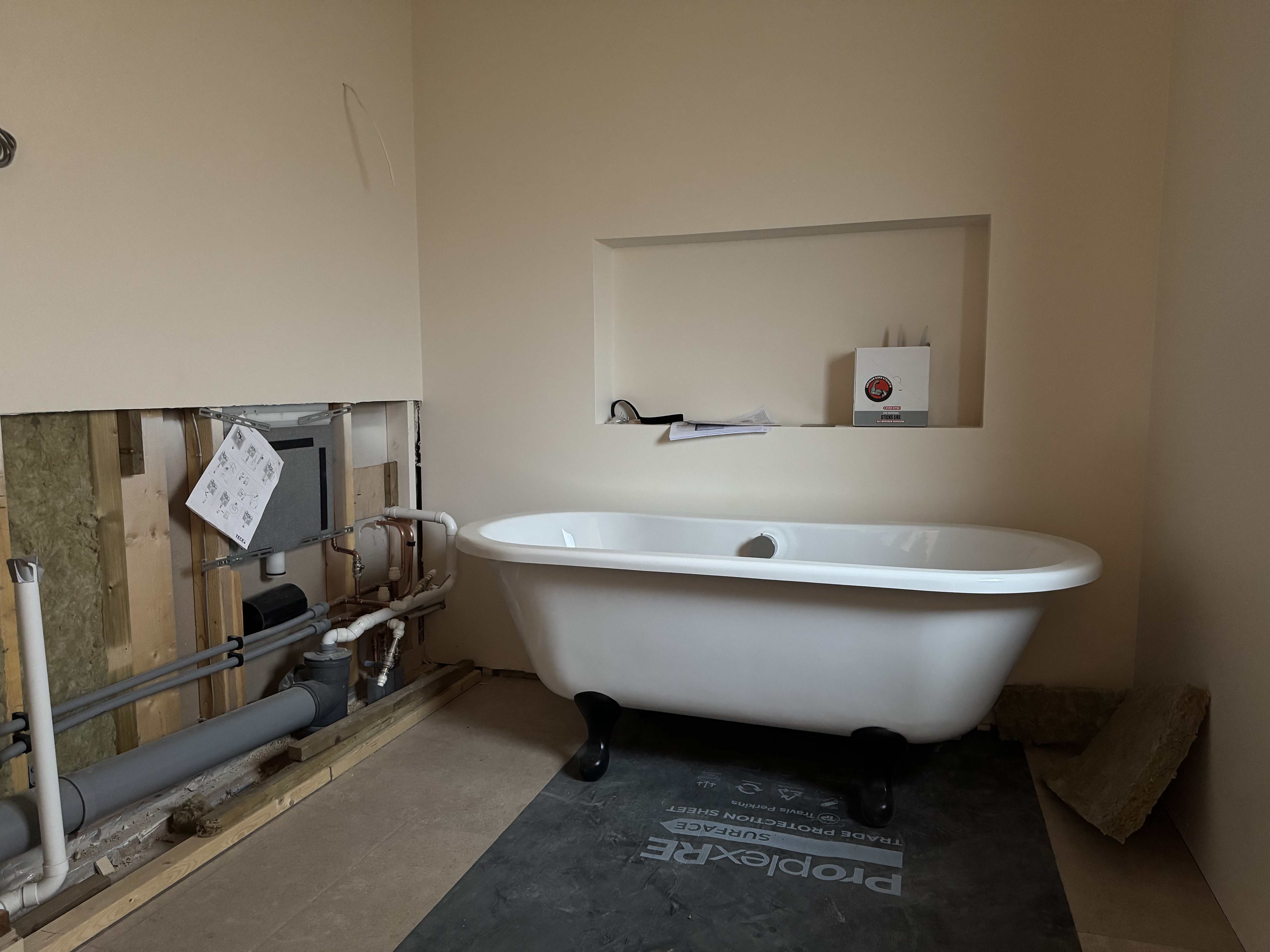

Bathrooms

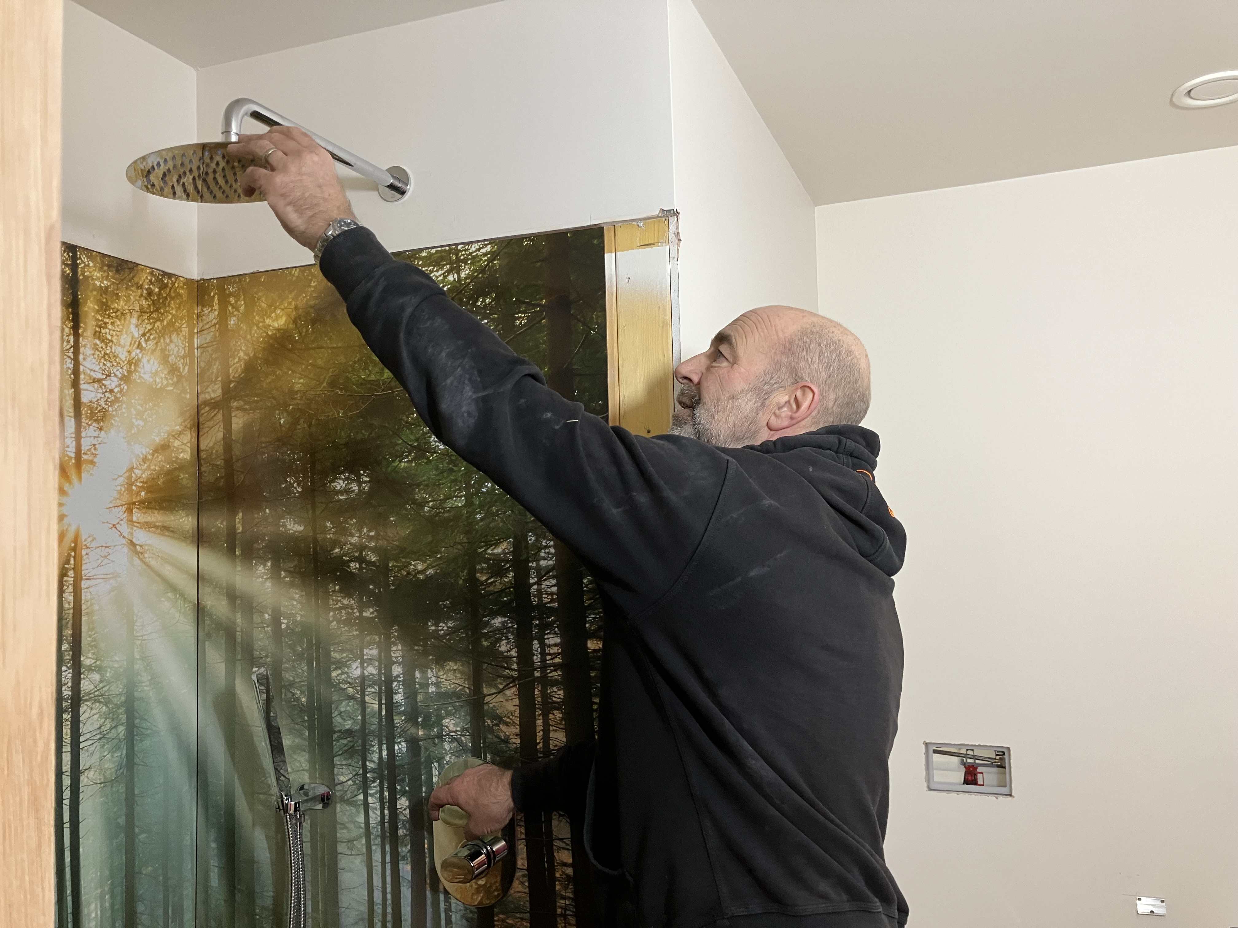

Speaking of quality, we have a first rate plumber working on our bathrooms, namely: my brother Chris.  He came over from East Sussex for a couple of weeks to do the work and the logistics meant he came ‘sight unseen’ which added to the challenge.

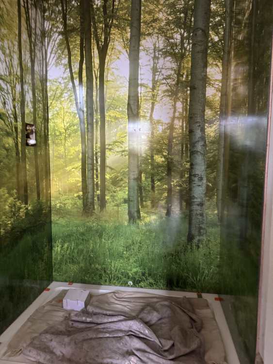

We are trying to maximise the space by fitting a generous master ensuite, a family shower room, and a guest ensuite into a relatively compact area of the overall house footprint. This means a lot of plumbing has to go into the wall between the master ensuite and the other two bathrooms.  The soil pipes, whose location we had decided on during groundworks, proved not to be in the ideal place, but Chris managed to find a way to make it all fit.  We dropped one wall hung WC in favour of a back-to-wall, floor-standing model with a concealed cistern because there was simply no way to fit a wall frame into the studwork and line the soil pipe up.

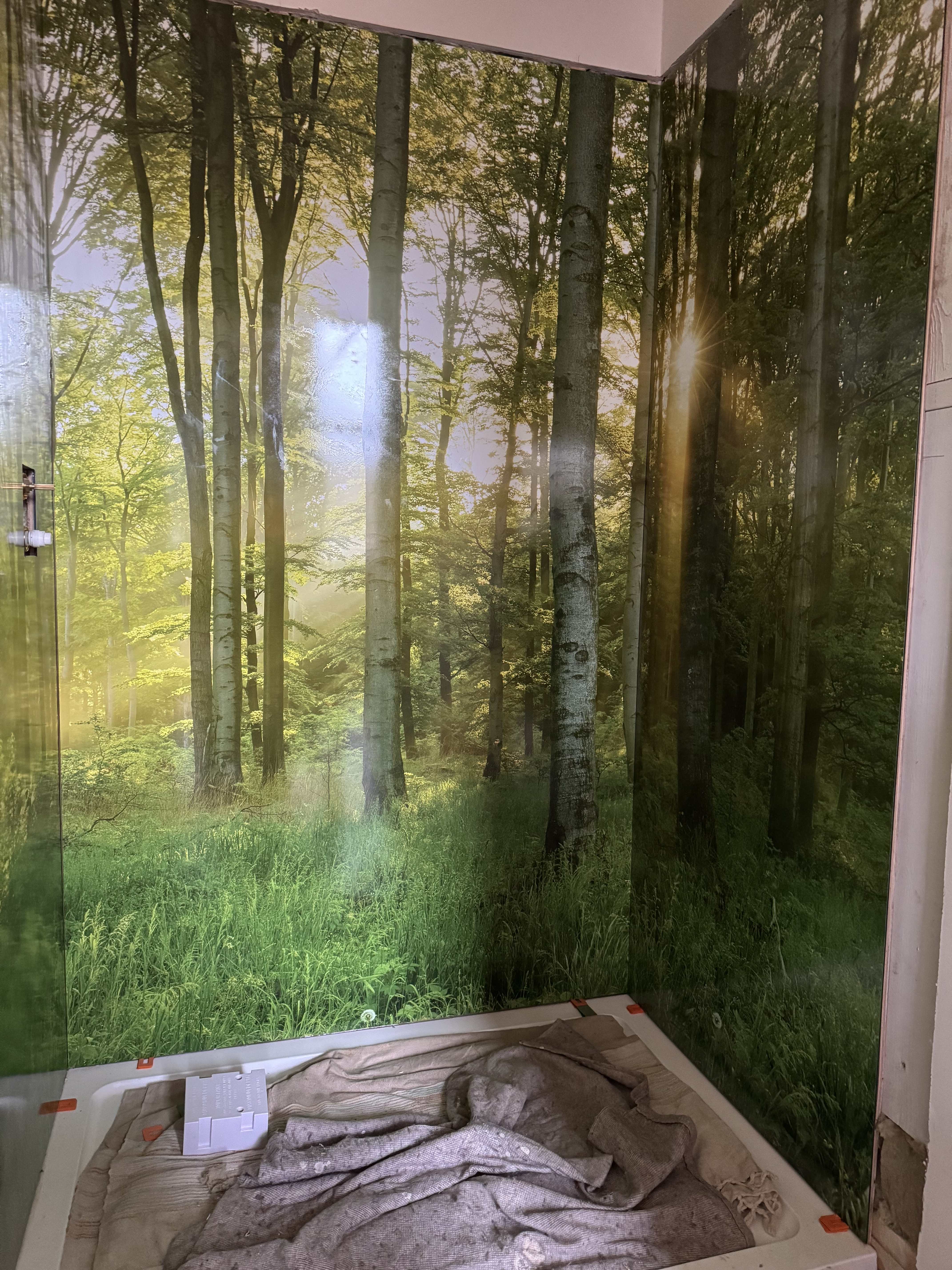

Chris has made great progress so far and we are particularly pleased with the mural wall panels that he’s fitted to the two showers. He’s also sorted out half a dozen minor jobs in the plant room, and set up the supplies and waste for the kitchen and utility rooms.
Great work Bro!

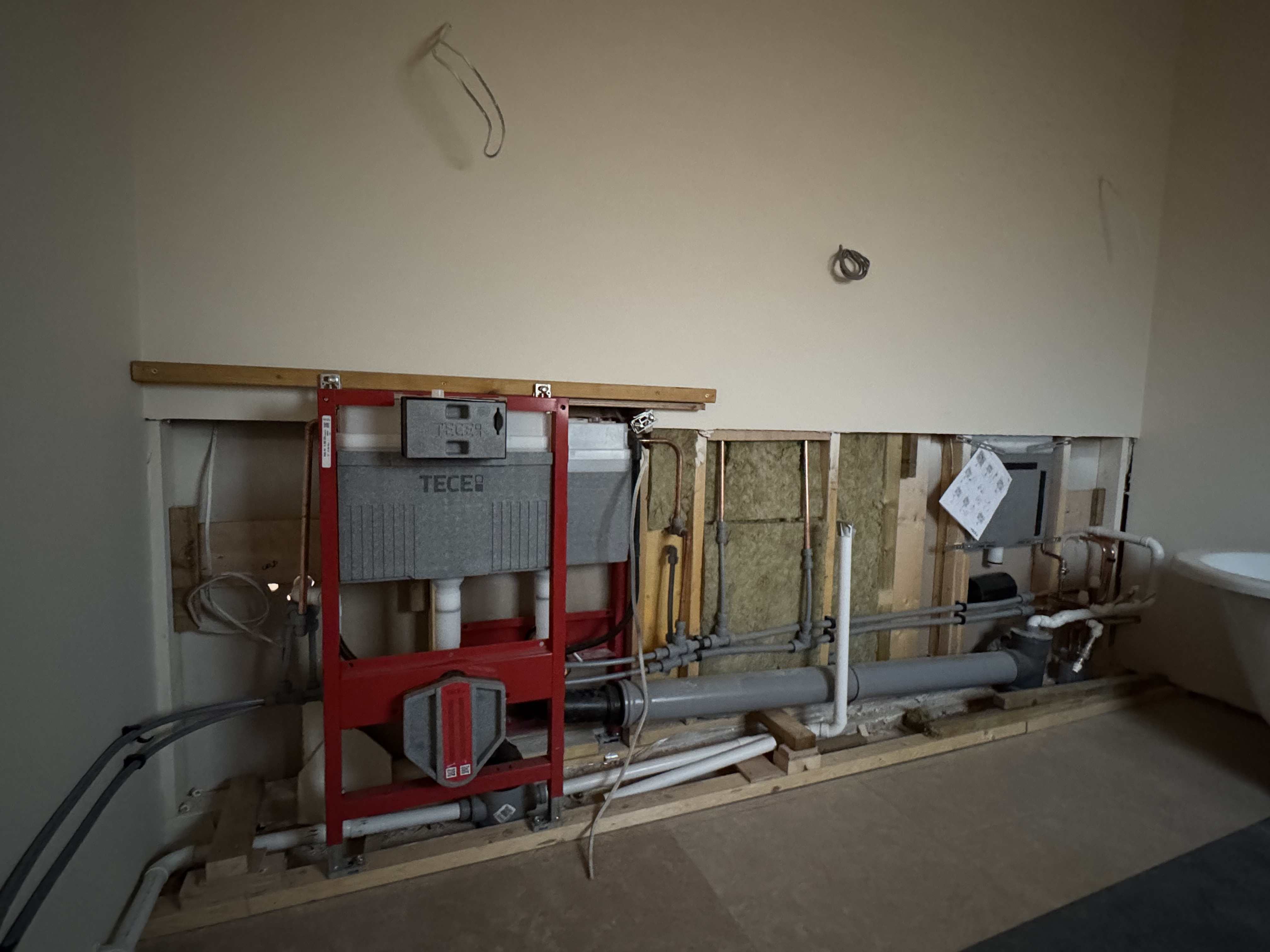

In the master ensuite we have now got some boxing-in to do which will hopefully double up as built-in storage, then Chris will be back in the New Year to fit toilets, wash basins, shower screens etc.

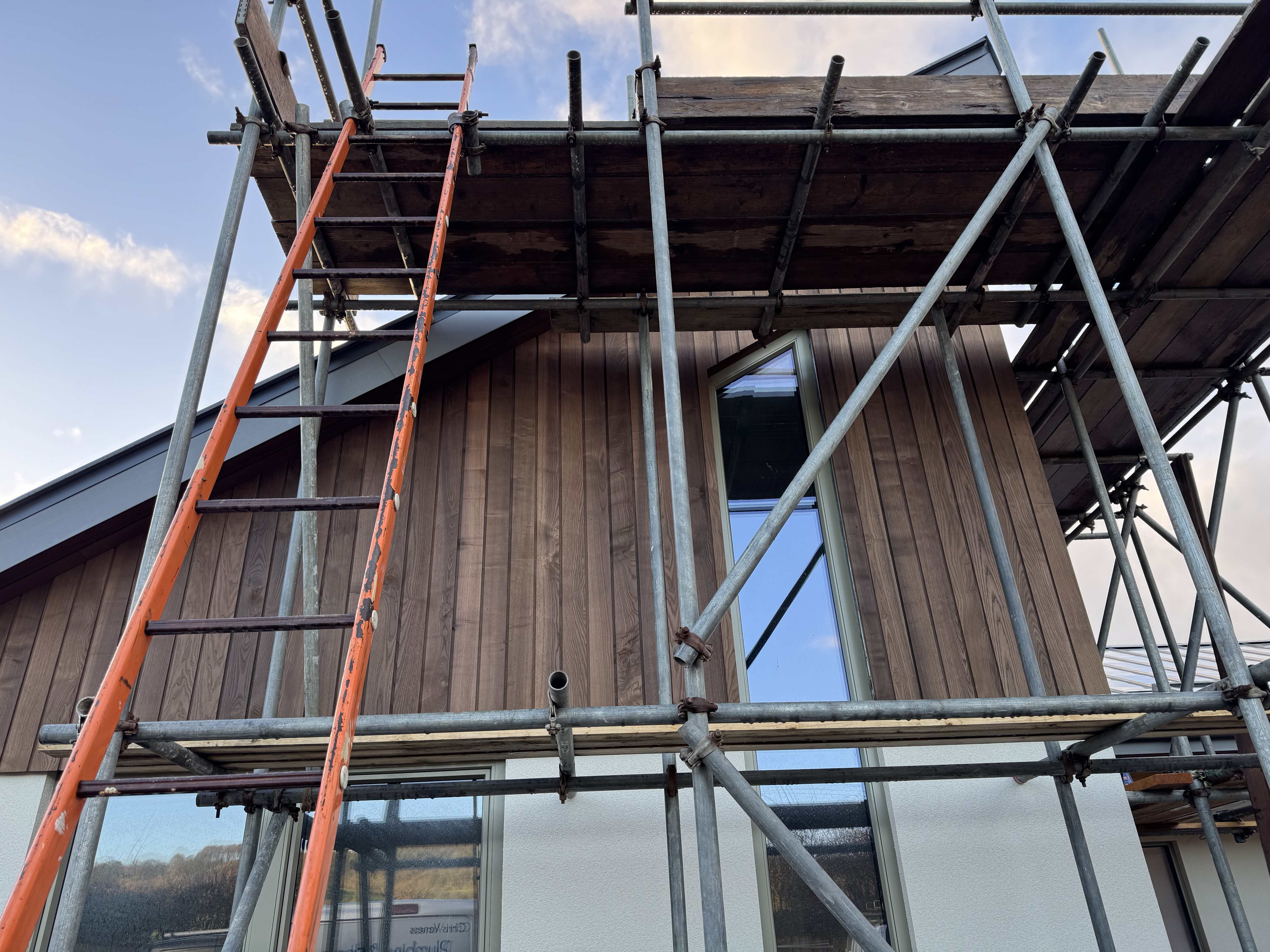

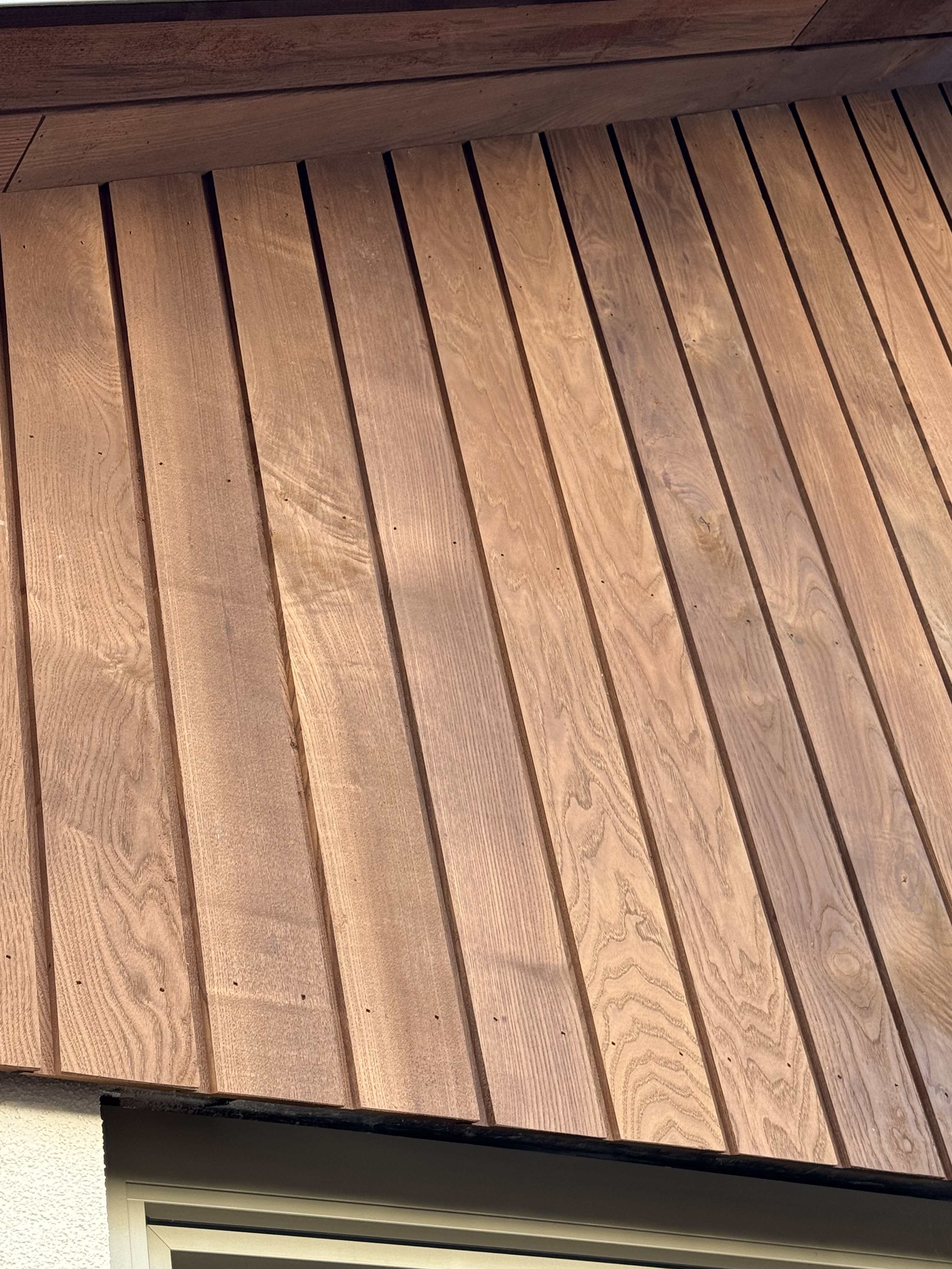

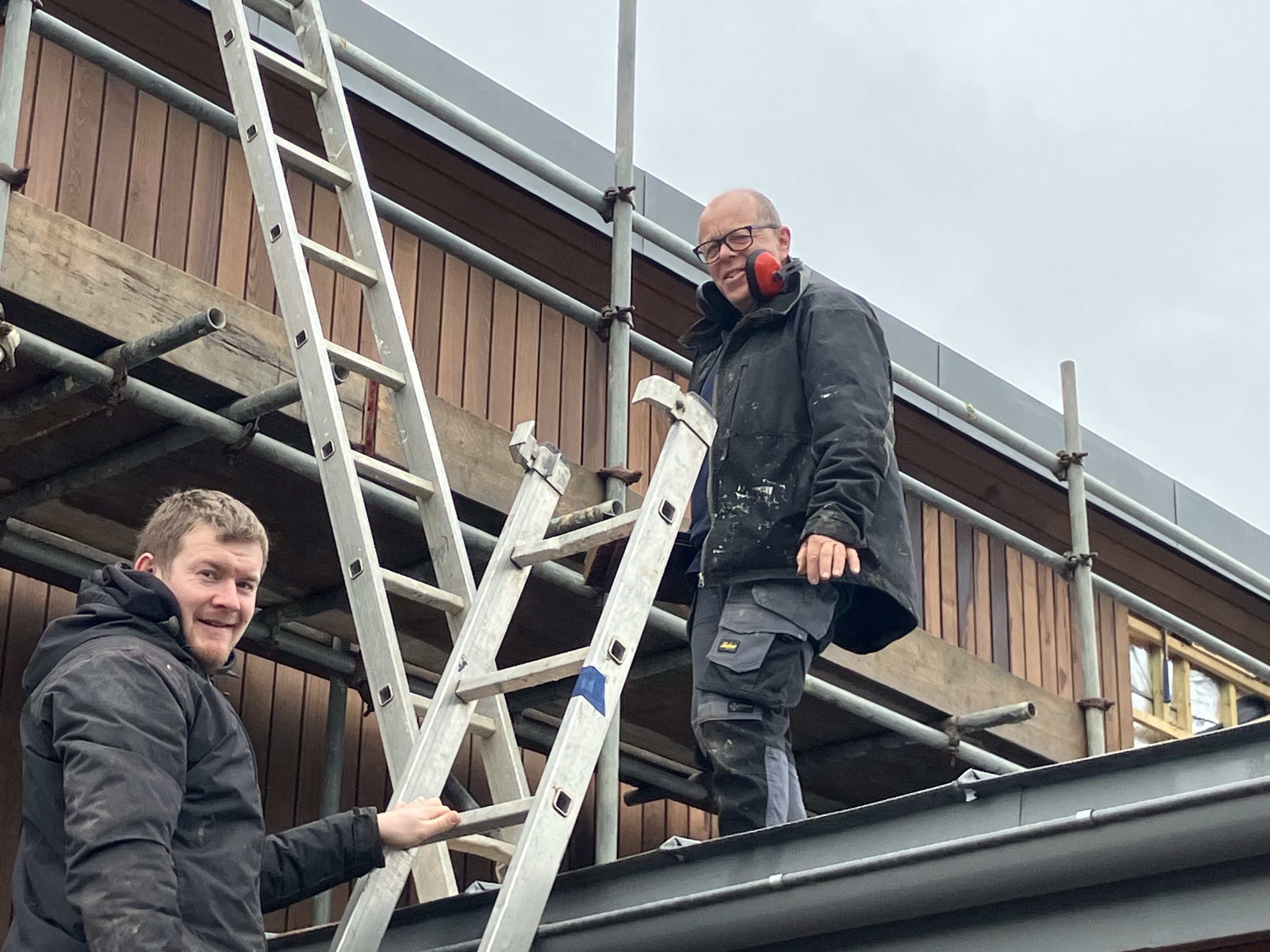

Cladding
Alan and Chris, our two chippies who have been with us throughout the build have been progressing the Brimstone Ash cladding. They’ve made a great job of it too. All the high work is now done and so our scaffolding should be coming down within the next week or so, with luck.  It would be nice to get the house clear of scaffolding with the cladding complete before Christmas.
We’re  delighted with how the cladding looks.  We won’t be treating it in any way though as we are happy to let it fade to silver naturally.
Chris and Alan our carpenters:

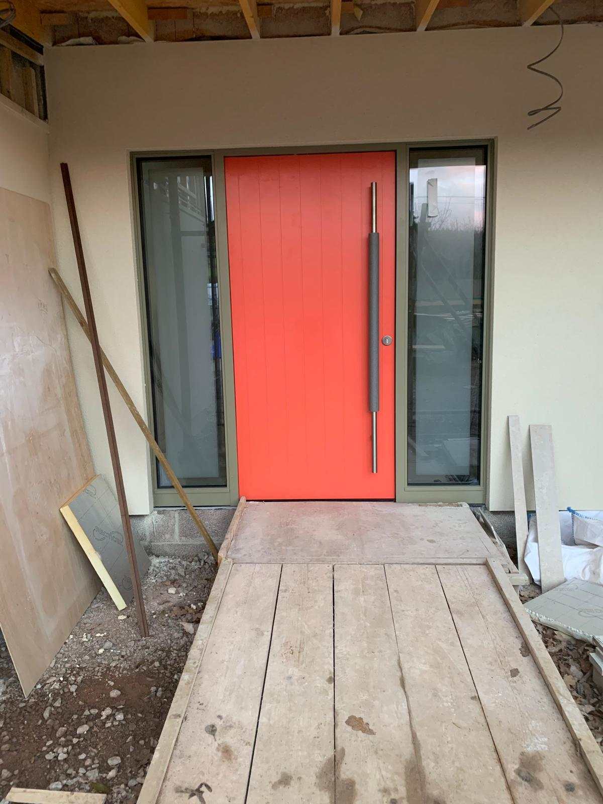

Between cladding, they found time to fit the 'real' front door back on (Norrsken tip was to replace it with a temporary door while the 'messy' trades were in and out of the house.)  The door looks great - but I am not sure the pipe insulation on the handle adds much to the aesthetics.
On the subject of doors, we went for 'slam shut', requiring a key to turn the latch from the outside, even on an unlocked door.  This may well be a recipe for locking ourselves out of the house repeatedly.  I am having second thoughts but Mrs P. is more relaxed.  I asked Norrsken is there is anything we could do to change that at this stage but they haven't been able to offer any solutions, so I guess we are stuck with slam shut doors.

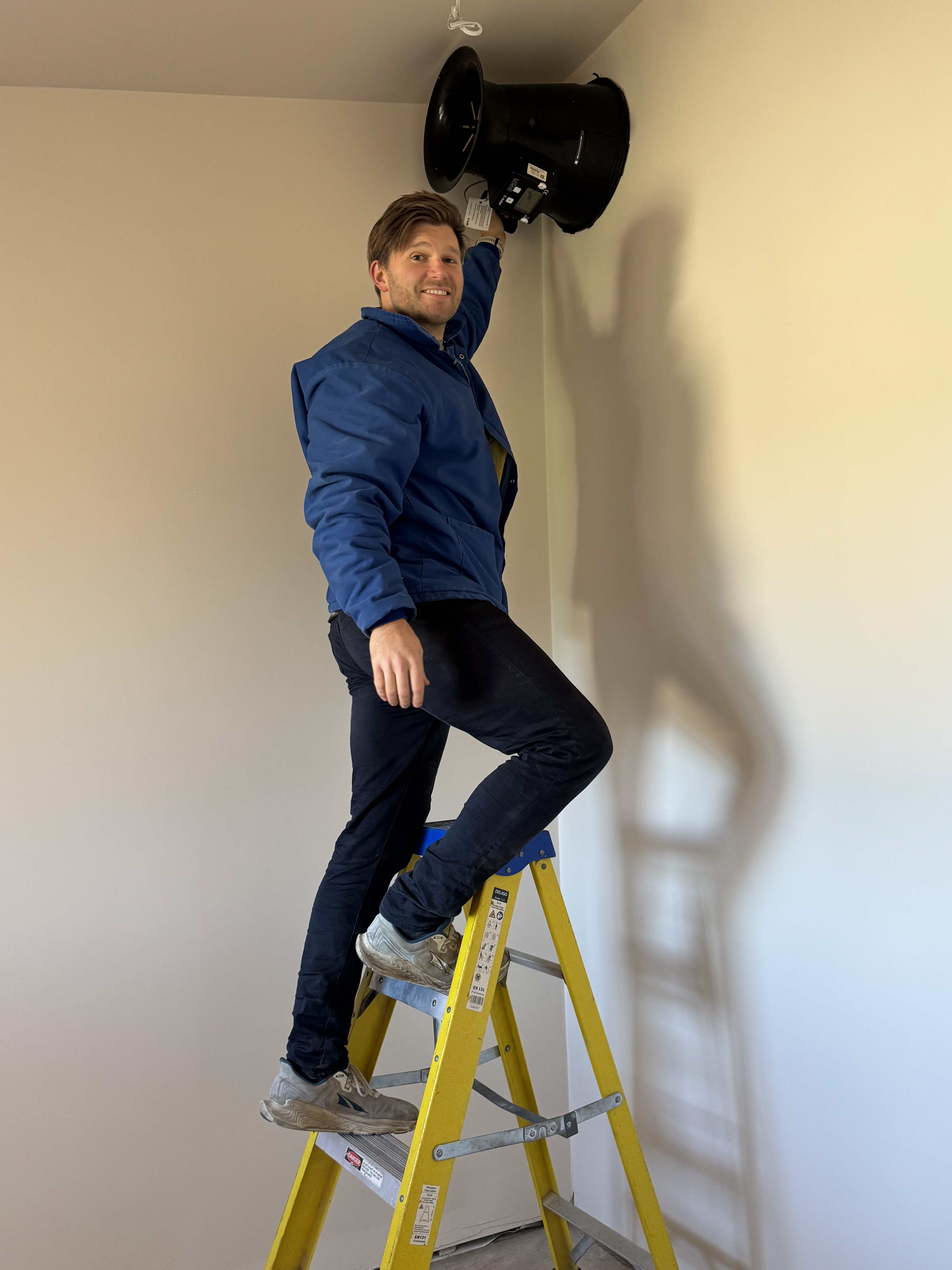

MVHR commissioning
Patrick Chester from Heat, Space and Light came along to commission our MVHR system. He confirmed that we appeared to have connected all the supply and extract valves correctly(!) and the commissioning and balancing was very straightforward.  We've had great service from Heat, Space and Light for a competitive price - highly recommended!
We have a Zehnder Q350 ComfoAir unit and Patrick took me through the basics. Compared to our previous MVHR the Zehnder seems incredibly quiet. In normal operation it’s using just 20W.  Patrick also showed me the heat recovery stats. On the day of the commissioning the outside air temperature was 2° C and the inside air was 15° C.  After passing through the heat exchanger, the incoming air was registering 14.5° C, so that’s a pretty impressive exchange of the heat from the air going out to the air coming in.
Patrick balancing the ventilation system

I do like the look of the Brimstone Ash (from Vastern Timber?). I tried several samples including it as well as Western Red Cedar and British Larch, one set indoors and the other outside to weather. The Brimstone faded to silver grey really quickly. It also proved a good demonstration of why you don't use galvanised fixings which was all I had to hand... black staining within a week!
Are you leaving the bottom edge over the windows as in the photo? I am thinking of adding a drip edge piece in timber or aluminium profile. Would you mind sharing the detail?

Yes it's Brimstone Ash from Vastern timber.  Expensive but really excellent quality - straight as a dye, virtually no knots, and it came really well packed.  It cuts cleanly and we haven't experienced any splitting, despite Vastern warning that it can be brittle.
We originally intended using western red cedar but discovered that cedar reacts with zinc and we have some high cladding above our zinc roof.  The Brimstone Ash is inert (so we are told!).  It's about the same price as Canadian cedar but has the benefit of going silver quicker, and it's British, so lower transport CO2 costs.
Stainless nails are an absolute must.  We're using Timco FirmaHold 16G 50mm Stainless 2nd fix nails through the face - very hard to see.
Regarding the edge above the windows.  Although it doesn't really show in the photo all the bottom edges are cut at a 30 degree angle to leave a drip point at the outside edge.  This was recommended by Vastern.  The same for any joins in long verticals, though incredibly I think we have only needed 2 or 3 due to lots of long lengths being supplied and careful selection by our carpenters.  For the bottom edges they have fixed them slightly over sized then run a rail saw.
Anyway we feel the angled cut at the bottom should stop water pooling on those bottom edges.
Further progress on the cladding today:

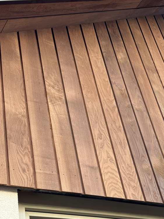

Fantastic build, the Ash is such a premium product and looks great.
I purchased about 300sqm of locally cut Red Cedar, 200mm wide and then cut a half lap on each edge, fixed with SS screws. Very knotty compared to Canadian but does not detract.
Image below is triggering!!
But you do have very good builders, you must so pleased with the progress.
Can you tell me what the electrics behind the cladding is, one looks like Cat 5/6?

Hah, yes, I spotted that in the photo too but you just don't notice the nail holes from ground unless you look for them.  They are doing them by eye rather than marking out every hole and there are some slight variances - I'll forgive them that because we want the cladding done asap.
The cables are indeed mainly cat 5/6 - for CCTV.  The outside lights are all in the soffits, and obviously have power cables running up behind the cladding from the plant room to service those.  There are just a couple of outside power sockets but not on these walls pictured.
We have used British cedar before on previous projects and rated it highly.  We bought it green from a local sawmill and was very heavy - I almost expected it to drip like a sponge.  But once it was up it dried quickly and weathered very well.   I might well use it when we re-clad the workshop, next year hopefully - no zinc to run on to so no issues with using cedar there.
It's not visible in the photos - did you render the window head reveals? On ours I'm concerned it would be too awkwardto render.

No we haven't rendered that top reveal - too fiddly.
There's a cross batten behind the vertical cladding and I think they have added, or are going to add, a strip of ash to cover that batten but that strip will only be visible from below - the vertical cladding comes down further.
I need to check tomorrow.   Also I am now unsure how any water that gets behind the cladding will drain, so I need to check that too but I'd be surprised if the chippies haven't already considered and addressed it.  (There's a ventilated cavity behind the cladding of course.)
I'll report back.
Edited by Benpointer
Benpointer
I'll report back.
Checked - it's as I thought, they are going to fix a strip of the ash to the cross batten, they have already done this on the tall window (photo looks a bit odd due to it being an angled reveal + the camera perspective).
We are not going to worry about weep holes because: ventilated cavity, small gaps between the half lap boards, and its a relatively sheltered east facing wall.  The window itself is set back from the cladding and very well sealed.

Interested to see you using Tece cisterns. We've used Tece frameless, really nice product but be aware where you purchase as there are non WRAS approved units out there which can catch out the unwary, I know!
