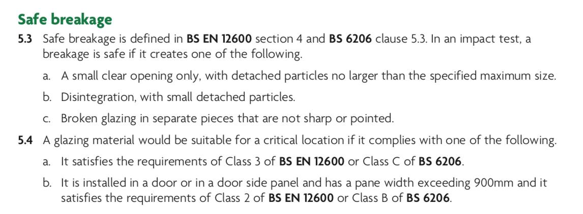

Roz Posted May 30, 2019 Posted May 30, 2019 So, for the bifold for our studio, we have to conform to the same regulations as the rest of the house. They need toughened glass in them basically (and the right hardware). Our BCO said "The glass in the Bi folds needs to be safety glass to BS6206. This is either laminated or toughened." The glass in the bifolds I am currently hoping to order says it meets European standards BSEN12150 and BSEN12600. I can't figure out if this is sufficient?? Anyone more well versed in these know the answer?
Ralph Posted May 30, 2019 Posted May 30, 2019 BS6206 is the old standard superseded by BSEN12600 so I would say you're covered. 1
Moonshine Posted May 30, 2019 Posted May 30, 2019 umm, a quick search on the british standards, indicates that BS6206:1981 has been partially replaced by BS EN 12600:2002 https://shop.bsigroup.com/ProductDetail?pid=000000000010129296 1
Roz Posted May 30, 2019 Author Posted May 30, 2019 13 minutes ago, Ralph said: BS6206 is the old standard superseded by BSEN12600 so I would say you're covered. 12 minutes ago, Moonshine said: umm, a quick search on the british standards, indicates that BS6206:1981 has been partially replaced by BS EN 12600:2002 https://shop.bsigroup.com/ProductDetail?pid=000000000010129296 Thanks both! Wonder why the BCO is using the old one.
Moonshine Posted May 30, 2019 Posted May 30, 2019 30 minutes ago, Roz said: Thanks both! Wonder why the BCO is using the old one. If i were you, i would get the company that you are hoping to order from to give you something in writing that you can pass on to the BCO in relation to BS 6206, and how its relates to BS EN 12600.
PeterW Posted May 30, 2019 Posted May 30, 2019 45 minutes ago, Roz said: Thanks both! Wonder why the BCO is using the old one. Because he’s a dinosaur .... Since 2013 the Part K regs have referred to BS EN 12600 1
