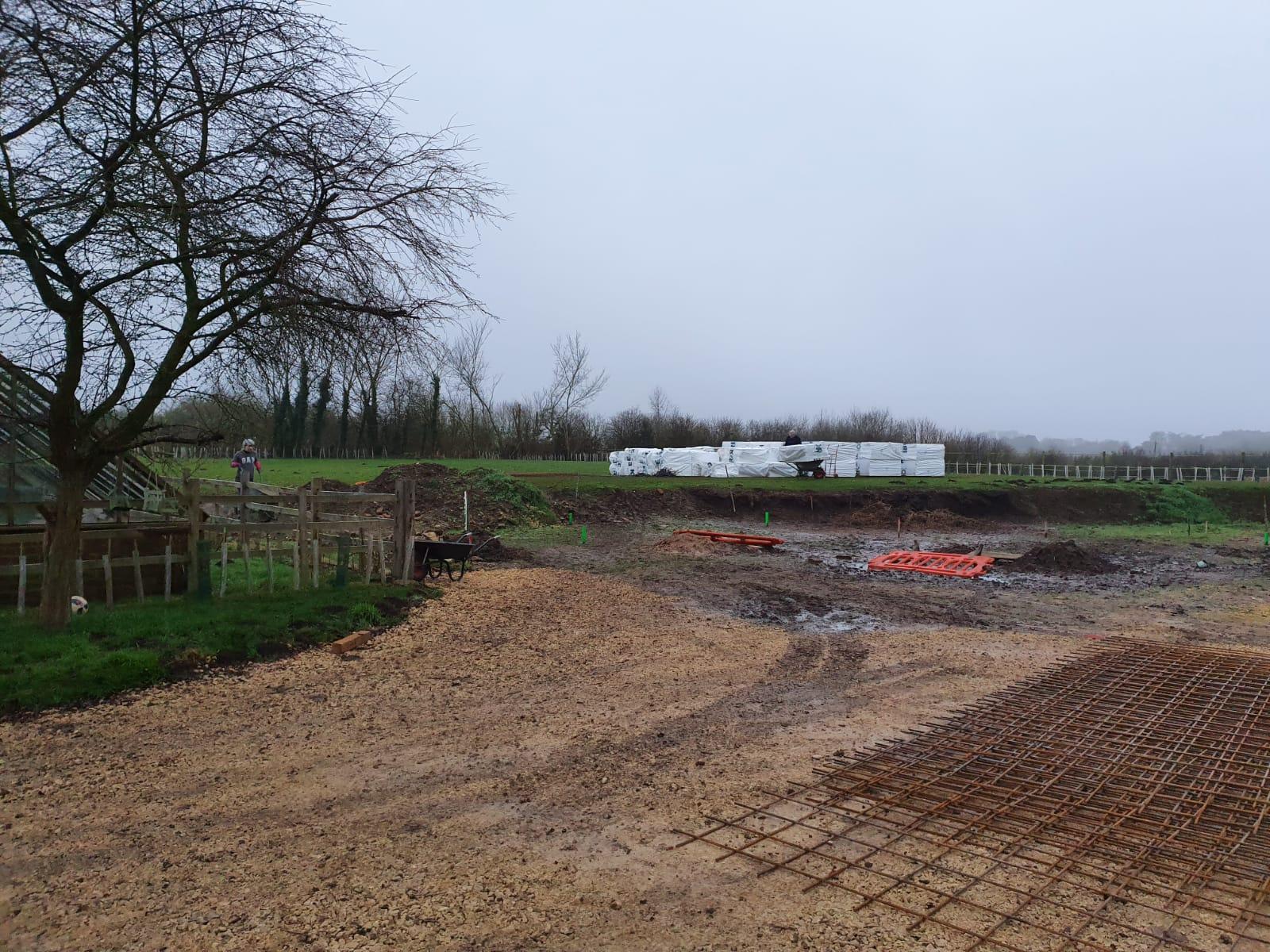

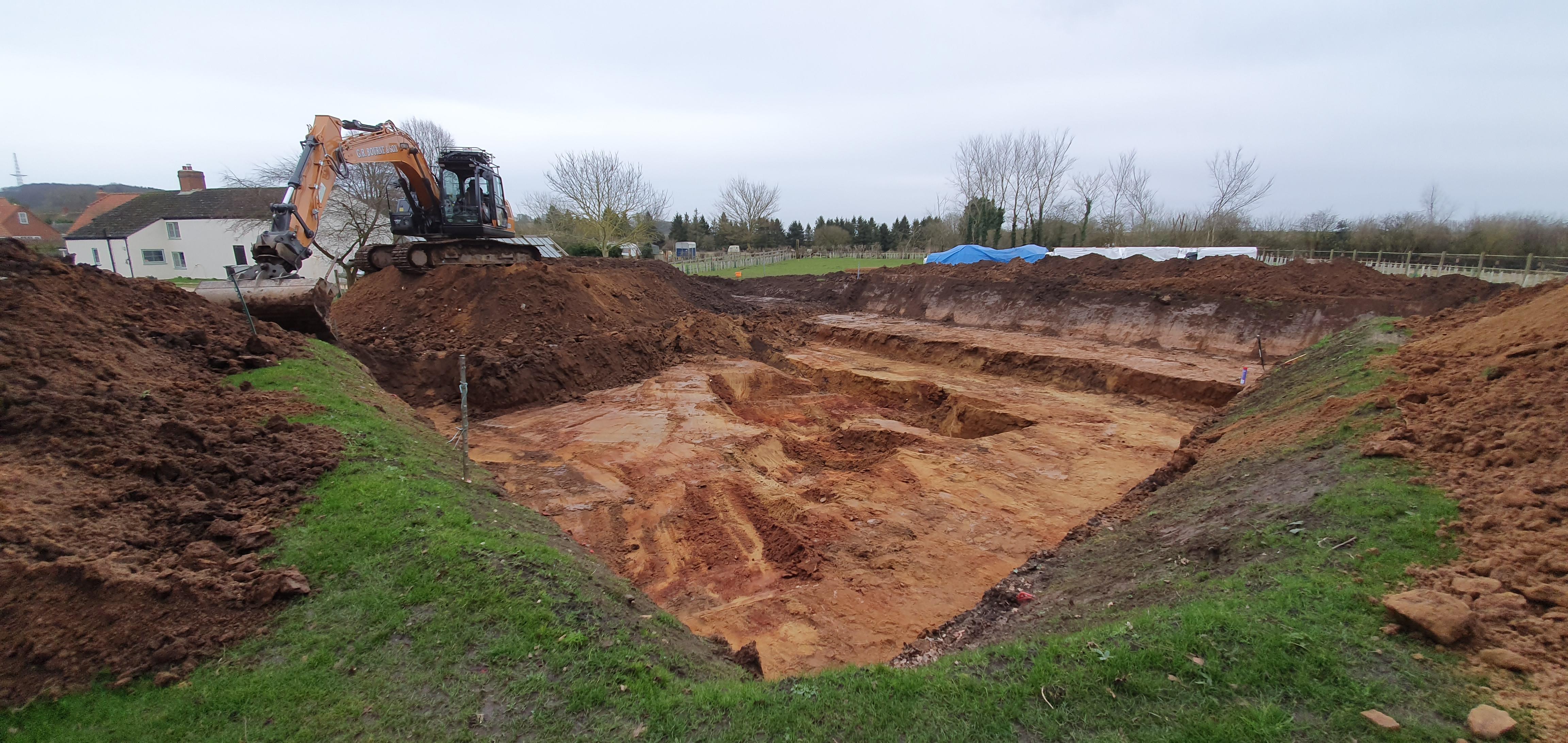

Trying to do as much of the founds myself as possible.  The design was done by Tanners, the insulation is from Kore.
Due to the ground I have, it needs digging out by 800mil before putting 500 of stone in.  50mm of grit sand to go on that before I can lay out the insulation.
The insulation appears to be as simple as a jig saw puzzle - I have a plan with the edges marked out, just follow the foundation design when filling the middle in.
The steel is fairly simple, just two layers of mesh, no complicated cages or such in the thickenings.
I hope to get all that done and the UFH pipe installed before getting a contractor in to do the concreting.
Not alot to show yet other than the big hole!
