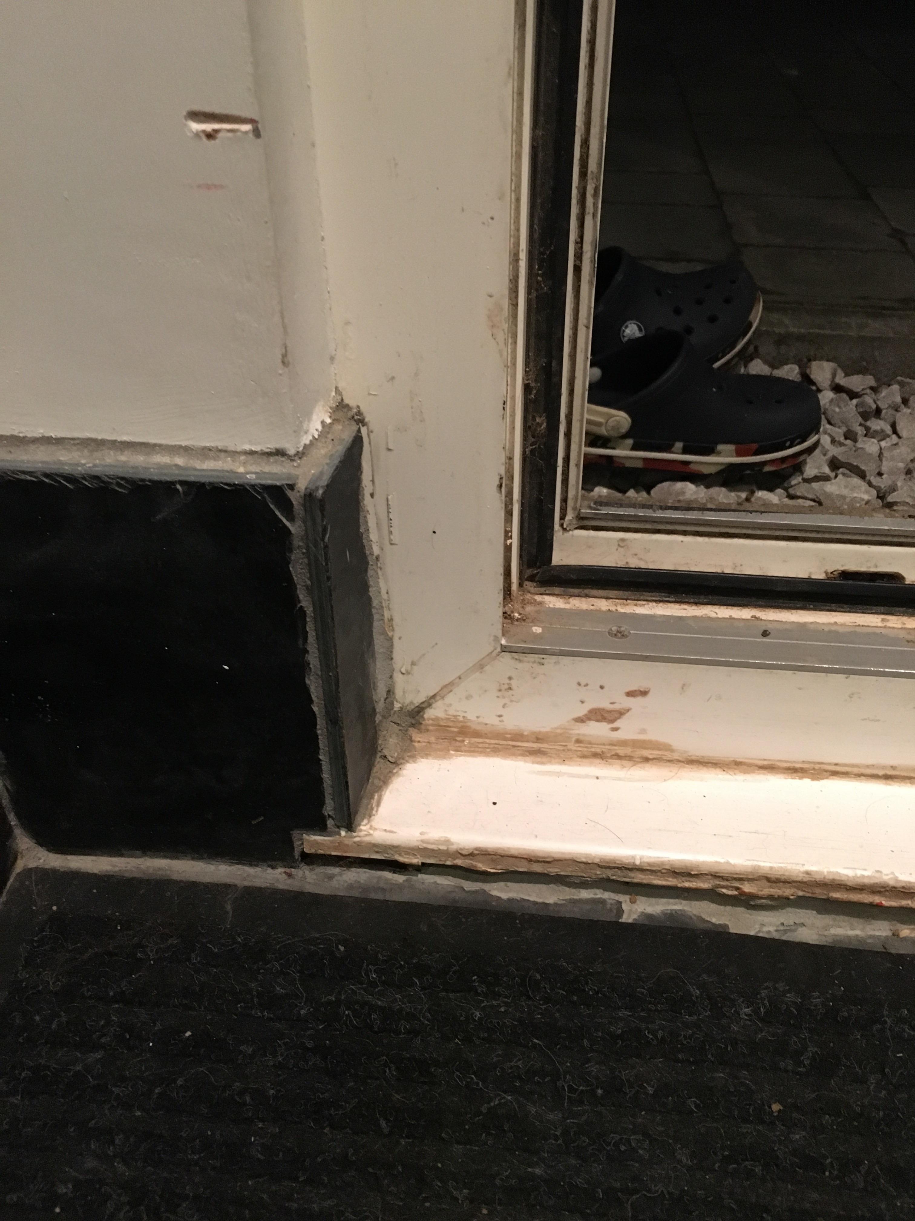

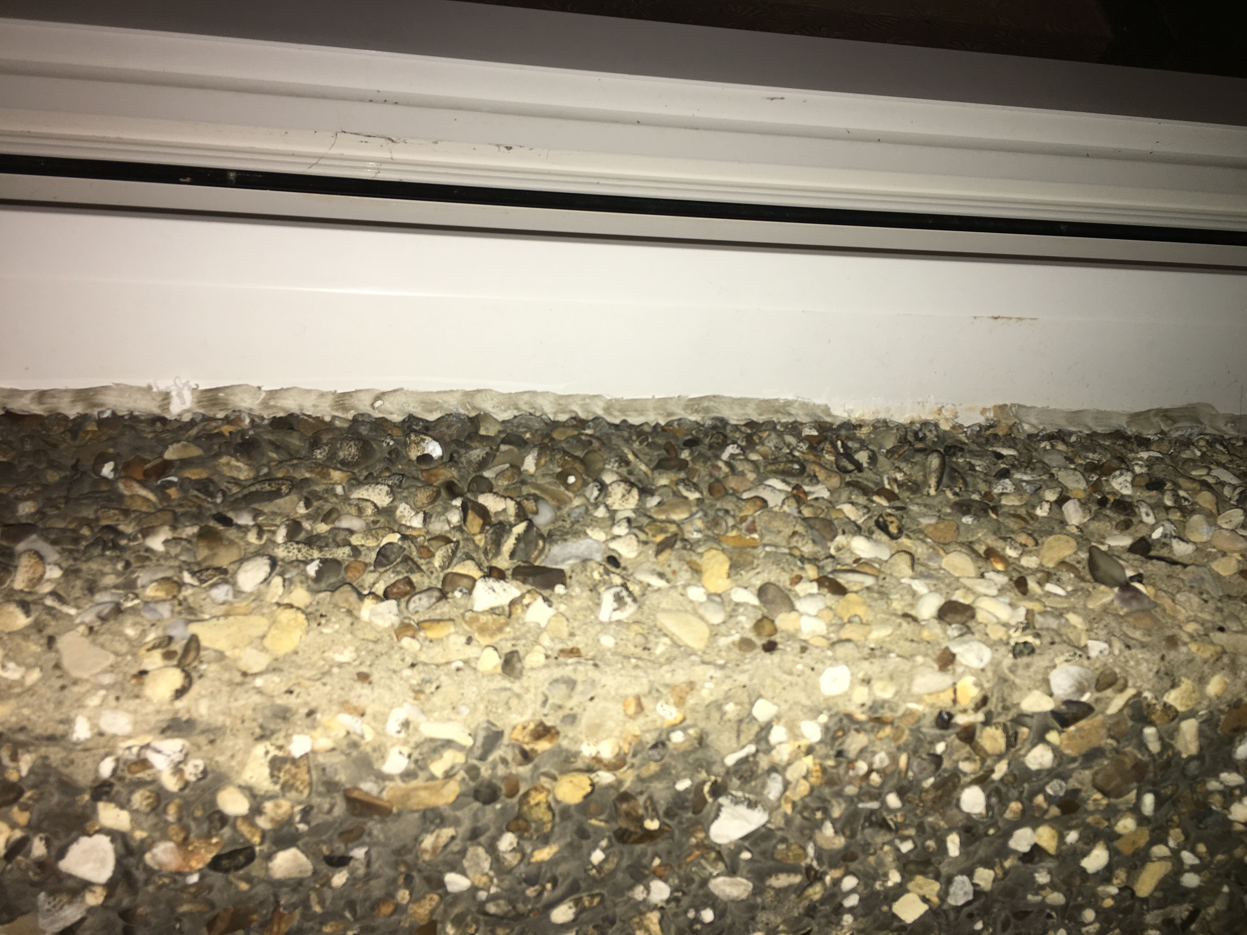

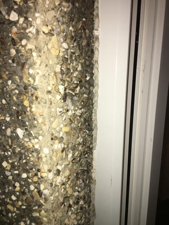

Calvinmiddle Posted September 5, 2016 Share Posted September 5, 2016 Anyone got any advice for removing an old uPVC door and frame with the view of getting it out in one piece to sell on eBay? Know how the door lifts off the hinges and located 4 screws on each side, but it's rendered on the outside so will that have to come off to get the frame out? here are a couple of pics Link to comment Share on other sites More sharing options...
Declan52 Posted September 5, 2016 Share Posted September 5, 2016 It will held in place by metal straps clipped onto the side. Probably 3/4 on each side and maybe 1 top and bottom depending how fussy the fitters where. The plaster on the inside will have to come off and you will see where the straps have been hilti nailed in place. Once you cut the straps with a grinder it will only be held with expanding foam and silicone. Should be able to slide a saw up between frame and revel and cut this out. Door should come out then. Link to comment Share on other sites More sharing options...
PeterW Posted September 5, 2016 Share Posted September 5, 2016 Unless it has concrete screws holding it in through the frame - check for a gold frame fixer or screw caps in the sides. Link to comment Share on other sites More sharing options...
Calvinmiddle Posted September 5, 2016 Author Share Posted September 5, 2016 Got the 4 screws on each side, can't find anything on top or bottom. Slightly worried that both the render and plaster will need to come off to get the door out. Cant remember if I told the brickie I wanted to save the door and frame, if I didn't would they just smash the frame out as opposed to take it out nicely Link to comment Share on other sites More sharing options...
Nickfromwales Posted September 5, 2016 Share Posted September 5, 2016 Yup. They'd sacrifice the door to save the reveals These doors sell for pennies so not really worth hacking the house to bits to get it out whole IMHO. Link to comment Share on other sites More sharing options...
Onoff Posted September 5, 2016 Share Posted September 5, 2016 Concrete screws, sounds like. Torx head on them? Probably just in there on packers.....if you're lucky. Or been expanding foamed in if not..... Get the door off, screws out and see if it's "live". Cut through any mastic and/or peel off. Would removing render/finishes from the inside be an option? Link to comment Share on other sites More sharing options...
Calvinmiddle Posted September 5, 2016 Author Share Posted September 5, 2016 Inside being replastered and outside rerendered, so I'm not bothered about the reveals. Know they don't go for much but even if I get £10 for it it saves me having to cart it to the dump and buys me a few beers. Will see what mood the guys are in tomorrow... Link to comment Share on other sites More sharing options...
