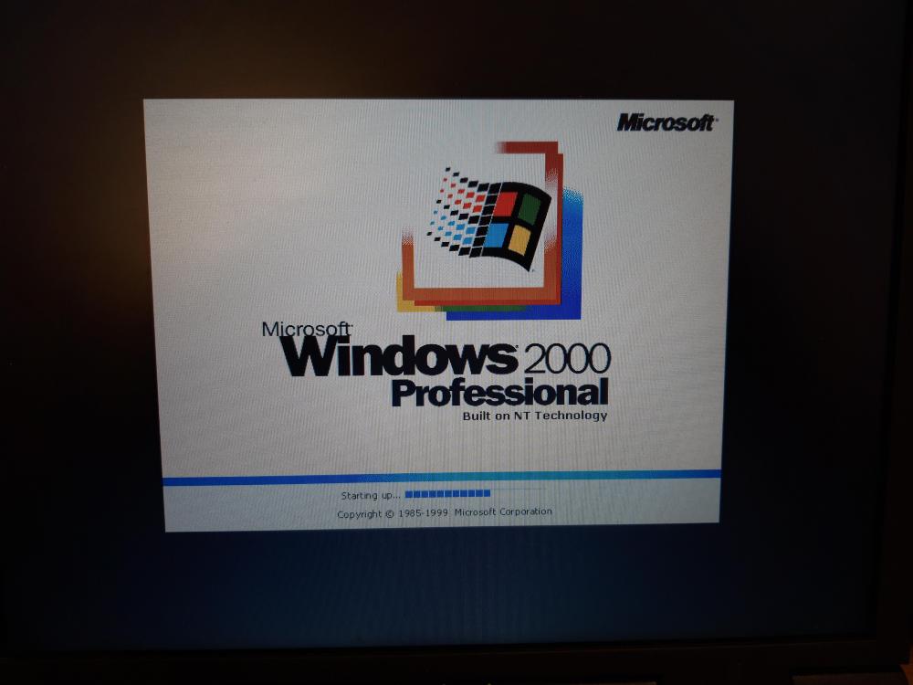

Well I got somewhere, in some sense further than I thought I might in cloning the 6GB hdd to the 8GB compact flash card.

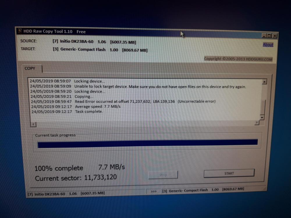

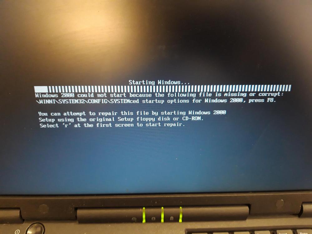

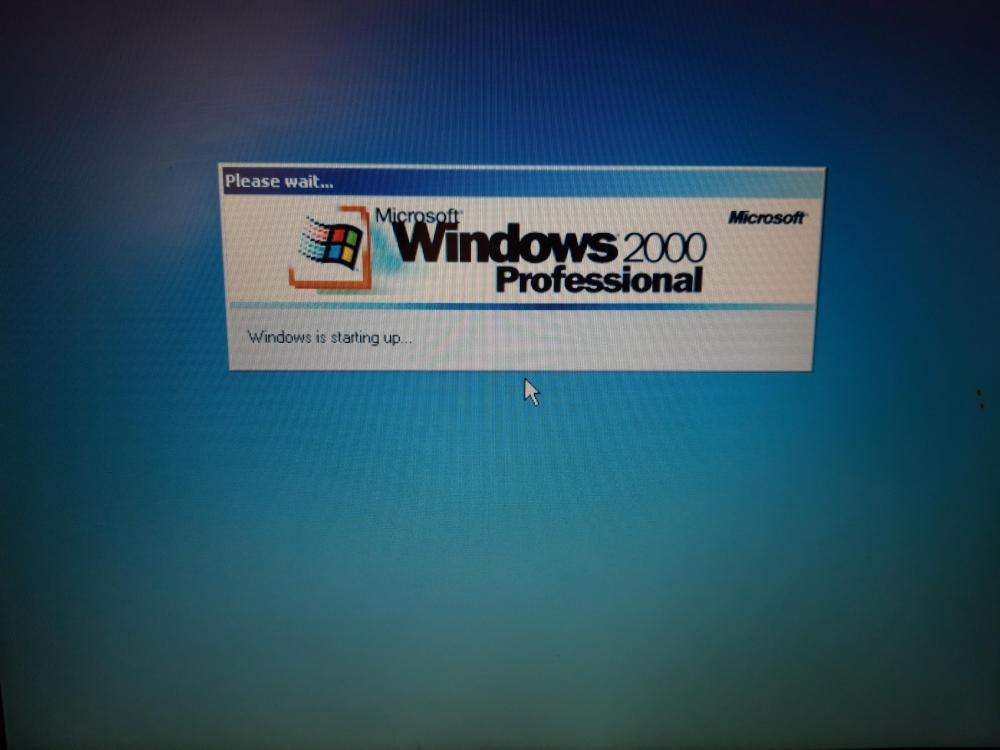

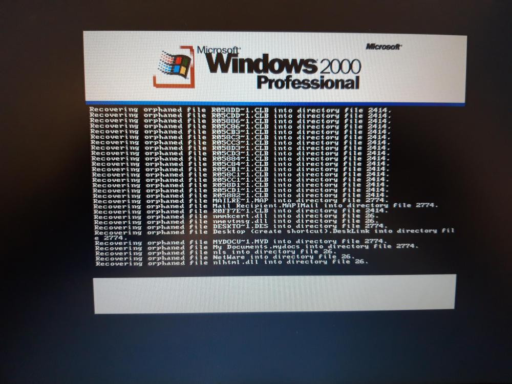

Macrium Reflect didn't work - errors. EaseUS appeared as though it might until I found out I'd have to pay!
I then used the free HDD Raw Copy Tool. First go failed so from the command prompt I ran chkdsk with /f on the source hdd. Didn't appear to fix anything but the second attempt completed albeit with a read error:
I plced the CF card in the laptops hdd tray and switched on. Failed to boot with the following screen.
So I deleted the contents from the SYSTEM32\CONFIG folder on the CF card then copied them direct from the source disk.
Back into the laptop and after auto detecting / fixing some errors it boots up to the clone of the original desktop, what I was aiming for all along.
It all seems dare I say though, a bit clunky/laggy compared to when a proper hdd is fitted. I wonder if a faster CF card would be better?
The mouse pad on the laptop doesnt appear to work (did it before I'm wondering???)  so I have to use an external PS2 mouse.
The one program I was wanting working, the whole purpose of this really, crashes! I'll persevere and probably try and reload from CD.
Quite impressed.
