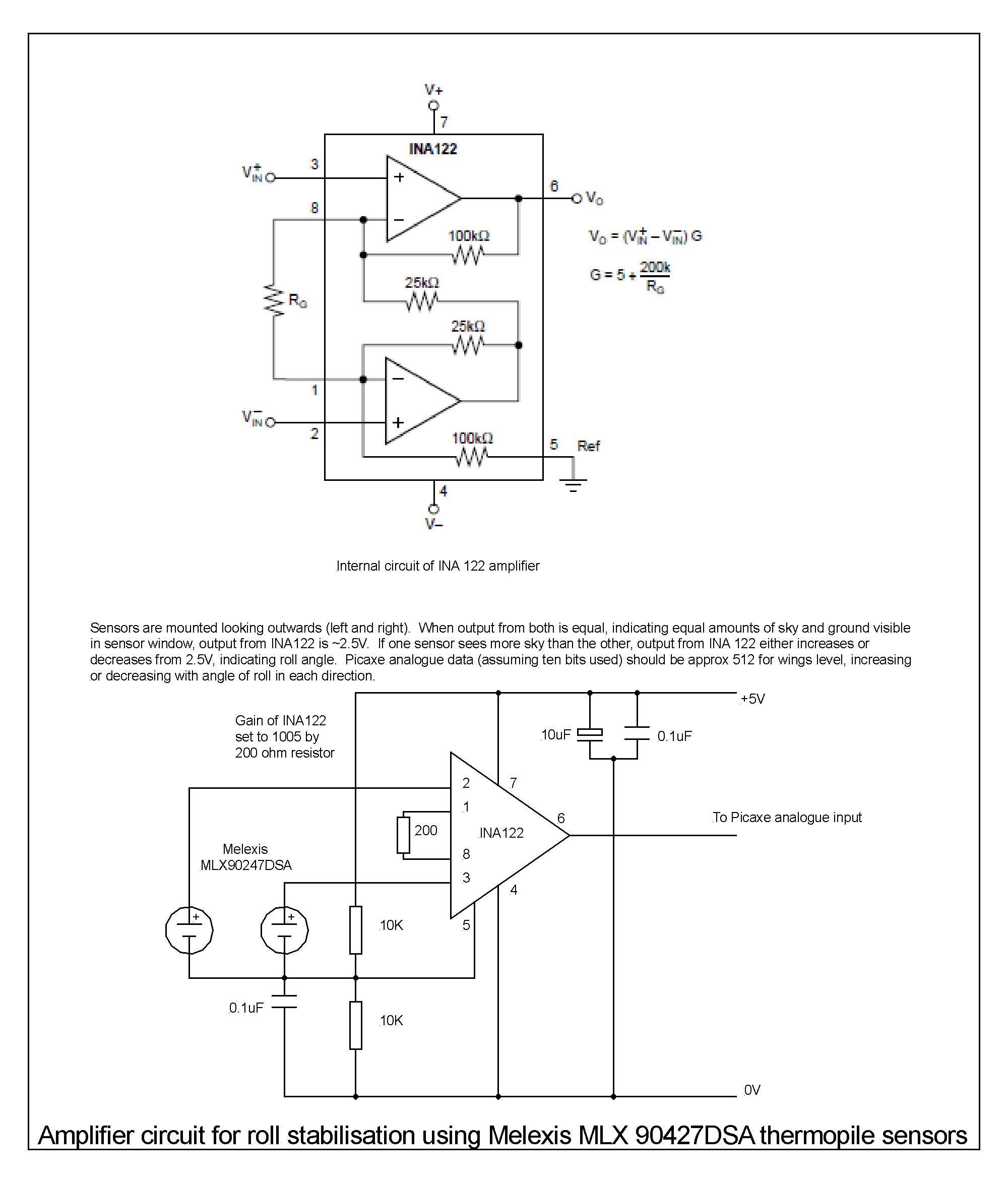

Posted
8 minutes ago, SteamyTea said:
Purely as an academic exercise, has anyone every rigged one of these up to a RPi:
https://www.melexis.com/en/product/MLX90615/Digital-Plug-Play-Infrared-Thermometer-Ultra-Small-TO-Can#
They do a few different ones, including an IC2 one for about 3 quid.
I've got a box of various  Melexis IR sensors around somewhere.  Can't recall which ones offhand, but I can try and dig them out and check.  I used them to make an aircraft artificial horizon, by sensing the boundary between the ground and the sky.  Not exactly 100% successful as a project, but good fun.  It semi-worked, but the idea was to try and build a cheap and cheerful gadget that would allow the pilot of an aircraft without IFR instruments to be able to get out of trouble if he/she accidentally flew into cloud.

Posted
7 minutes ago, SteamyTea said:
If you could and see if they work with an RPi, I then may get some as part of my Silly Sunday Experiment, which is now over a year old.
Just dug the box out.  Seems I have a handful of Melexis 90247 sensors: Melexis MLX90247_v2.pdf
Looking back it seems that I used an INA122 low noise instrumentation amplifier to get a large enough signal to feed into a microcontroller A/D input: INA122.pdf
Not sure if one of these would be any use to you.  I may well have a spare INA122 knocking around too.
I found the circuit that I drew up years ago of my prototype "wing's level" IR sensor unit too:
Posted
I may just take a chance and get the ones that work on an Arduino, can get a couple of them delivered for under a tenner.
Cheers anyway.
