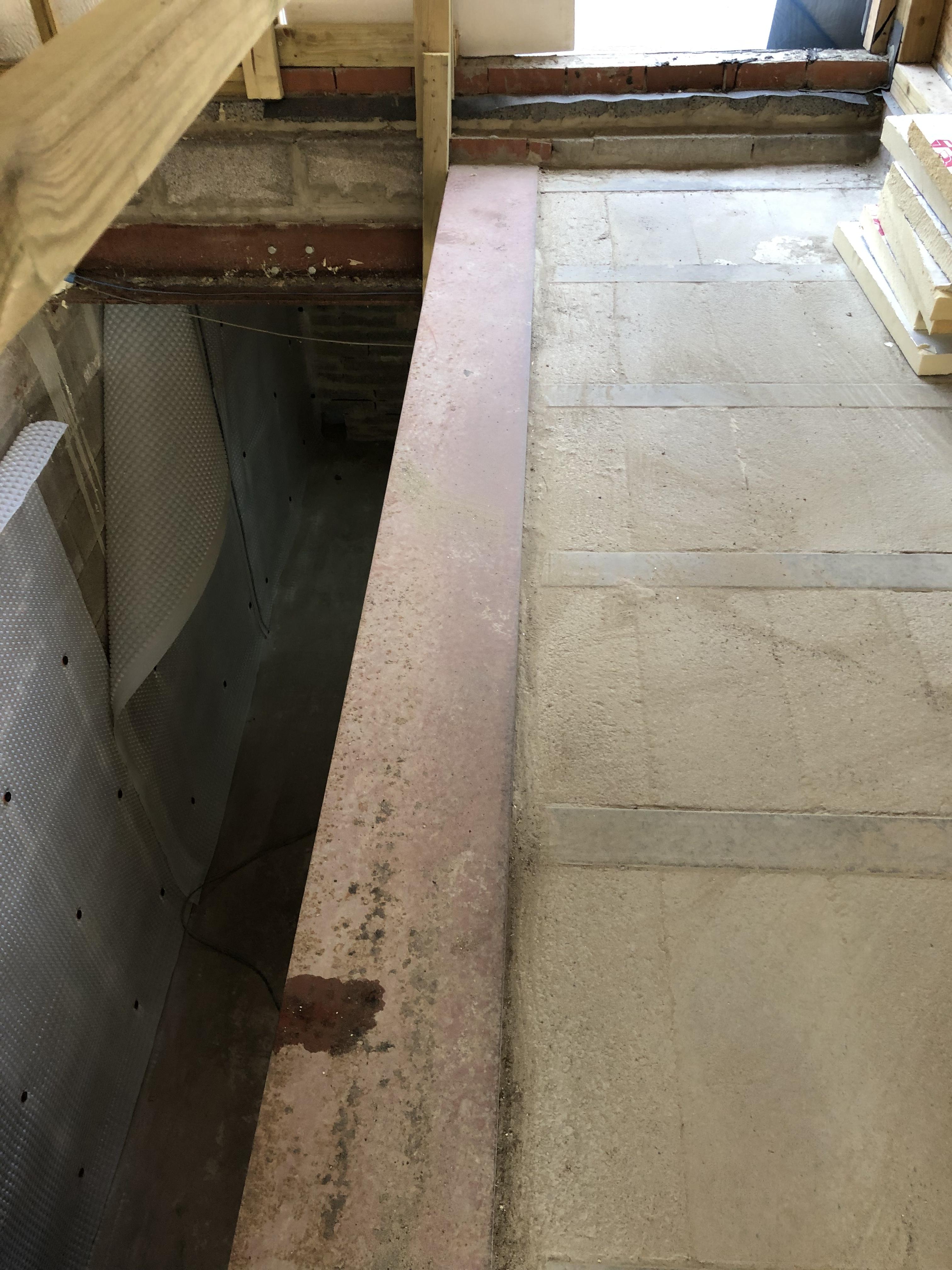

Pocster Posted April 14, 2019 Share Posted April 14, 2019 Hey all i need to build up a concrete plinth that happens to be on an internal steel . Whats the best way to attach concrete blocks to structural steel ? I could cement them but i’m Guessing that’s not the preferred way .... ? Link to comment Share on other sites More sharing options...
Brickie Posted April 14, 2019 Share Posted April 14, 2019 Sand & cement mortar is the only way I know of laying concrete blocks, Tell is more about this plinth and if the steel was designed to carry this load as well as the function it already performs? Ps my fave tv show ‘Brexit’ has been commissioned for another series :)) 1 Link to comment Share on other sites More sharing options...
Pocster Posted April 14, 2019 Author Share Posted April 14, 2019 15 minutes ago, Brickie said: Sand & cement mortar is the only way I know of laying concrete blocks, Tell is more about this plinth and if the steel was designed to carry this load as well as the function it already performs? Ps my fave tv show ‘Brexit’ has been commissioned for another series :)) It’s an internal steel whose function is just to provide support for the stairwell . I need to shutter the edge for ufh screed . But also need a good edge for fixing of balustrade and the actual staircase . Link to comment Share on other sites More sharing options...

Pocster Posted April 15, 2019 Author Share Posted April 15, 2019 Here’s the steel to make it clear . i just need a nice concrete base along its length ( and probably as wide ) I could just cement concrete blocks to it but i’m worried when they are drilled for fixings the vibrations will cause concrete block to disconnect from steel beam Link to comment Share on other sites More sharing options...
Declan52 Posted April 15, 2019 Share Posted April 15, 2019 You only build the first course and put maybe 2 of them fixings in. Let the motar go of and then build away the next day. What is the purpose of the concrete base??? Link to comment Share on other sites More sharing options...
Pocster Posted April 15, 2019 Author Share Posted April 15, 2019 (edited) 2 minutes ago, Declan52 said: You only build the first course and put maybe 2 of them fixings in. Let the motar go of and then build away the next day. What is the purpose of the concrete base??? So bed the fixing in the 1st base mortar and then drill/screw 2nd course to fixings ? That edge will have balustrade and also self supporting stair case will fix to it Edited April 15, 2019 by pocster Link to comment Share on other sites More sharing options...

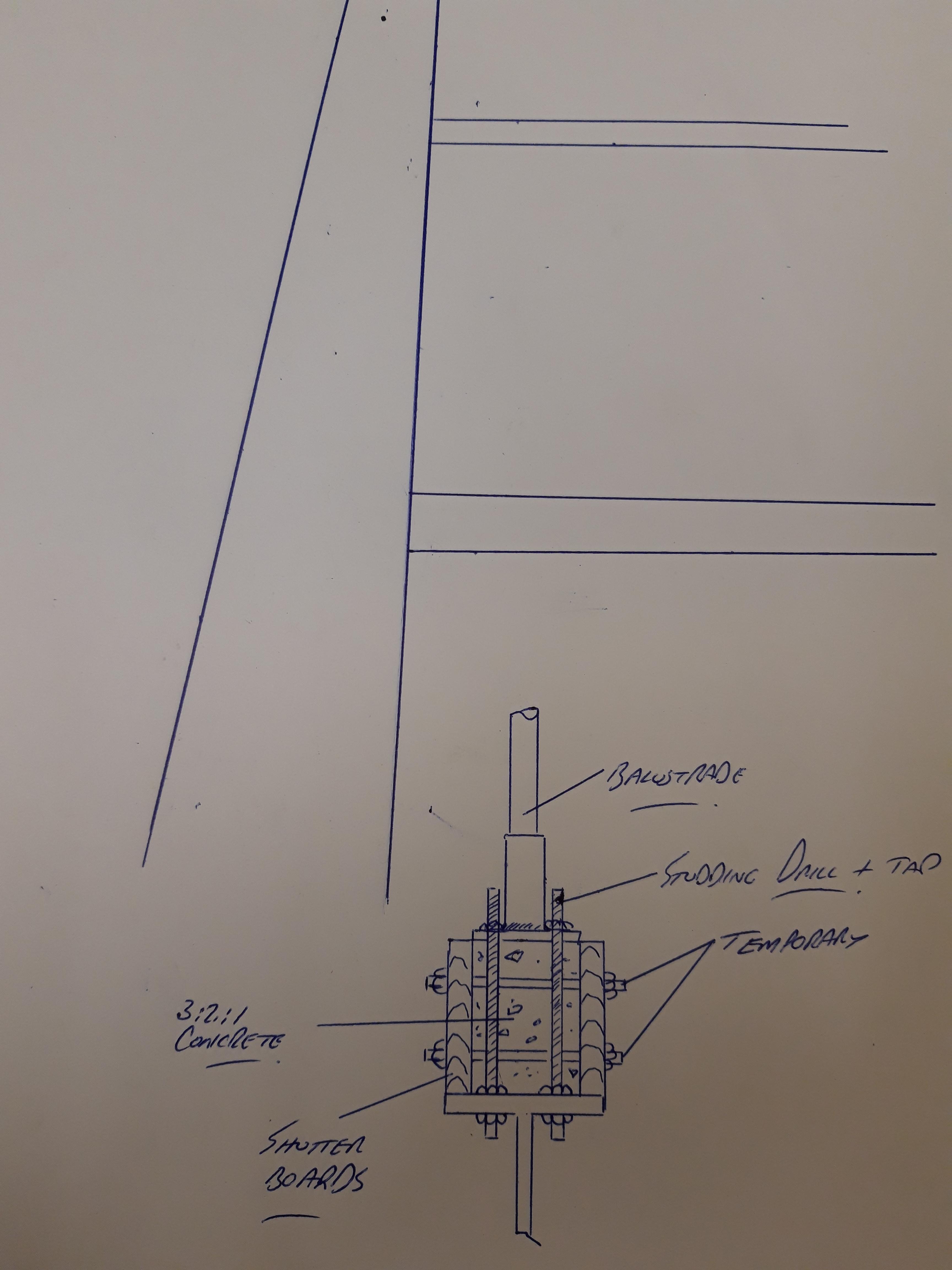

Onoff Posted April 15, 2019 Share Posted April 15, 2019 14 minutes ago, pocster said: So bed the fixing in the 1st base mortar and then drill/screw 2nd course to fixings ? That edge will have balustrade and also self supporting stair case will fix to it What form will the balustrade take / look like? I'm thinking along the lines of drill and tap (if you don't want to weld) some base fixings into the top flange of that steel then cast concrete in-situ up level with them. Couple of stiff timbers as shuttering tied together with some studs. Doddle. Link to comment Share on other sites More sharing options...

Onoff Posted April 15, 2019 Share Posted April 15, 2019 Is this balustrade a show thing? External or internal? Seems mad not to fix direct to that lovely big bit of steel.....something like this I was thinking. 1 Link to comment Share on other sites More sharing options...
Pocster Posted April 15, 2019 Author Share Posted April 15, 2019 (edited) 36 minutes ago, Onoff said: Is this balustrade a show thing? External or internal? Seems mad not to fix direct to that lovely big bit of steel.....something like this I was thinking. All internal . Problem is I need to ‘shutter’ this bit for ufh and screed . Balustrade some way off ? , but yes they could drill through the lot to bolt off the steel Edited April 15, 2019 by pocster Link to comment Share on other sites More sharing options...
Declan52 Posted April 15, 2019 Share Posted April 15, 2019 13 minutes ago, pocster said: All internal . Problem is I need to ‘shutter’ this bit for ufh and screed . Balustrade some way off ? , but yes they could drill through the lot to bolt off the steel The block wall will give you something to act as a shutter. 1 Link to comment Share on other sites More sharing options...
