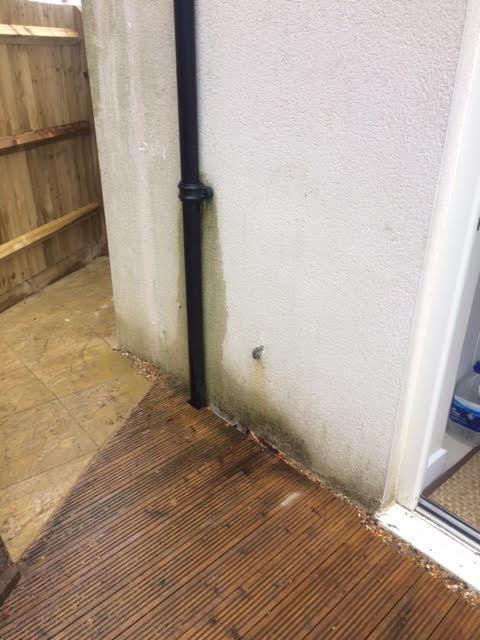

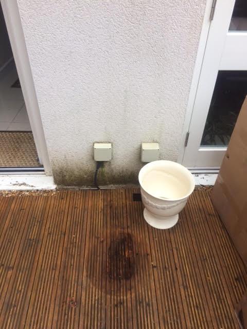

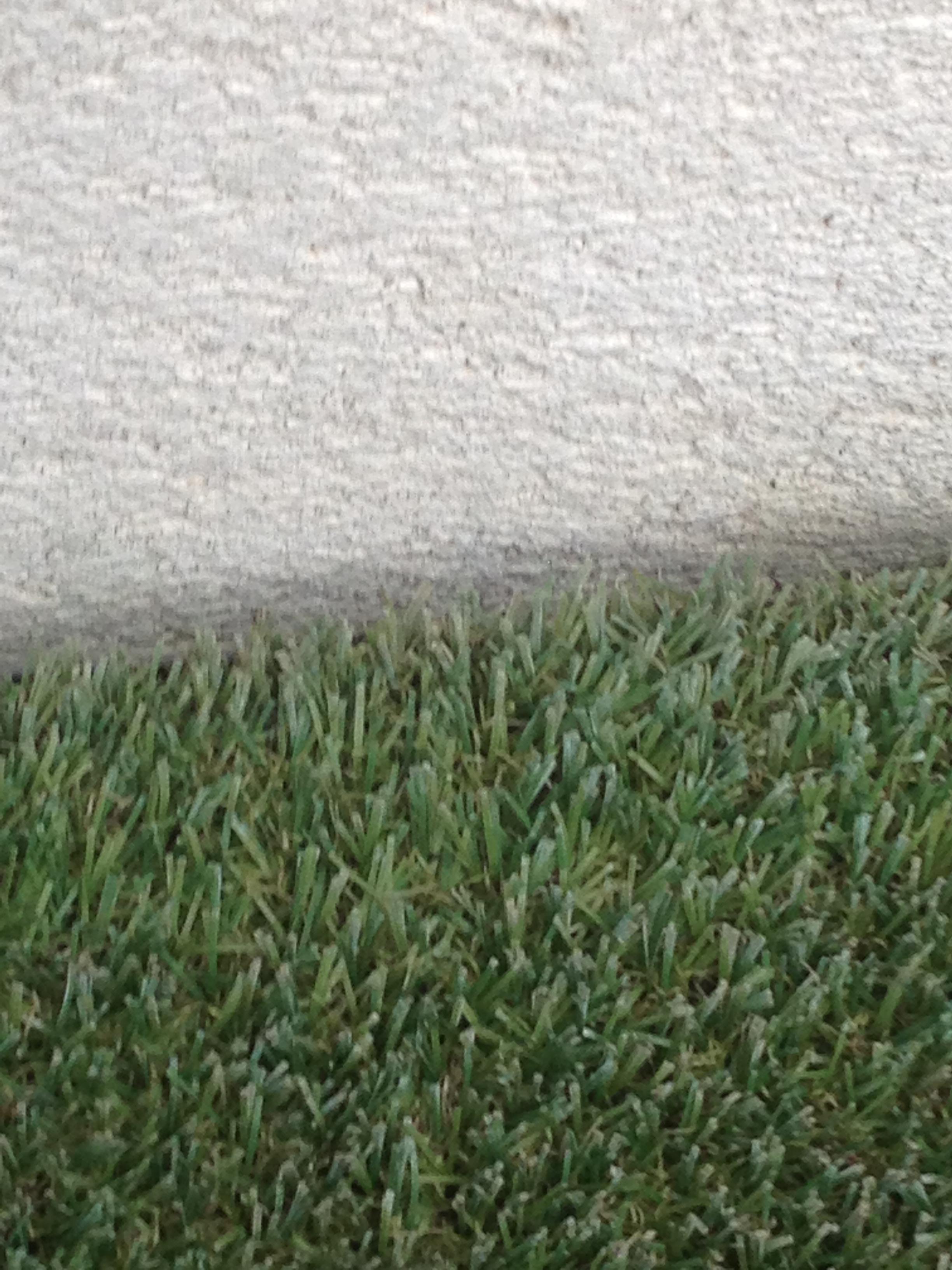

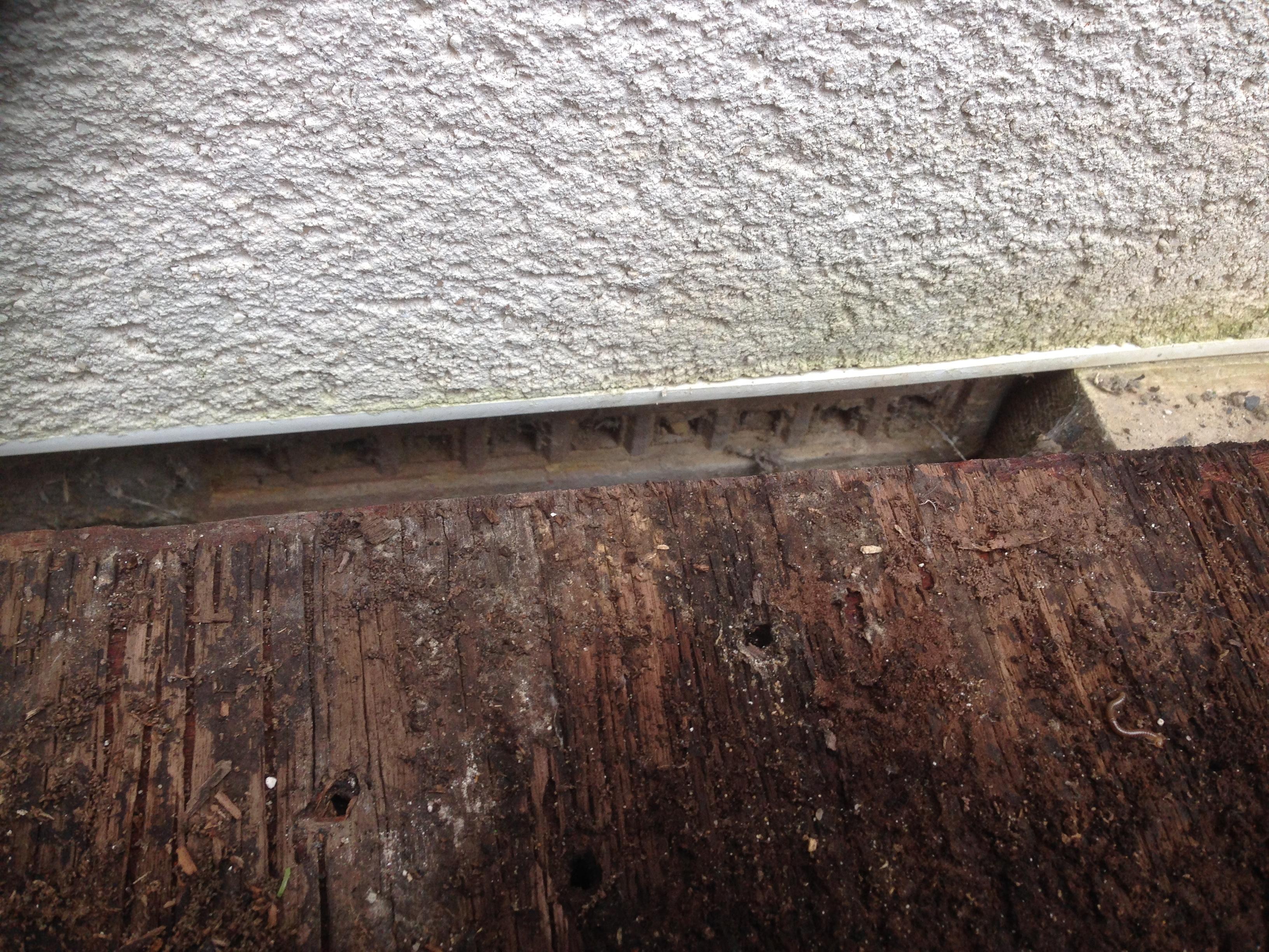

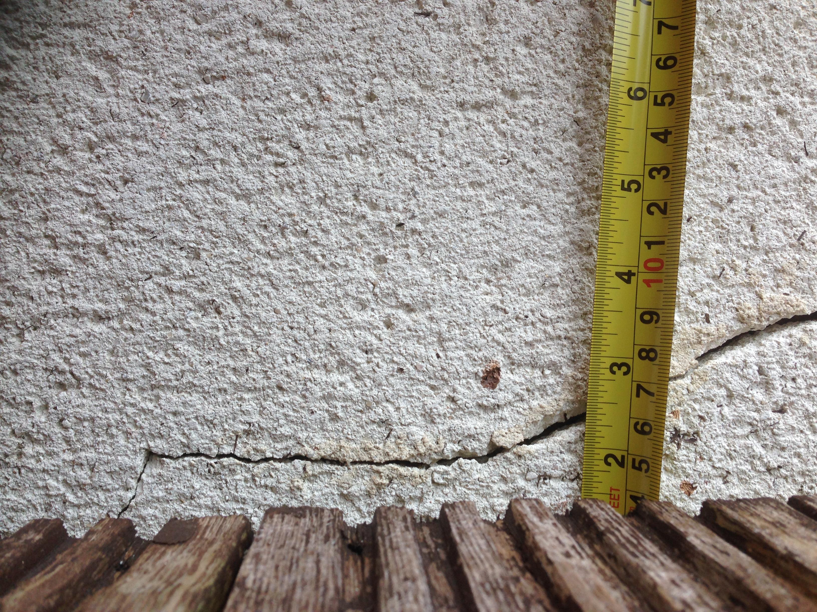

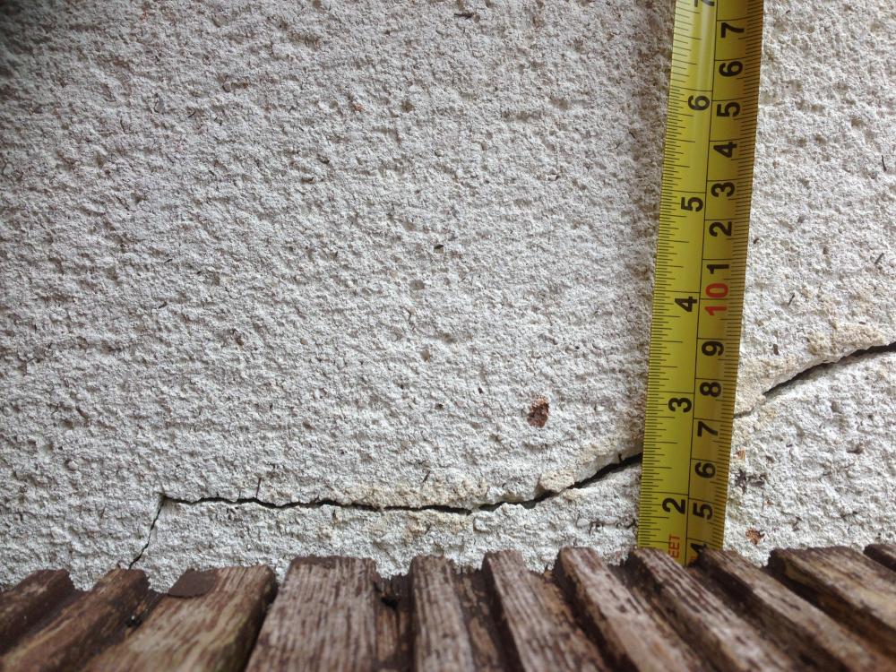

Bri44 Posted April 12, 2019 Posted April 12, 2019 (edited) Hi all. After some expert opinions on what the correct solution is for my decking and grass area. Currently it is 40mm above the DPC, it is fastened to the house by wooden spars with no spacers, the spars are directly under the DPC. it is causing the render to crack and crumble and has rising damp. the fake grass has been laid straight onto hardboard with no drainage, it is now rotting away. thanks Edited April 12, 2019 by Bri44

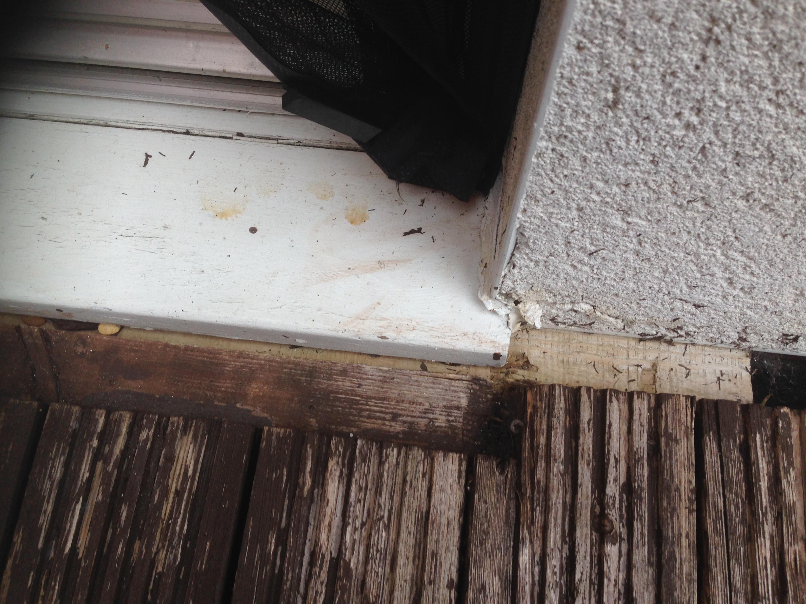

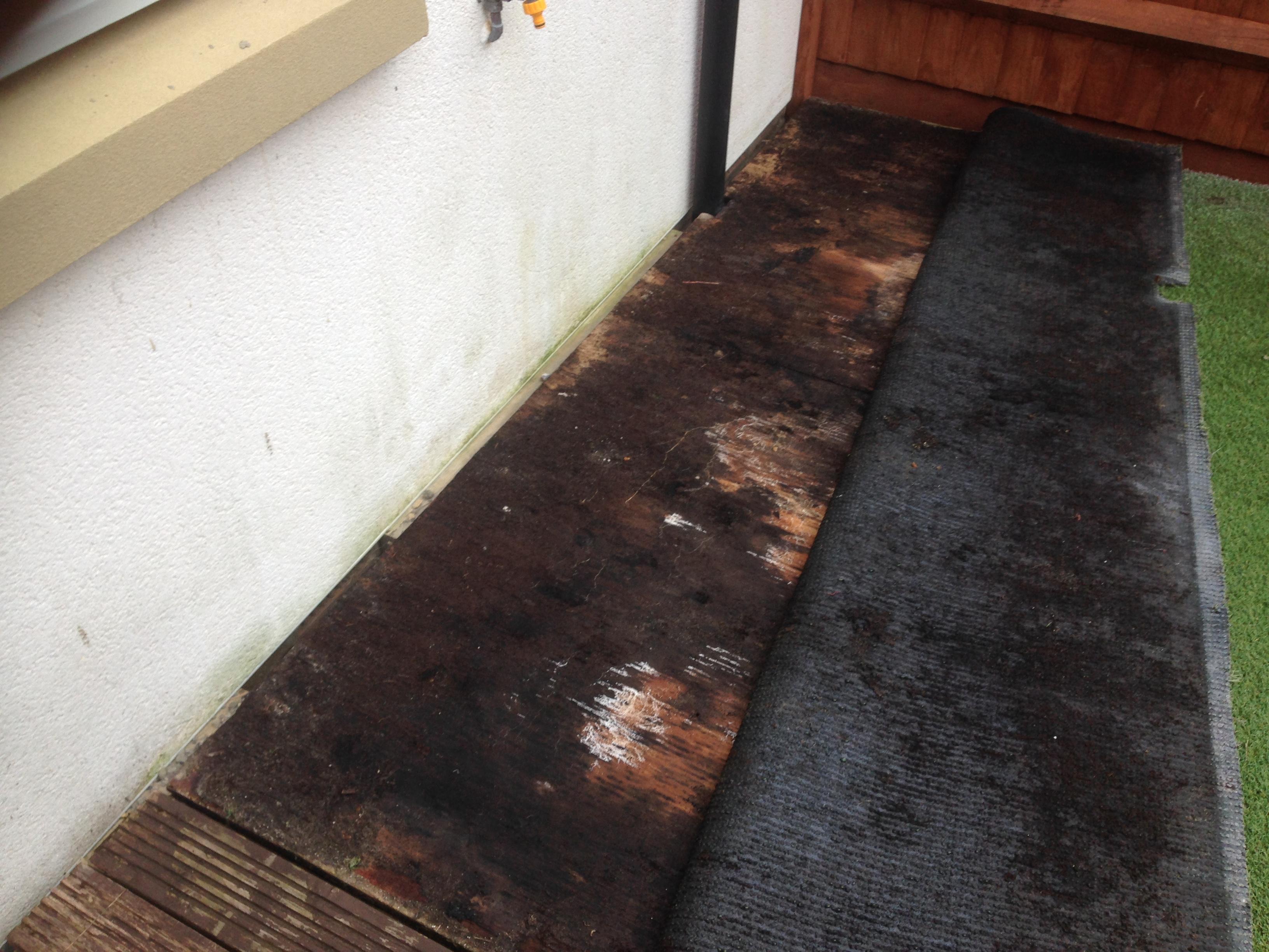

Declan52 Posted April 12, 2019 Posted April 12, 2019 It's cracking as the deck is swelling and putting pressure on the render. Your going to have to lift a few boards and try to prise it out from the house. A spade or a crow bar should be enough to move it. As for laying artificial grass on hardboard I don't know what to say about how bad that is. Artificial grass is full of holes to allow rain to drain through. Yours is draining beneath but has no where to go so is rotting the hardboard. It will all need ripped out, no other way round it. Your either going to have to redo the top with deck boards or treated timber and then relay the grass. Going from these photos I would highly doubt what is below the deck is done right either. You might be better lifting it all then examine what's been done and then do it right. Otherwise you might end up going through it some day.

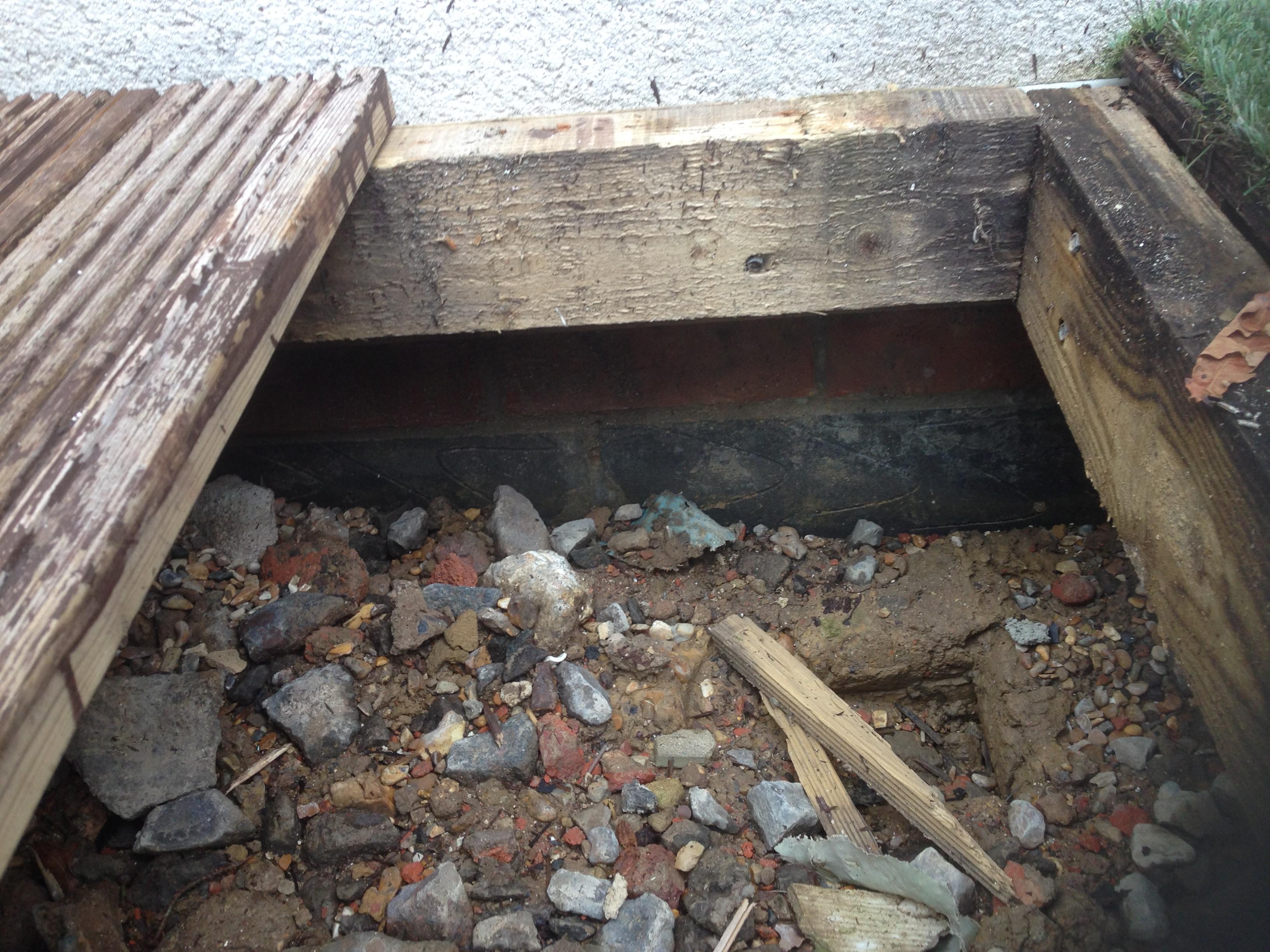

Ferdinand Posted April 12, 2019 Posted April 12, 2019 (edited) What is underneath? can you just take it away? It classically needs to have a surface 150mm below the dpb, and everything sound and functional eg air bricks. It may be that it is worth doing more given that you have to start eg put a gravel path and French Drain in, or go deeper and put skirt insulation on that wall. What is the situation with the remainder of the house? F Edited April 12, 2019 by Ferdinand

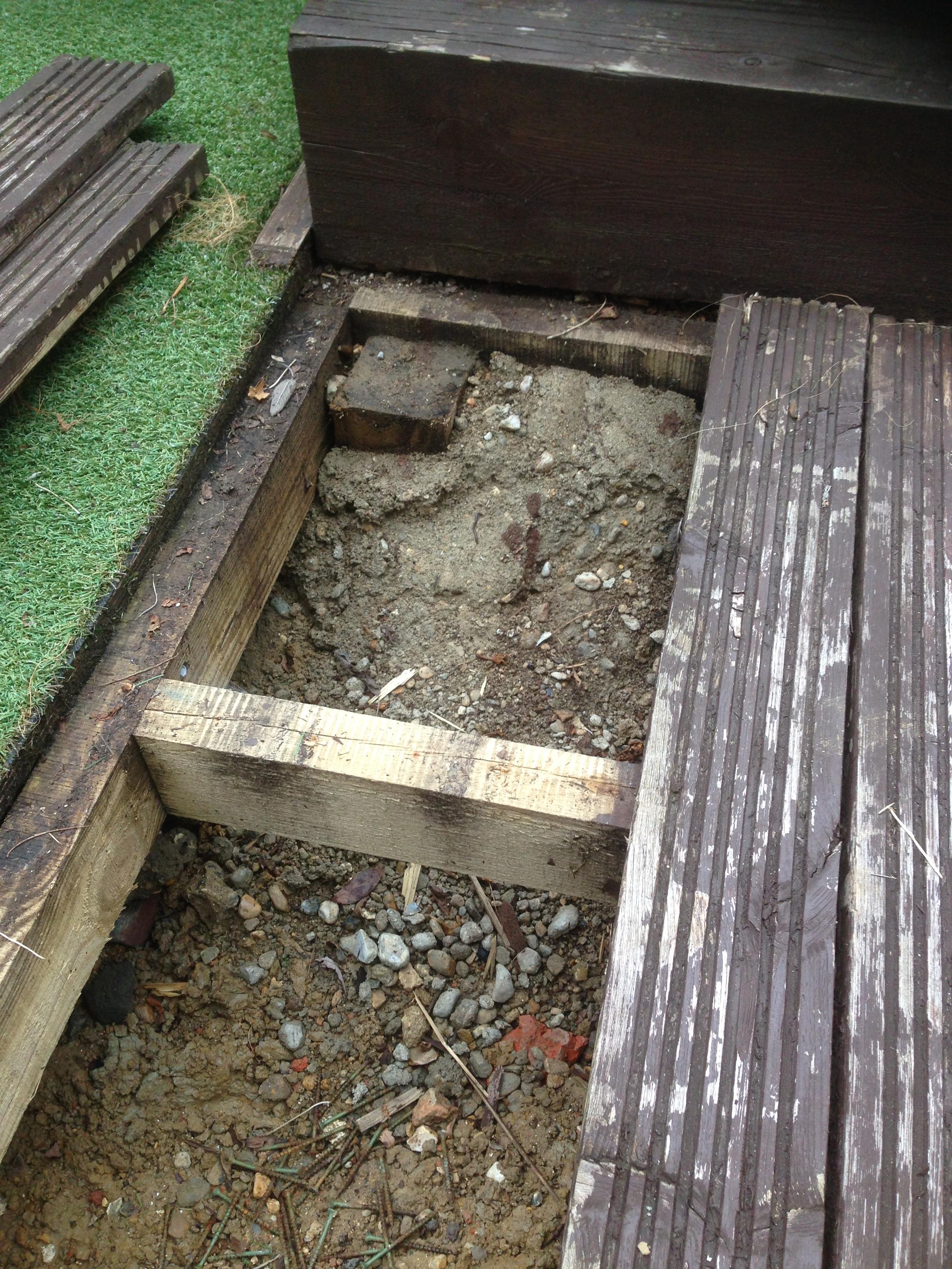

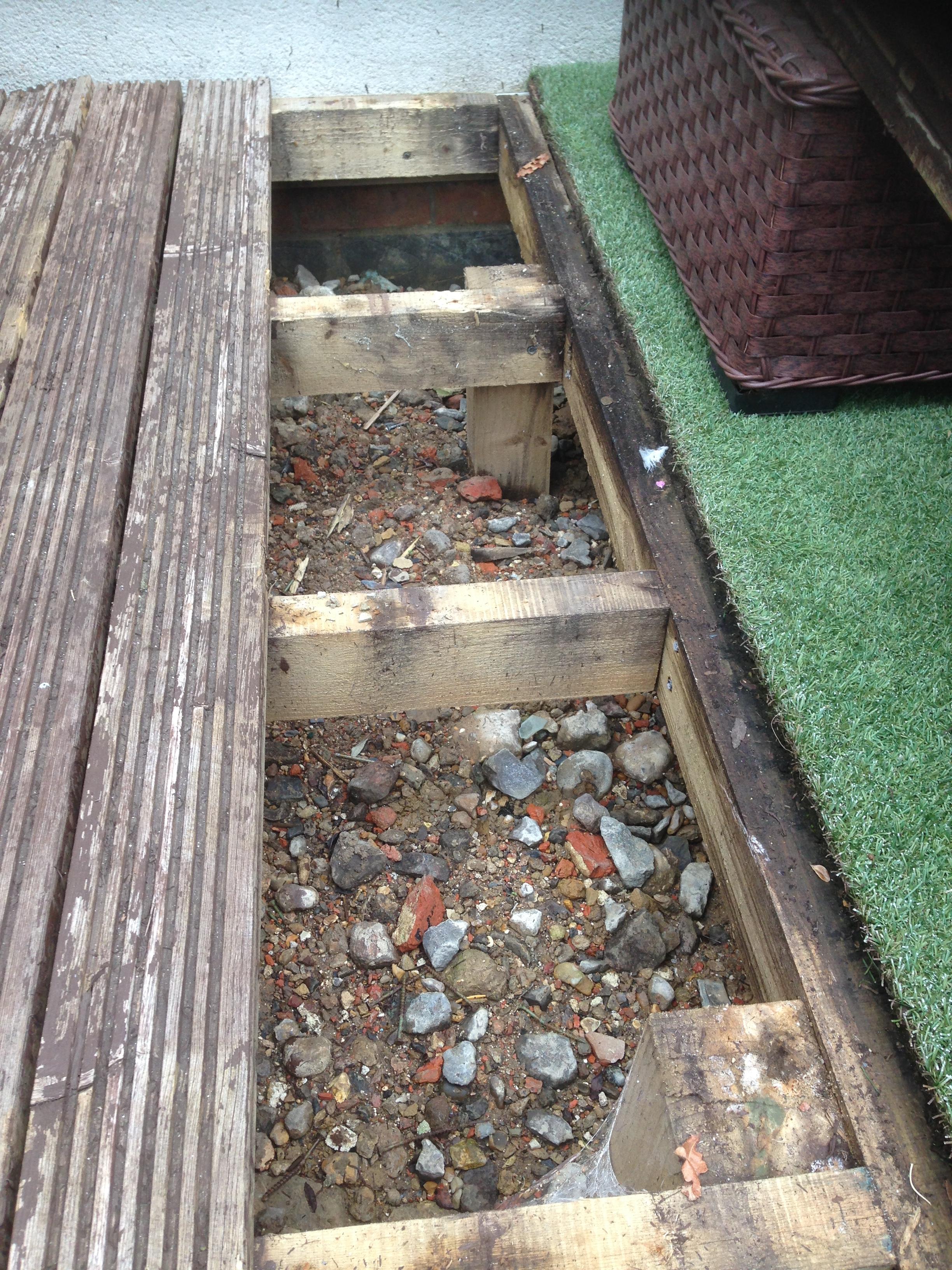

Bri44 Posted April 12, 2019 Author Posted April 12, 2019 Here is underneath. It is approx 1 foot off the ground.

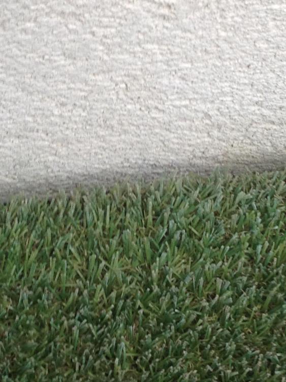

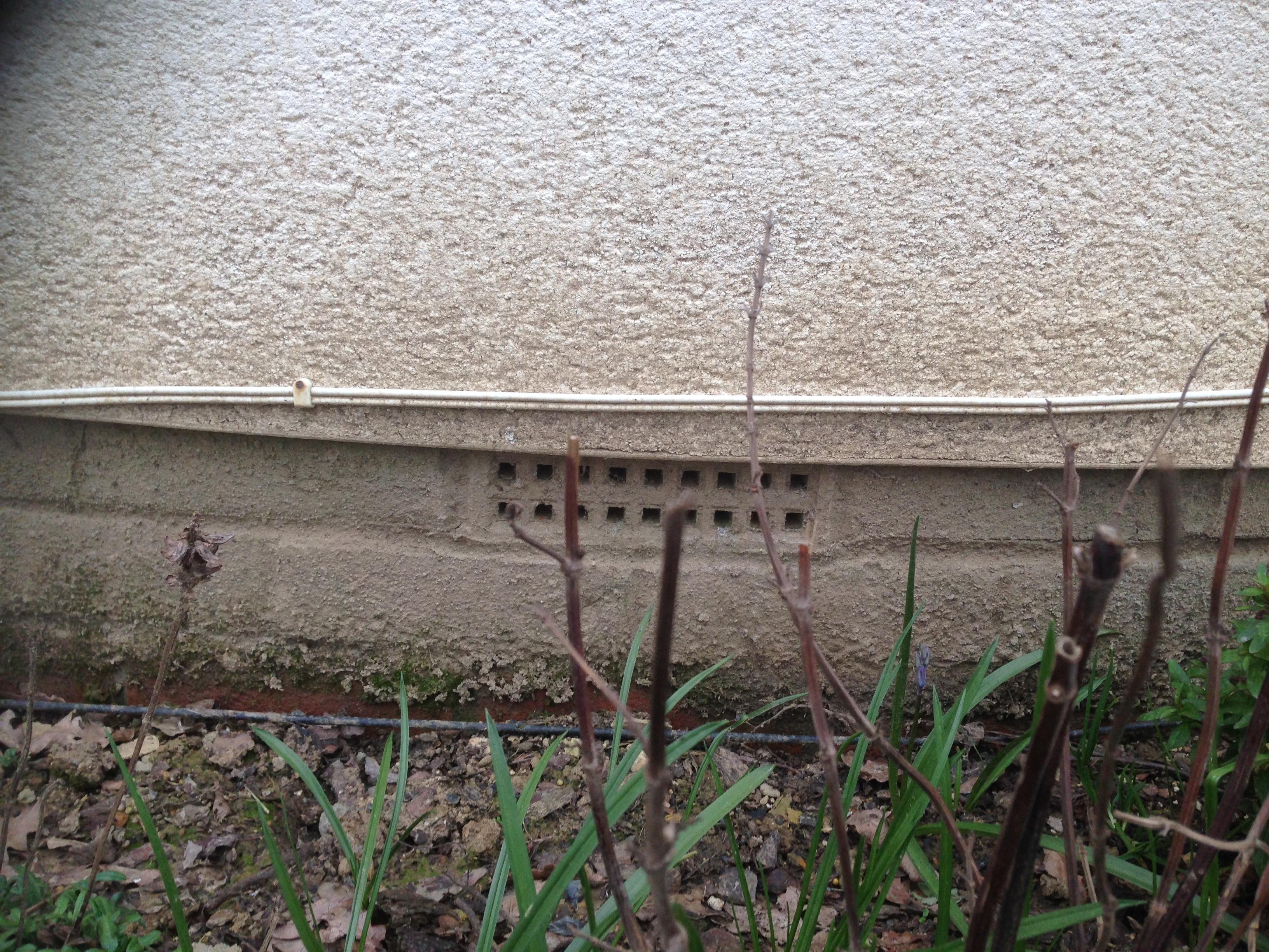

Bri44 Posted April 12, 2019 Author Posted April 12, 2019 Here is airbrick which is covered when grass down, it has two rows of holes

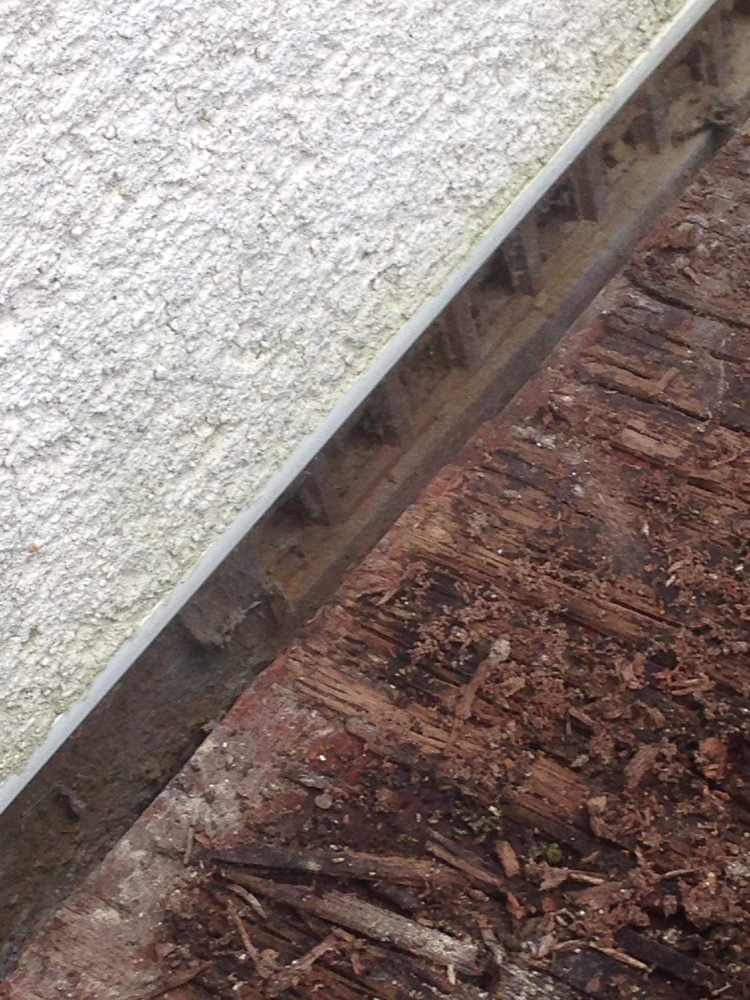

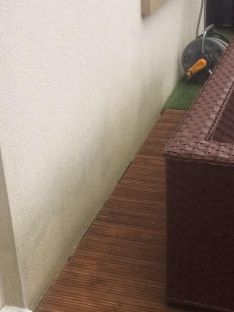

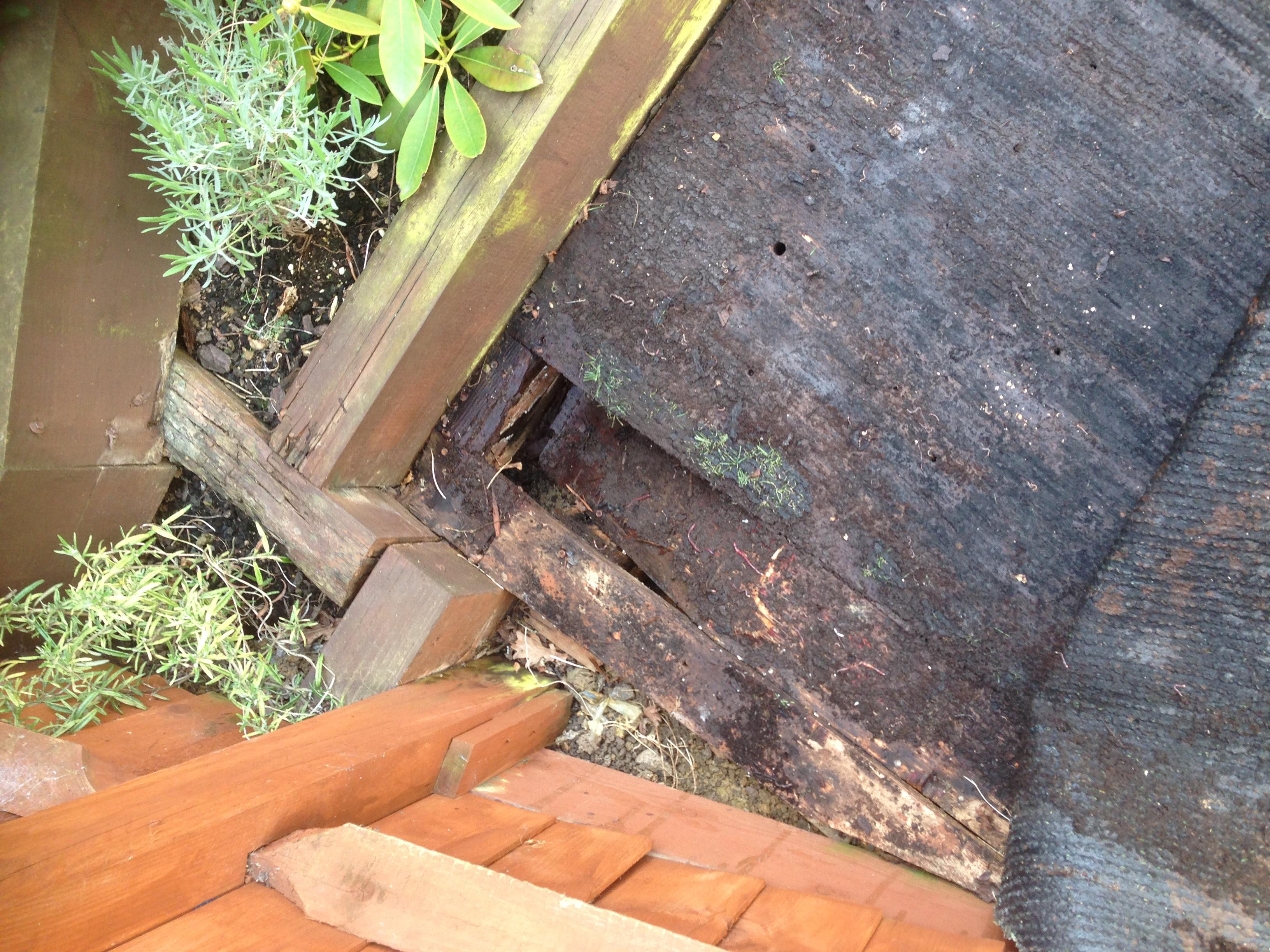

Bri44 Posted April 12, 2019 Author Posted April 12, 2019 The back door step seems to be supported by the spar fixed to the house. Second image is the air vent at front of house that I had to dig out.

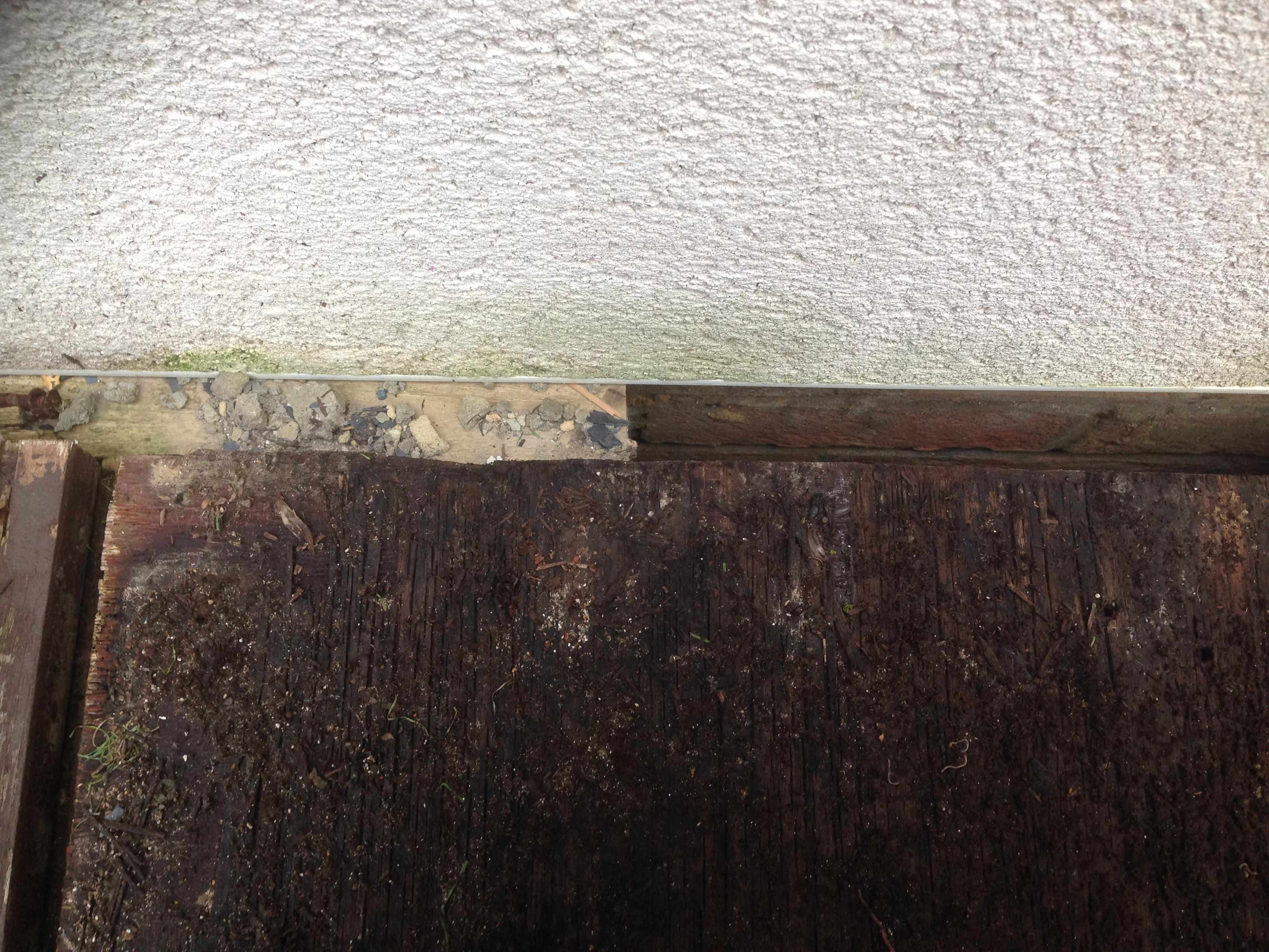

Bri44 Posted April 12, 2019 Author Posted April 12, 2019 Here is the board under the grass at the opposite end to the house. My foot went through it last weekend
Bri44 Posted April 12, 2019 Author Posted April 12, 2019 37 minutes ago, Ferdinand said: What is the situation with the remainder of the house? F The levels around the whole house are incorrect. The front garden i had to dig out a trench but still get splash back from the mud. The side of the house has paving that is level or just below the DPC with no drainage at all.

Declan52 Posted April 12, 2019 Posted April 12, 2019 That just needs ripped out. It would take longer to patch up. None of them joists are treated timber. There is a real lack of fixings holding the joists to the posts, maybe a single nail. Your looking at a joiner to get it done correct so it will last. Some garden companies will do this type of work as well. Some in your area might have a Facebook page where you can at least see pics from jobs plus comments and reviews from customers.

Declan52 Posted April 12, 2019 Posted April 12, 2019 22 minutes ago, Bri44 said: Thanks Declan. Seeing that the deck is 40mm above the DPC, would you say cutting it back by 150mm would stop the damp problems? I`ve read that splashback will cause damp unless the deck is 150mm below the DPC. When you say ripped out, would you then reinstall at 150mm below DPC? Yeah the splash won't be helping. It will need dug down and rebuilt so it ends up 150mm below your dpc. To do the artifical grass correct you will need a sub base of 150mm of well compacted hard-core. On top of that then you screed either sharp sand or quarry dust level. Then you can roll out your grass. The sand / dust will mean it will drain and the hard core means it won't sink. You can't skimp on either of these steps.

Bri44 Posted April 12, 2019 Author Posted April 12, 2019 1 minute ago, Declan52 said: Yeah the splash won't be helping. It will need dug down and rebuilt so it ends up 150mm below your dpc. To do the artifical grass correct you will need a sub base of 150mm of well compacted hard-core. On top of that then you screed either sharp sand or quarry dust level. Then you can roll out your grass. The sand / dust will mean it will drain and the hard core means of won't sink. You can't skimp on either of these steps. This is what the developers 4 contractors all said but the developer wants to cut it back by 150mm only.

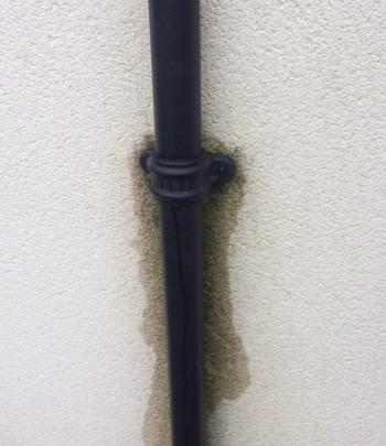

Bri44 Posted April 12, 2019 Author Posted April 12, 2019 (edited) What the damp and downpipes look like when I don`t clean it. This was shortly after moving in. the developer cut the deck back by 2 inches as it was flush against the render. Then they put a layer of gravel on top of the spars to try and make it look acceptable. The site manager was explaining this to me the day I moved in saying, the building inspector would not sign off until we cut this back. Edited April 12, 2019 by Bri44
