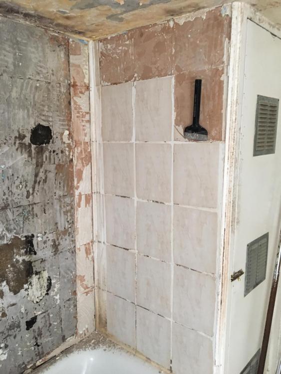

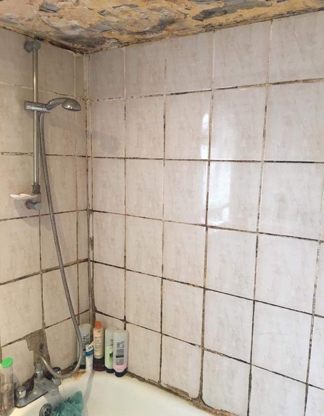

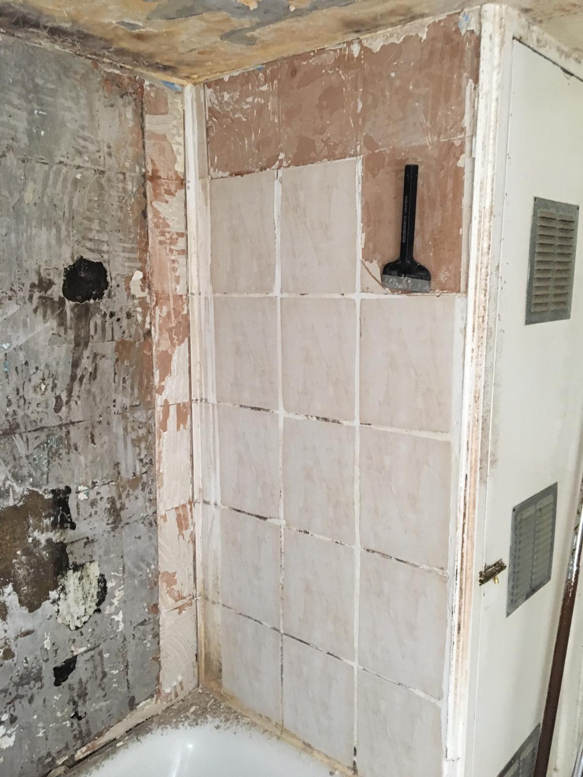

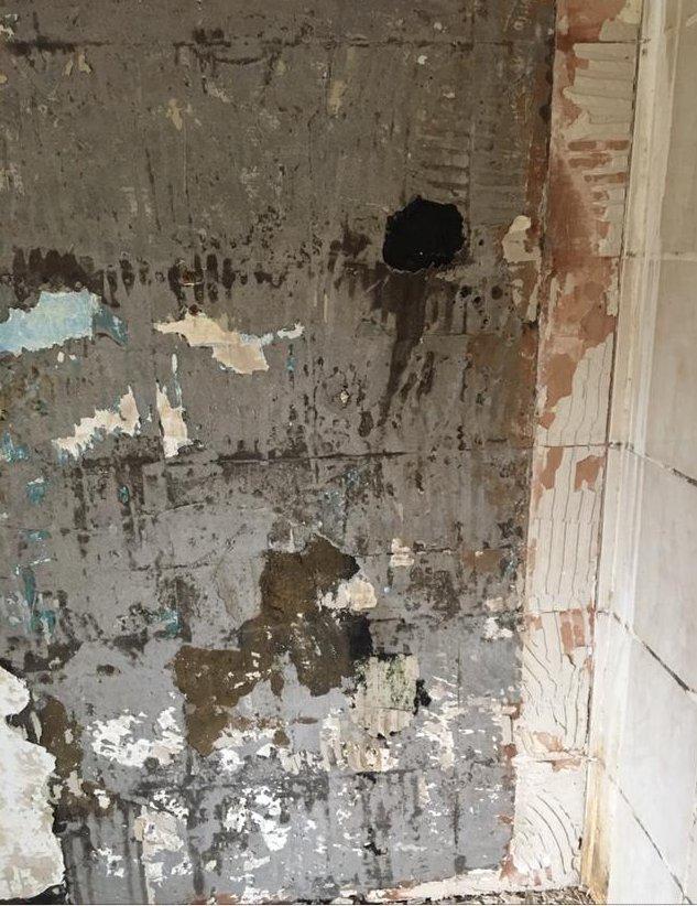

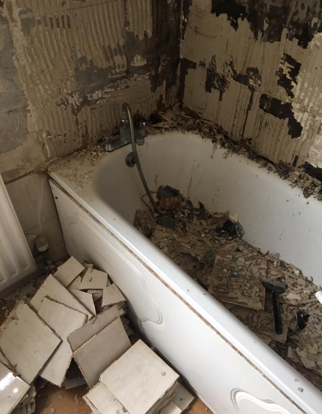

Onoff Posted April 9, 2019 Share Posted April 9, 2019 (edited) Mate's rented place. He wants to fit a new bath & re-tile. He's stripped the tiles above the bath and reckons there were some hollow tiles and that the blocks behind are damp. First couple of tiles were a bitch to get off, rest more or less fell off. This is an external wall. Brick facade externally. He can't access that to check any mortar joints as a neighbouring glass roof. At this point he doesn't know whether the damp is coming through from outside or has penetrated through the tiles. They do have a shower handset in the bath so this wall (the tiles) get wet. Tbh my money is on the tiles letting water through: He has a working Envirovent in there. Flat roof above that has been repaired. His plan is to overboard. I've told hin to use moisture resistant, (green). Before: With the tiles removed: He's already bought the new tiles & bath. If he hadn't I might have suggested "multipanel" type board. My gut feel is to tank the wall with Everbuild Aquaseal but will it stick to damp walls? Is there anything else he could use? I remember using a liquid dpm from Wickes you applied in two coats. The second one you threw sand at to give a key. Does he need to "stabilise" the walls in any way? One option is that I have an unused tube of Feb Blue Grit he's welcome to. This is made by Everbuild who make Aquaseal tanking membrane and tbh, other than the grit in it the blue liquid element looks and smells the same. At the mo he's just cleared the debris and rigged a temporary shower curtain so they can continue using the shower. Any suggestions for him to move forward. Cheers Edited April 9, 2019 by Onoff Link to comment Share on other sites More sharing options...
ProDave Posted April 9, 2019 Share Posted April 9, 2019 What a sorry state. Condensation and mould heaven. It looks like a very poorly insulated very poorly ventilated bathroom. Is the property occupied? (I hope not for the tenants sake) First thing is ventilate well and use a dehumidifier to dry the whole lot out. While you are doing that scrape and scrub that lousy ceiling to get back to something sold and clean as apart from the tiles you will be renovating that ceiling. If it dries out okay and remains dry go ahead and re tile after making good any rotten plaster. If it remains damp you really have to find the problem. And ensure the place is heated and ventilated properly. The only times we had issues was when the tenant was too tight to turn the heating on, and turned the fan off. Tip: Rental properties should NEVER have a fan isolator switch, that just invites the tenant to turn it off. If it is a problem room due to poor insulation consider a single room mvhr. 1 Link to comment Share on other sites More sharing options...

Mr Punter Posted April 9, 2019 Share Posted April 9, 2019 Strip all the crap from the walls. Cut out the crap bit of ceiling and replace with MR board. Dry the room properly for a couple of weeks. Fit an extractor with a timer wired to light and set the overrun to 20mins. Use the blue grit on the walls after they have properly dried. Re-tile with cement based adhesive from a bag. Grout to finish. Link to comment Share on other sites More sharing options...

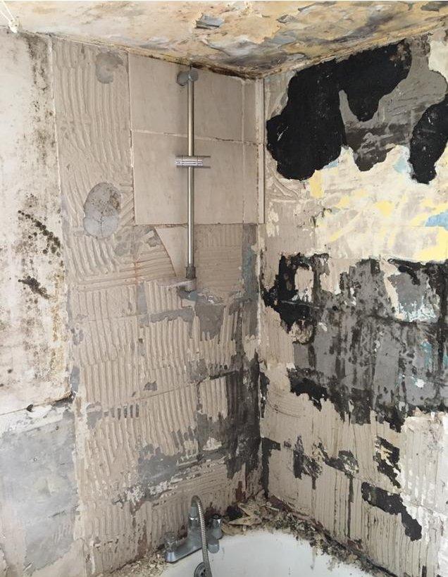

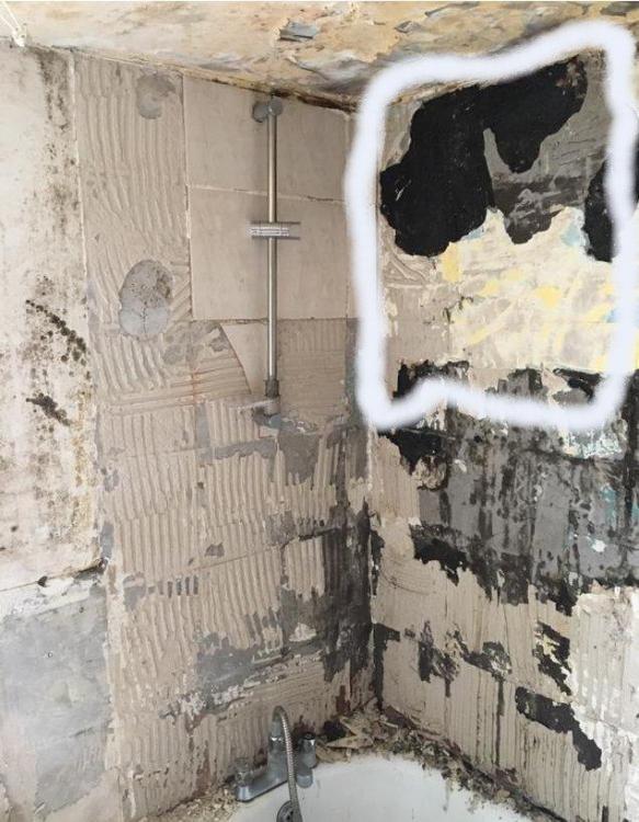

Onoff Posted April 9, 2019 Author Share Posted April 9, 2019 VIDEO of the fan, clearly not mvhr! Guess is they shower and some in the house, not all, just don't bother to switch it on. There's the left hand wall where the shower riser is and taps below. Tiles are stuck pretty fast here except the ones low down by the taps. This is a VIDEO of the main wall over the bath: Then the right hand wall, tiles are stuck fast. If it's brick outside and blocks on the inner leaf my guess is the damp and tiles lifting issue is purely down to lack of ventilation and the constant spray on that wall over the years. What in the way of insulation could he line that wall with? Battens and 50mm pir like I've done? Link to comment Share on other sites More sharing options...
Onoff Posted April 9, 2019 Author Share Posted April 9, 2019 (edited) I suggested battens with 50mm pir in between then mrpb over the top. Would bring the main wall out by about 65mm. He's worried though this would put the bath too close to the rad valve: I therefore suggested maybe raking the bath panel in at the bottom like I've done on mine. Got to admit I'd be taking that ceiling down to see if it's wet from the flat roof above. Edited April 9, 2019 by Onoff Link to comment Share on other sites More sharing options...

ProDave Posted April 10, 2019 Share Posted April 10, 2019 That wall on the long bath edge is soaking. It needs stripping and some time with the dehumidifier to see if it dries out. It might be wet from the shower leaking through failed grout, it might be wet from something else above or the other side of the wall (is that an outside wall or party wall) I have seen people carry on using a shower in this state during renovation by hanging a shower curtain or 2 up the wall while showering then take it down to allow the room to breathe and dry out. If it does not dry out then it is a building problem and he has the "fun" of explaining to the HA the present state of it.......... Link to comment Share on other sites More sharing options...
Onoff Posted April 10, 2019 Author Share Posted April 10, 2019 9 minutes ago, ProDave said: That wall on the long bath edge is soaking. It needs stripping and some time with the dehumidifier to see if it dries out. It might be wet from the shower leaking through failed grout, it might be wet from something else above or the other side of the wall (is that an outside wall or party wall) I have seen people carry on using a shower in this state during renovation by hanging a shower curtain or 2 up the wall while showering then take it down to allow the room to breathe and dry out. If it does not dry out then it is a building problem and he has the "fun" of explaining to the HA the present state of it.......... He has rigged a temporary shower curtain. Link to comment Share on other sites More sharing options...

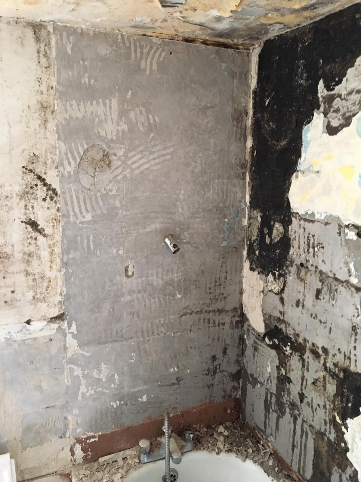

Onoff Posted April 17, 2019 Author Share Posted April 17, 2019 (edited) Update. He's had a builder mate come around and look at the walls. Consensus is that the damp is where the water from the showering has gotten through the grout lines and behind. Wright or wrong he "primed" the whole area with 2 coats of Mapei Primer G. Applied it late on Monday. Prior to this he hacked off the loose plaster in the area circled below: When the Mapei Primer G dry to the touch he's "filled / skimmed" with this stuff - just really the area circled above: Says as of this morning it's dried everywhere but on the "blackjacked" areas it's still damp /cold. The tiles for the wall he has are porcelain, 600x600x8.5 (9.5?) He's considering saying "f*** it" and boarding with Aqua Panel/Wedi boards etc. Couldn't he just Aqua Seal tank the whole lot and get the tiles on? Says it's all pretty flush holding the spirit against it. Any thoughts on how he can best get a surface ready to tile on that will take the tile weight and how to fix whatever to the wall behind? Cheers Edited April 17, 2019 by Onoff Link to comment Share on other sites More sharing options...
Mr Punter Posted April 17, 2019 Share Posted April 17, 2019 I think the 600 x 600 are a good call as there won't be too many grout lines. The corners are often the weak points. I think some of the tanking systems have tape that you can use. Make sure everything is completely dry before tanking. Link to comment Share on other sites More sharing options...
