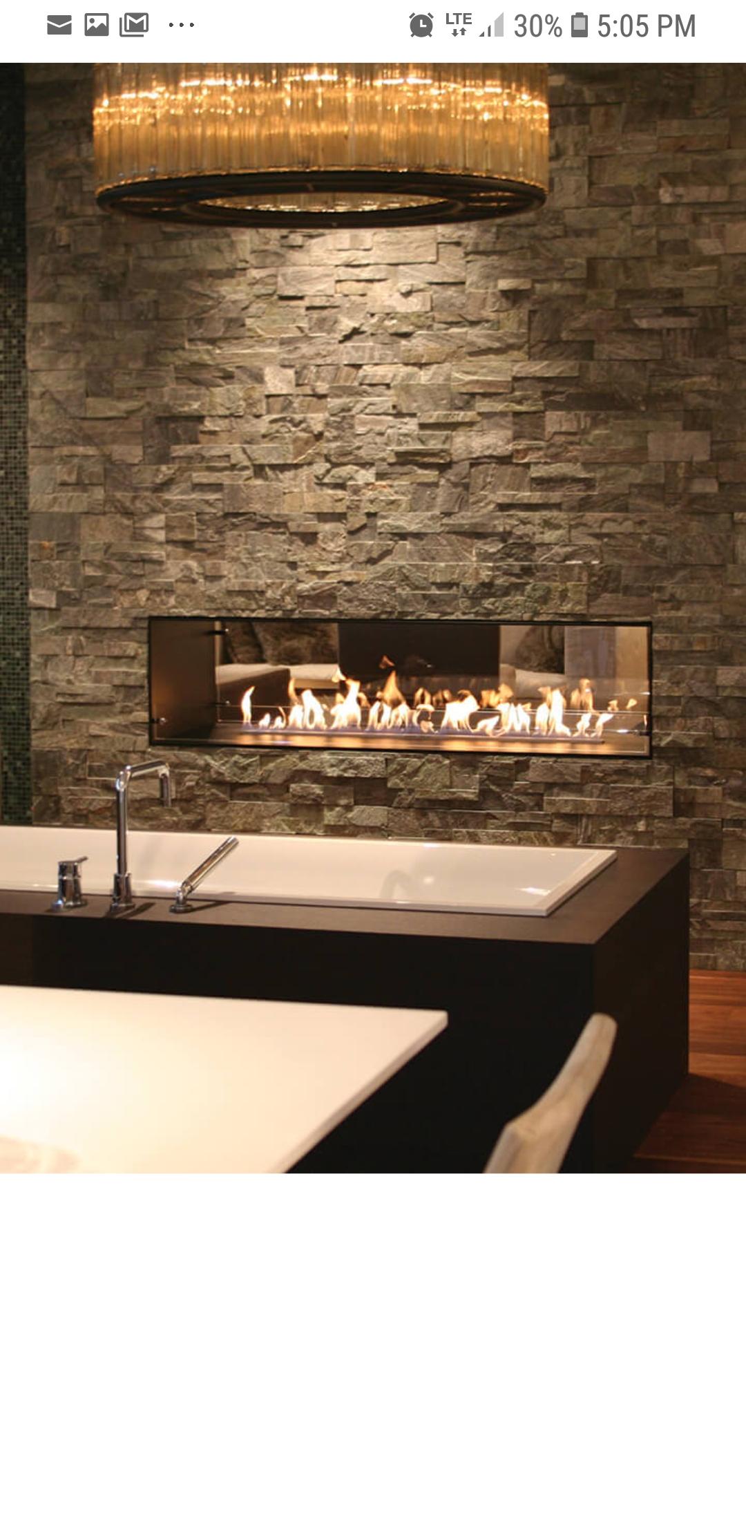

Alexphd1 Posted April 2, 2019 Share Posted April 2, 2019 We have 2x 500l thermal stores in the house heated by 20kw log gasification boiler in garage and solar thermal . PV/ashp to be added. Log and thermal seem to work pretty well. All done DIY. I am slightly concerned about hooking up the ashp to 1x 500l thermal store for ashp efficiency. We are installing a bioethanol fire in the house for the caveman instinct of light a fire to be warm. 1 Link to comment Share on other sites More sharing options...

Carrerahill Posted April 3, 2019 Share Posted April 3, 2019 (edited) On 02/04/2019 at 17:08, Alexphd1 said: We have 2x 500l thermal stores in the house heated by 20kw log gasification boiler in garage and solar thermal . PV/ashp to be added. Log and thermal seem to work pretty well. All done DIY. I am slightly concerned about hooking up the ashp to 1x 500l thermal store for ashp efficiency. We are installing a bioethanol fire in the house for the caveman instinct of light a fire to be warm. Photos! Sounds good. I intend to go down a similar route but I will keep a real log burner in the living room. Edited April 3, 2019 by Carrerahill Link to comment Share on other sites More sharing options...
Alexphd1 Posted April 3, 2019 Share Posted April 3, 2019 Unfortunately that's not our photo but that's the idea. Link to comment Share on other sites More sharing options...
