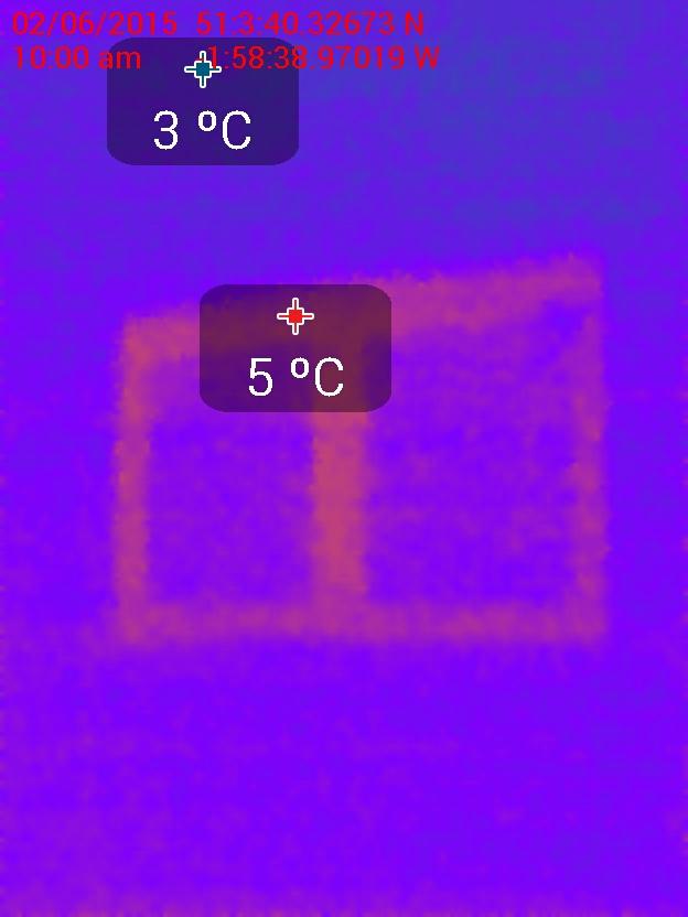

This is an image taken on a fairly cold morning of the outside of one of our living room windows, for comparison:
I set markers over the highest and lowest temperature spots (useful, as it give a sense of the temperature range being displayed) but left the false colour settings to auto-adjust (this means you cannot compare the colour from one image with the colour from another, as they won't represent the same temperature).
The above image shows that, as expected, the window frames have the lowest thermal resistance and that the glazing is reasonably good.  However, a 2°C  increase in the frame outside temperature versus the wall outside temperature isn't too bad.

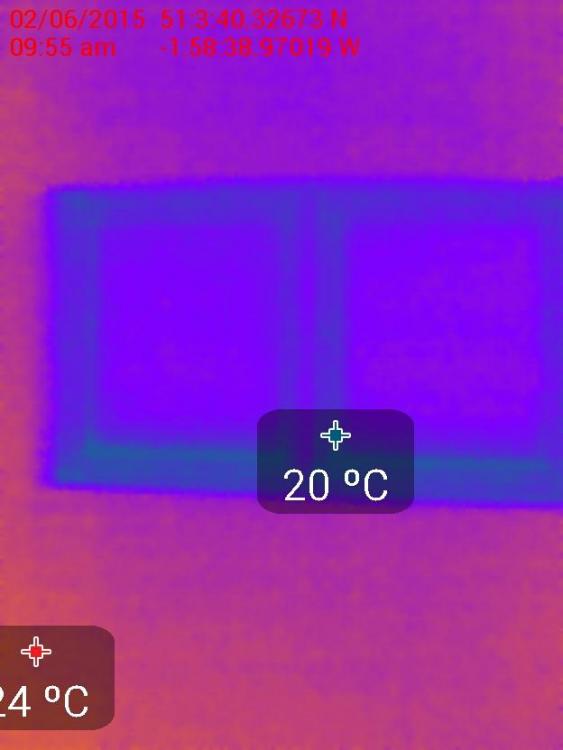

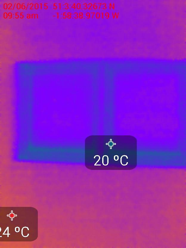

This image is the same window on the same day (5 minutes earlier) from the inside looking out:
Again, I put markers on the highest and lowest temperatures in the image and allowed the false colour range to auto-adjust (so the colours in this image bear no correlation with the colours in the previous image)  The same characteristic is present, in that the window frames are the components with the lowest thermal resistance, but again, a 4°C difference between the wall temperature inside and the coldest part of the window frame inside isn't too bad, and is probably as good as it's likely to be able to get.
