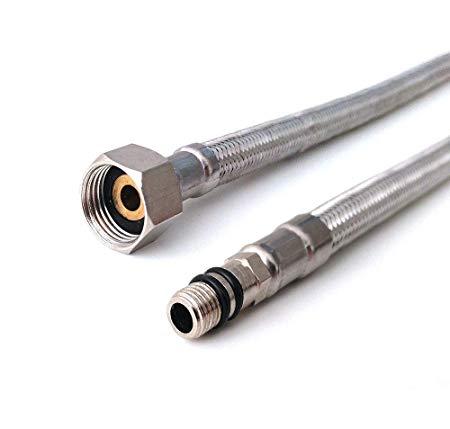

Onoff Posted March 8, 2019 Author Posted March 8, 2019 (edited) I've had these tap connectors lying around for so long I've lost one rubber O ring and the other is dry, cracked and perished! Anyone know what size they are? Measures about 8.5mm dia to the base of the groove. From my trusty £3 Maplin box of assorted O rings I note I have both 7 and 8mm ID ones, both 2mm thick. Cheers Edit: In searching for the O ring size I came across monobloc connectors with double O rings. Are these any better than the single O ring ones? Edited March 8, 2019 by Onoff

PeterW Posted March 12, 2019 Posted March 12, 2019 1 hour ago, Onoff said: Normal ones by the look of it, not flat faced. Should I be worried? They seem to be holding at the mo, saying that I've only got the hot from the cylinder connected. Might be a different story when I put the cold on mains. I could whip them off and turn the face down flat in the lathe? Cheers. Just buy a couple of hose adapters and put the nuts on properly. £3 1
Onoff Posted March 12, 2019 Author Posted March 12, 2019 5 minutes ago, PeterW said: Just buy a couple of hose adapters and put the nuts on properly. £3 Will do: That might cause me problems as it'll push the flexible hoses tighter against the pedestal, that extra 1/2" might be an issue...
